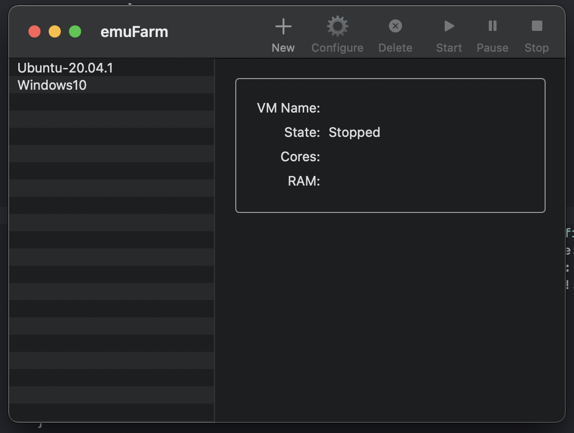

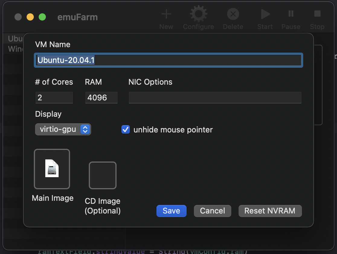

So I've been playing with the source some more, and am working on throwing together a quick little VM Manager.
I'm going to add in the ability to use qemu-img to create a blank RAW or qcow disk from the configuration screen.
Anything else that'd be worth adding in as well? I'll get this all packaged up and submitted as a pull request tomorrow or Wednesday (depending on day job). I've done some basic testing so far, and it seems to work ok.
View attachment 1689947 View attachment 1689950

How about drive options like what UTM uses? Maybe the ability to add a drive or a shared disk? Also it looks like UTM is the only app that will allow you to do full screen with the window. (I know we can use RDP) but would be nice just to hit the green full screen button.
Gnattu
macrumors 65816
Sep 18, 2020
1,107
1,671
UTM is using SPICE as display and heavily patched it to use it with Cocoa, but ACVM is using qemu's built-in Cocoa display. qemu's built-in Cocoa does not support native full screen, but the UTM's implementation does, that's why we can use native full screen on UTM. To implement a full front end of display is somehow out of the scope as ACVM is just a GUI wrapper, not meant to be an all-in-one virtualization solution.
If you are booting Linux, you can set your virtual gpu to virtio, and press command+f when your host has the keyboard to toggle fullscreen, then just change the resolution in the VM to match your screen. Windows can only use a framebuffer device but not the virtio gpu and you are locked to 1024x768 because of that, which makes full-screen meaningless.
I think he mentioned the ability to add a disk using qemu-img.

EDIT: I just decided to post what I have done so far.
Changes:
  • Updated QEMU to the latest v5.2 with patch set 4 (https://patchwork.kernel.org/project/qemu-devel/list/?submitter=185121)
  • Added a VM manager
    • Added ability to create, edit, and delete vm configurations​
    • Added ability to create new disk images (either RAW or QCOW2 format). Right now this is accessed via the File menu.​
    • Added ability to start/stop multiple VMs​
  • Incorporated the cache=writethrough for the main drive image
I have a lot to clean up visually, and move stuff around. This is may first time coding Swift, and I am learning as I go. I'm mainly doing this so that I can learn more about the language and have some fun. I'm open to suggestions.
I've done a handful of testing locally on my computer, and it seems to be working ok, but I do expect there to be bugs/issues.
