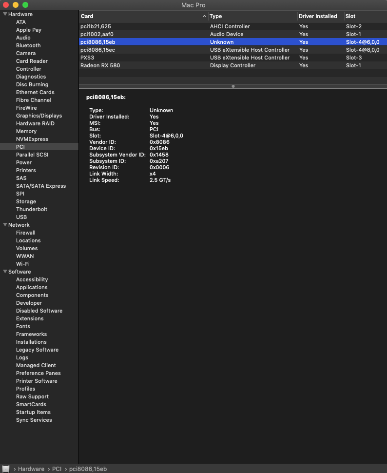

The Titan Ridge is installed in PCI Slot 4 and is seen as Unknown / USB Controller by MacOS. Slot three is a PCIe USB 3.1 card, which works properly.
Screenshots attached.

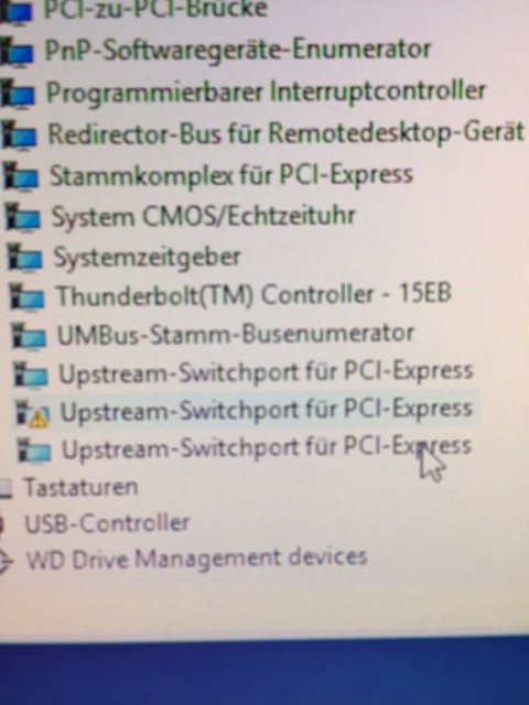

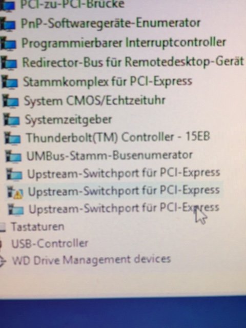

I ran into the same issue and followed these steps to resolve:
This resolved the Yellow Bang Code 31 "PCI Express Upstream Switch Port" issue and now I'm successfully able to connect Apollo Twin Thunderbolt (Silver Edition) to UAD software under Windows.

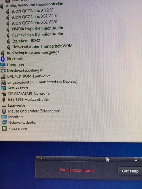

The PCI device is not showing up in Windows or macOS even though the UA Twin Mk II appears in the list of attached Thunderbolt devices. Did you try using the other Thunderbolt 3 port of the GC-TITAN RIDGE?
Can you post a screenshot of the firmware version of the GC-TITAN RIDGE?

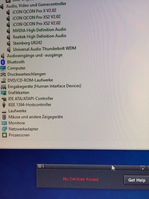

I have the same “no device found” on windows but it’s working perfectly on MacOS. any idea how to use it on windows?
how i do this on mac or win? Firmware Version

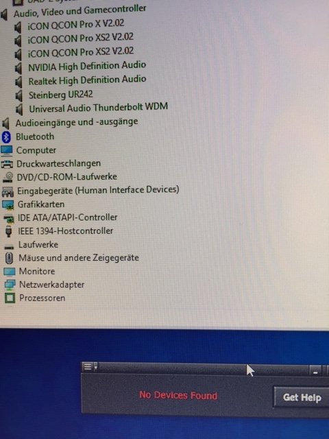

Apollo device manager is looking for the PCIe device. Does Intel Thunderbolt Software show the Thunderbolt device is connected? Once the Thunderbolt device is connected, then you warm boot into Windows to get the PCIe device connected.

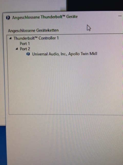

Do it in Windows. One of the options in the Intel Thunderbolt Software will show the connected Thunderbolt controllers and their firmware.
Where do I check that? It’s probably not connected if universal audio device manager sees no device.

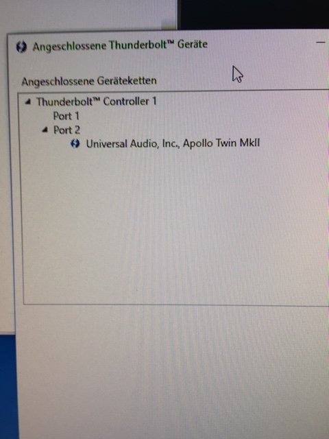

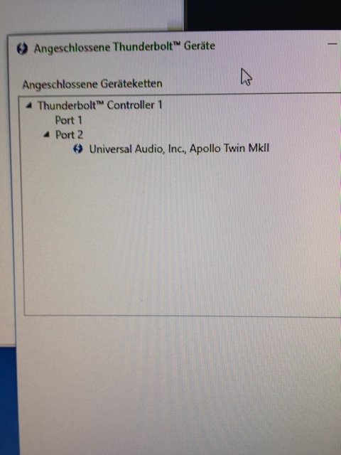

Yes thunderbolt manager shows the apollo twin is connected on port 2.
I’m in Windows. Do you mean once I see this in windows restart back into windows again?
#417
Yes, warm boot back into Windows after you see the Apollo Twin is connected.

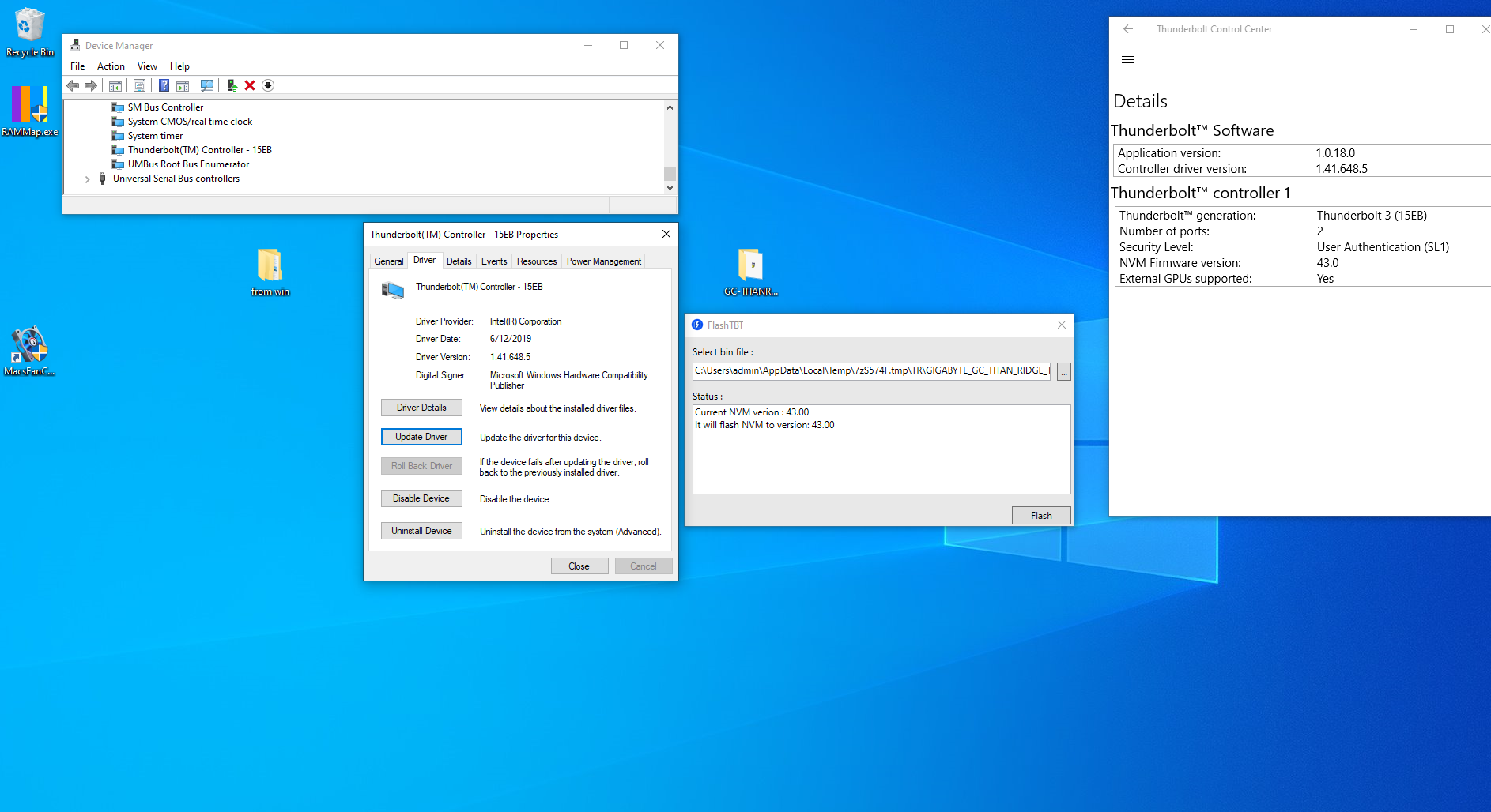

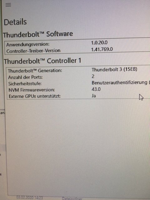

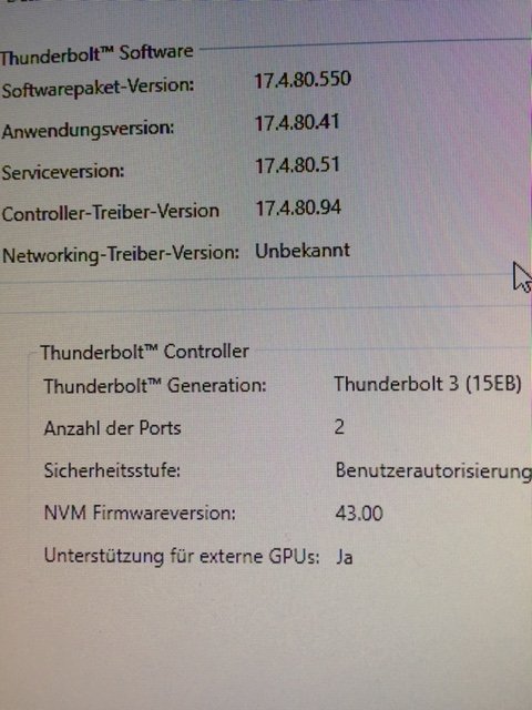

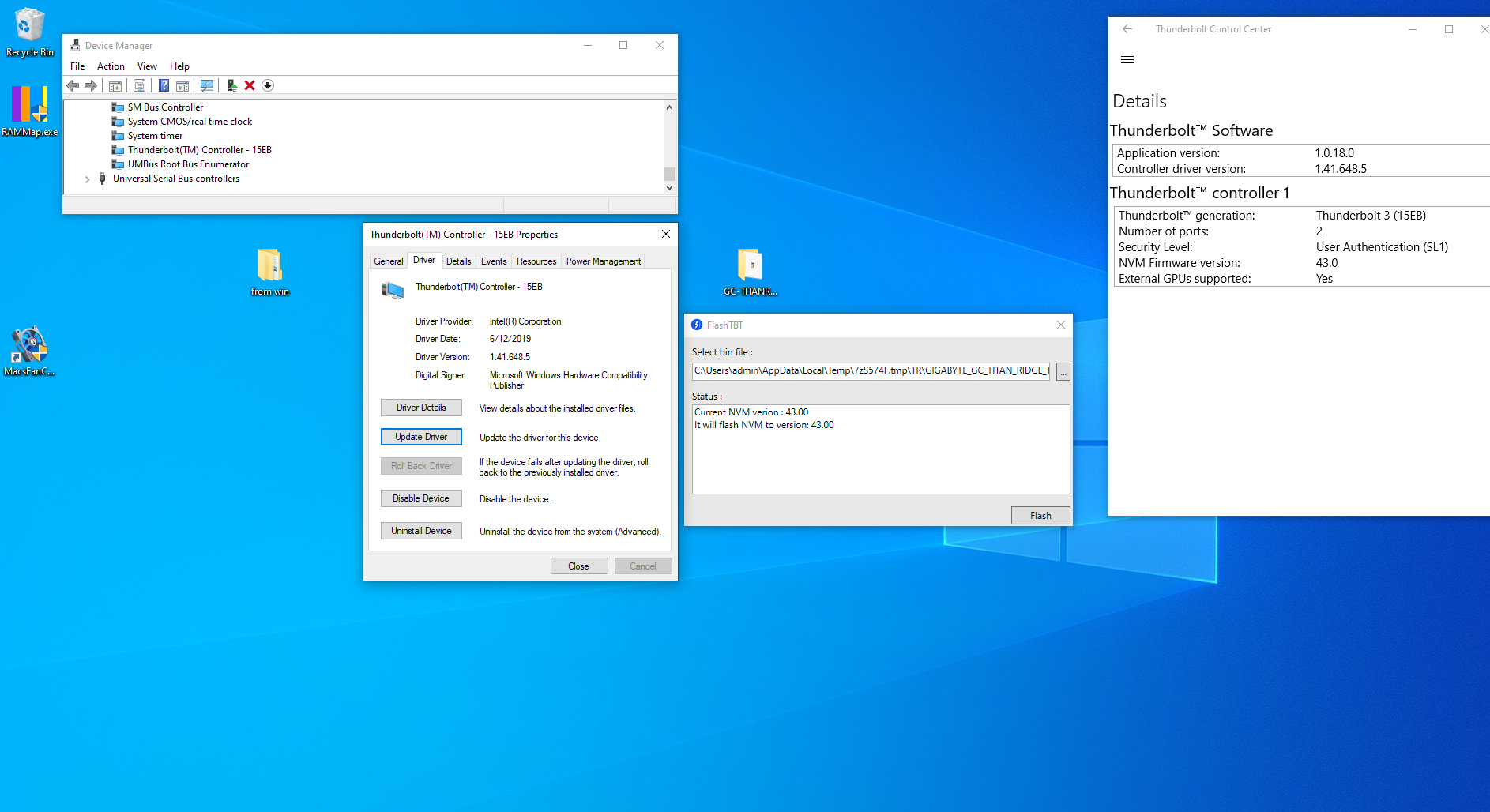

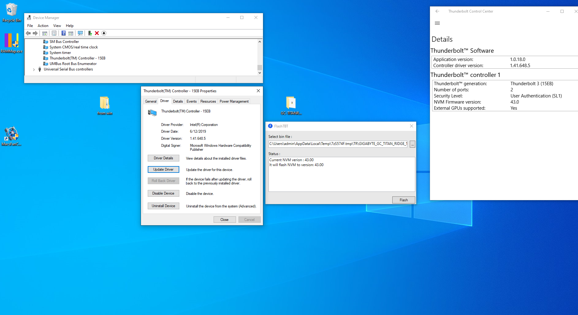

You have NVM Firmware version 43.00
I have NVM Firmware version 23.00
Maybe 43.00 doesn't allow automatic PCIe enumeration and we need to find a way to downgrade the firmware.

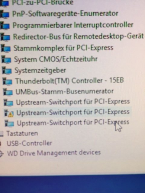

Warm boot did the trick! Apollo is working on both windows and Mac. For the record, I also have an exclamation Mark on one of the pci upstream in device manager. I don’t know which pci it is. So for others who think that might be the issue. It isn’t an issue here. Is it stopping me from any functions I might need?
I’m on firmware version 23.0
In Device Manager, view devices by connection instead of type so you can see the tree layout. Then you need to find out what device that upstream switch is. What's the PCI vendor ID and product ID? What are the parents of the switch? What's the error of the device that has the exclamation mark?

Better not update the firmware until someone says version 43.0 is ok.
I'm on firmware 43.0 and still unable to connect on the mac side and unfortunately no luck in figuring out how to roll back from 43.0 to 23.0. Quick search found another forum reporting same issues with firmware:
I have opened a gigabyte support ticket to request ver23 firmware but doubtful they will release (also mentioned in link provided)
I will post gigabyte's response once I receive an update...

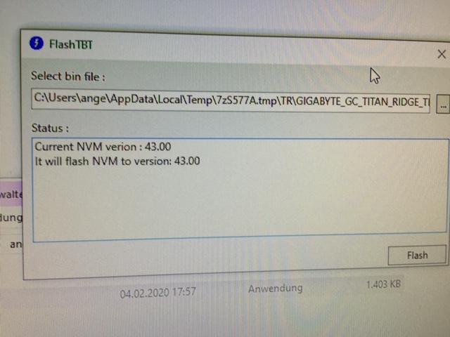

ohhhhh ****.😱
now i have a problem.😟
can i change the firmware with the FWtool from Gigabyte ?
