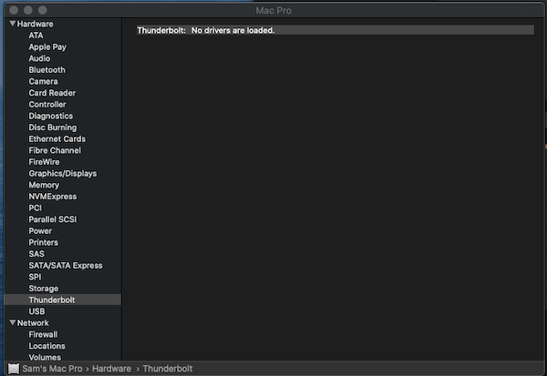

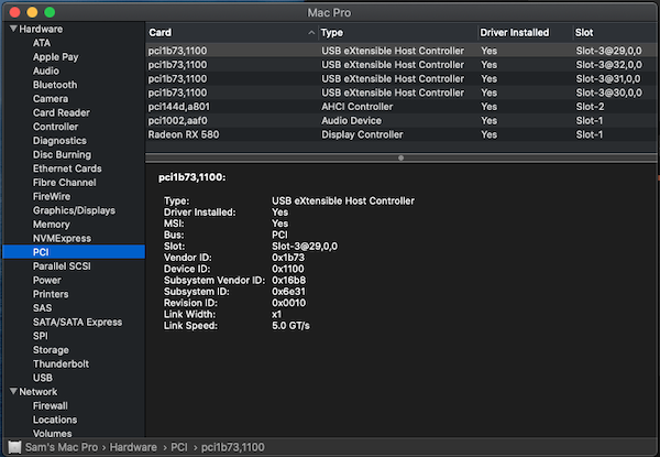

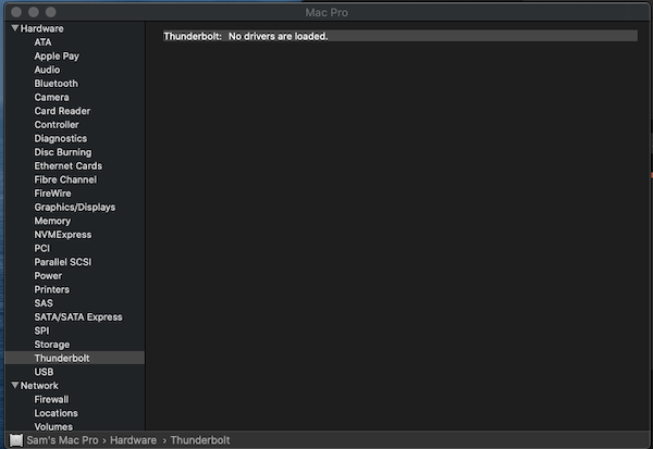

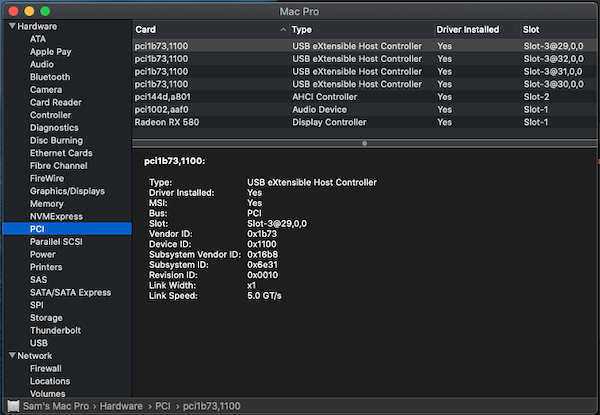

Hello everyone, Im having issues with the Titan Ridge Flashed and a Sonnet 3.2 Allegro Pro pcie card. Two cards don't show correctly, with SSDT-Tbolt3.ami enabled. On my Mac Pro 4.1 flashed to 5.1 with bootrom 144.0.0.0.0
The Titan Ridge is in the 4th slot​
Pins 1 & 3 jumped​
Opencore is setup correctly with SSDT-TBOLT3.aml enabled​
Every thing works fine without the Sonnet card, shows up as thunderbolt device Vender Apple Inc. But with the sonnet card in slot 3 it disables the Titan Ridge. If I place the Titan Ridge in slot 3 it disables the sonnet card this only happens when the SSDT-TBOLT3.aml enabled in opencore.

That's interesting! My sonnet allegro USB 3.0 pcie card shows up absolutely prefect for the 4 SSD drives I'm using with them.
@Mikis @DCswitch no! Alpine Ridge is a totally different chip and no one should try to flash the Titan Ridge firmware to an alpine ridge card... You would brick it!
@safari70 if you use the new firmware you have to create an unique uuid for your DROM.
It will not work with the old ssdt without it.
If you remove the ssdt it should work after warm boot.

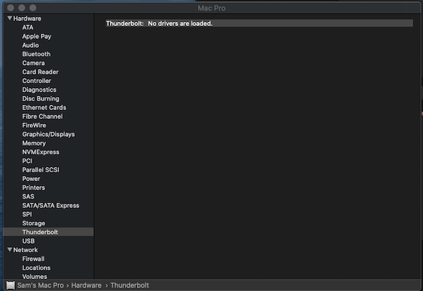

Hello I do not see where exactly we have to put the UUID in that SSDT.
It is not seen as "Titan Ridge USB 3.1 Controller" &
"Intel JHL7540 Titan Ridge USB 3.1"
but as Thunderbolt controller & "USB eXtensible Host-Controller"
I do not know also why we are not getting the 40Gb/s but instead we are getting the 20Gb/s
I am on your latest firmware though.
Where should I put that UUID in (Line?)
Thank you for your help.

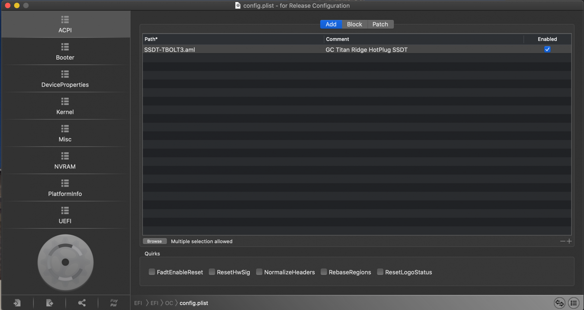

I had similar issue at the beginning and found the SSDT was not injected properly in config.plist. I now use OpenCore Configurator to add:
For UUID info you can read up to learn more (well over my head!):
I'm using OpenCore 0.5.7 with Original DSM2 SSDT-TBOLT3.aml (original UUID config), TR flashed with 2nd release Custom Firmware.
This is all new to me, hope this helps...

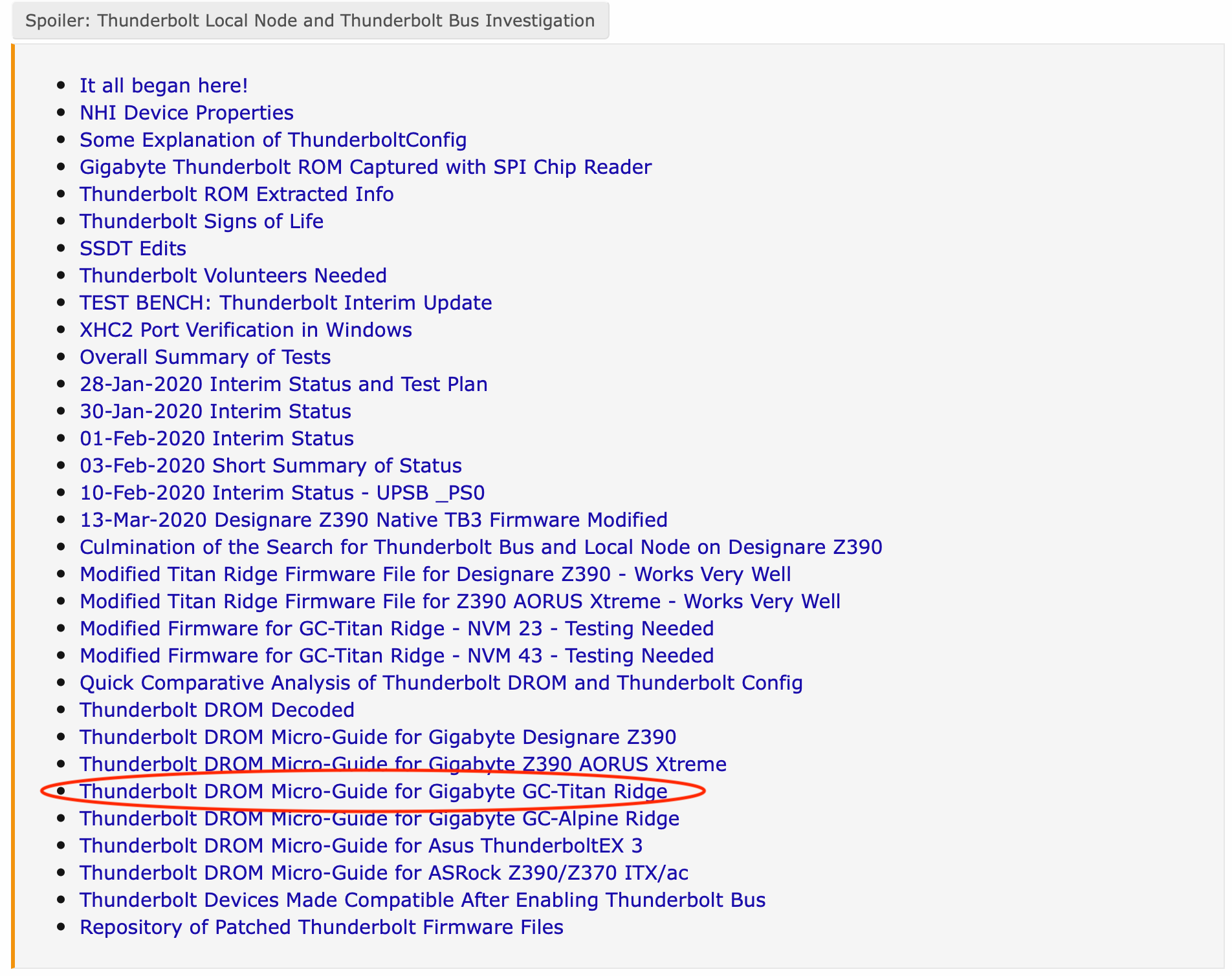

Yes. I just got an x8 and can confirm it's working with the opencore setup DSM posted and DSM's latest firmware. I largely followed this guide: https://github.com/ameyrupji/thunderbolt-macpro-5-1/blob/master/GC-TitanRidge.md

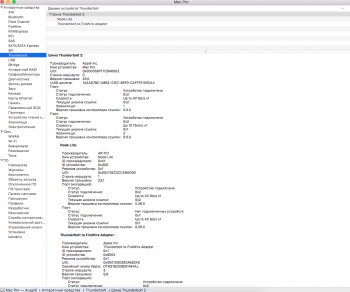

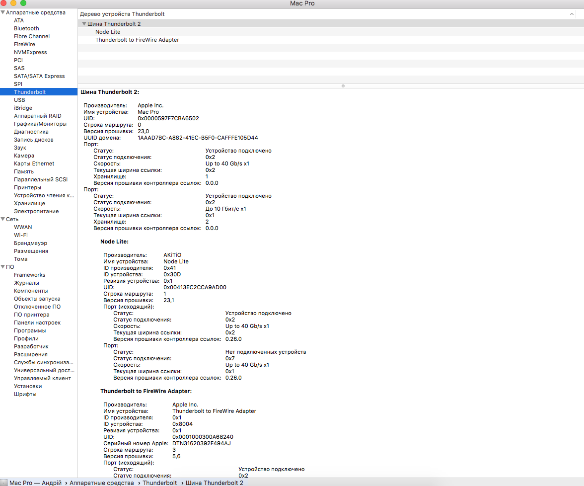

Hello everyone! Sorry for the crooked translation. I use Google translate.
Today I reflashed my Gigabyte Titan Range v1.0, and I am pleased with the result. Thank you all! 🙂
Аor the performance test I used Akitio Node Lite TB3 and Digidesign 002 Rack (Firewire through adapters to TB3) - and my sound card is working stably.
I have a question - will work UA Apollo x4 (TB3)? Now there is no way to test yourself
Thanks again! You are the best
