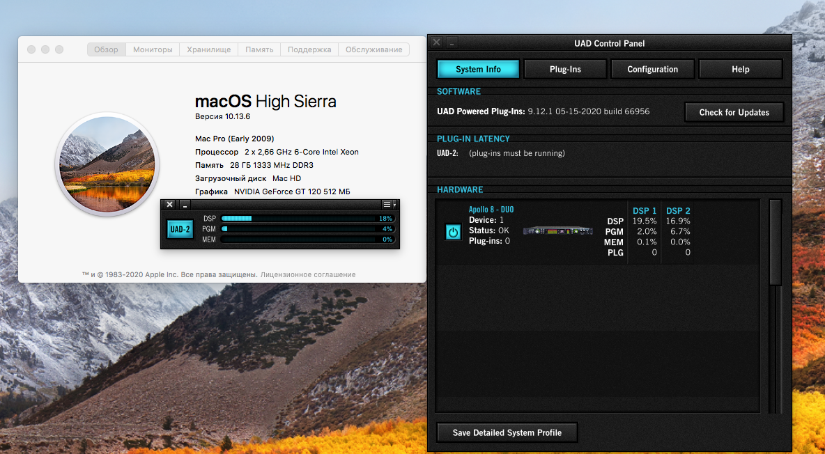

Opencore at boot does not see the bootcamp sections :( How can I fix this? So how do I need to switch to windows
The method "select boot disk" from the settings of the Mac OS - does not work, because everything is stuck on the opencore bootloader
[automerge]1590355675[/automerge]
on macOS works great. Thank!

See this thread: MP 1,1-5,1 OpenCore on the Mac Pro which has several discussions of handling Windows bootcamp.

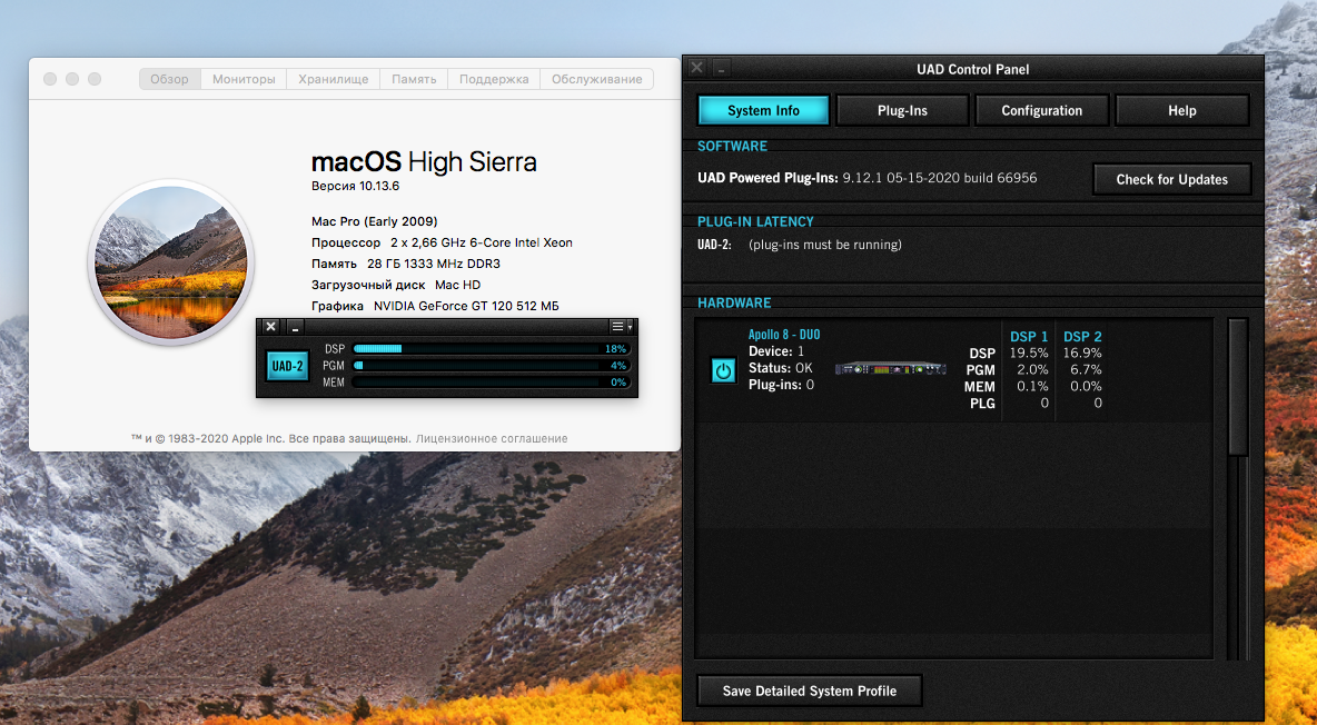

I’m doing an overhaul on my 2009 4,1=>5,1 cMP. This weekend I had installed OpenCore and flashed my Titan Ridge card to be able to run my Universal Audio Apollo natively. I just finished install a pair of 6-core 3.33GHz x5680 CPUs and now I can’t get my Apollo to connect. Has anyone dealt with this before?

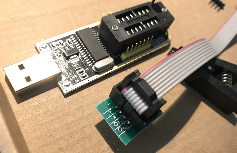

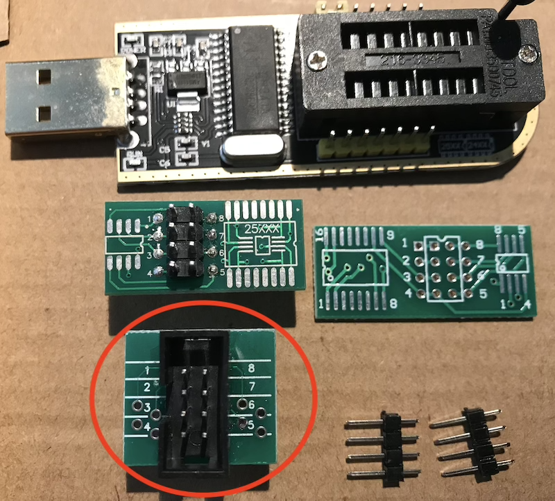

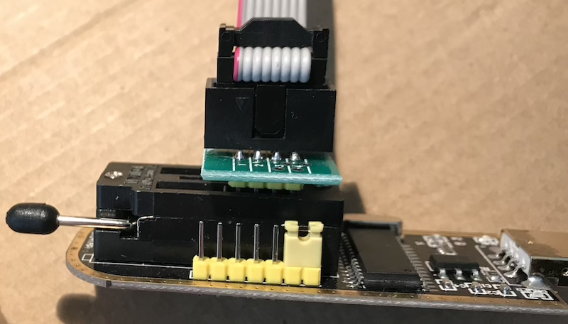

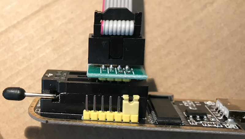

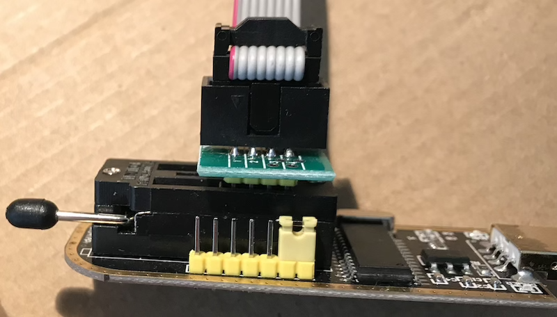

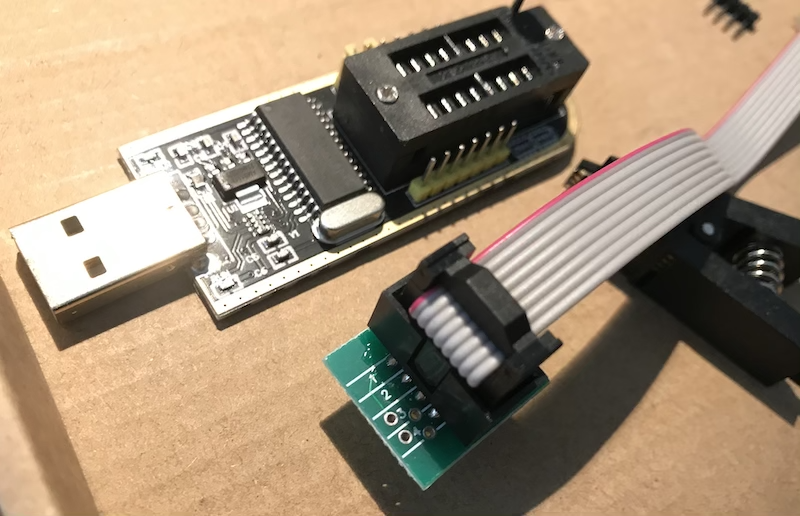

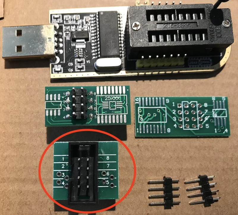

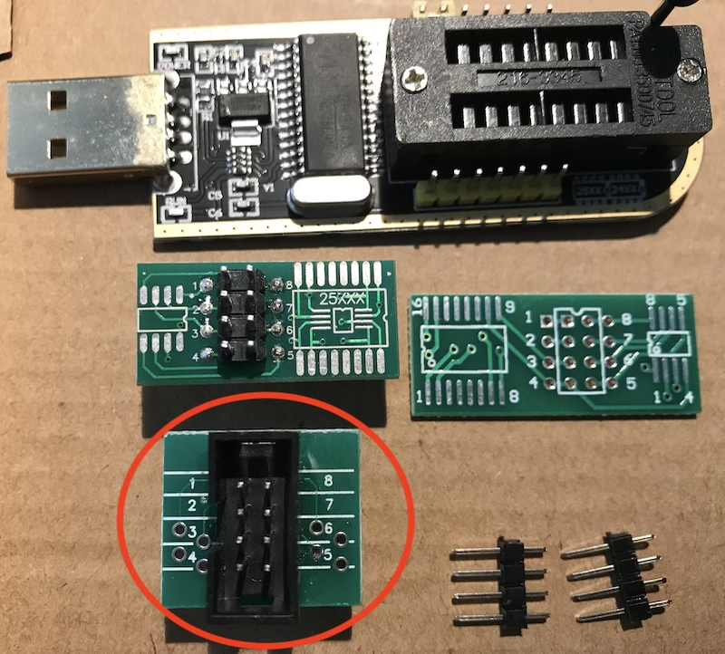

The EEPROM programming tool in your photos look very similar to the one I have. Except I use a different connector board for attaching the clip. I am not sure if this makes any difference in functionality, properly not though. I repeatedly flashed and verified different rom versions to my Titan Ridge card with this unmodified set-up, after measuring the voltage between pin 1 and 5 to be a little under V3.3 The card is working fine, tested with video through-put from RX580 to a Thunderbolt connected LG UltraFine 5K display.
View attachment 915346 View attachment 915347 View attachment 915348
