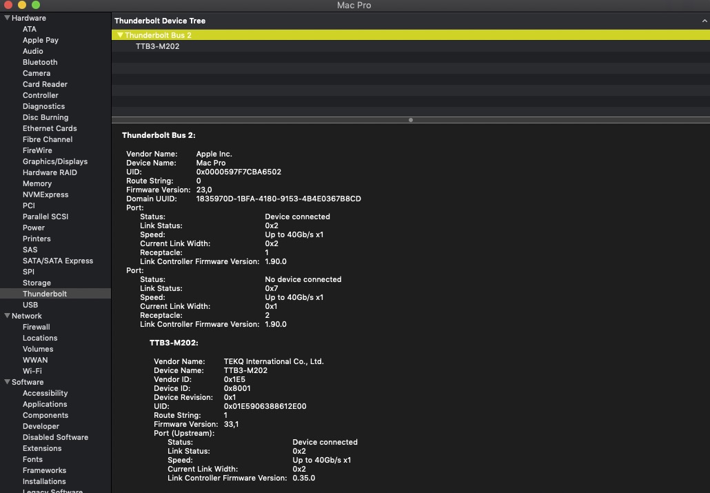

a flashed titan ridge card need OC 0.5.6 with SSDT file and set in the config.
if you use the SSDT file from DSM2, it must be in slot4!
the device must be connected during coldboot, unplug > replug and after a warmboot you will see
your device

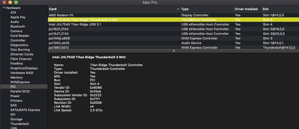

Is there any way I can test whether the Titan Ridge card installed in my cMP 5,1 is just dead?
Details:
The Titan Ridge was working great. Now, not at all, in either Mojave OR Windows 10. I can't dual boot anymore either, IMO because I have 2 security certificates in my boot rom. Could this cause the Titan Ridge card not to work also? (I use for external drives only, no eGPU).
More Details:
Because of 2 security certificates, I have to physically remove Mojave NVME card to get into Windows now. Replace it and it boots back into Mojave.
Thunderbolt control center in Windows 10 wasn't detecting the Titan Ridge either, and drives I plugged in weren't showing up.
My setup is:
cMP 5,1
Mojave NVME PCI boot drive, Windows 10 on SSD in slot 1.
RX580
Titan Ridge
