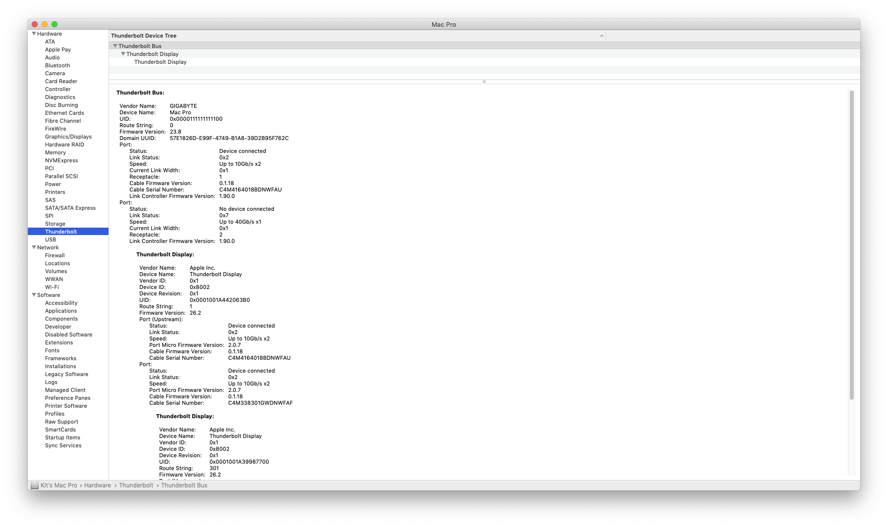

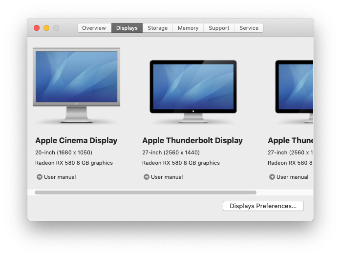

Hi Joevt;
I managed to get the Display working with TB3 in MacOS this evening. I have been playing around with a lot of variables, so now I need to hone in and get it working better.
The first problem I solved today was that if I use a SSDT for Slot 2, and I move my Titan Ridge there, it no longer interferes with the RAID card. It didn't work either, but no longer interferes.
The second change I made today was I switched back to the v33 Firmware, seeing as I had nothing but bad luck with the v50 firmware yesterday. I also switched the order of what DisplayPort on the GPU goes to which part on the Titan Ridge, but I don’t know if this made a difference.
The last change I did was switch from the "Nico" SSDT that was originally shared here, to one of the derivative SSDT's provided from Hackintosh folks, after discovering this thread. Originally I thought our "SSDT-TBOLT3" was a derivative product of some of the SSDT's they are using, and I wanted to find it's origin so I could diff any changes specific to our hardware, but then I realized our "Nico" SSDT was the original that they have modified, so I took one of theirs and changed the addresses to work in a cMP in Slot 2.
To get things working how I want, I cold boot, and then I plug the monitor into power, giving me video output but no Thunderbolt / USB devices. Then I reboot, and one again no video output and things are a stutter show in MacOS, but the FaceTime camera and USB devices are all attached. Then this time, I unpowered the monitor for 10 seconds and re-attached it to power, and I got video output PLUS FaceTime, Brightness, Speakers, USB etc.
I am not sure why I have turn the monitor essentially off and back on again for this to work, and it would be nice if "hot plug" just worked. I’ve tested these SSDT’s in slot 3 but they also interfere with the RAID card - I just won't have the option for a HighPoint expansion card down the road but this is OK.
