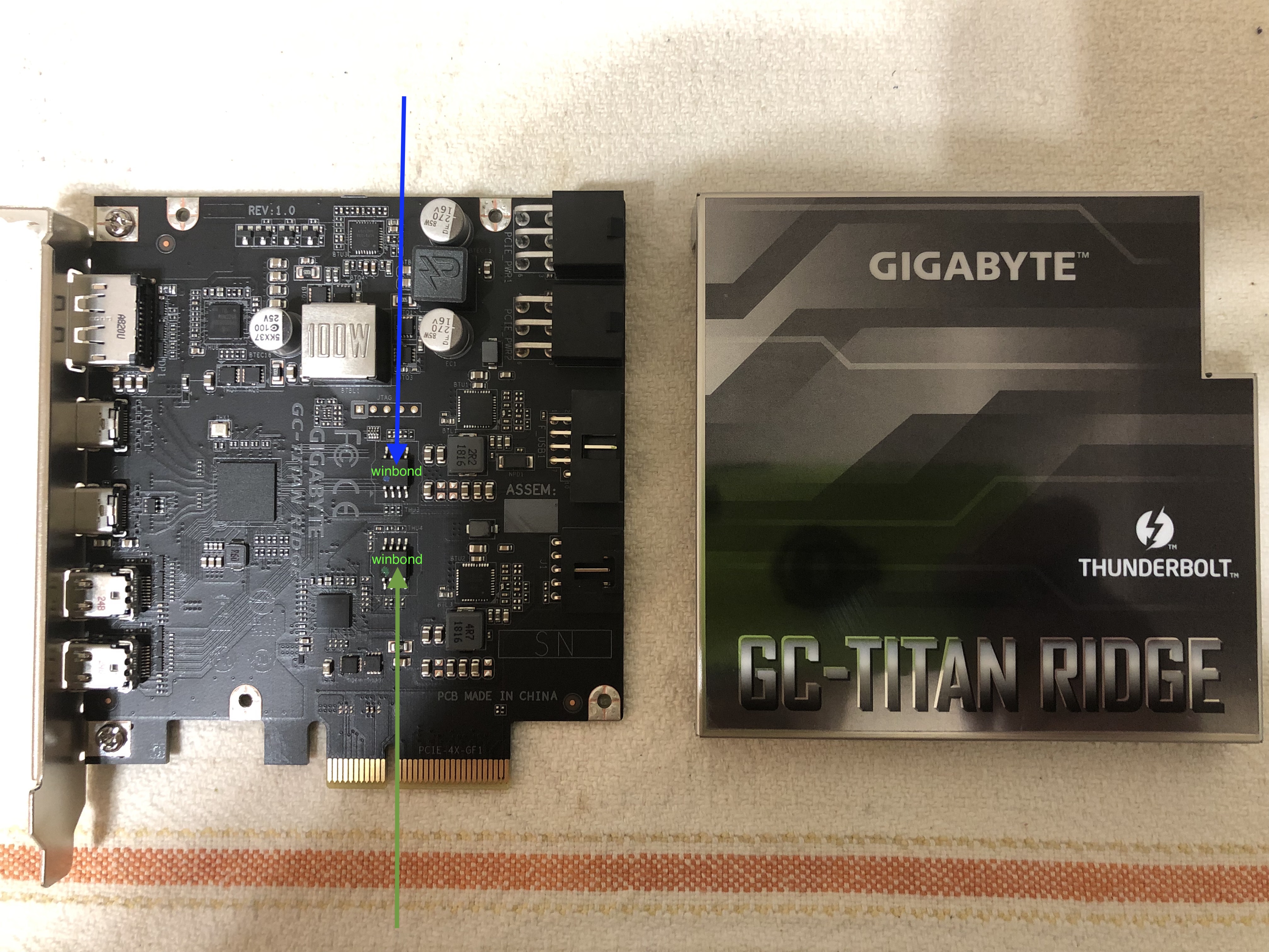

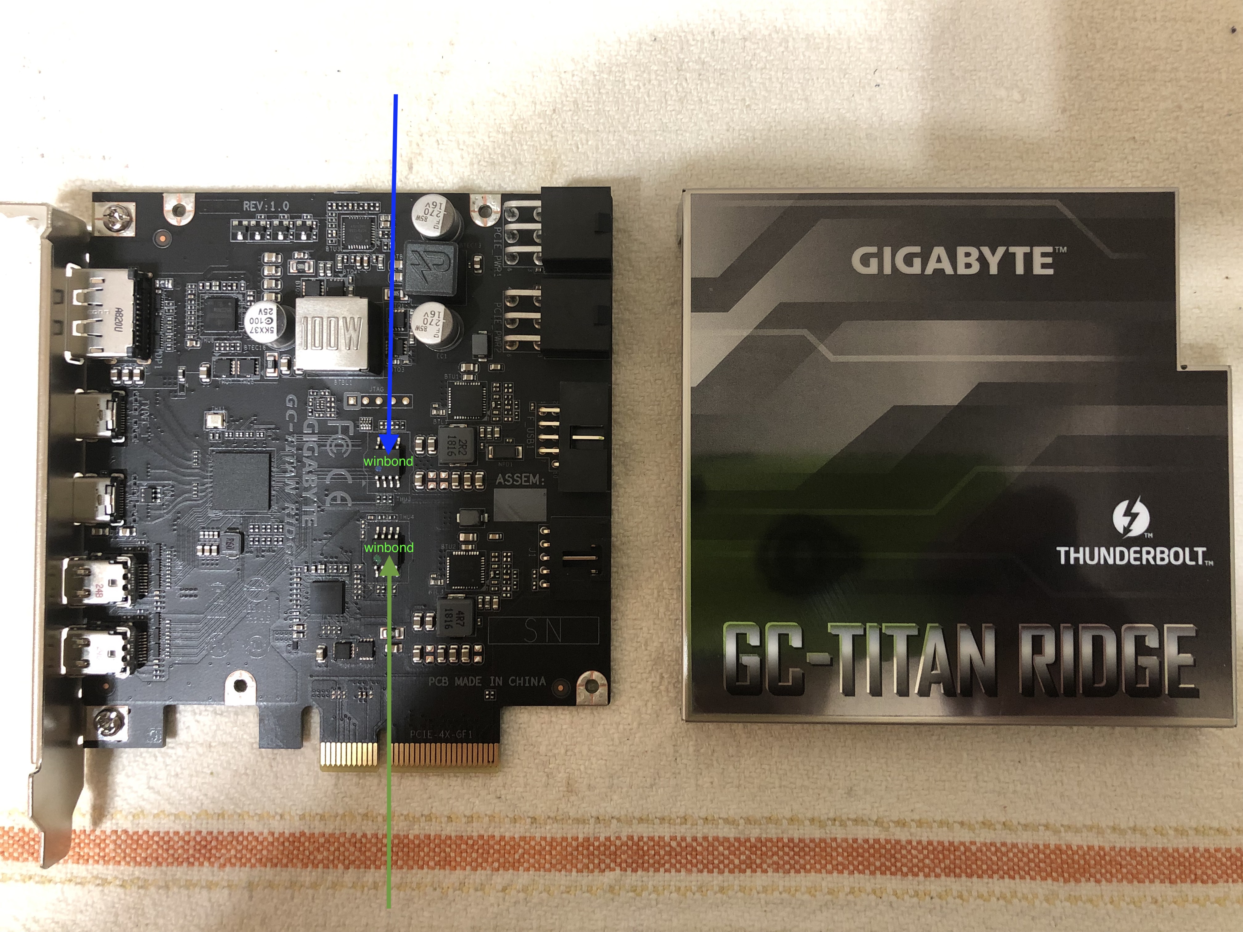

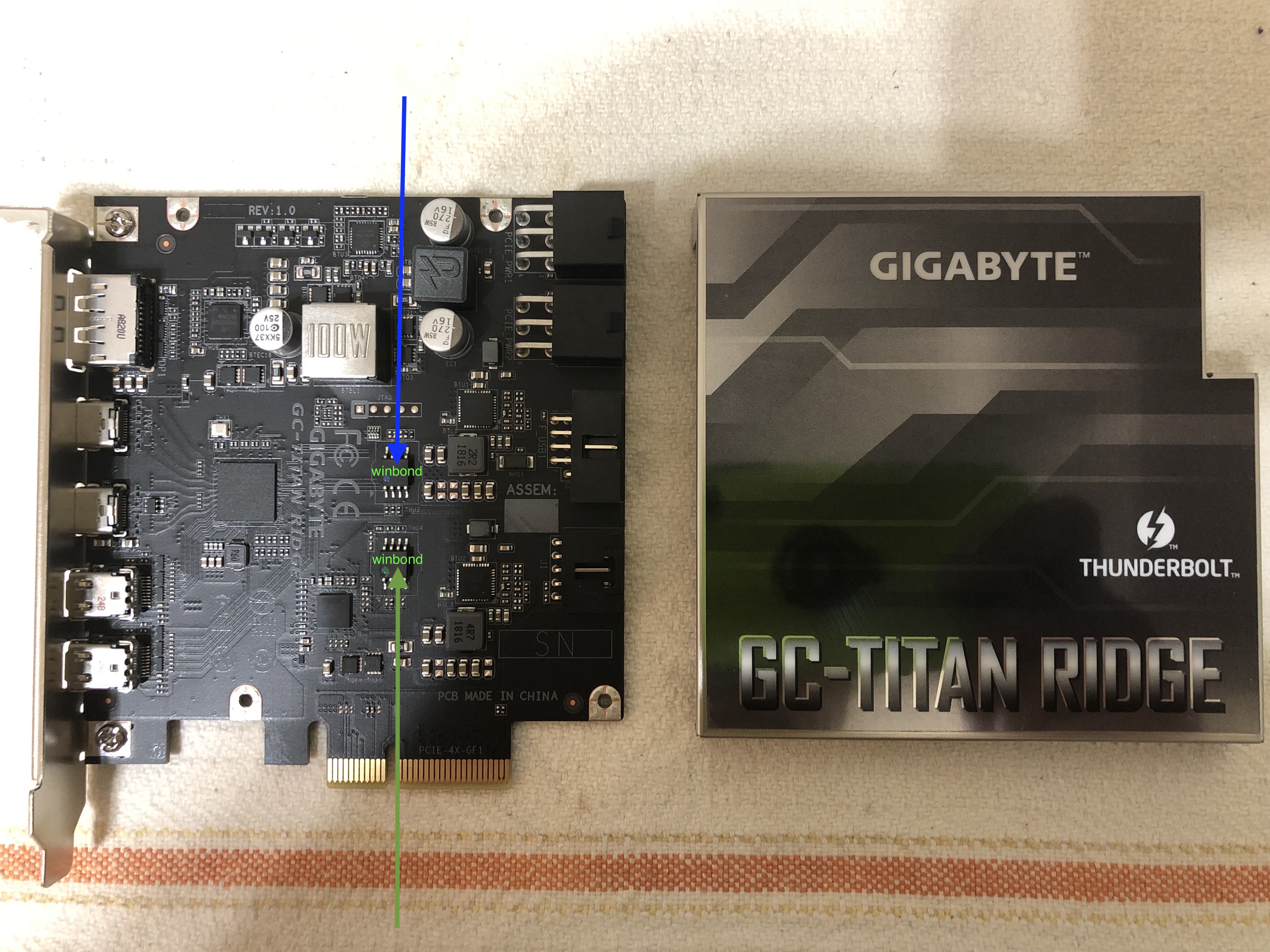

I got myself a really cheap Titan Ridge GC at a very good price could not resist and bought it, here a picture of what's on the PCB..
Now need to test under Mojave.
I want to see what in the Winbond chips... especially the one that has the green dot.. which I think is the rom...
the eGPU.io website has many pictures of Thunderbolt devices including the GC-TITAN RIDGE. Everyone of them has a windbond chip for the Thunderbolt firmware (and probably NVM storage?) I don't know why the GC-TITAN RIDGE has two of them.
