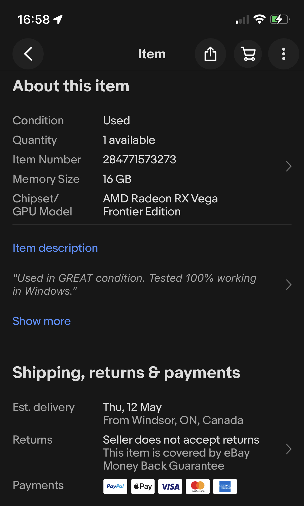

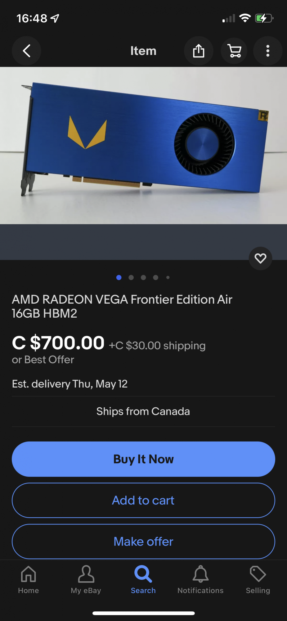

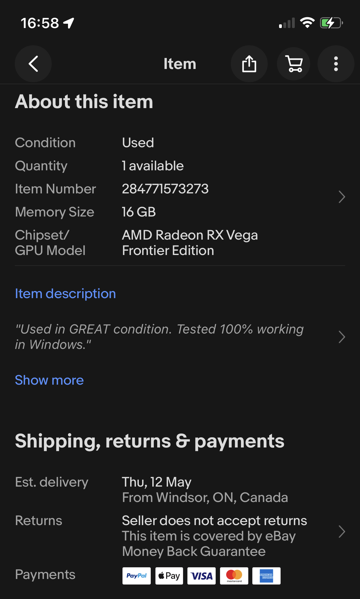

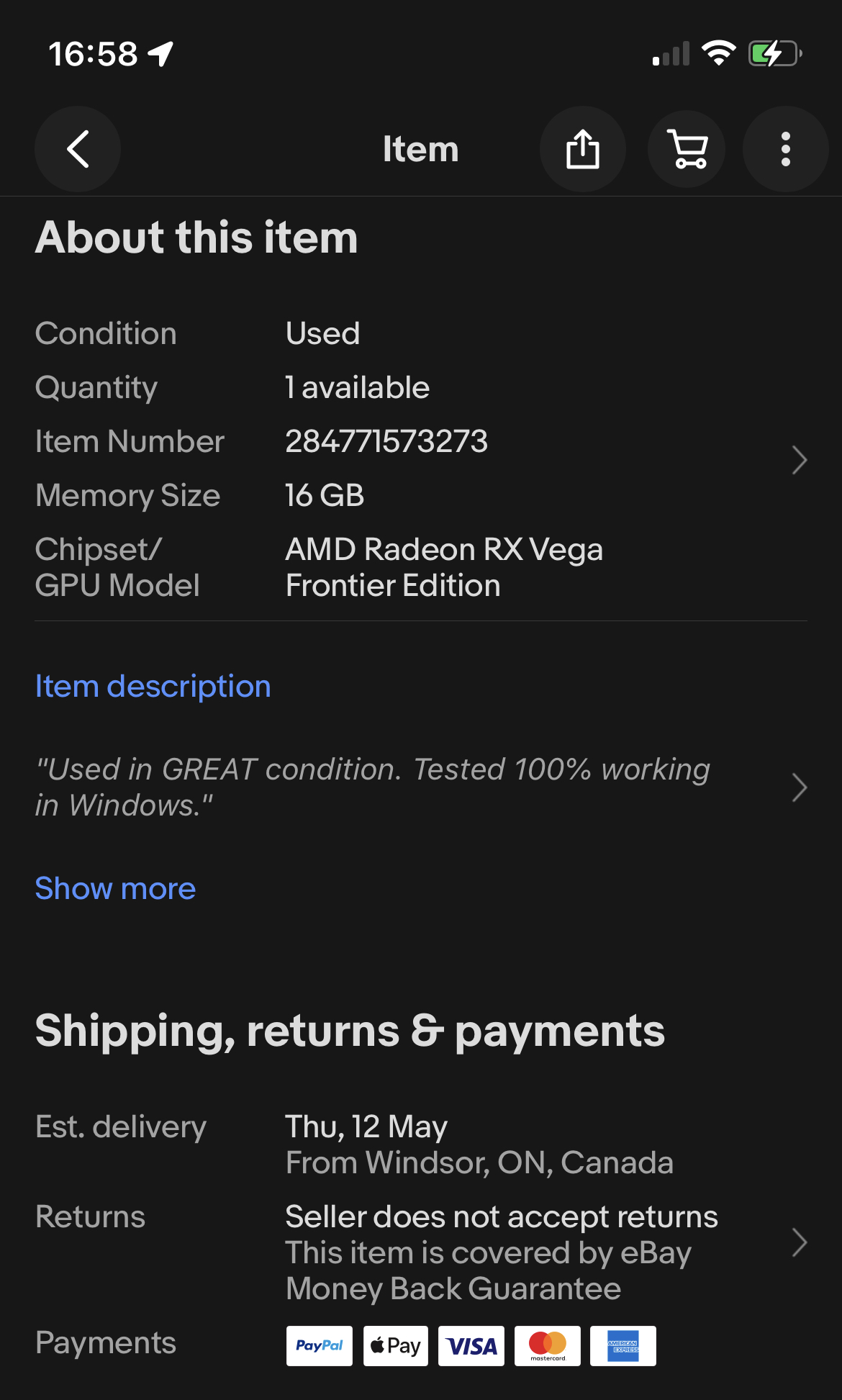

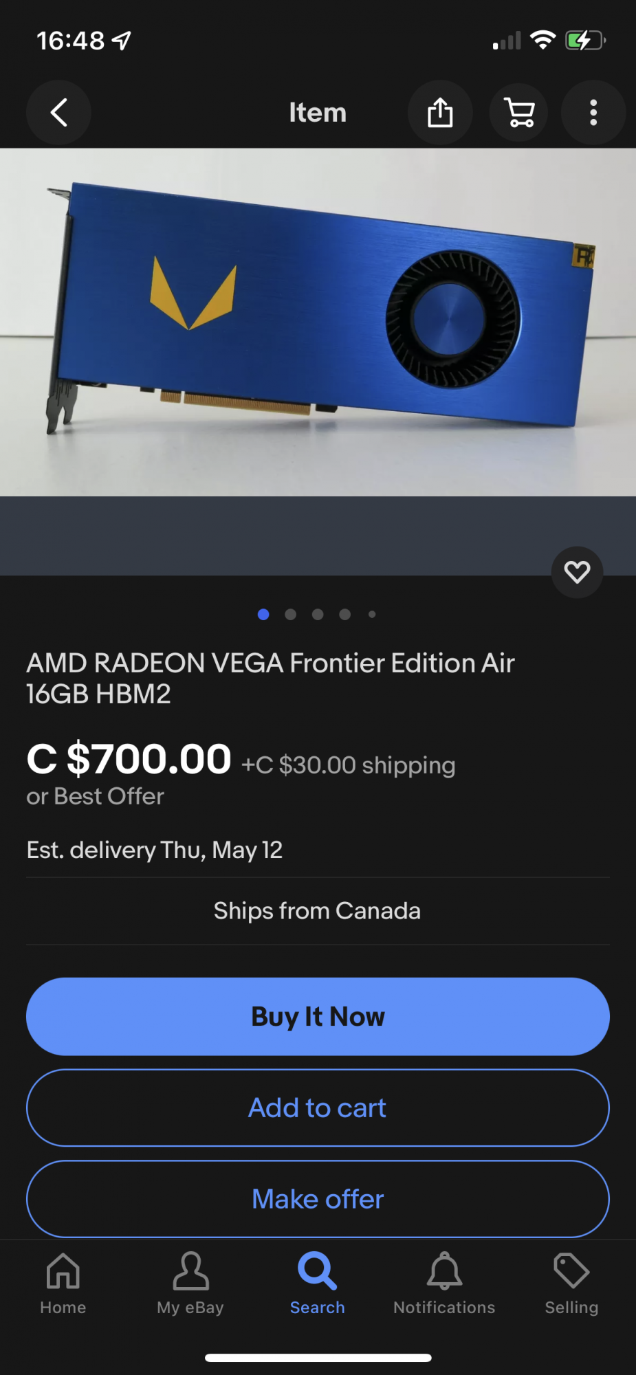

I just took a look at my saved searches that only look in Canada (no import taxes and free or $20-$30 express shipping…
Look what just popped and he’s open to talk 😭😭 If I had waited to order my RX 6600… it’s not taxable so basically 140$ more than the RX 6600 for almost twice the power 🤦‍♂️ Someone go buy it… my bank converted it at $548 USD 🤣 515 €
I bought for a little over $2500 of hardware with the used Mac Pro 6,1 the 12 cores E5-2697 v2 and 64Gb memory kit, the Razer Core X Chroms, the 2 GC-Titan Ridge V2 cards for my 2 MP 5,1 with the second hand Sonnet RX 560 eGPU Puck, 2 2.5 ft TB3 cables, 2 Apple TB3 <-> TB2 converters, the RX 580 I got 2 months ago and RX 6600. I need to take a break before the next GPU 😆 take it away guys 🥴🤕🤣 I got into this too deep 🤪
