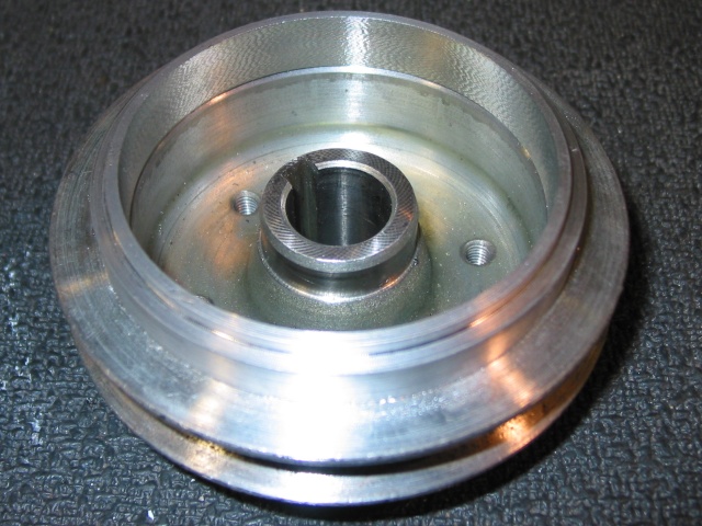

Since this engine had mechanical fuel injection there were no "sensors" for anything. No crank position sensor and no cam position sensor (since it used a regular distributor for ignition). We also had to fabricate these.

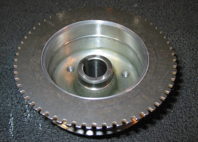

Factory crank pulley with a "lip" machined into the top.
The 60-2 trigger wheel pressed onto the pully (also later spot welded to make sure it stays put).

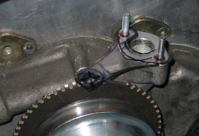

Trigger wheel mounted on engine and using plastic to make a template for the crank sensor mount.

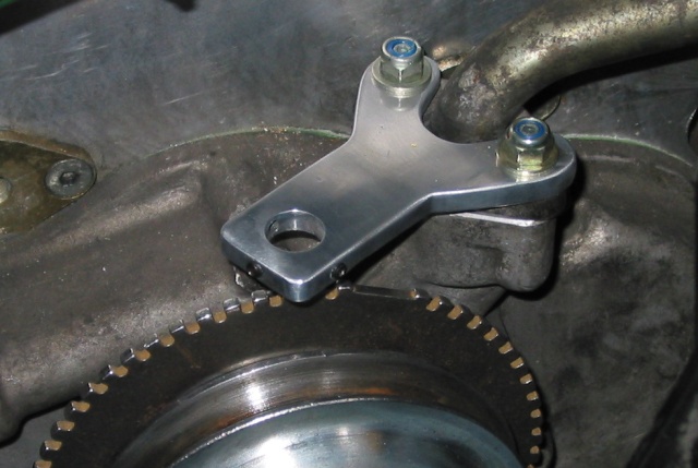

Aluminum crank sensor mount.

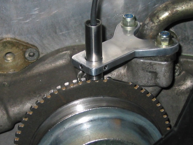

Crank sensor installed into mount.

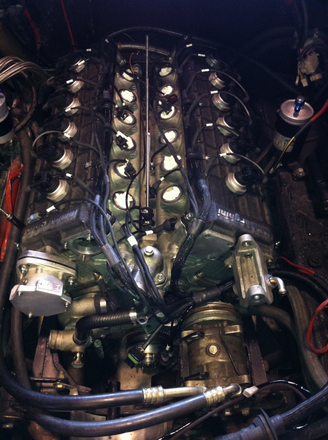

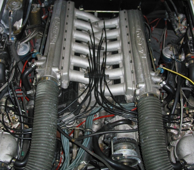

The very messy stock engine bay.
Test fitting the wiring harness.

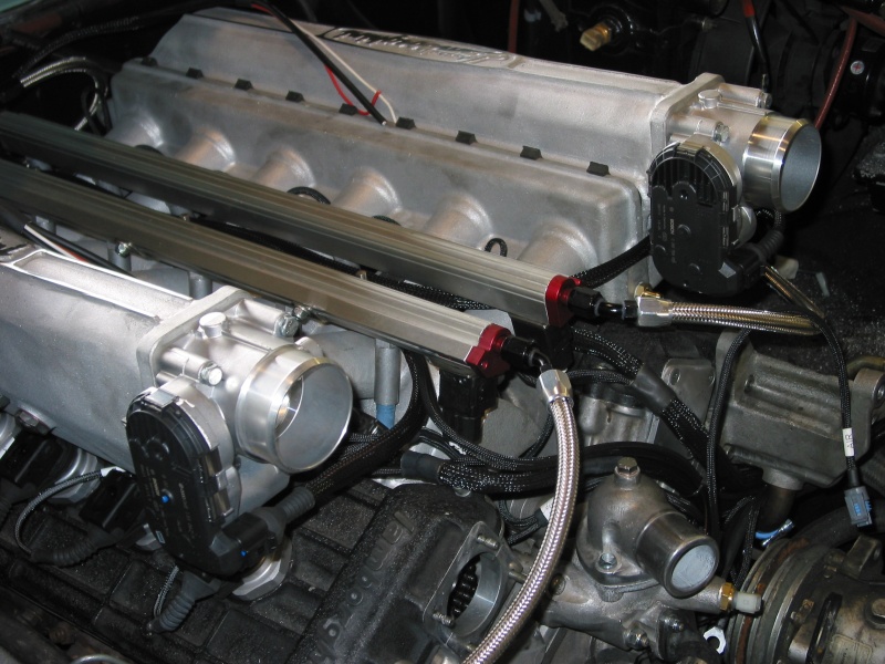

Another shot of the manifold showing the drive-by-wire throttles.

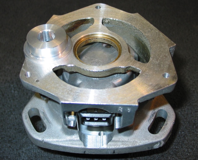

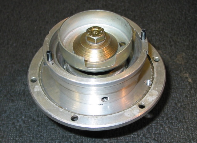

The disassembled distributor with the cam sensor wheel installed.
Distributor with cam sensor installed and hole machined into side to allow for electrical connector. The aluminum "plug" on the left is what holds the sensor in place.

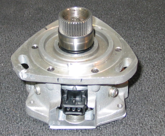

Back side of the distributor. A little bit of overkill on Lamborghini's part to have such a heavy-duty splined connection to the camshaft to drive the distributor.

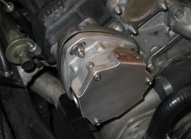

"Distributor" mounted on engine. We wanted to retain some of the original which is why we turned the distributor into a cam sensor instead of just mounting one hidden away in the valve cover somewhere. We even kept the Marelli plate.

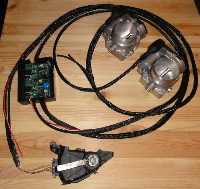

This is the drive-by-wire throttle controller I made specifically for this vehicle. While some aftermarket ECUs support drive-by-wire throttles, it gets expensive to find one that supports dual throttles. So I built one instead.
This is where it gets technical (apologies to those who don't understand engine electronics - ask away if you have any questions).
  • The throttles are originally for VW/Audi. Typical DBW throttles with 6 wires - 2 for the motor, 5V, GND and 2 signal wires for the throttle position sensors. Vehicles with DBW throttles typically have a pair of sensors for safety/redundancy. If there's a discrepancy between the sensors the ECU would typically cut power to the throttle and the engine will run in limp mode.
  • The voltage output for the sensors in these particular throttles is appx 0.5V to 4.5V for one sensor and 4.5V to 0.5V for the other for 0-100% throttle position. This makes it really easy to check for plausibility of the two signals as they should give you 5.0V when added together.
  • The accelerator pedal is from an Audi A4. The pedal was removed and a small arm fabricated that would allow connection to the factory pedal via a linkage.
  • I used two commercially available servo motor drivers to operate the throttles. However, they have only the most basic built in protections (over voltage, temperature, motor short circuit and so on). They have no redundancy features. Safety is critical in DBW throttles, so I built a custom controller. There are a pair of micro-controllers used to control the throttles.
  • The master micro-controller reads the value of all the sensors/inputs and calculates the throttle position. It then commands the servo drivers to move the motors to the correct position. If any faults are detected it sends a disable signal to the servo drivers to cut power to the motors. If the throttle position returns to rest nothing further happens. If the throttle doesn't immediately return to rest, there are secondary relays that physically cut the power to the throttles. This gives me two separate methods to cut power in case of any issues.
  • The secondary micro-controller does nothing except monitor all the sensors/inputs. It doesn't control anything. If it detects any faults it also has the ability to send a disable signal to the servo drivers and also to turn off the relays.
  • Finally there's a third redundancy feature separate from the micro-controllers. A simple voltage summing amplifier and comparator monitors the throttle and accelerator pedal voltages. If they exceed a maximum allowable difference (0.2V is what I decided on) they can turn off the relays to cut power to the throttles.
  • Since the ECU doesn't support DBW throttles, I also needed to find a way to make it work with my controller. The two primary areas I needed to be compatible with are throttle position and idle air control.
  • For throttle position the controller sends out a 0-5V signal (programmable for range) to the ECU. This "simulates" the typical TPS signal from a normal throttle body. For idle my controller has an input for a typical solenoid controlled idle air valve. It measures this signal to determine if the idle speed should be increased/decreased and then adjusts the DBW throttles in very fine increments to regulate idle speed. Bottom line - the ECU has no idea the engine has DBW throttles. It gets its TPS signal and controls idle as it would with an engine using a mechanical throttle system.
  • Two other features added in are the valet switch and throttle curve switch. Valet is pretty self-explanatory - maximum engine power is limited by preventing the throttles from going past 20%. The throttle curve switch controls how fast the throttles respond to pedal inputs. There are three settings from mild to wild. ;)
