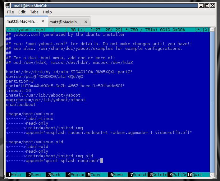

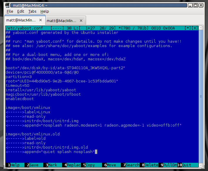

@0403979 : Try booting from yaboot with these: Linux nosplash radeon.modeset=1 radeon.agpmode=-1 video=offb:eek:ff
If that works, (this worked on my macmini-g4) once booted, sudo nano /etc/yaboot.conf and add those to the "append" line (replacing the original line). Then run sudo ybin -v and reboot. Those settings will be saved and will stick for future boots.
Cheers

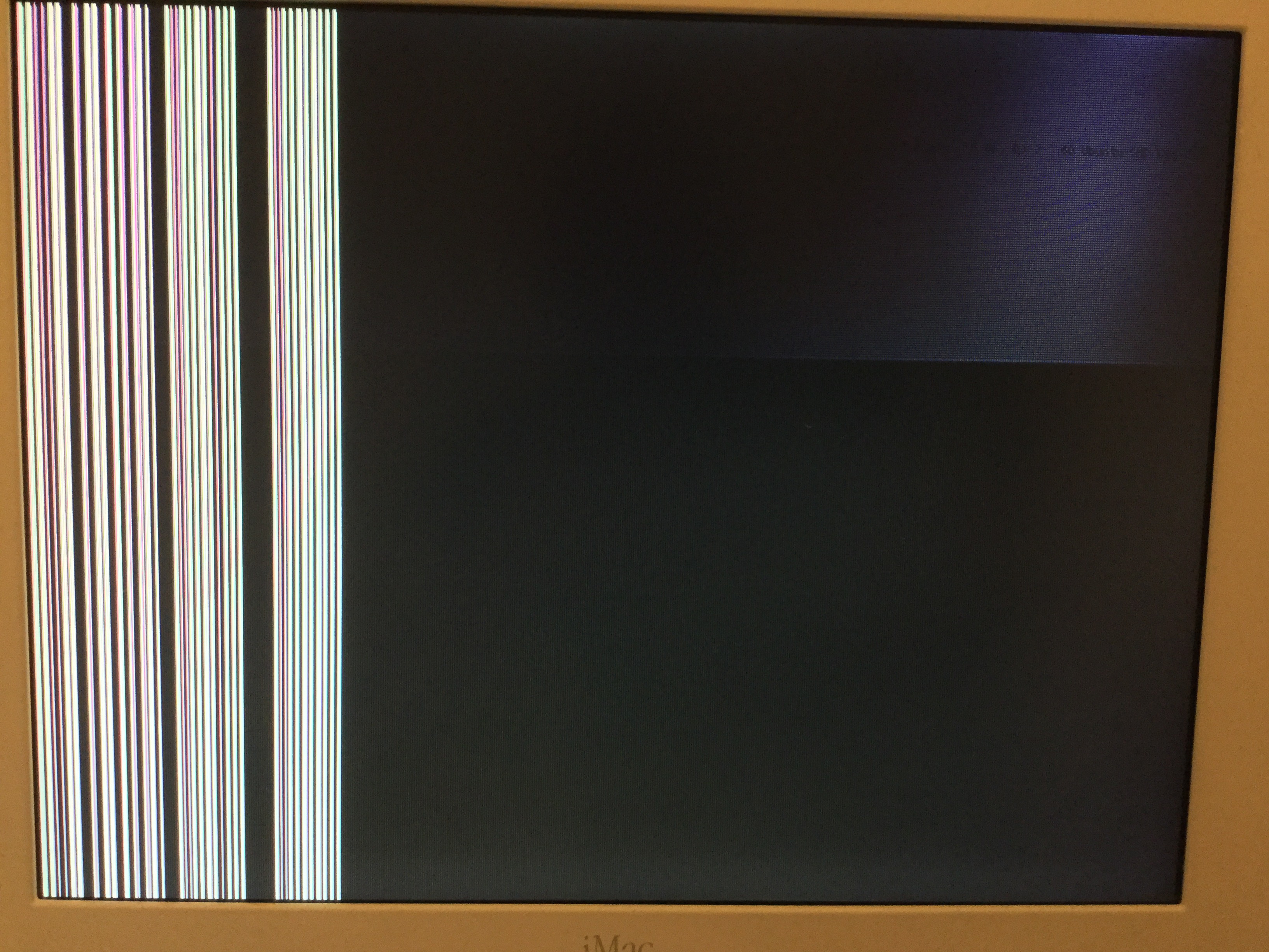

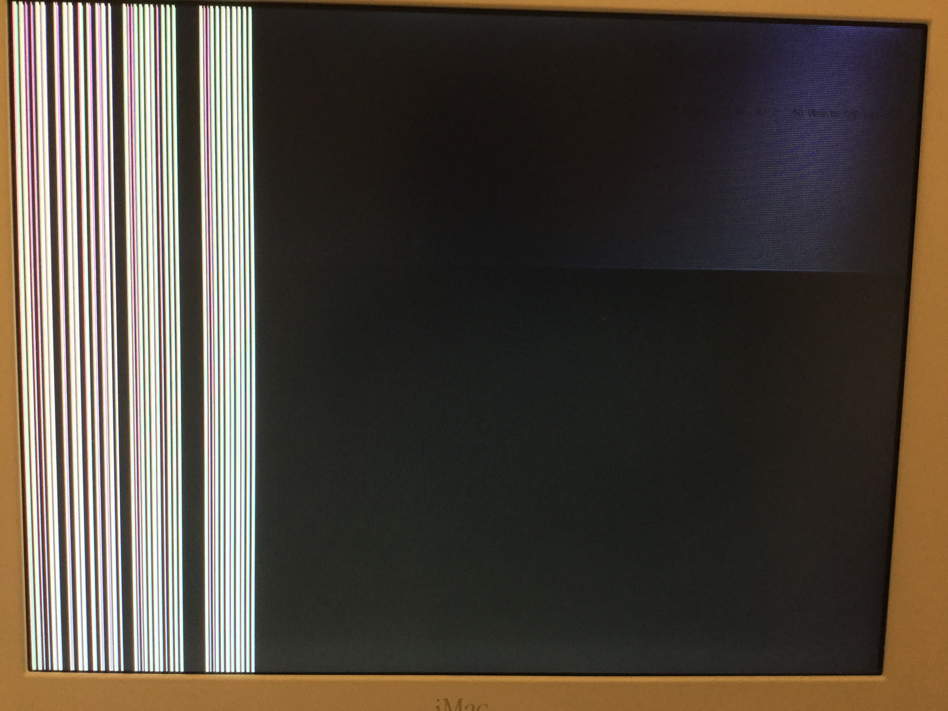

EDIT: Here's a screenshot for better reference

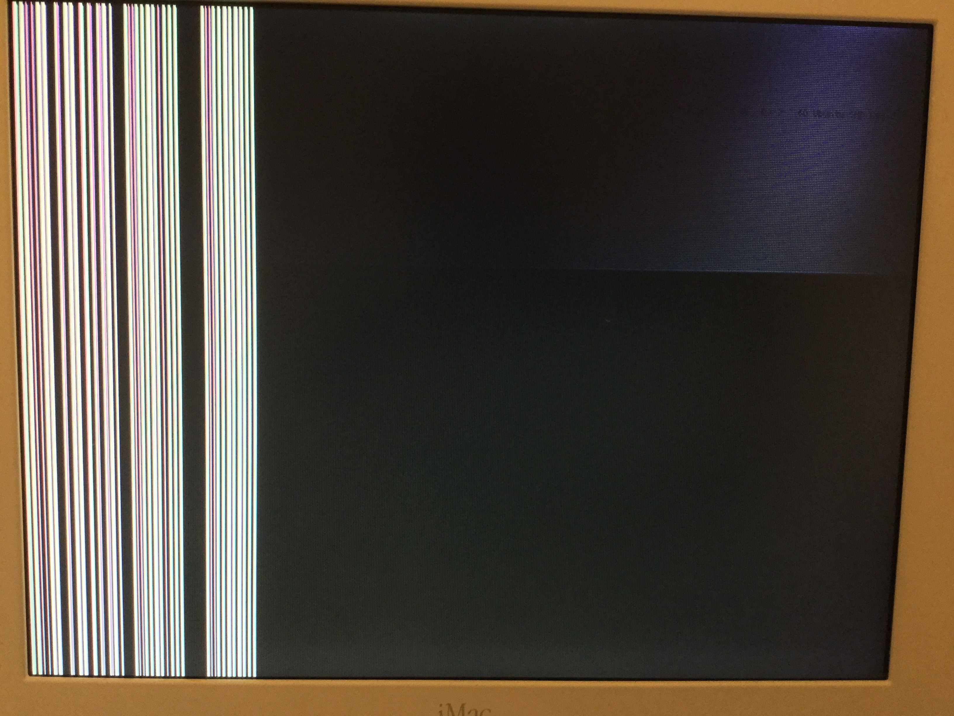

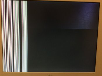

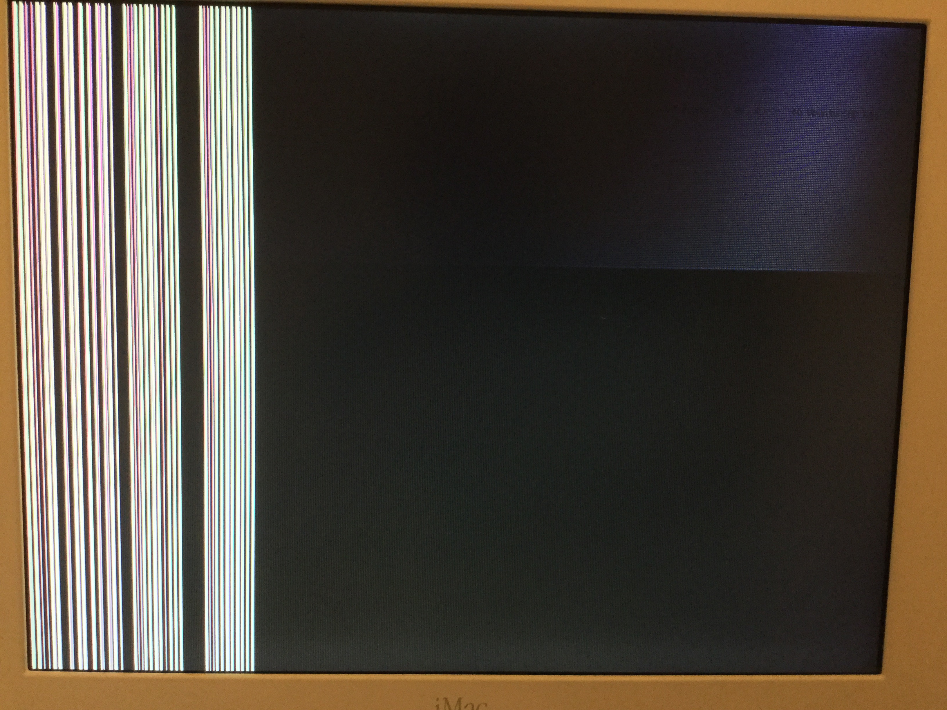

This doesn’t work. Same issue with the (sometimes obstructed) broken animation that fades to black.
Any ideas about how I might solve the VLC issue? Every player is behaving the same way, so it seems to be bigger than just VLC.
Aside from that issue, things are working nearly 100% at this point.
