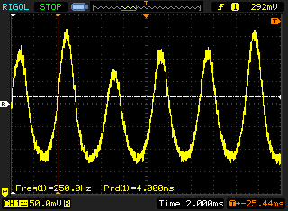

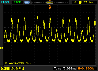

Per Notebookcheck, “The panel in our review unit flickers between 122.5 and 250 Hz, which is low enough to cause issues for those who are PWM sensitive. Likewise, the panel flickers at 60 Hz at 100%, so we would recommend trying the Note 10+ before buying it if you know you are PWM sensitive. Samsung does not include any special dimming features such as DC dimming as Huawei and OnePlus do with some of their flagships.”
The PWM curve itself at 250Hz appears fairly similar to iPhone 12 Pro Max:
Note 10+
iPhone 12 Pro Max
I’m not sure if they zoomed in more on the iPhone, but it appears that the Note 10+ has a more shallow PWM curve which should lead to less issues.
Edit: it does appear more zoomed in on the iPhone since they measured a timeframe of 2ms on the Note vs 5ms on the iPhone. They are incredibly similar, but not identical.
