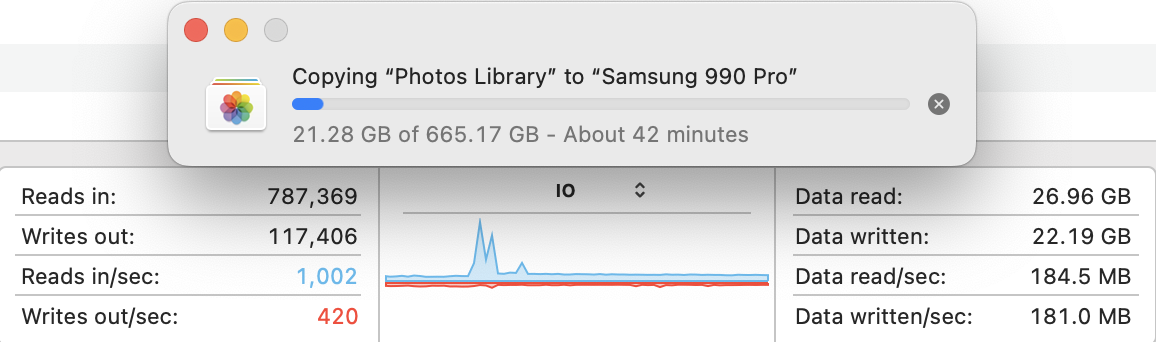

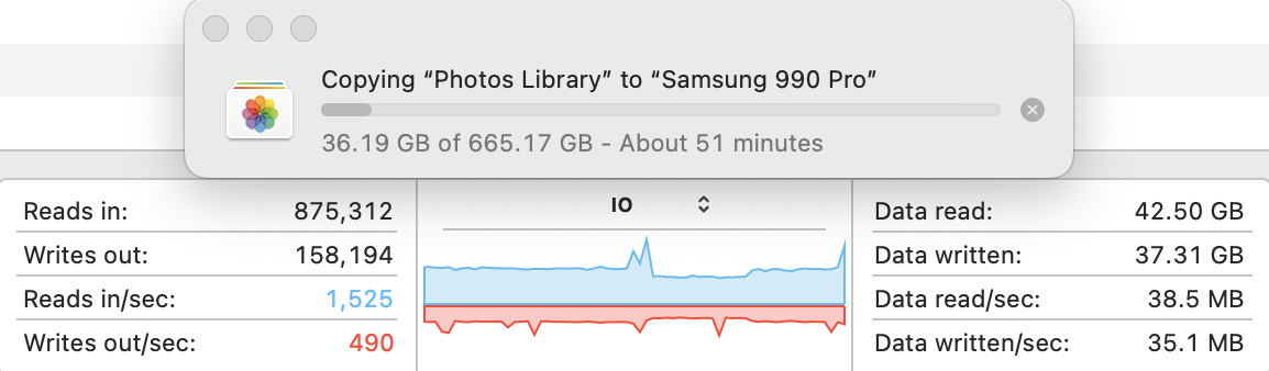

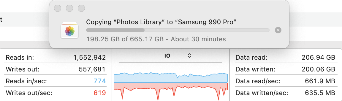

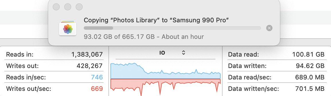

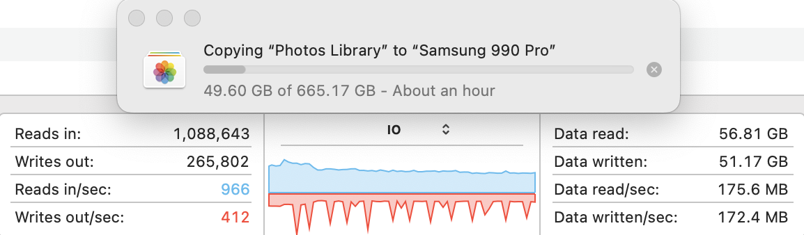

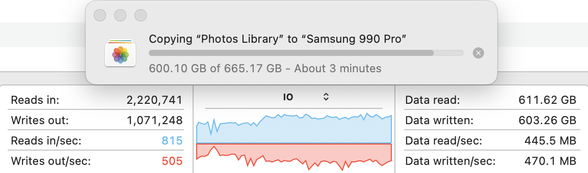

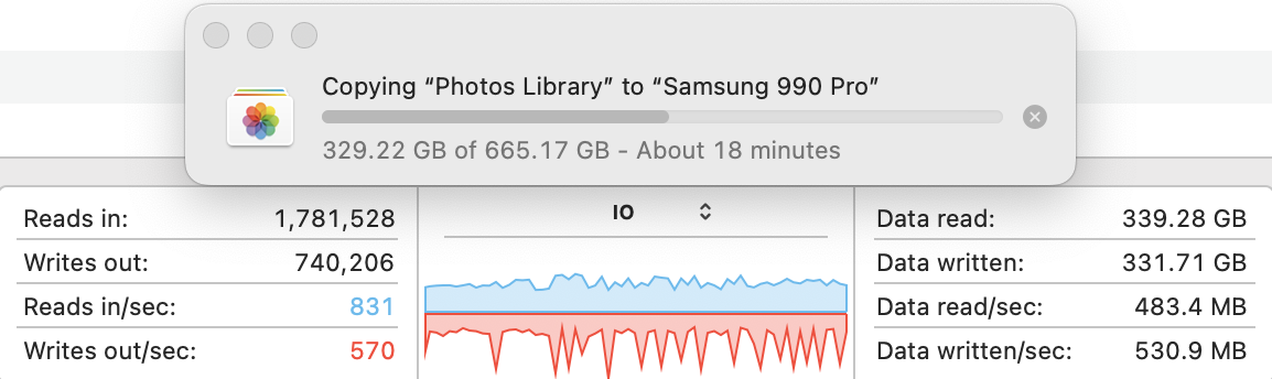

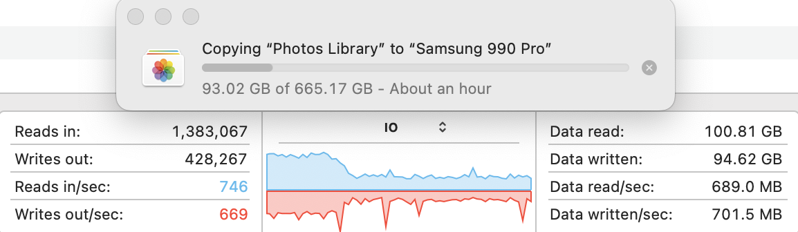

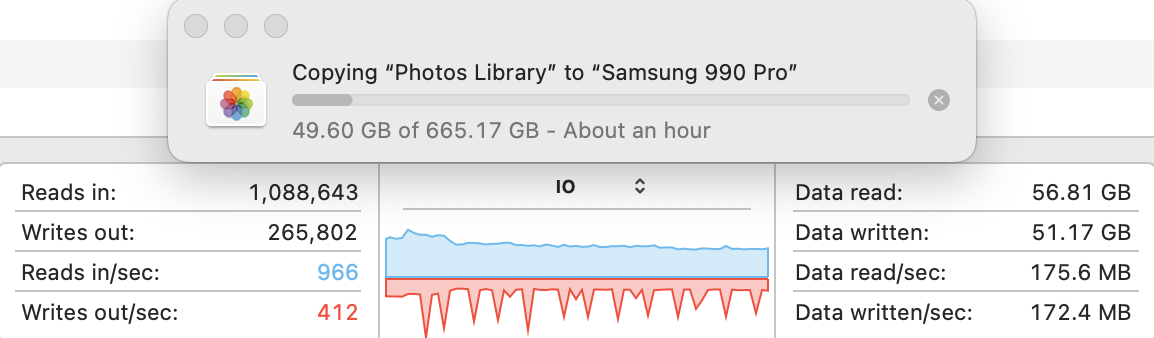

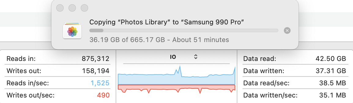

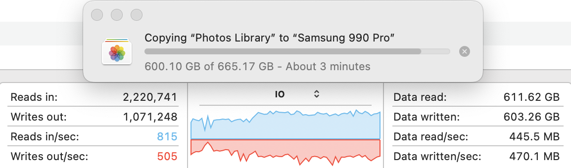

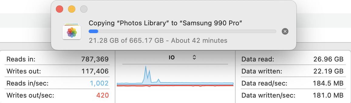

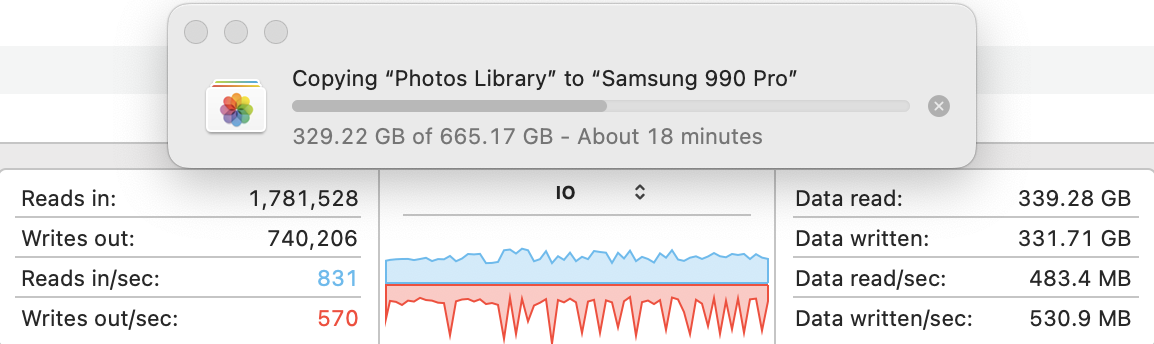

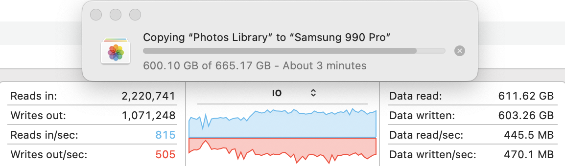

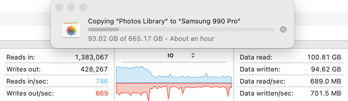

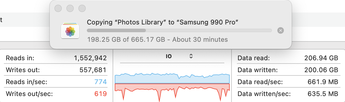

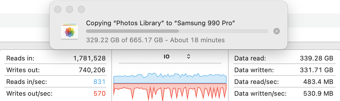

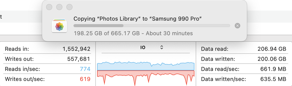

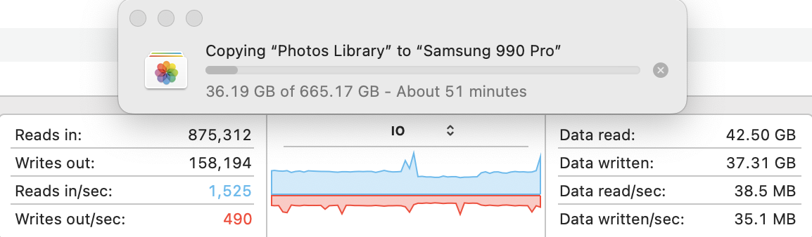

I transferred my 665.17 GB Photos Library from my Samsung T7 Shield to the new USB 4 Samsung 990 Pro. It took 29'45" for the complete process, or 29'11" for the actual transfer (since it took 34" for the transfer to be prepared). So that means a transfer speed of 373 MB/s or 380 MB/s depending upon how you calculate it. However, the speeds and behaviour really ranged, probably because of the types of files transferred inside that library. Here are the various transfer speeds at different points in time during the transfer. The graph shows the variability in the transfer speed.
Temperature peaked at 51 C.
The second file transfer was a directory full of subfolders of various photos and stuff. It was for 477.4 GB and took about 15 minutes including preparation time, so probably around 530-550 MB/s transfer depending upon whether or not you include the preparation time. Then I did yet another file transfer of about 60 GB. At the end of all this it had peaked at 55 C. It was in a more cramped spot though so I've since moved it to a somewhat more open area to see if that affects the temperatures. Currently idling at 42 C.
BTW, now Photos loads instantaneously on the 990 Pro. With the old T7 Shield, sometimes at first launch there would be a delay of a few seconds. I'm not sure why, but I'm wondering it was asleep and takes a couple of seconds to wake up.
At 55 C the Qwiizlab enclosure was very warm, but not super hot. The T7 Shield also got warm, but significantly less warm than the Qwiizlab enclosure.

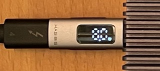

According to my Hagibis USB 4 power tester, the drive & enclosure combined use 5.5 Watts at idle and 8 Watts during writes in Black Magic Speed Test.

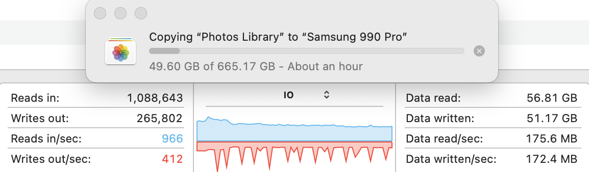

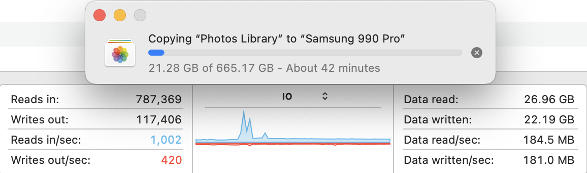

Out of interest's sake, I wiped the drive and started over again, just to see if it was truly indexing. The md_worker service wasn't active in Activity Monitor so it likely wasn't Spotlight indexing, and nothing seemed to be accessing the drive, yet the light continually flashed, even after wiping it to turn it into an empty drive. OTOH, if I plugged it into my iPad Pro M4, there was no flashing. BTW, my 2017 12" MacBook (with its single 5 Gbps USB-C port) does not seem to be able to mount this drive. I wonder if it's because it can't supply enough power.
Well, the culprit was Macs Fan Control that I had installed on the Mac mini in order to monitor the temperature. It appears monitoring the temperature of the drive is registered as drive access. If I exit Macs Fan Control or if I just turn off the temperature monitoring feature, the LED flashing stops. Lesson learned - after wasting a couple of hours of my time. 😕

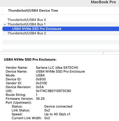

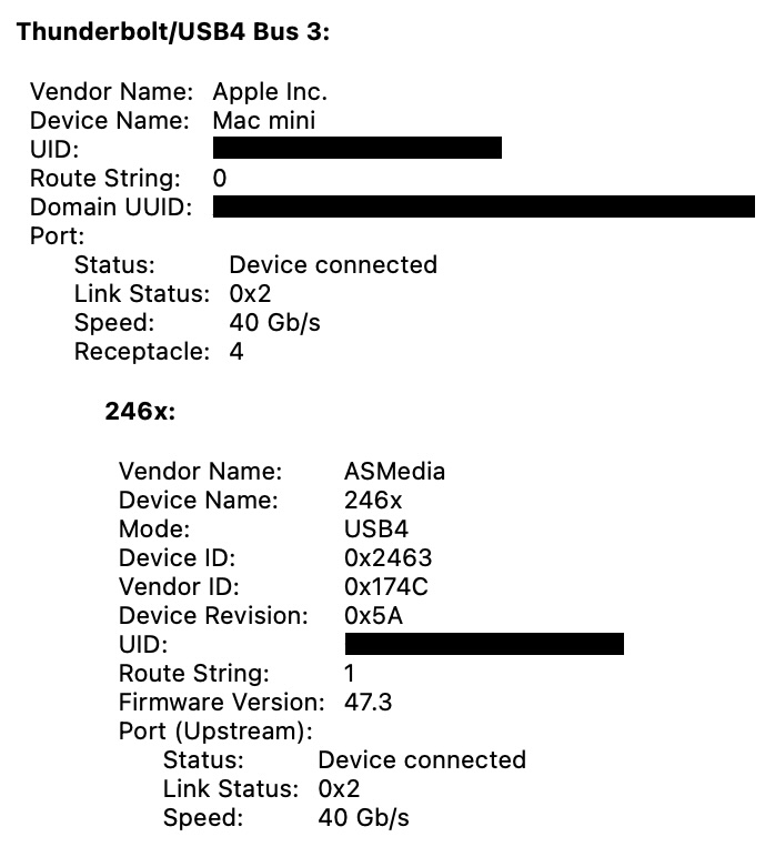

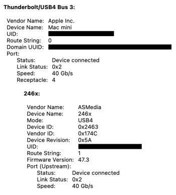

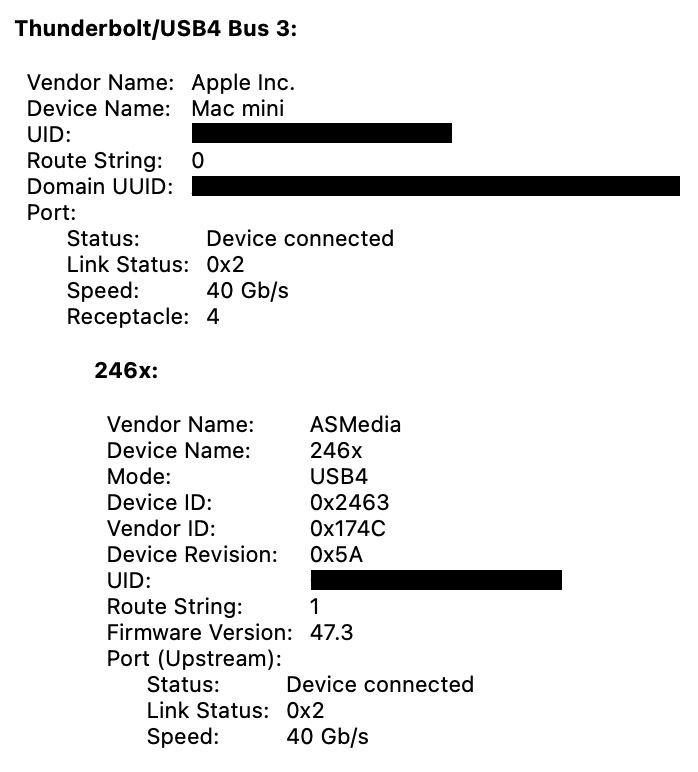

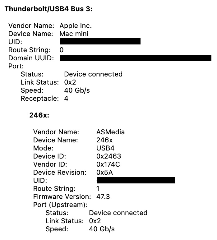

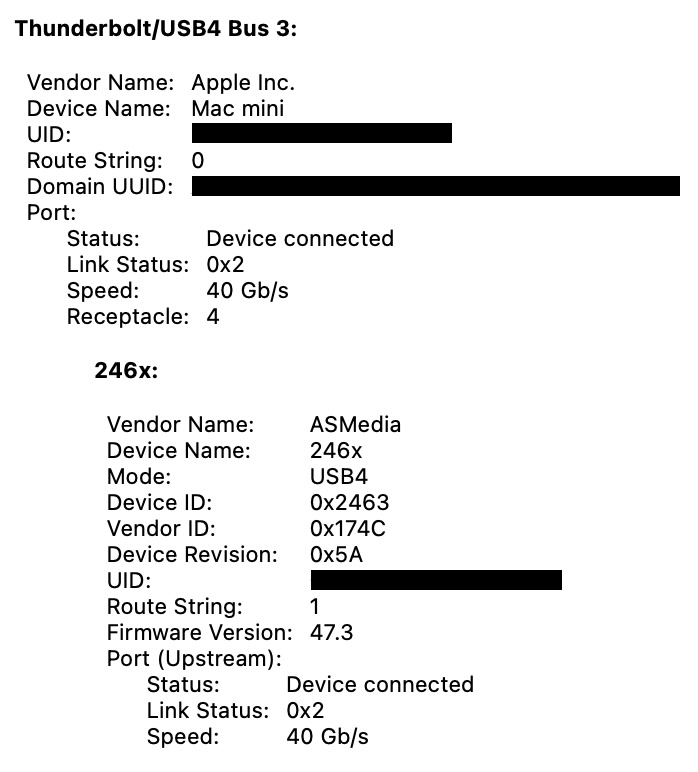

I was going to say I don't have a Windows machine, but I just remembered I have an old 2008 Mac Pro in storage with Windows 10 on it.
However, I can't tell what my firmware corresponds with compared to the driver revision numbers. Can someone help decipher this?
It states firmware 47.3, but that doesn't seem to match anything I've seen in the driver descriptions.
It's a lot more recent than the 35.25 in this post from December 2023 though.
It seems the Zike drive is actually a Satechi. From my M1 Max MacBook Pro.
So one could buy that instead.

Hi EugW,
I think your driver version is 2024-07-03 (47.3 means year 2024 month 7 and day 3).
I use reddit post:
Where driver 20231005 become: 3a.5 and 20240129 become 41.29 then I figure out seems those could be translated into date. The first digit looks like a year while the second seems month in hexadecimal.
That also means you're just 1 version older than the latest:
Asmedia ASM2464 NVME/USB 4.x Controller Firmware Version 240703_85_00
Asmedia ASM2464 NVME/USB 4.x Controller Firmware Version 2409013.85_00
If someone with Qwiizlab / OWC could confirm their firmware we would have more information regarding 4TB vs 8TB support.

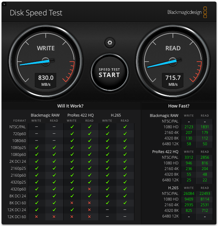

This is my Samsung T7 plugged into the front USB 3 port of my M4 Mac mini.
(It might be somewhat faster with the rear ports, as I've seen with my USB 3.2 NVMe enclosure, but I didn't test that.)
