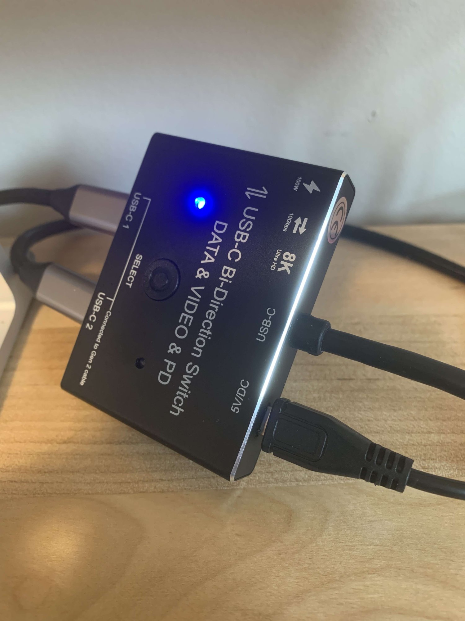

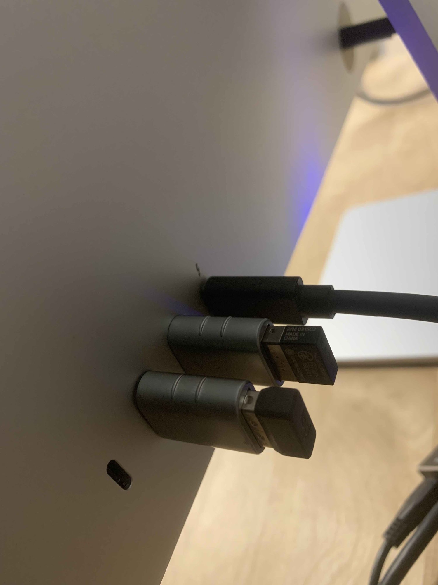

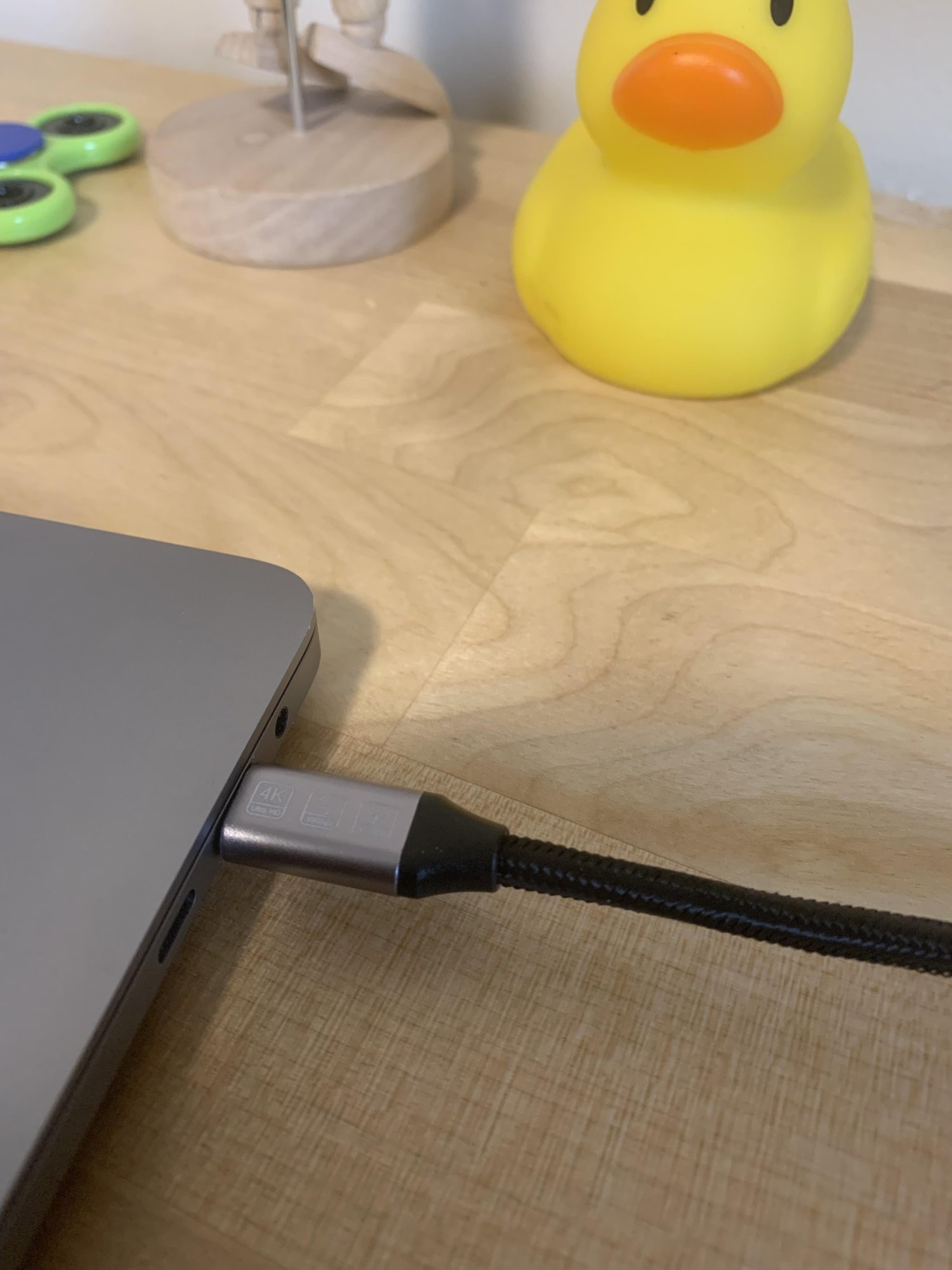

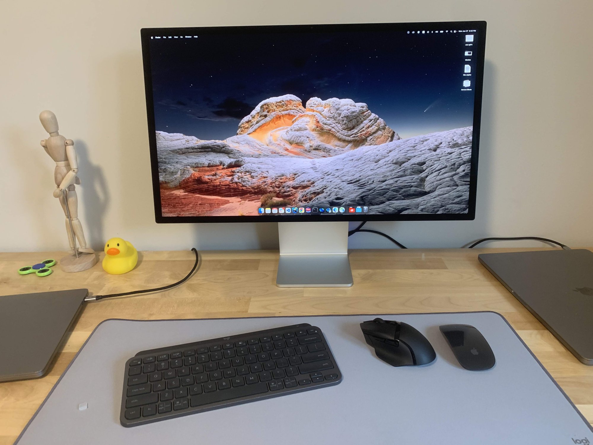

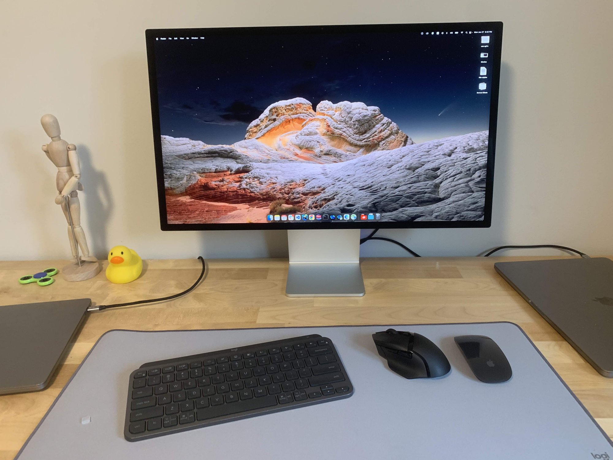

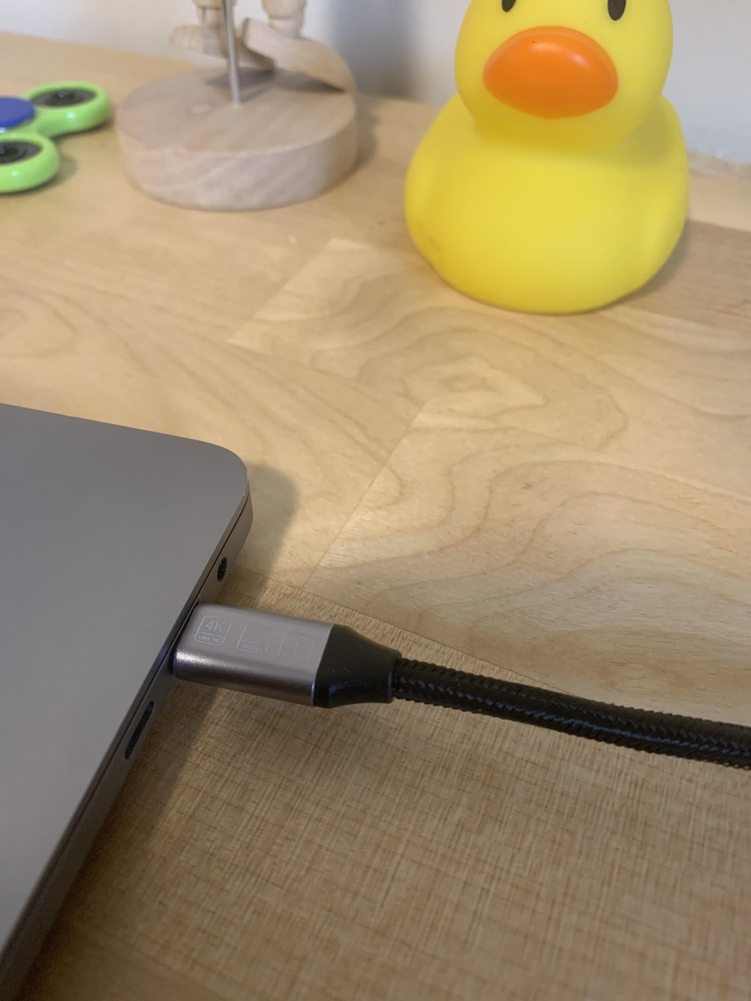

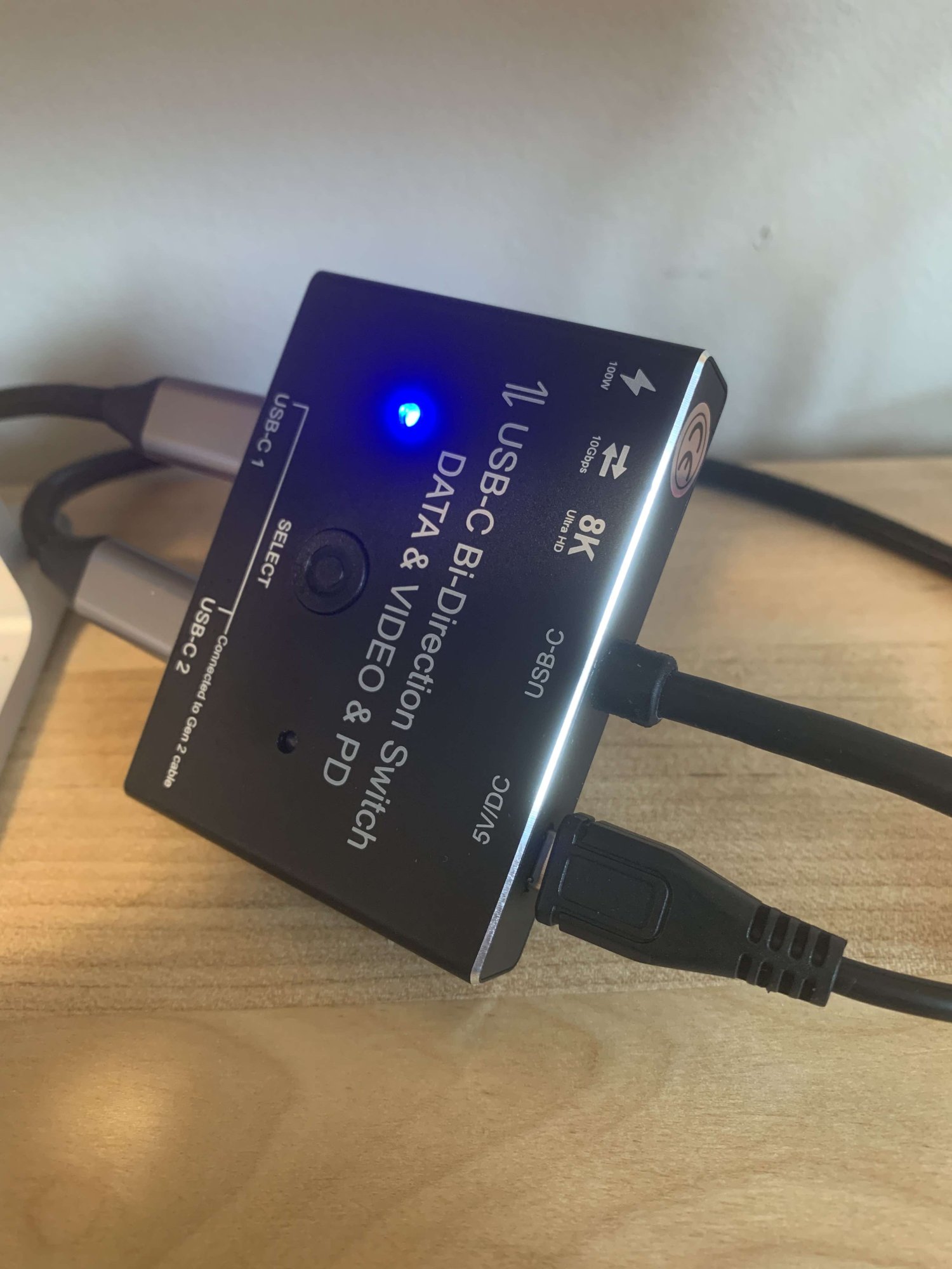

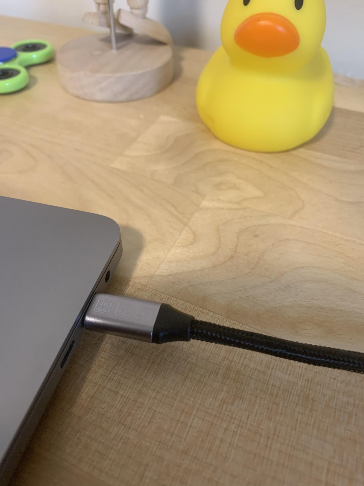

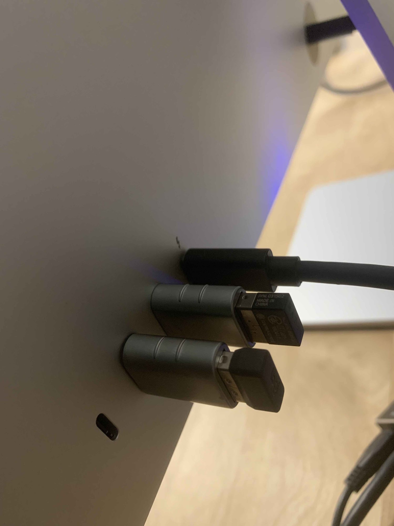

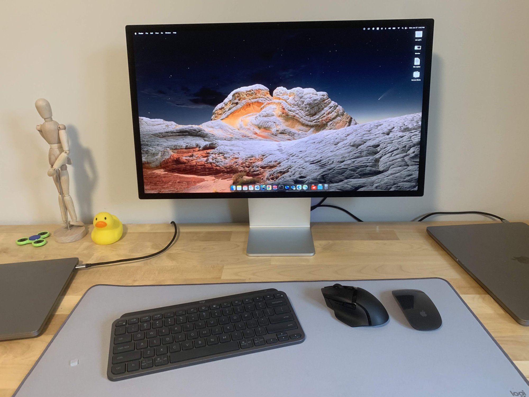

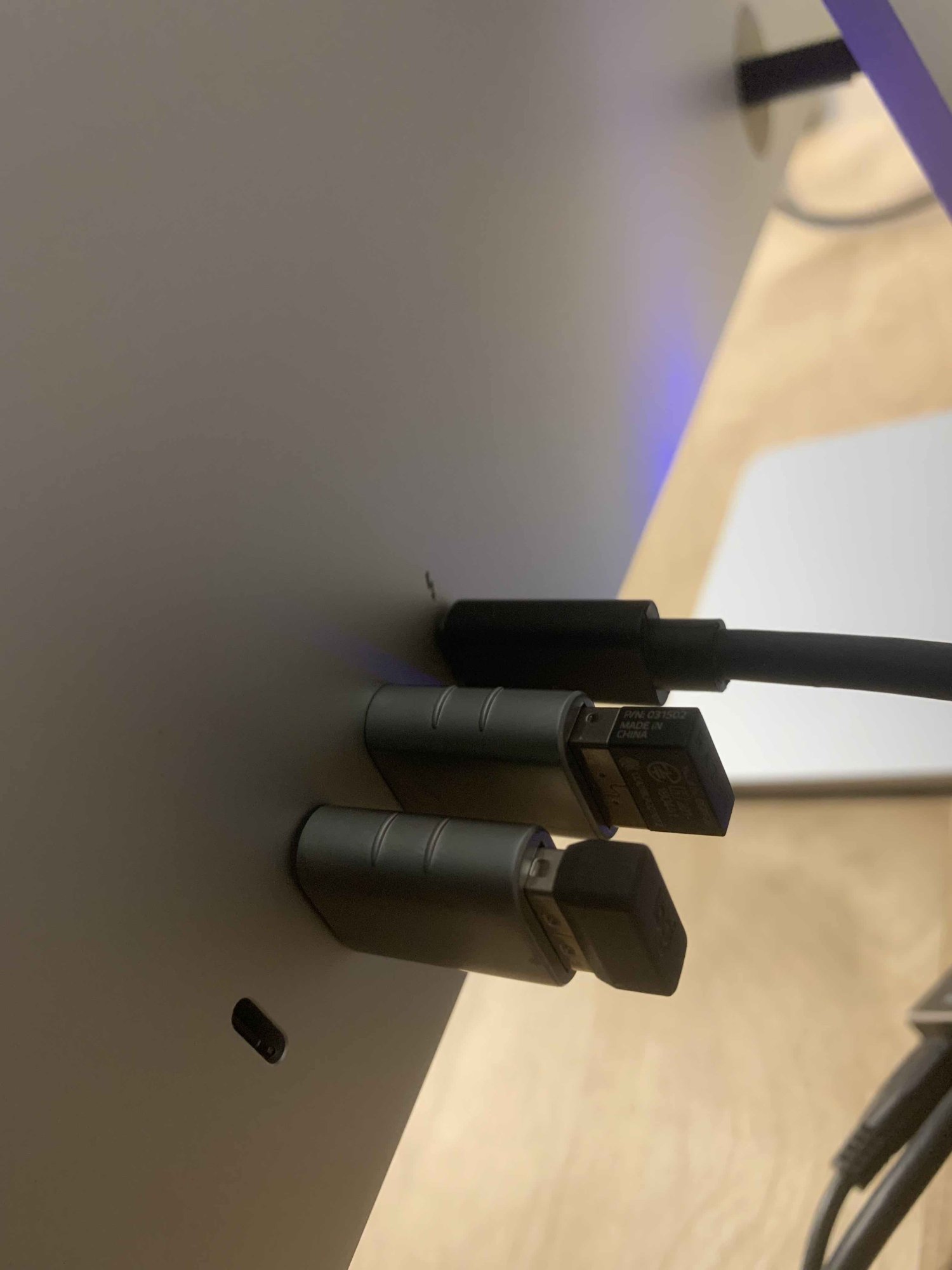

To all others facing the same issue, I successfuly managed to convert my Apple Studio Display into a full on kvm+docking station!! Here's how:
My workflow is having two laptops (mbp 16 inch 2019), one for work and one for personal. And I'd like to switch between them with the least amount of effort. I also like to share my mouse and keyboard during the process.
For that I bought:
- CableDeconn USB-C Type-C 8K Updated Switch (Link)​
- Syntech USB C to USB Adapter Pack of 2 USB C Male to USB3 Female Adapter (Link)​
The switch acts as a kvm. No convertors or hubs are necessary. Just press the button and it switches, with power delivery! The unit also comes with all the cables necessary included. Also for the mouse and keyboard I use a razer basilisk x mouse (supports both 2.4 gz usb and blutooth) and Logitech mx mini with the bolt receiver. So I connect both directly to the studio display itself using usb-a to usb-c convertors and everything works like a charm!
And the best part of this is, all combined costs less than a hundred bucks!
Cheers!
@battleslim Wow! This is exactly what I'm looking to do without manually switching the cables.
I know you have listed details, but can you please share more info/steps (ie: the recipe ... what is connected where etc)? I'm new to Apple, so this will be very helpful for me. Can you please include details re: any additional cables as well?
It's not clear to me why I need the Syntech USB C to USB Adapter Pack of 2 USB C Male to USB3 Female Adapter?
Also, do you know if I can share my existing bluetooth Logitech mouse/kboard between the 2 Macs? I think it should be possible (says can pair up to 3 devices).
Thanks.
Edit: Just read the Amazon listing for CableDeconn
It is not compatible with Macbook Pro or Mac Series Devices with M1 Chip

View attachment 2024014View attachment 2024015View attachment 2024016View attachment 2024017
This is exactly what I needed. Ordered 🙂

I recommend ordering one and return if didn't work because it seemingly works with M1 even though it says it doesn't.
The usb converter stuff are kind of optional. If you have a mouse and keyboard that you want to share and they have a usb dongle, you can use them and connect them directly to your studio display. If your logitech devices have a unifying receiver or bolt receiver then you can do it.
As for the recipe, the connect 1 usb-c to your laptop A and othe end to the switch. the second cable goes to your second machine and switch. Finally the switch has an output that goes into the monitor. Now can click a button on the switch to select what should be displayed on the monitor.
For that I bought:
Cheers!
Hi @battleslim, only one question, because I have exactly the same USB-C switch.
You can reach the 5120x2880 resolution, right? I mean If I use the official TB4 cable that comes with the ASD the switch don't work, but If I use a cheaper cable, works with lower resolutions.
Got it, thanks! Does the switch come with USB-C cables or did you get your own?
I couldn't get things working with the original thunderbolt 4 cable from studio display. But just used the included cables in the box and get 5k output no issues. The cables are decent.
Yes, I get the same conclusion, I have been doing tests for a while and these are the results:
- The CableDeconn USB-C Switch only can handle up to 10Gb/s cables (incompatible with Thunderbolt 4)
- Studio Display Included 1-Meter Thunderbolt 4 is 40Gb/s (Black screen with the switch)
- M1 CPU Mac mini can draw 5120x2880 with 10Gb/s cable
- Intel i7 2018 15" Macbook Pro, as use the same cable for power, only can draw up to 3840x2160 with 10Gb/s
Next week Im going to receive the M1 Pro 14" Macbook Pro, so lets see if with this new one we can reach the 5K resolution with 10Gb/s.
If I'm reading this correctly, you used the switch + included cables and were able to get it working with M1 and at 5k.
Glad to see another data point 🙂
