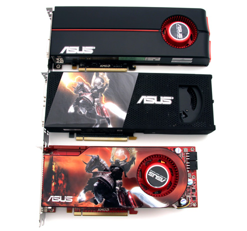

Aaaand checking if the 5870 size could be a problem :
Could it even fit in all the MP models,especially the older where the 16x pci slot is at the bottom??
I don't think size is an issue.
Seen here is my 4890 in my Mac Pro 1,1:
There is still ~10cm to spare, and looking at this picture:
The 5870 is actually not that much longer.

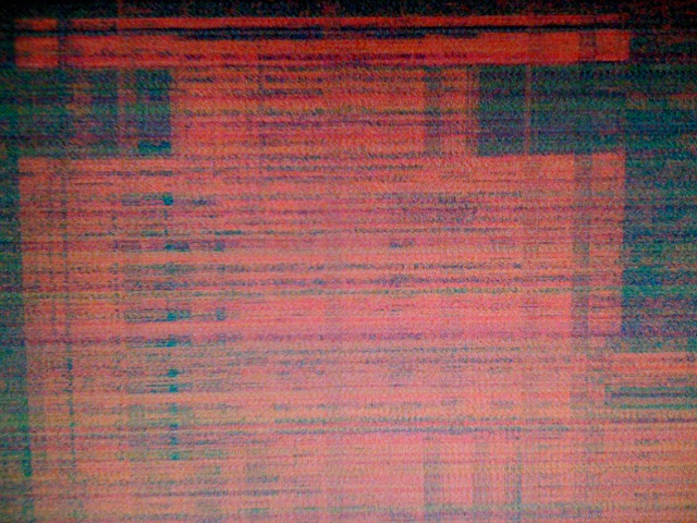

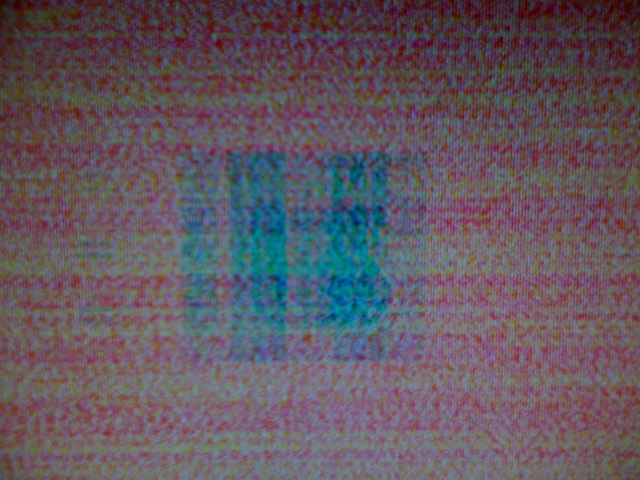

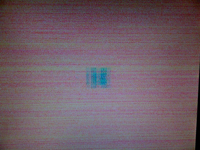

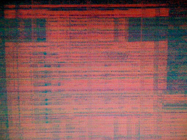

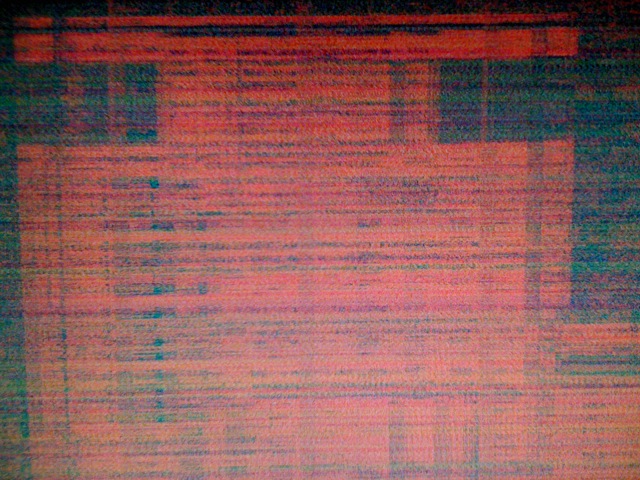

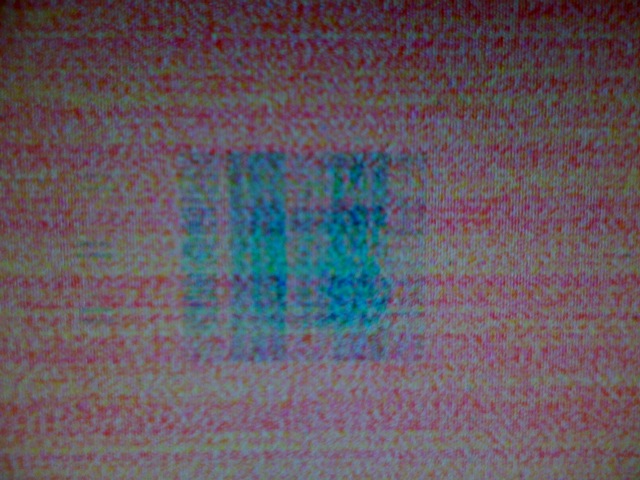

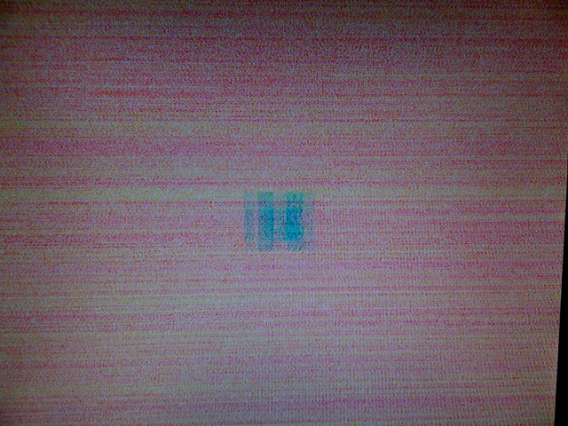

Well, no Joy here unfortunately. I snagged one of the XFX 4890s, which others in this thread appear to have working via. the new rom-flashing method. Everything seems to go well, but all I get is a completely garbage display from the moment I power-on. This could be something as simple as my card being a different revision, and could be very had to track down, so if I don't get it working by tomorrow I'll probably just bail and exchange it for an "Apple" 4870 (my time is worth a lot more than the money saved). It seemed like such a nice idea though! I can, if I squint really hard, sometimes make out the Apple symbol on the boot screen amid the chaos and snow. I guess that's something 🙂
Has anyone else run into any major problems with the flashing? I used both the regular and the overclocked version of the roms with no luck (same symptoms). As far as I can tell I've followed the directions to the letter. Are there any obvious things a long-time computer (but not unix) guy might have missed due to gaps in the instructions? For example, does either the app or the kext need to be in a specific directory? I created a new directory for them and worked from it since the instructions didn't specify. I also had to set permissions to the 755 as suggested by another poster. When set to the permission specified in the original article the flasher app would just launch and immediately quit.
Even when it appears to be flashing my card properly the flasher app would only run for about 10 seconds. Does this sound about right to you? It seems a bit quick to me.

Fast reply! I was running my "old" 3870 in slot 4 as my primary display and my 4890 in slot 1. I'll try switching some cards around and trying it one last time. I'll work on adding a screen shot-also.
Thanks!

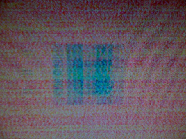

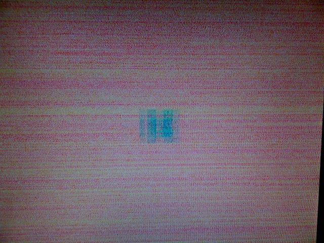

My XFX 4890 HD-489A-ZDFC ver 5.4 just arrived today. I am having the same exact problems as you (artifacts, etc) Also when the card is flashed with any of the roms neither of my displays work in windows. I do have the 4890 in the #1 slot and I flashed using the old method. I have flashed 4 xfx 4870's the same way with no issues. I will try moving my other card (7300gt) to the first slot and see what happens.
Still no joy
Still no joy here. I swapped the 4890 into a different slot, but no luck. My theory is that it has flashed, but that the rom file is not compatible with my particular card revision. If it didn't flash I shouldn't get any display at all, right? Anyway, it once again appeared to flash properly, but upon powering-on this is what I get (see the Apple? It is there!):
My non-working card is a "HD-489A-ZDFC V5.2". If you have a backup of the original (windows) ROM file for your card would you mind posting it here? I hate to admit this, but I did this on kind of a lark, at least half expecting to return the card, so I didn't bother to boot into windows and figure out how to backup the original ROM. If you have a copy I'll re-flash my card with it.
