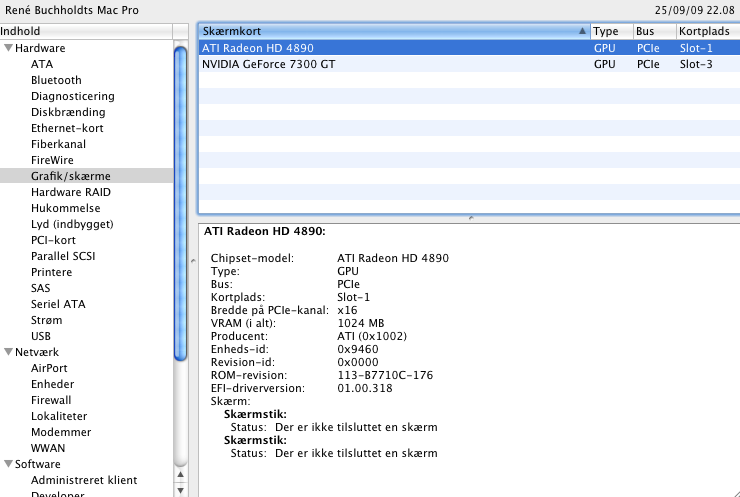

Hi there..
I really hope some of you clever guys can help me. I have the 2006 mac pro, and today i got the sapphire 4890 vapor-x oc card. I have flashed it using the guide on the front page. I seems like I have done i right.
My problem is that when I try to connect my monitor to the card I only get a black screen. But when i use my old 7300 i can see the 4890 in system profiler. Is that normal if the card do not work properly?
What can I do?

afaik the oc cards dont work. however im using an oc-rom (not sure on tha oc subject) maybe its because of your software version? you do have Snow Leopard right?
Yes thats right i use snow leopard. The thing I am confused about is that if my mac can see the card should it then not be able to use it.. As fare as I can see system profiler shows exactly the same info on my card then on the others..

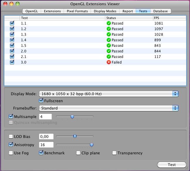

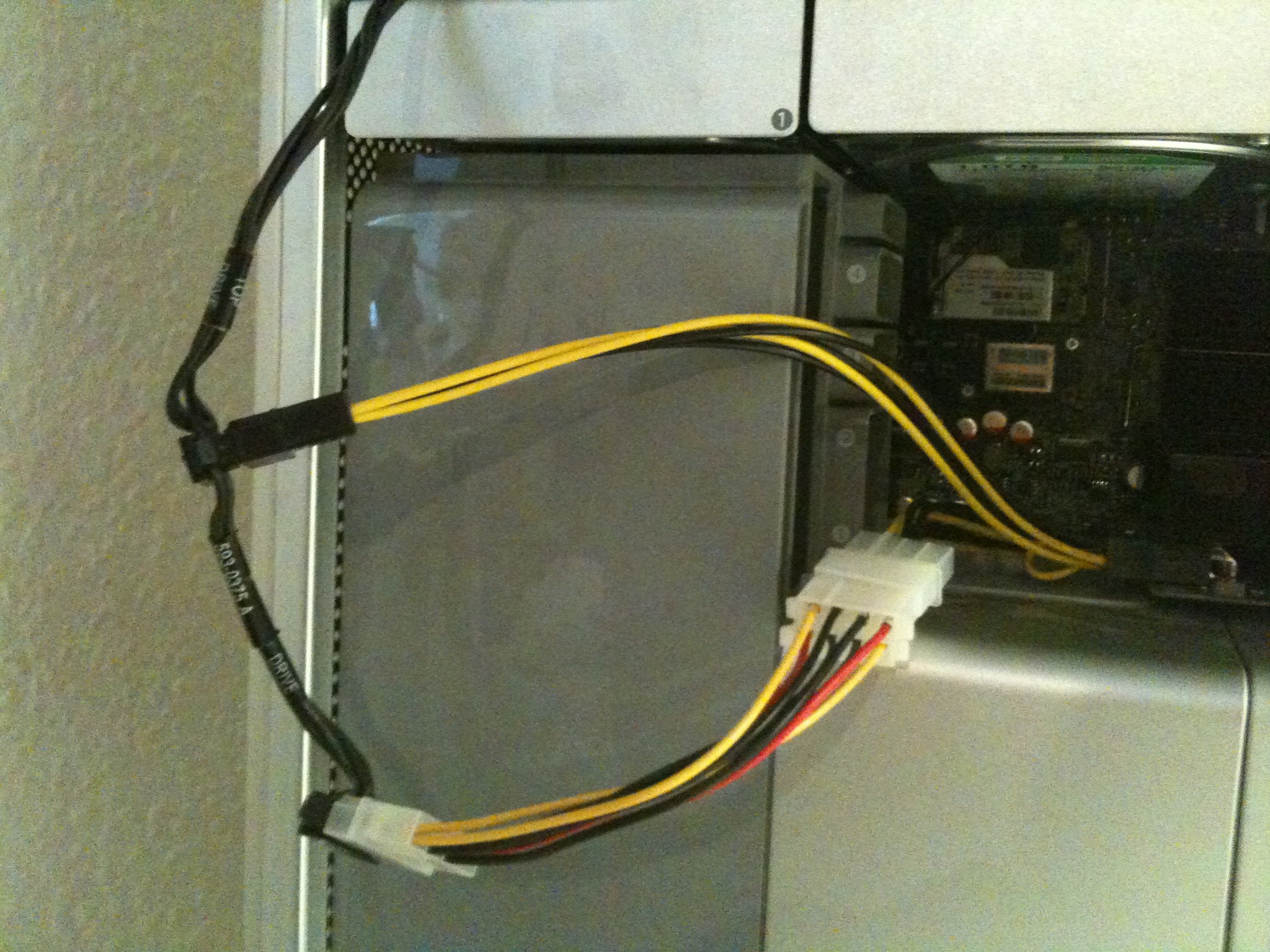

I now have the Sapphire hd 4890 Toxic Vapor-X OC 1 gb up and running. I did a benchmark test, and i thinks it okay. I do from time to time have a problem with the screen going blank after restart.. But othervise it seams to work.

THX. Just followed your guide, and had some luck I guess 🙂

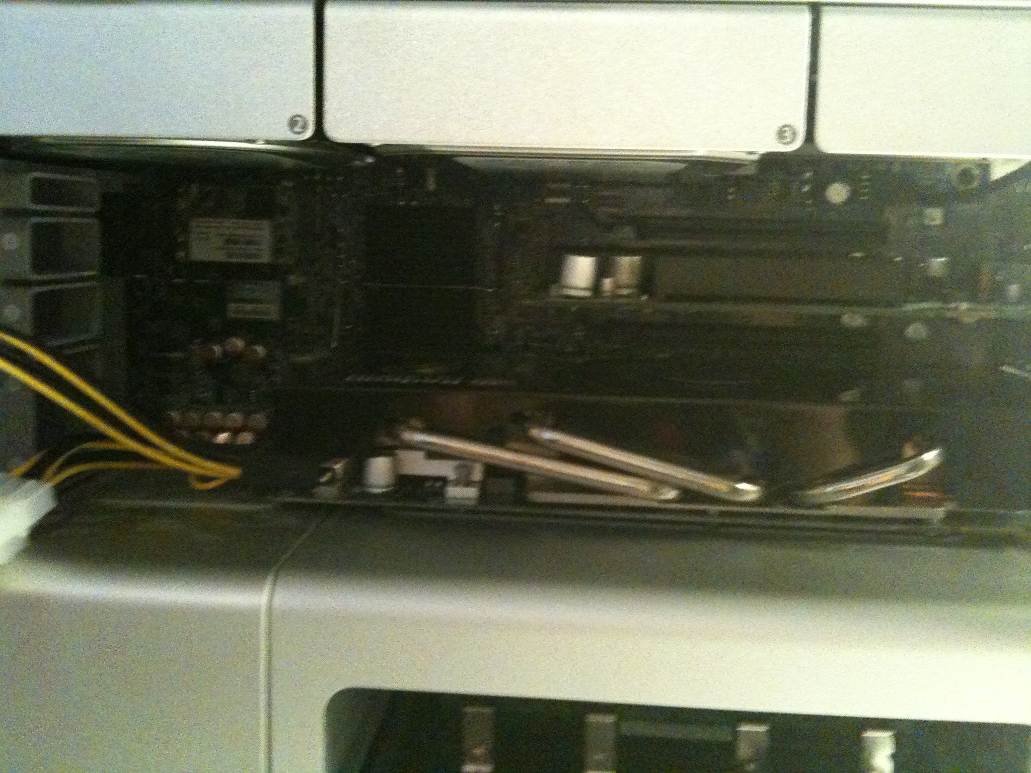

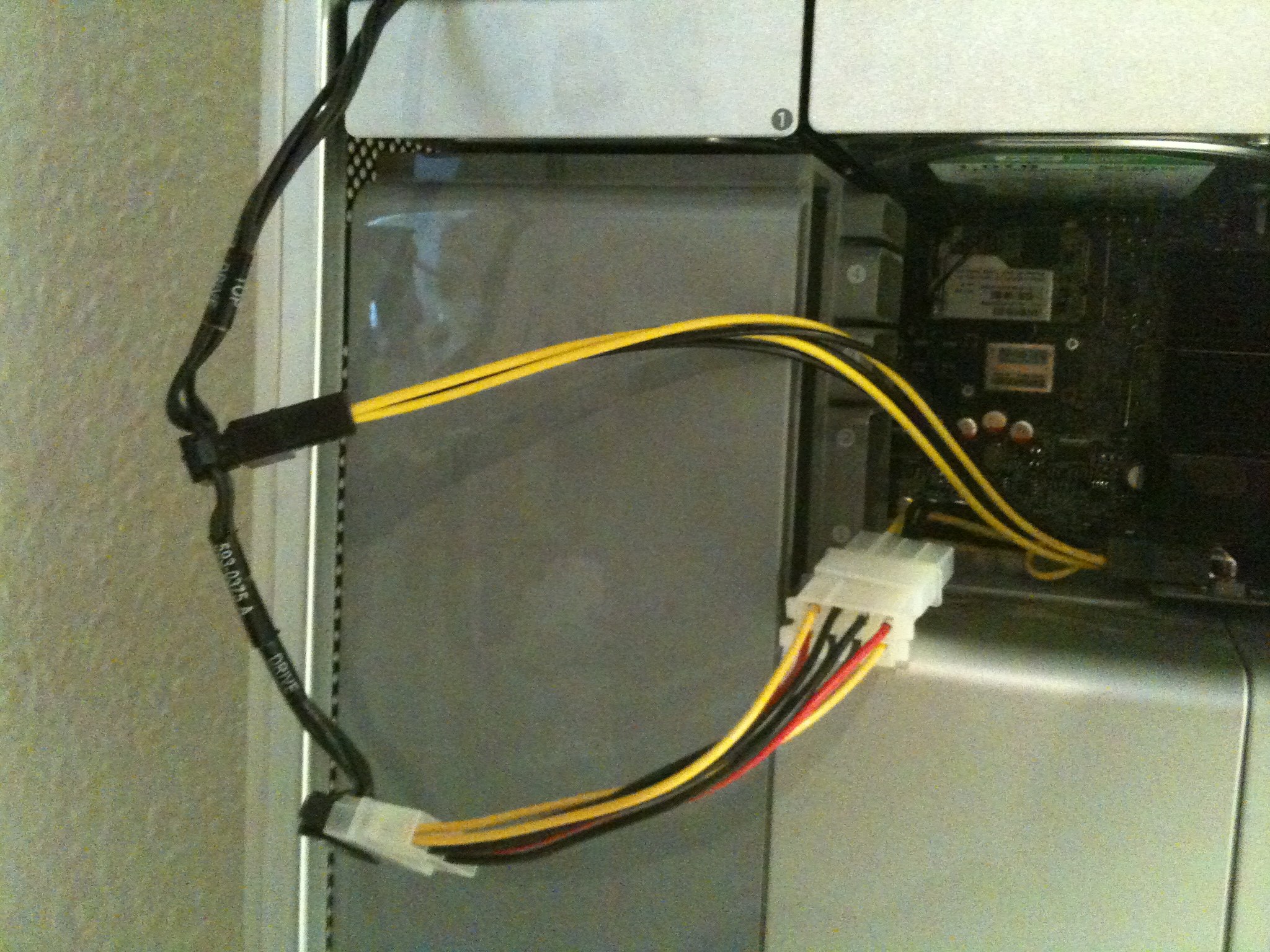

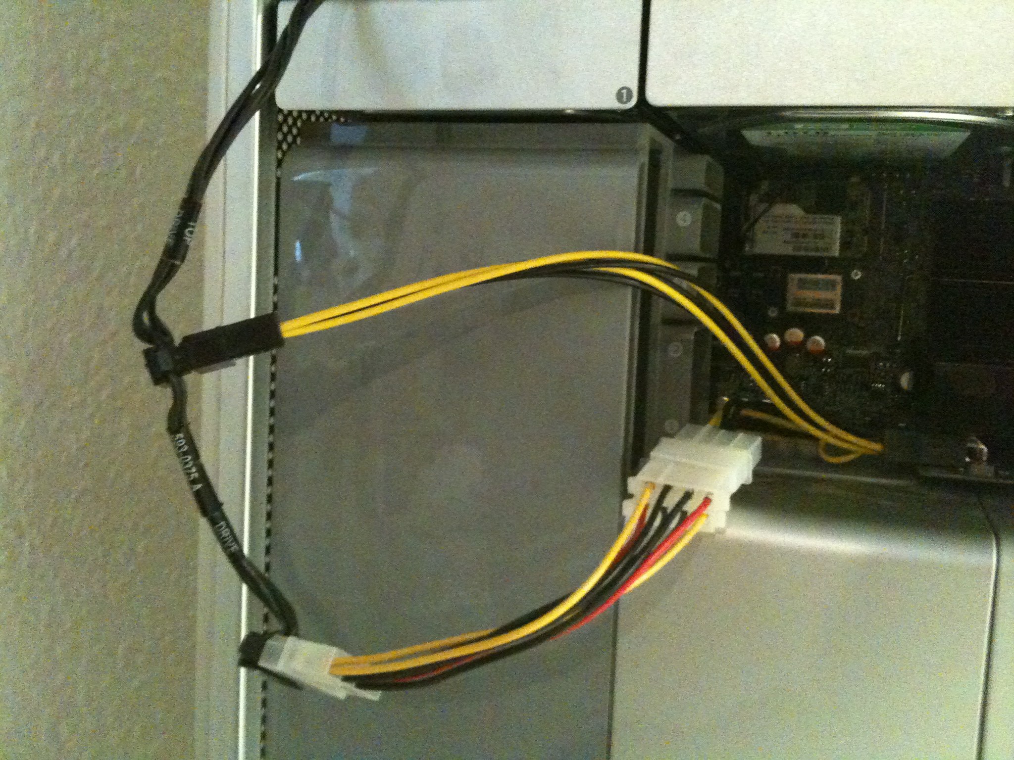

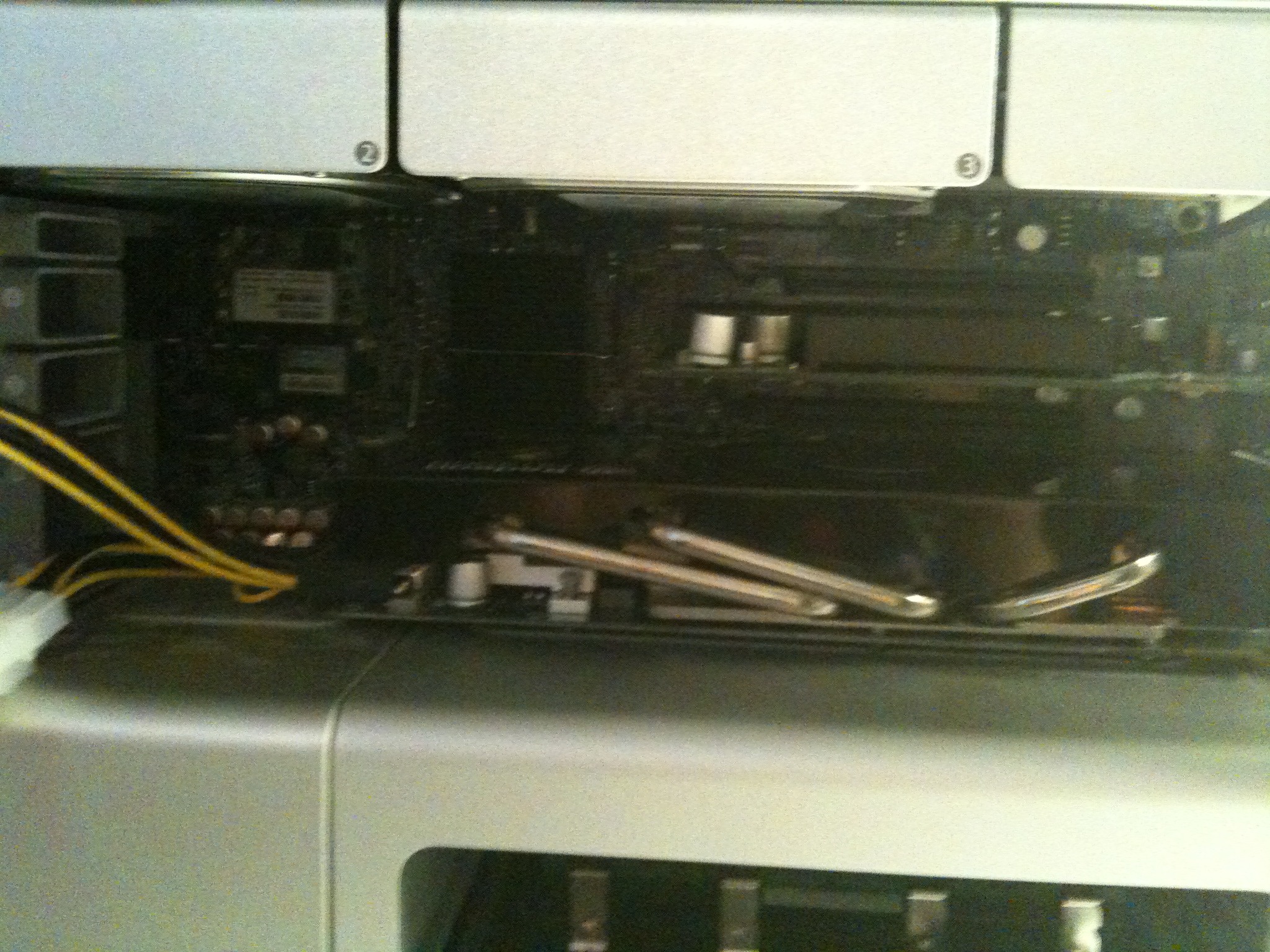

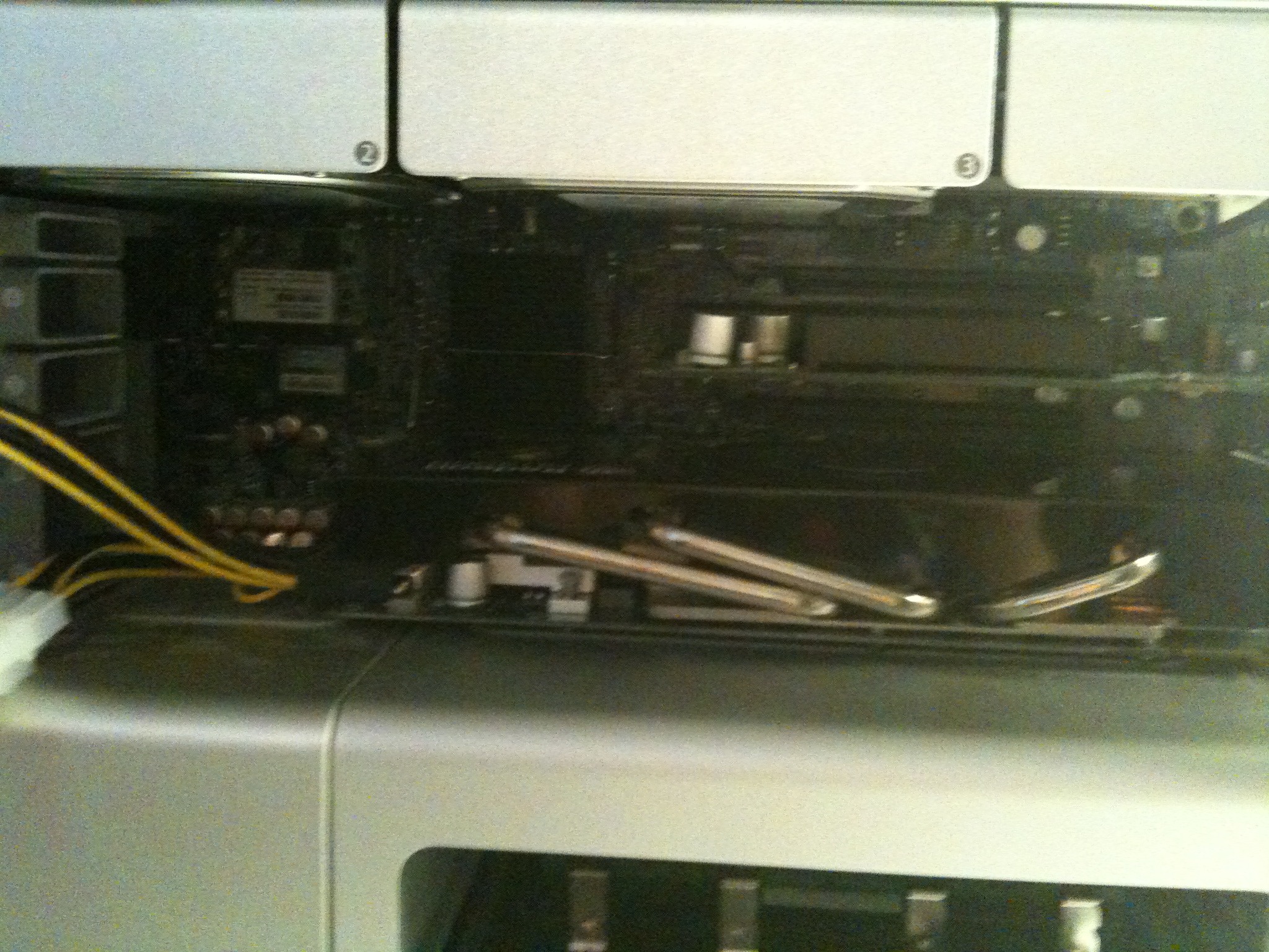

I think it is about half the times, but I am trying to figure out the problem, so I restart allot right now. I will try to tell how I installet it, in details, and perhaps you have an idea to what could help. I have posted pictures of my card and setup downunder.
First i injected the card using the files and guide posted on the front page. I did one thing different. Instead of using the terminal to remove the old ROM and insert the new one, I just did it through the finder ( right click, show content/pakages )I use the OC ROM for the card
After that I used the "QE_CI_Exotic_cards_10.6.1" app. Rebootet and then it worked.
Afterwoods I have the problem mentioned before, that the screen goes black. Sometimes I see the grey screen for a couple of secends before et goes blank. Sometimes It Stays black and sometimes it works. I have found out that if i hold "x" down on reboot I have a bigger change getting the card to work.
Anny ideas?

The first thing I notice is that card is "different" than the traditional Vapor-x cards myself and others were attempting to use. what he has is a Sapphire TOXIC with vapor-x cooling.... completely different card. I thing that is a standard Sapphire card witha vapor X coolers redesign on it. this is the older Vapor X model myself and others were trying to use. As you can see it looks much different.
Problem solved... rbuchholdt is not using a Vapor-X. He is using a Toxic card.
They are different cards.
