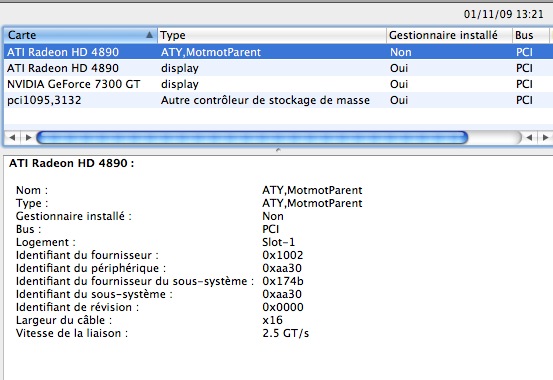

In System Profiler I noticed I'm listing two PCI cards. The top one says there's no driver installed. The bottom one says there's a driver installed.
Is this normal?
Yes, it's listing the HDMI audio component for some reason, which has no driver. You never answered my previous question, after flashing the card did you uninstall Natit? As for what Hz to use try 0, 59 and 60.

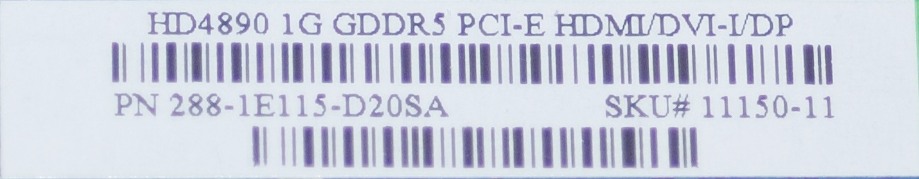

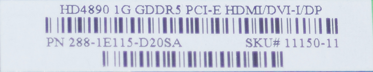

mfka,
Sapphire Radeon HD 4890 New Edition should have this P/N and SKU#

Hi guys ,
My card have just the same numbers.Can't I use your original rom to flash it back in the original state?You think it's a difference in rom b'cos of different memory names?

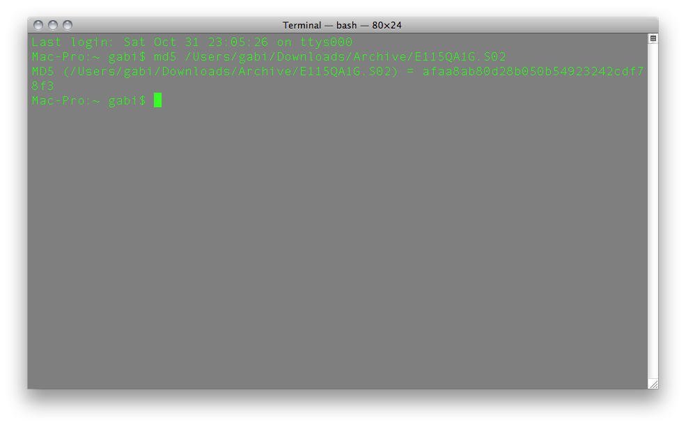

Peloche,
Here attached the original New Edition (qimonda) rom, please check md5 before using it (go to terminal, type md5, drag and drop the file in it and return)
This is the result I get back from terminal.Is it good?
Yeap it's good but within archive.zip you have 2 files E115QA1G.S02 which is the rom and E115QA1G.md5 that you open with textedit and gives you the result of md5 verification, to compare with the terminal result.

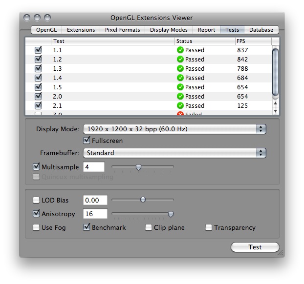

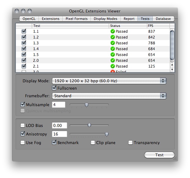

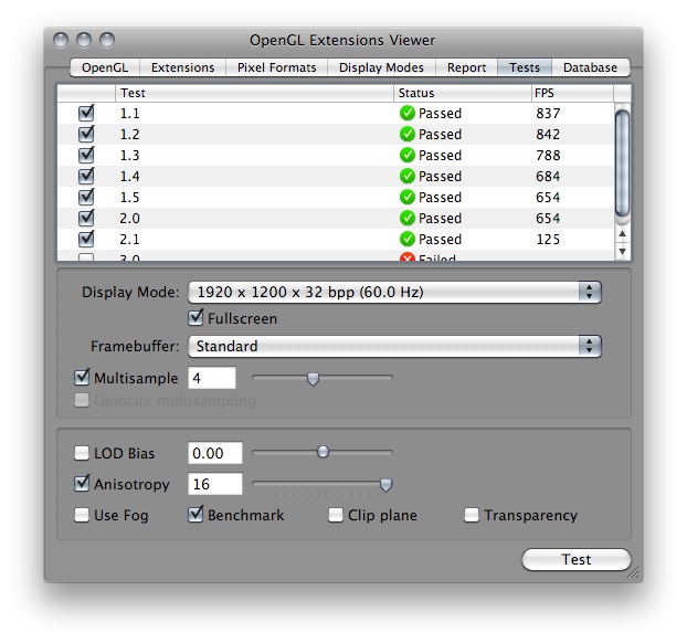

Results
Ok. I have results to show. I used the same settings as Cindori did a while back. Somehow I didn't do quite as well as he did. There was also an extra test done at the bottom of the list that was not on the list from Cindori. Anyhow, it failed that test. Perhaps the version of software he used has changed since.
Drexus no one's going to get the exact same results due to differing system specs and testing conditions. I also wouldn't worry about failing the OpenGL 3.0 test since OS X only supports up to 2.1. (Hey Apple, in case you haven't heard they're up to 3.2 btw.)

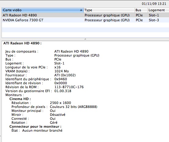

Edit:
At boot, screen is grey with screening wheel and when windowserver starts screen becomes black, i had to disconnect the screen from the card and reconnect to get the screen working, and then a warning appears "The cables ..." log in and click the close button of this warning and that's it.
Needs some improvements.
mfka doesn't have these problems, it could come from my 30" ACD.

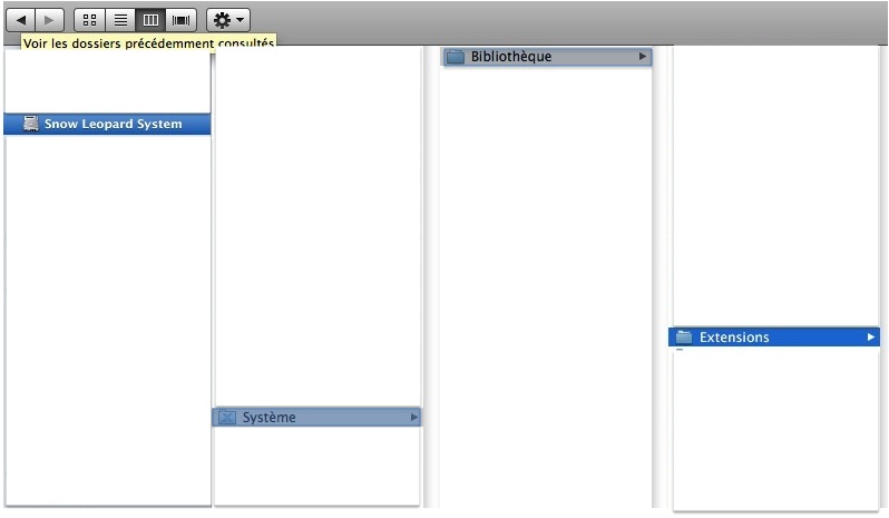

mfka,
Don't forget to remove ATY_Init and Natit which are in System/Library/Extensions/
Library in french is "Bibliothèque"
Better to flash the card and to remove the extensions after just before reboot
Good luck,
