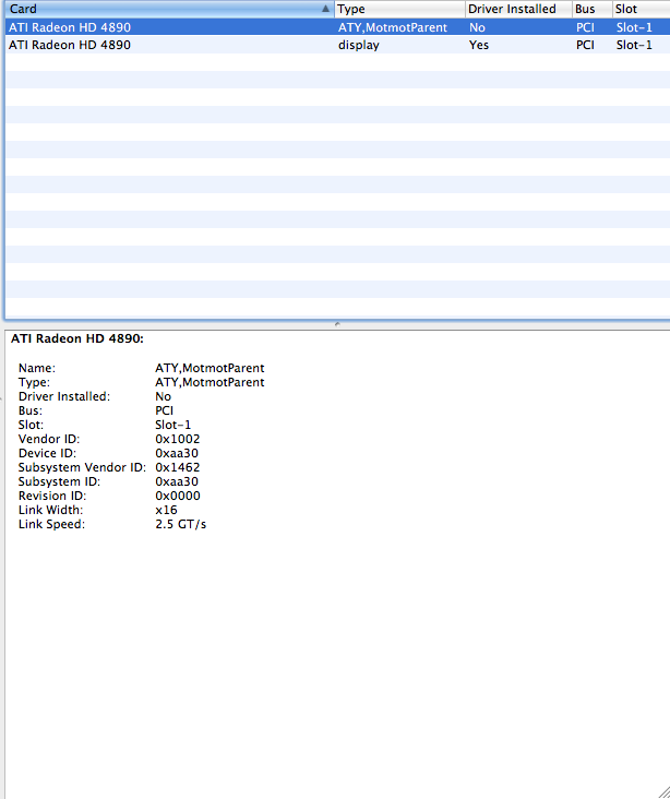

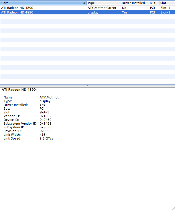

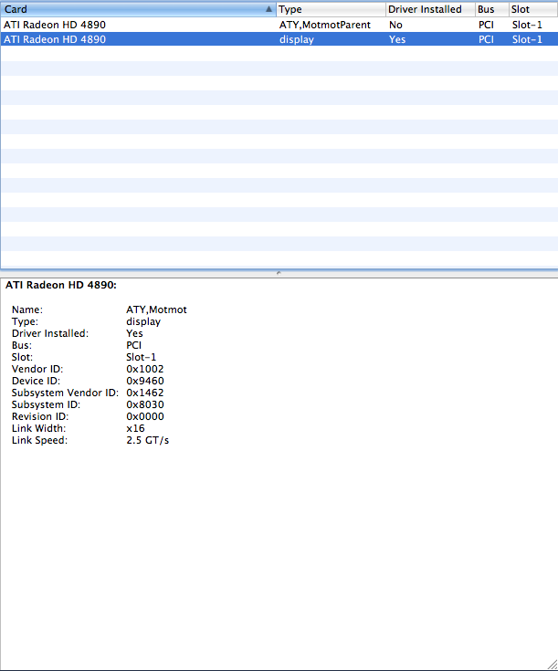

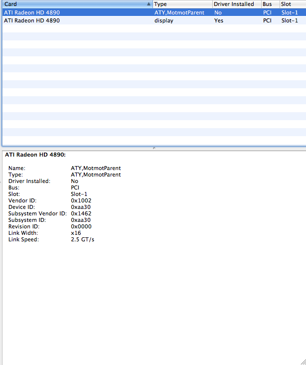

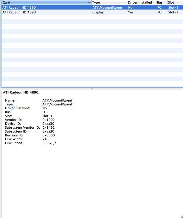

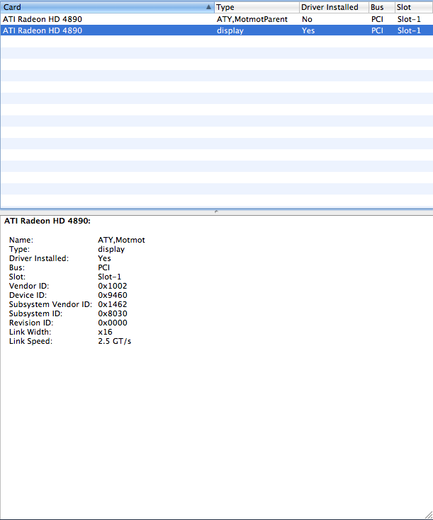

On my issue of screen tearing with dual monitors with the HIS 4890 - I've just noticed something.
When I am using the computer while playing a game or using a Flash application, the tearing stops completely!!!!
In System Profiler I noticed I'm listing two PCI cards. The top one says there's no driver installed. The bottom one says there's a driver installed.
Is this normal?
probably because the game uses a Hz or Resolution that works ok.
use switchresx - experiment with Hz and resolution.
also something you can try is to use RBE in windows (google it) to edit rom, set all clocks at same lvl

I downloaded switchrezx - don't really know what to change the Hz to. I changed the resolution a few times but the tearing still occurs.
If I use RBE in windows will I have to reflash or will there be any other complications? Could you maybe give me a suggested clock speed to try for all the settings?
Under windows I have no tearing issues with the monitors.
