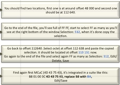

I have also a suggestion to make as far as the ROM modifying scheme I tried to use (Peloche posted it at the end of # 1126) is concerned.
Instead of stating "Select octet at offset 112638 ..." maybe it would be clearer saying "Insert cursor at octet 112638 ...", because that's what made my file one FF short (if you select and paste, the selected octet disappears, while inserting the cursor conserves it). Have a look.

You're right bradipo concerning "Insert cursor at octet 112638", i'll update it.

Done,
thanks bradipou 😀

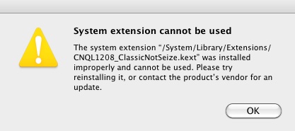

Oh, and just another problem ...
As I suspect I've to go with Cindori's atiflash to correct what happened in Windows, I tried to install the Natit. Cindori's application told me that it was successfully installed, but after ten seconds I got this message you can see below. Does this mean I'll have to create my own Natit, with Peloche's algorithm ?

Classicnotseize is a buggy printer/scanner kext. It has nothing to do with ATI Flashing Tool or Natit.
The reason it's popping up is because ATI Flashing Tool rebuilds kextcache after installing Natit, so unsupported kexts will reject like that one.
If you are not dependant on any special printer/scanner, you can remove it.
