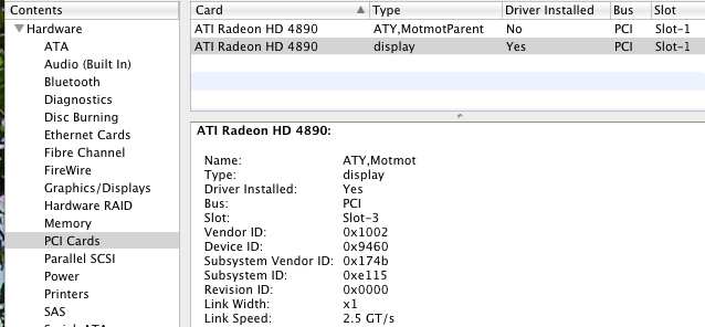

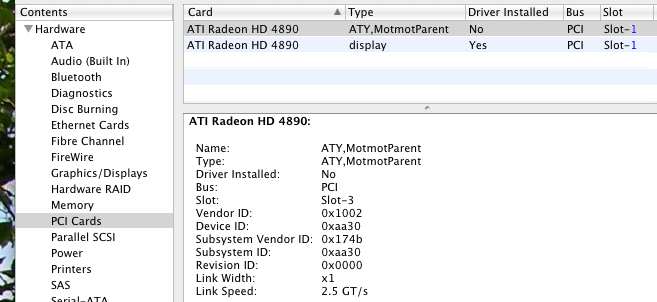

Ok, so here I'm back.
I followed Cindori's advice. I calmed down. 😀 Then I studied that jacobcroft link (http://web.me.com/jacobcroft/4870Flash/4870Flash.html). The information you can get there was not exactly what I needed, but at least sufficiently understandable for me to get the right software in the right places, start Windows and prepare a fully functional DOS boot CD. I'd never have thought that possible ! So, thanks for your patience.
Flashing the ROM of my Vapor-X with DOS was quite easy once I had that CD, as expected. I reluctantly removed my X1900XT from slot 1, placed the Vapor-X in its stead and rebooted. Windows wanted once more Vapor-X drivers, installed them and was content. MacOS 10.6.2 also accepted the new card. I then used Cindoris ATI Flashing Utility to install the QE_CI business. But Quartz does still not work; VCL doesn't accept any file format anymore, the QuickTimeReader uses a lot of CPU power to read videos, and the ATI Flashing Tool continues to tell me that Quartz Extreme is not enabled. What am I missing here ?

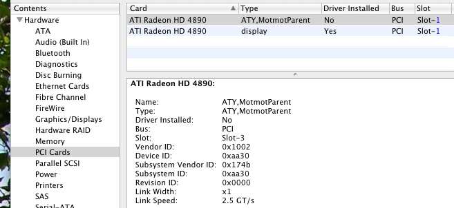

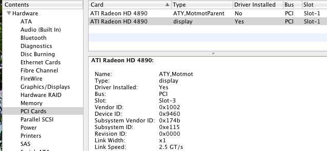

Two cards in slot 1 ...
what os are you on and what version of ati flashing tool did you use
Just in case you were referring to me : I'm on 10.6.2, using your Ati tool 1.2. As you can see in my system profile (see the attachment files five posts earlier), the Vapor-x card appears two times in slot 1, with and without driver installed. Probably I should erase some preferences, but I don't know which ones. Does anyone have an idea ?
Thanks and bye !

Brad, i wasnt 🙄 but that 2nd appearance is the sound chip on the card. Nothing to worry.

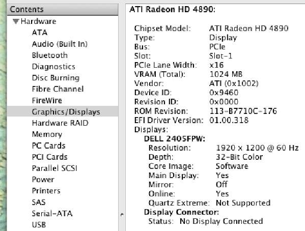

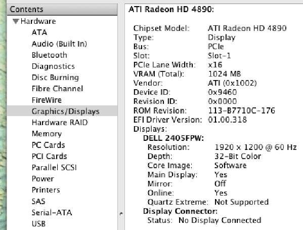

Quartz extreme
Hi there,
strange things do happen ... Now I managed to get Quartz Extreme support for my 10.6.2 system, even if the System Profiler doesn't tell. I have a 10.5.8 system where the System Profiler states that even the sound chip driver works, but no Quartz Extreme there (see attachment). As I hardly use that system, no harm is done. But I depend on using an even older system, the 10.4.11, because of some software that is not compatible with newer system versions.
Cindori, you never promised that a 4890 card would work with a 10.4.11. My question is : could I do something about that (for instance modifying some file with a hex editor, in order to get my display at least rotatable), or would that be too complicated to create ? I understand, of course, that you did already very much work enabling the last four system versions for this card. If there's somebody who knows how much trouble it is to create these QE_CI packages it is you ... As I have no idea I thought I'd ask at least.
If there's no solution, I will work sometimes with less comfort, but the advantages of the new card are much more important. In any case I thank you very much again.
