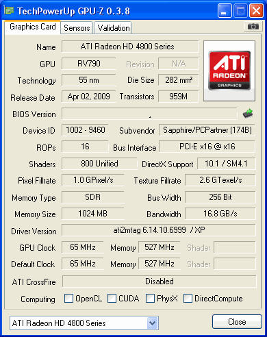

And System Profiler gives me these:
Type: GPU
Bus: PCIe
Slot: Slot-1
PCIe Lane Width: x16
Vendor: ATI (0x1002)
Device ID: 0x9460
Revision ID: 0x0000

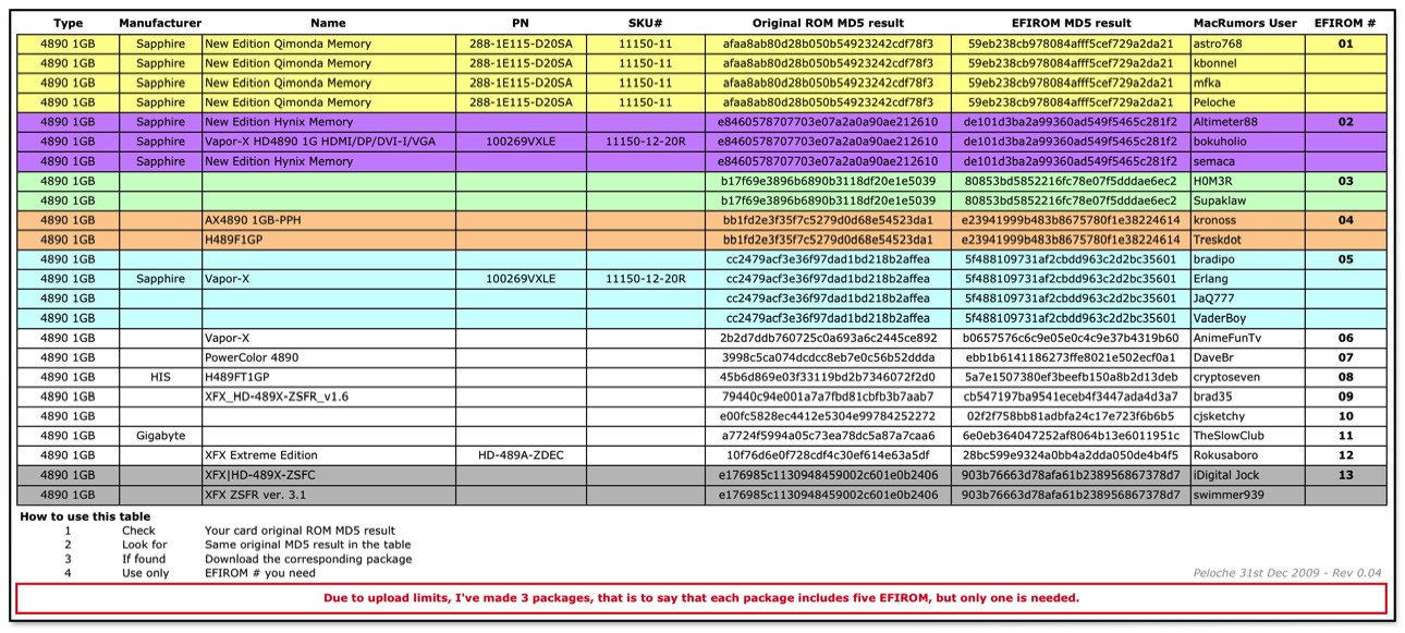

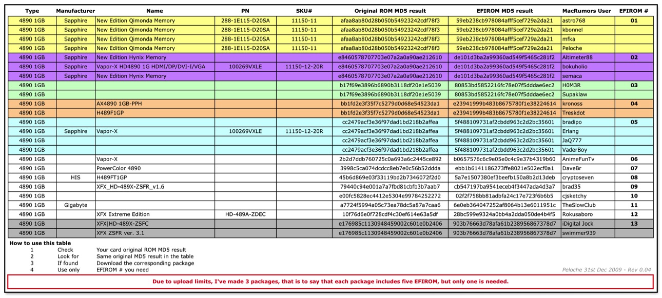

ATI Radeon HD 4890 ROMs table
Hi,
You'll find herewith a table showing information about HD 4890 cards.
If you like to complete this table or correct any mistakes please post your information (Manufacturer, Card Name, PN, SKU#).
Rev 0.02, Semaca input
Rev 0.03, Erlang input
Rev 0.04, 31/12/09: Inputs for TheSlowClub, Rokusaboro, iDigital Jock, swimmer939; Added file 11 to 13.zip

Hi,
I'm using a Sapphire with hynix memory chip with the 02 efi rom with no problems , yet.By the way , where did you ordered the convertor display port to DVi?
