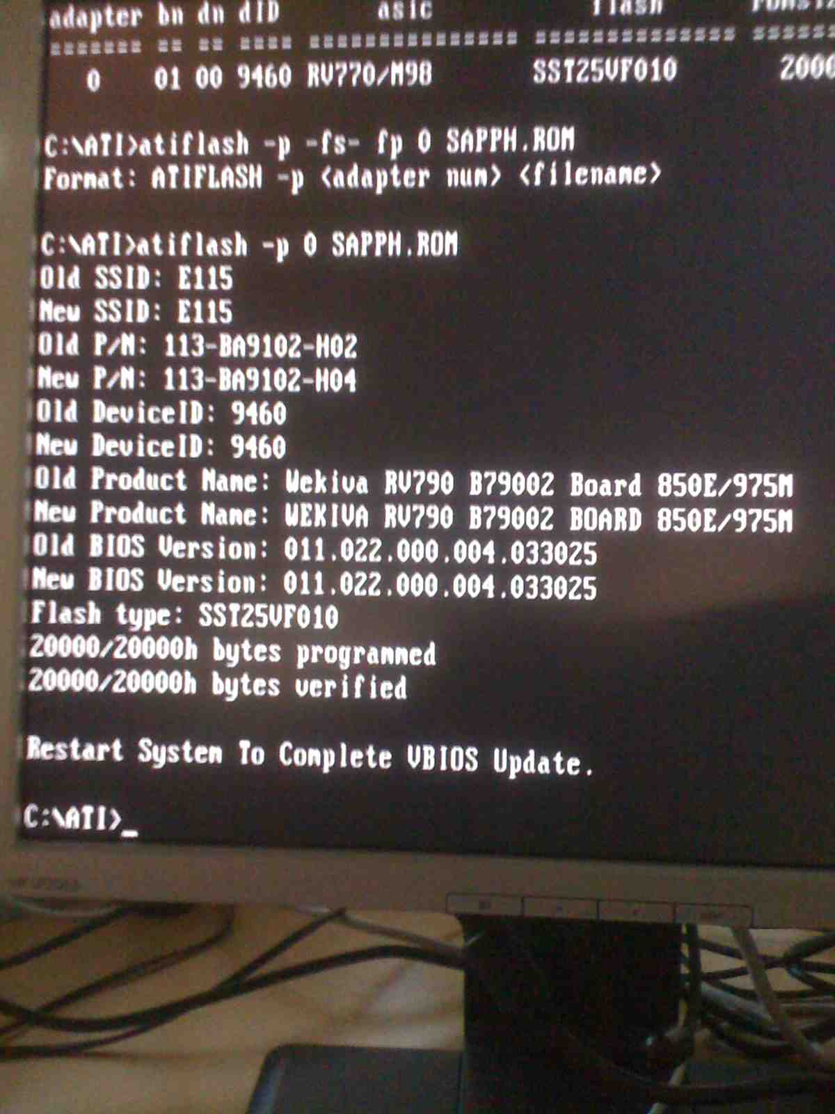

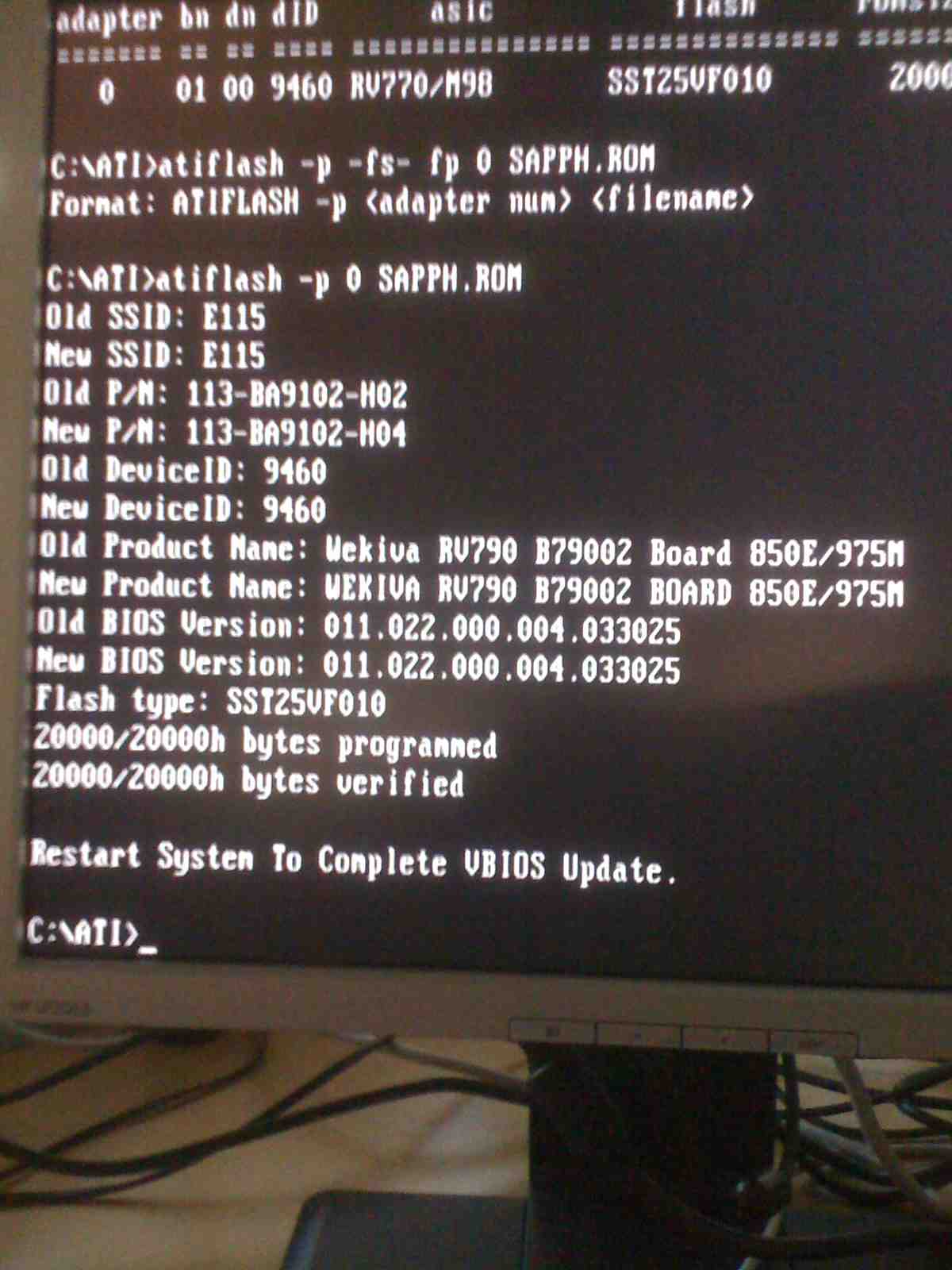

Sapphire HD4890 1G OC Version bricked
Hi every one there
I'm the owner of this
Sapphire HD4890 1G GDDR5 PCI E DUAL DVI/TVO OC Version
PN =288-1E115-200SA
SKU= 1150-04-20R
After I tried a flash the GPU was bricked
So i decided to put it back in my PC. and forgot about binging it to the mac (I don't need it that much on mac)
Trouble is that :
-of course dumb as I am , I got no backup ROM;
-All rom I've tried so far just don't work the "atiflash -f " sequence command is successfull BUT on reboot :
kind of blank screen : (gray vertical rays and nothing else)
I've been looking through forums for the last two days ; all i see is about some trouble regarding the power supplied ; for this I checked : I'm on a 700W Tagan ; I've plugged the 2*6pin connectors of my card. So...
Just one thing : most people seems to have a (6+2 ) and 8 pin power plugs on their card; mine is 6 and 6 pin.
Well my question is this one : how can I flash back this card to it's original firmware and back to it's windows world
I'm not willing to bring it to mac anymore;
so please those who have an original ROM for this model , thanks to send it to me;
And those who know how to proceed; or some tools to check what is going on ?
another utility to use for flashing ?
Your help is precious...

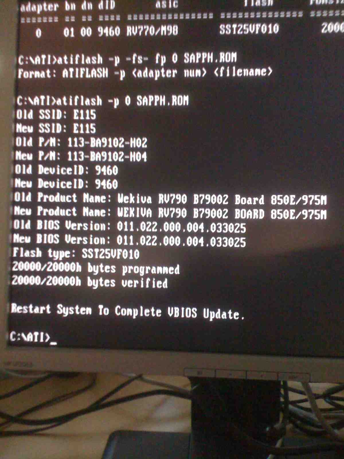

Hi all,
Just realized that during the flash I got a new P/N "Picture below", is that normal ?
Thanks for your help.

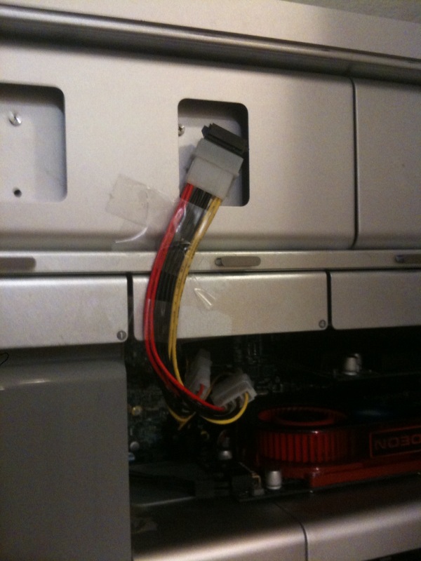

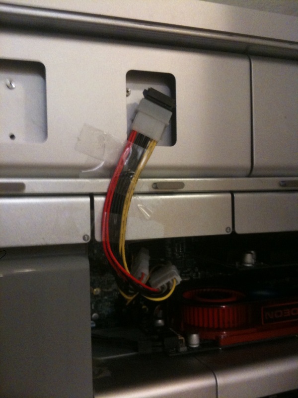

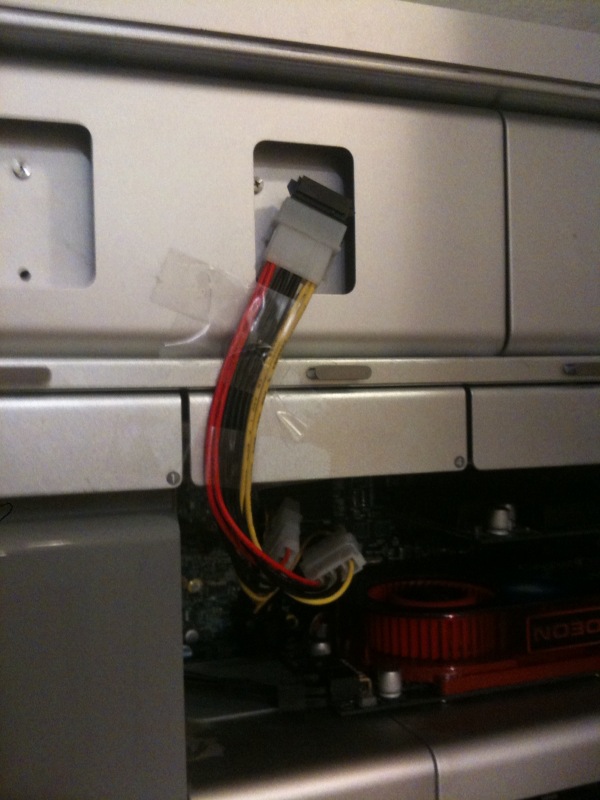

HIS H489FT1GP HD4890 1GB In Mac Pro 1,1
I purchased a HIS H489FT1GP HD4890 1GB from newegg, 220$. This is the "Fan Turbo" edition. It works under bootcamp fine with Windows 7. I am using the awesome flash tool to inject drivers and QE_CI under 10.6.2. MAKE SURE YOU INSTALL THE COMBO UPDATE FOR 10.6.2. It will fix potential kernel panics.
Will be flashing soon, but I am happy with the injected drivers.:apple:
I routed cabling from the optical drive. The door does lock shut, but it is a little tight. I have an Mac ATI PCI-E cable on order that I will use in concert with a 6 to 8 pin adapter.
look in my sig for superdrive cable routing
you dont need 6 to 8 pin adapter. 6pin works fine in a 8pin port on the gpu.
use the 5$ to donate to ati flashing tool instead 😀
PN =288-1E115-200SA
SKU= 1150-04-20R
Up for this ...
I've tried about a dozen ROM none working...
One of you guys must have an Original Sapphire DUAL DVI OC ??
If so please...
I need to check witth a excatly same ROM.
that way I will know if the card is dead or not.
(For the record :
-no signal out (except from gray vertical rays on a blank screen);
-back in a PC under WinXP beside a old pci vga card so i can boot after every flash i tried I reinstall drivers to windows then activate the card and everytime Blue screen with "error in ati2dvag.dll ... infinite loop :
// The driver for the display device got stuck in an infinite loop. This usually indicates a problem with the device itself or with the device driver programming the hardware incorrectly. Please check with your display device vendor for any driver updates.//
Help really needed ;
if one know how to be sure if it is a problem on the card side (dead; bricked ... ) or is ti just a rom trouble.. (for that just have to found the good ROM)
On one side i got hope and on the other , better start grabbin' some money
help needed !
Thanks
