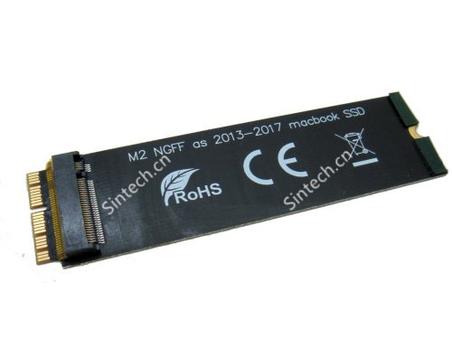

Can anyone please advise if all of the Sintech adapters are ok now ?
For me, only the long black 'ST-NGFF2013-C' version below worked properly. Do the shorter / cheaper ones work ok now ?
I received the short black adapter about 2 weeks ago and it works perfectly in a 2017 Air with an HP ex900.
I also have one of the earlier short green adapters in an early 2015 Air with an intel 600p with no issues.
