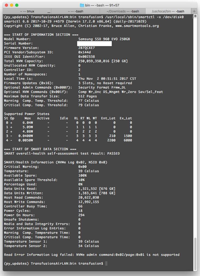

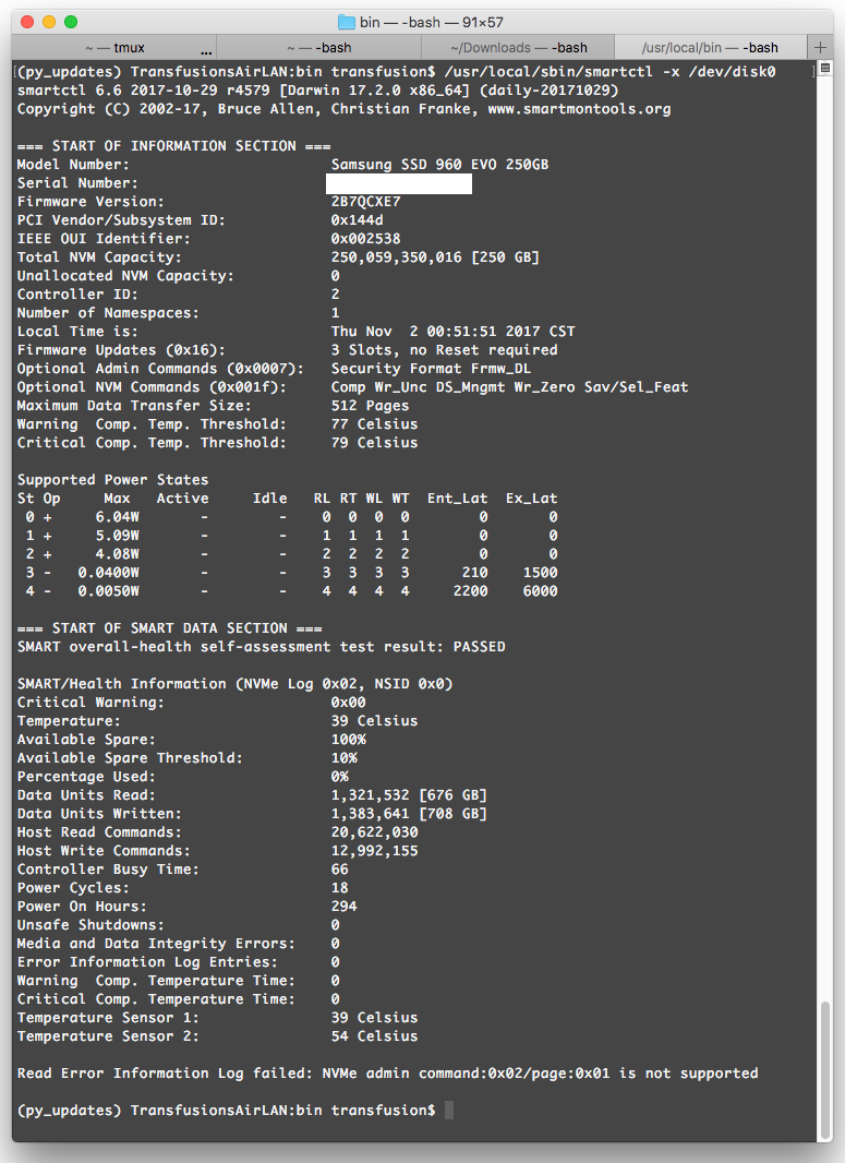

I would like to report that the nightly builds of smartmontools support NVMe drives already
Apple NVMe controller in 13.0 dose not support S.M.A.R.T., also it dose not in 13.1. I have checked Disk Util.app, Disk information dose not shows S.M.A.R.T. result.

It's a nice news. Apple NVMe controller in 13.0 dose not support S.M.A.R.T., but it dose in 13.1. I have checked Disk Util.app, Disk information shows S.M.A.R.T. result.
I only see SMART support in my original Apple SSD, not my 960 EVO, it says SMART not supported there.

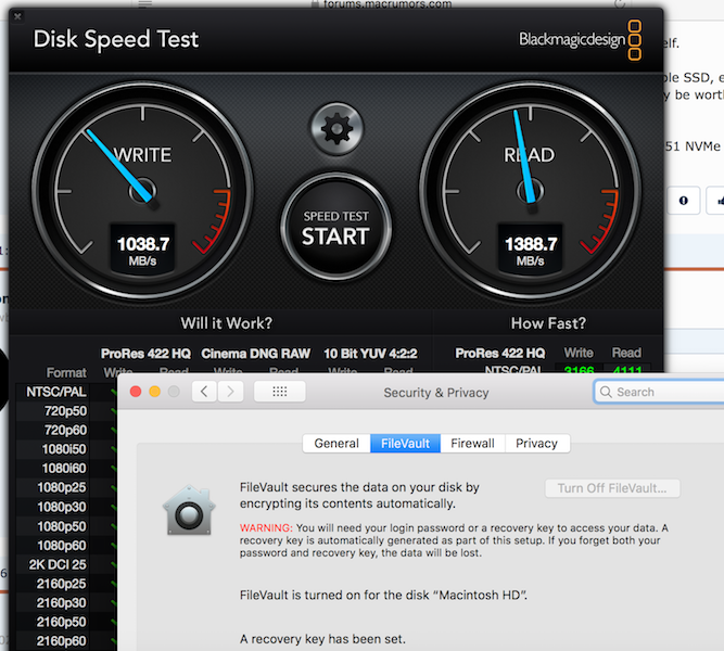

i attached speed test of my orginal 128GB ssd from mbpr 2015 13" and SM951 NVMe with chenyang adapter.
so far no issue with my ssd, no reboot issue,no sleep issue for hours...
[edited] i can confirm that sm951 NVMe has no issue at all.. thanks to all fellows in this thread and this great forum!! .
i just updating to 10.3.1 HS and the write/ speed of my ssd decrease about 300-400MB.
does anyone got this issue too after updating to 10.3.1 HS ?
or
is it because i turn the fileVault encrypt on ?

Still can't get any SMART-related software to recognize my 960, though.
