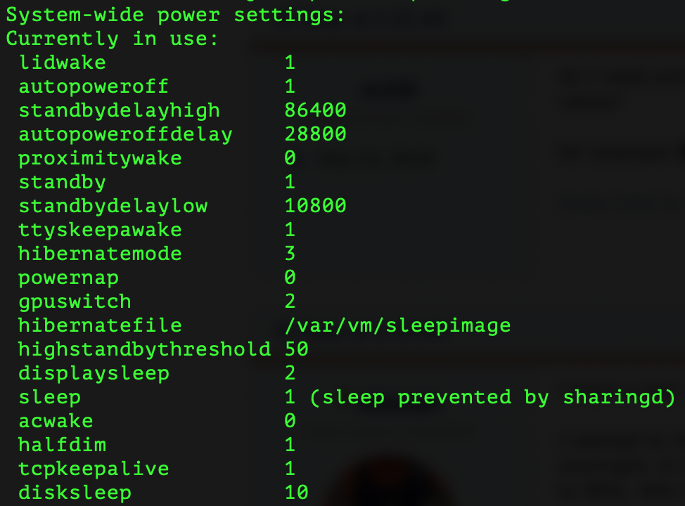

@Allistah, might the "sleep prevented by sharingd" be part of the issue? That line shows up in several related threads and consistently refers to having sharing enabled directly, or using some app that enables elements of sharing.
FWIW my 11,5/Sabrent 2T did the same thing as yours; it seemed like a lot of current usage considering I closed the lid at 100%, checked it about 10-12 hours later, and the battery was down to 93% or so (I hadn't learned about the sharing service blocking deep sleep at that point).

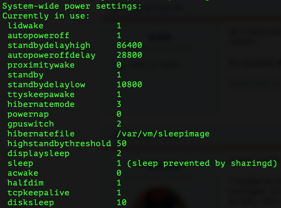

This would only be a problem if there's a bug within that particular feature of the system which has happened in the past, i believe when mojave was first released there was some problems with the computer going to sleep properly. If this was actually still a problem he/she would be experiencing the same issue with the OEM apple ssd but in this case the problem is simply because the NVM drive draws more power.
