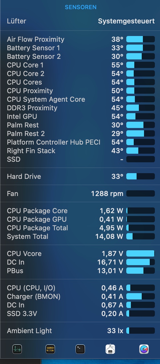

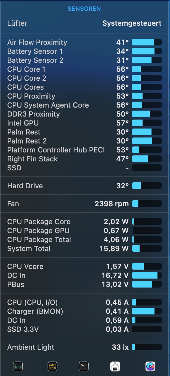

I upgraded macbook pro 2015 13 with Adata SX8200 Pro 1 TB one year and a half ago. Everything worked perfect since today, but energy consumption and battery drain was quite high.
Yesterday I managed installing NVMeFix and SSDPmEnabler. I'm on Big Sur 11.2.1. There is a significant reduction in Idle Power consumption now:
Energie Consumption on Idle
Before (without)
SSD 3,3V Energie Consumption IDLE: 0,2A
With NVMeFix and SSDPmEnabler
SSD 3,3V Energie Consumption IDLE: 0,03-0,05A
Before / after

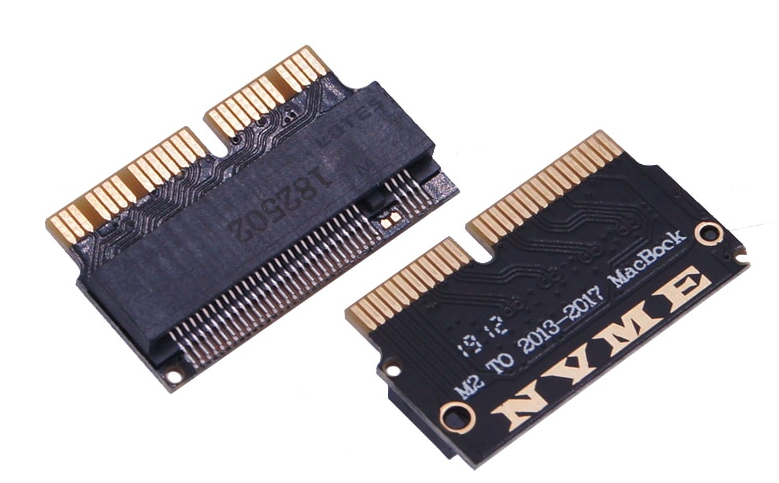

Or are my hibernation issues due to the adapter I'm using, which is not the Sintech that's supposedly the only properly working one?

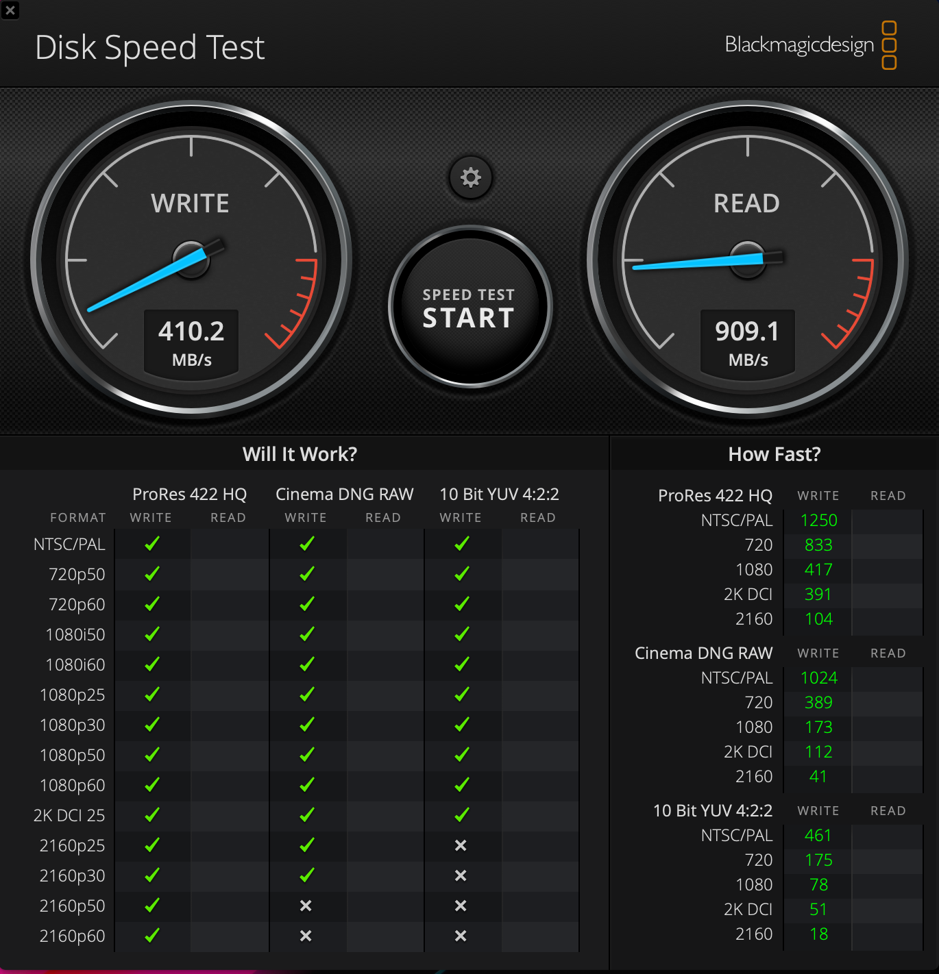

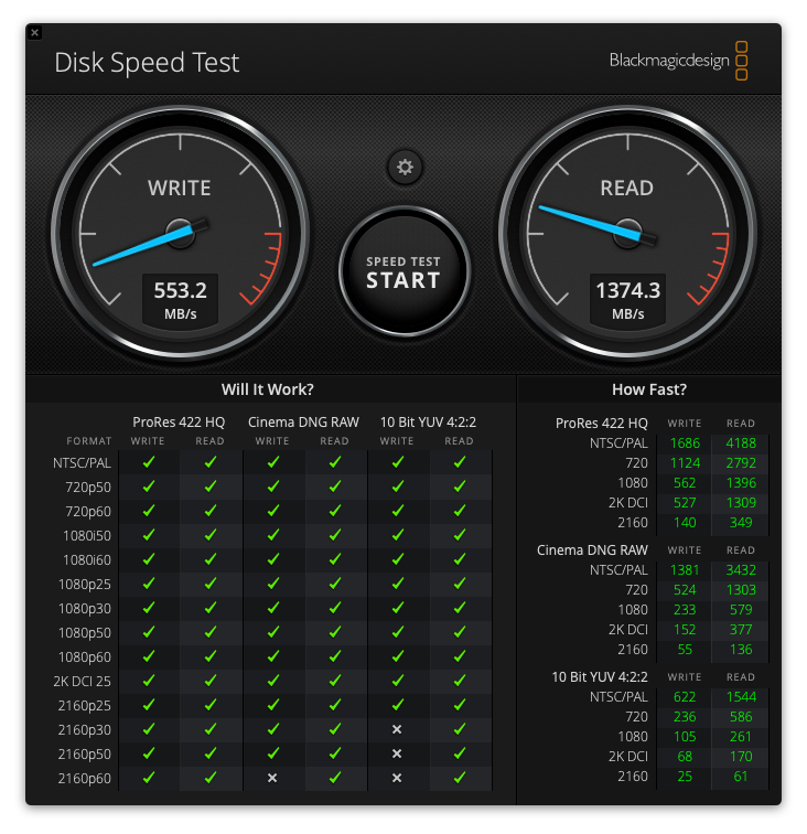

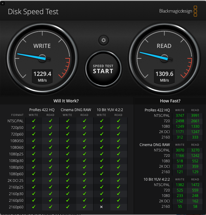

Hello,
I have a MacBook Pro retina 13" 2015 with crucial P2 500gb.
I installed SSDPmEnabler only.
But I am quite disappointed because write and read speeds are not high.
But we can see the difference with SSDPmEnabler.
I happened to use the same adapter with my MacBook Pro 15 (mid 2015) and a Kingston A2000 500GB. I have the issue where the screen stays blank for a whole minute after the Mac goes to sleep (when I shut the lid or leave it idle for a few minutes). It also takes much longer for the computer to respond to the power button being pressed to start up and sometimes Safari freezes on some webpages.
I've tried resetting the PRAM, SMC, installing Lilu+NVMeFix and so on but nothing seems to help.
I'm wondering if its an adapter issue or the SSD or simply incompatibility of drivers of some sort?
Adapter issue does seem likely.

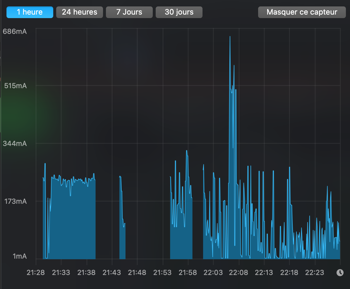

Crucial P2 500GB, mba6,2. (Big Sur 11.2.1) With $2 alibaba adapter!
