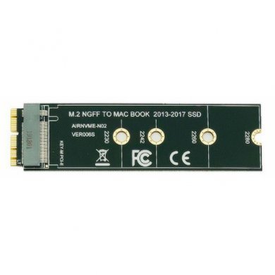

In case, new comers to this thread wonder what adaptor/NVMe I would pick now if I wanted to redo my setup.
NVMe surely will be SK Hynix Gold P31. No compromise in performance. Very efficient power consumption wise.
For adaptors, as said before, I'll go for LONG adaptor for better mechanical structure and support. Hence, pins between adaptor, NVMe, apple socket will always be in contact (yes, I meant always 24/7 under all weather conditions..)

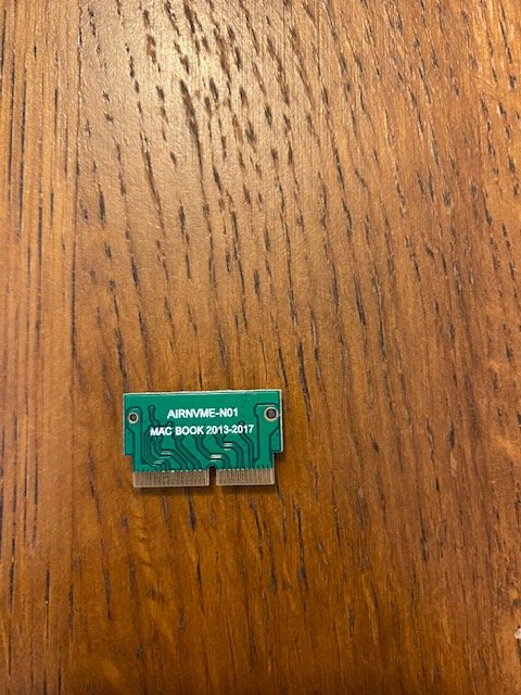

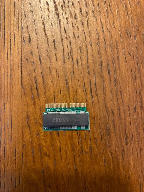

Hi All,
First time post from here from sunny Ireland. I am sure this question has been asked before, but I feel I have to ask it again to be sure that I get this right, so sincere apologies if IS a repetitive question. I was gifted an absolute mint condiiton MacBook Pro (Retina, 13-inch, Early 2015). It has the base configuration SSD of 128gig. I am looking at buying this SSD.
I asked a question on Amazon was the SSD compatible and they said no. I take it because it needs the adaptor? I have an adaptor, see picture below. Is this the correct adaptor?
latest macOS installed 12.0.1 (21A559)
Any advice or tips would be excellent.
Thanks folks.

Hi All,
Thanks folks.
A few posts up someone was talking about using the exact same Crucial P2... Yes, you will need an adapter - it will work.

Just same mac and Nvme model here. Woeks li9ke a champ, with an adaptor. Those in the pictures are right.
This is the one I bought
An advice. Install ssdpmEnabler, you will save a lot of power=hours of autonomy.
Yes that would w

Yes, it will work.
Generally speaking, green adapter is an earlier build version, and normally we would recommend one with black color PCB, but green one will work as well.
And you might want to bump your OS version to 12.5.1 , earlier Monterey still have some bugs here and there.

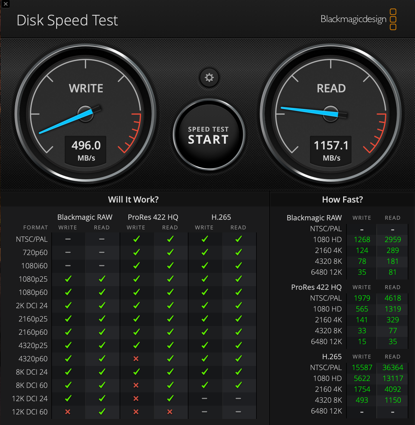

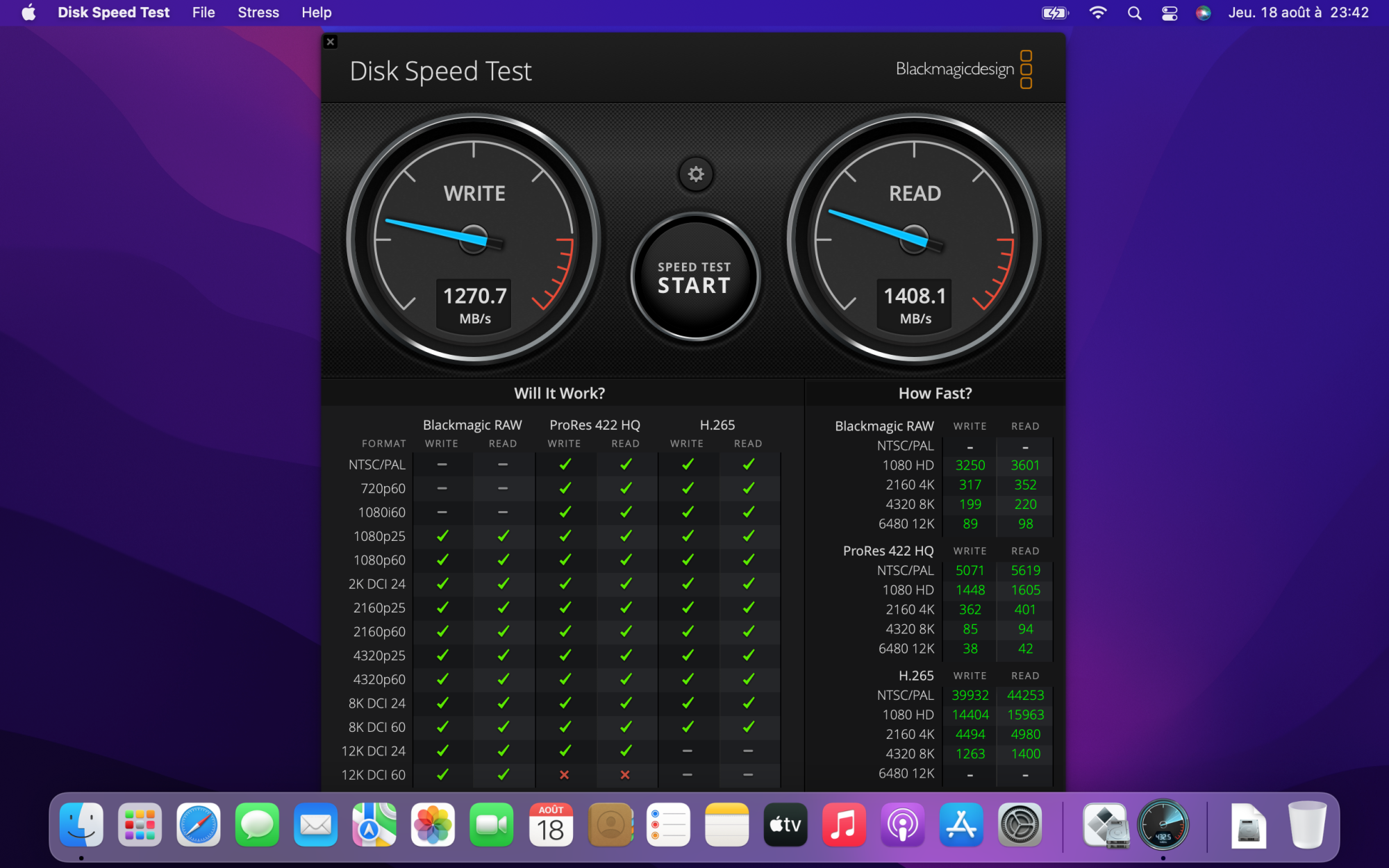

I have a MBP Pro Retina 13" early 2015 with 128GB SSD.
I updated from Mojave 10.14.6 to Monterey then replaced the SSD and installed Boot Camp in order to check the firmware version which was already up to date, everything else went smoothly.
You can see above the speed test before and after.
Now the last thing I'm considering is installing a kext for power management.
I installed iStats and currently it's 0,35 A under heavy use.
Would you recommend me ssdpmEnabler or nvmefix for my config please?
Thank you very much!
