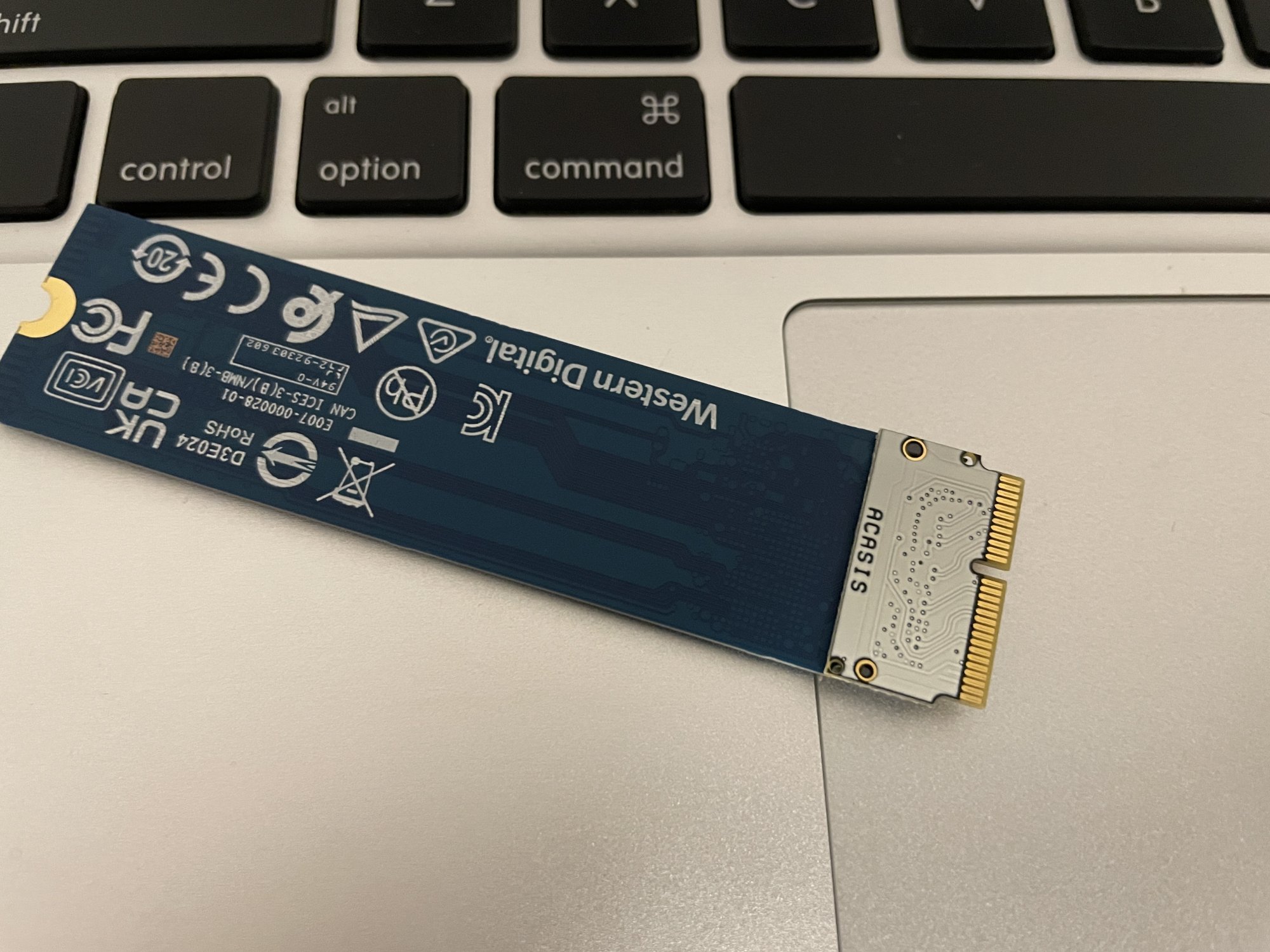

yes thank you, I took the short adapter from sintech
All that remains is to be sure between the 2 SSD models

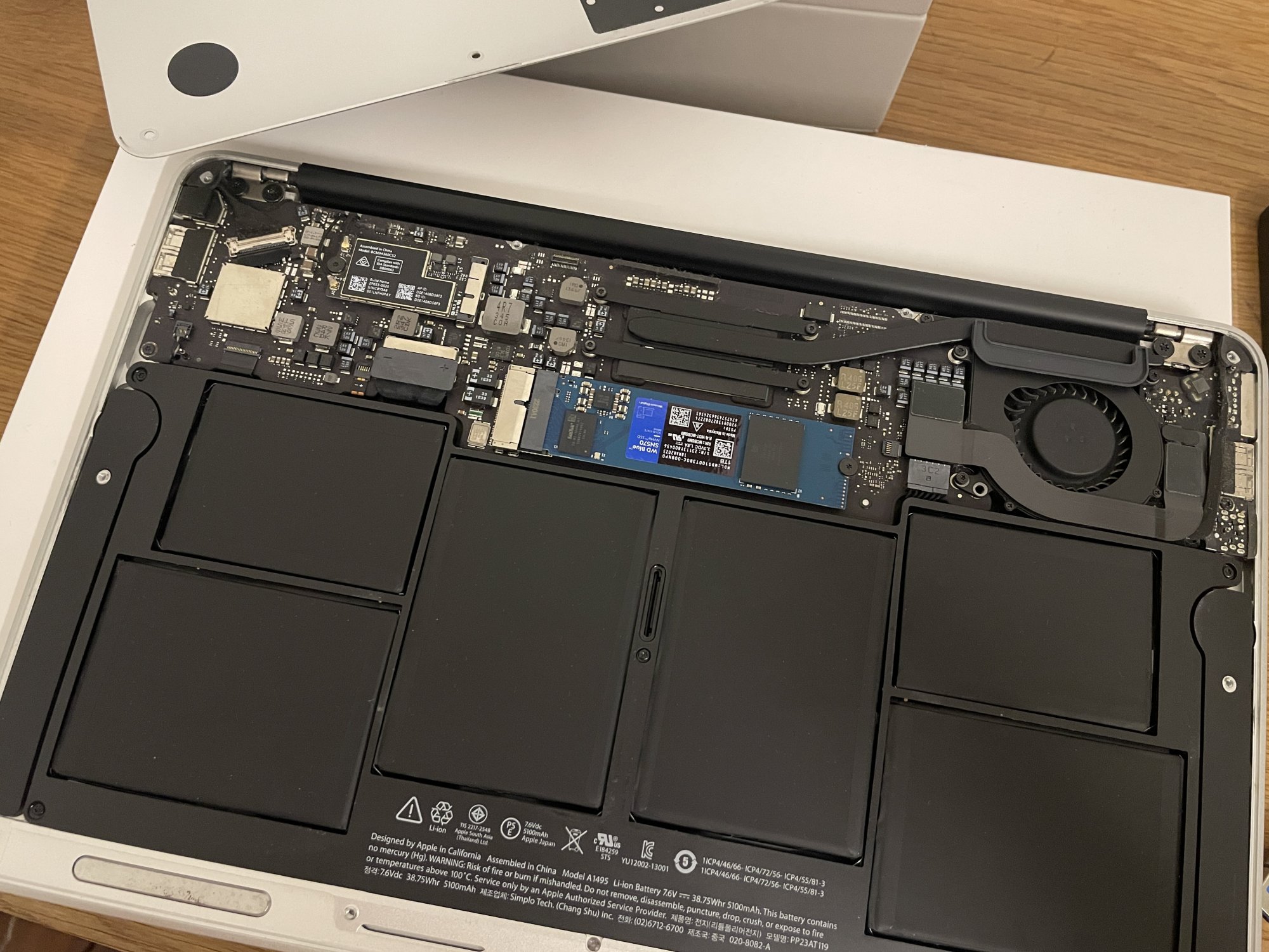

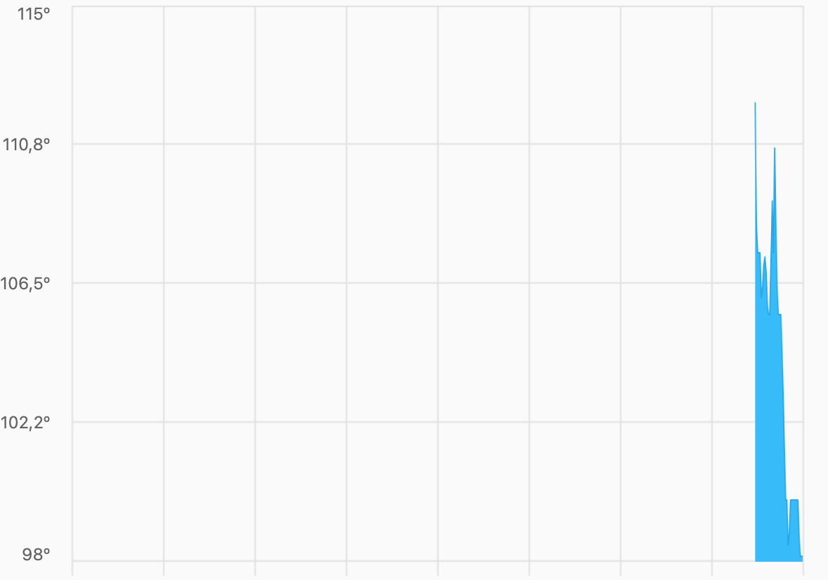

So i had my first kernel panic which the MBA was in sleep mode it had got really hot
Any suggestions to avoid repeat
Any idea of what your panic report says? (issues with sleep/hibernate are not unknown)
You may want to try disabling sleep/hibernate first, it is known that your 2014 model will not support these drives at lower power states..
What’s the price difference like in your area? (P31 is probably your best option if the price isn’t too dissimilar, otherwise the SN570 is a great value option if the difference is too great..)

MacBook Air Early 2015 was updated with Sintech short adapter and SP A80 in 2021...
Initially, it had some kernel panics all related to NVMe... I solved the issue by placing Kapton tape on the laptop case under the SSD. Actually, the SSD was short-circuiting with the laptop case and the Kapton tape isolated it. After that, all panics stopped.
I describe this process somewhere in this thread...

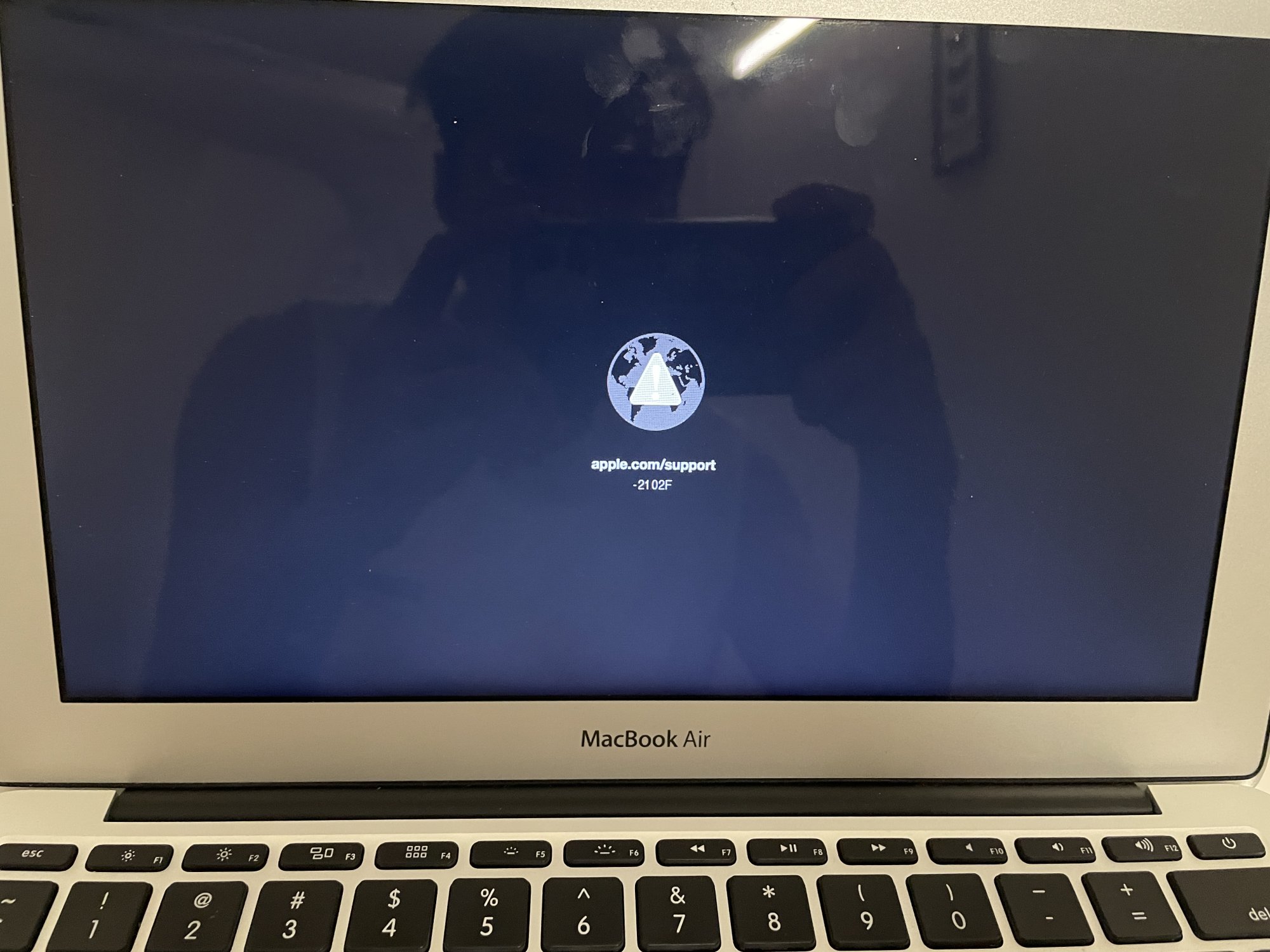

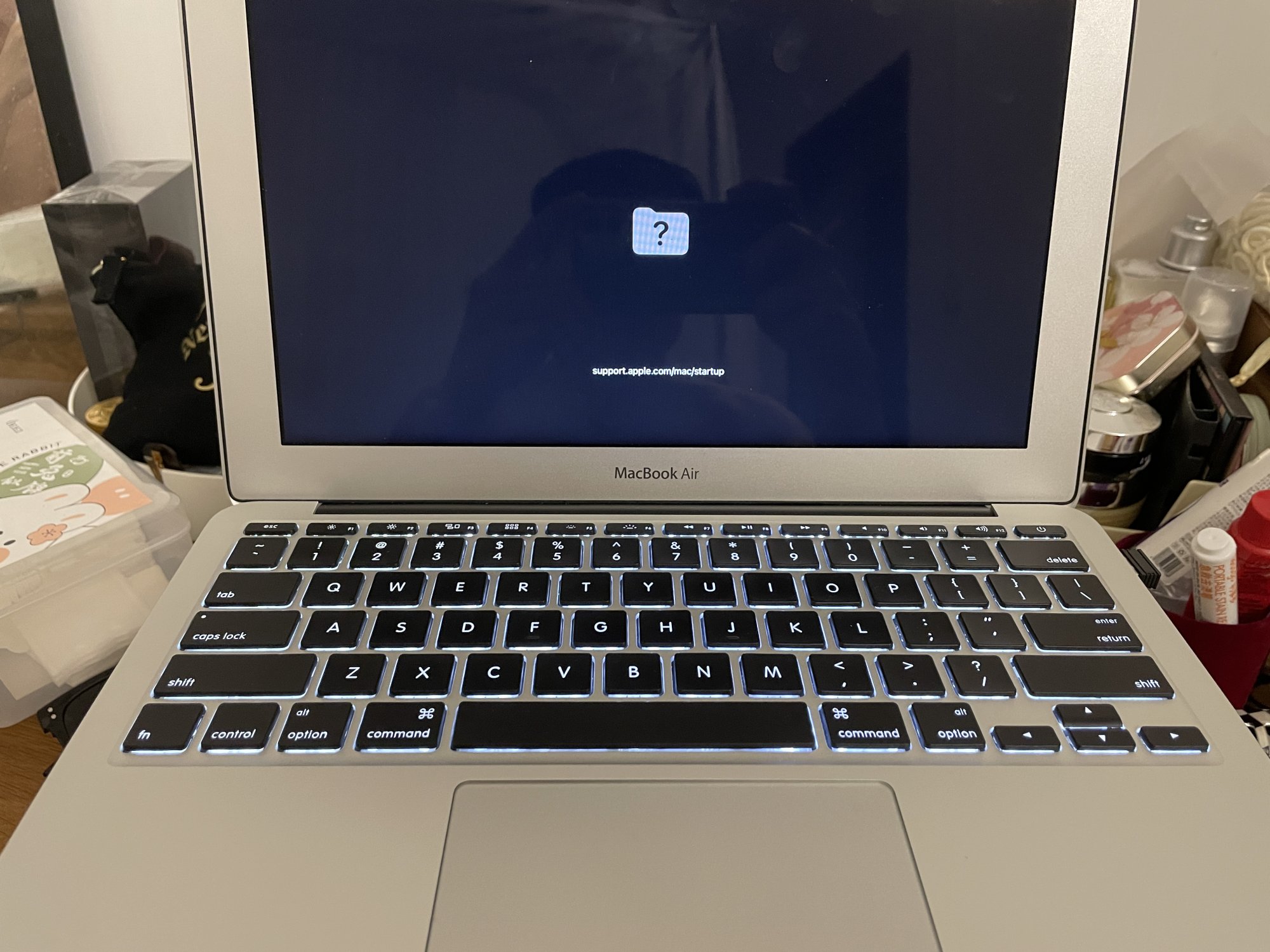

I just upgraded my SSD. Anyone experienced Boot loop before after installing new SSD to MacBook pro 2015?
Tried installing Monterey but after installations of the first files in recovery mode it reboots and says about 29 minutes left.

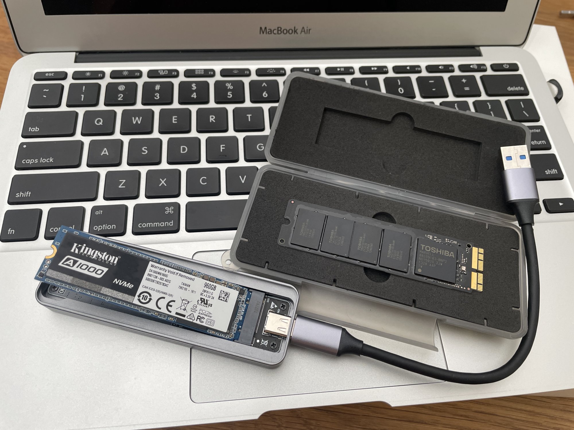

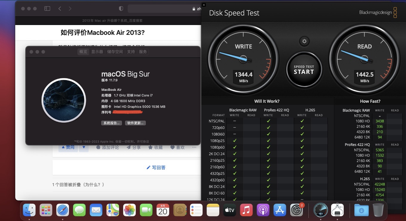

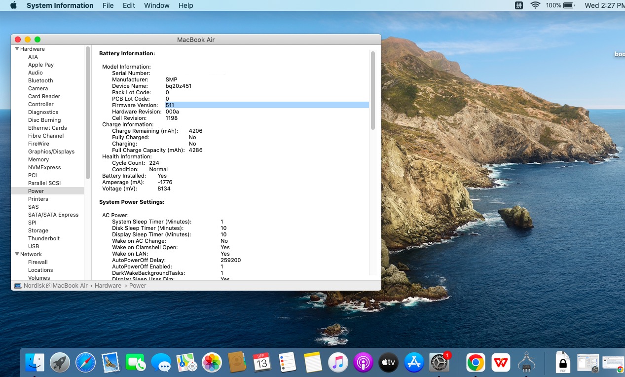

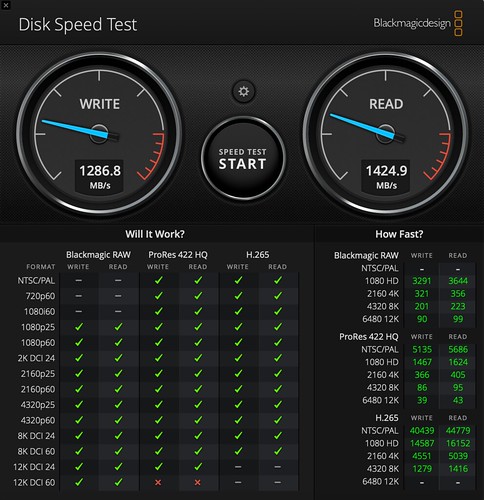

I upgraded my MacBook air in July, share my upgrade SSD experienc.
Computer model :2013MacBook Air (A1465)
My first upgrade to SSD was using Kingston A1000 480g, and there were no abnormalities after using it for a month. After that, I replaced it with a larger capacity, which is still 960g for Kingston A1000,After installation, there were issues with hibernation, resulting in crashes and restarts,I thought it was caused by an incompatible hard drive, but even after replacing it with Western Digital sn570-1TB, there was still a problem of not being able to wake up during sleep, leading to a reboot. Obtained from searching for information, there is a chance that 2013-2014 macbooks will experience sleep problems,The solution is to upgrade the system Catalina or Bigsur with the original SSD (upgrade the hard drive firmware),Check if your firmware is above 471,I am updating to 511,After using it for two months, there was no sleep issue and there was a significant improvement in speed and capacity. However, the big sur system was too power consuming, so I downgraded it to Catalina.
The read and write speed has increased by four times, reaching up to 1400mb/s

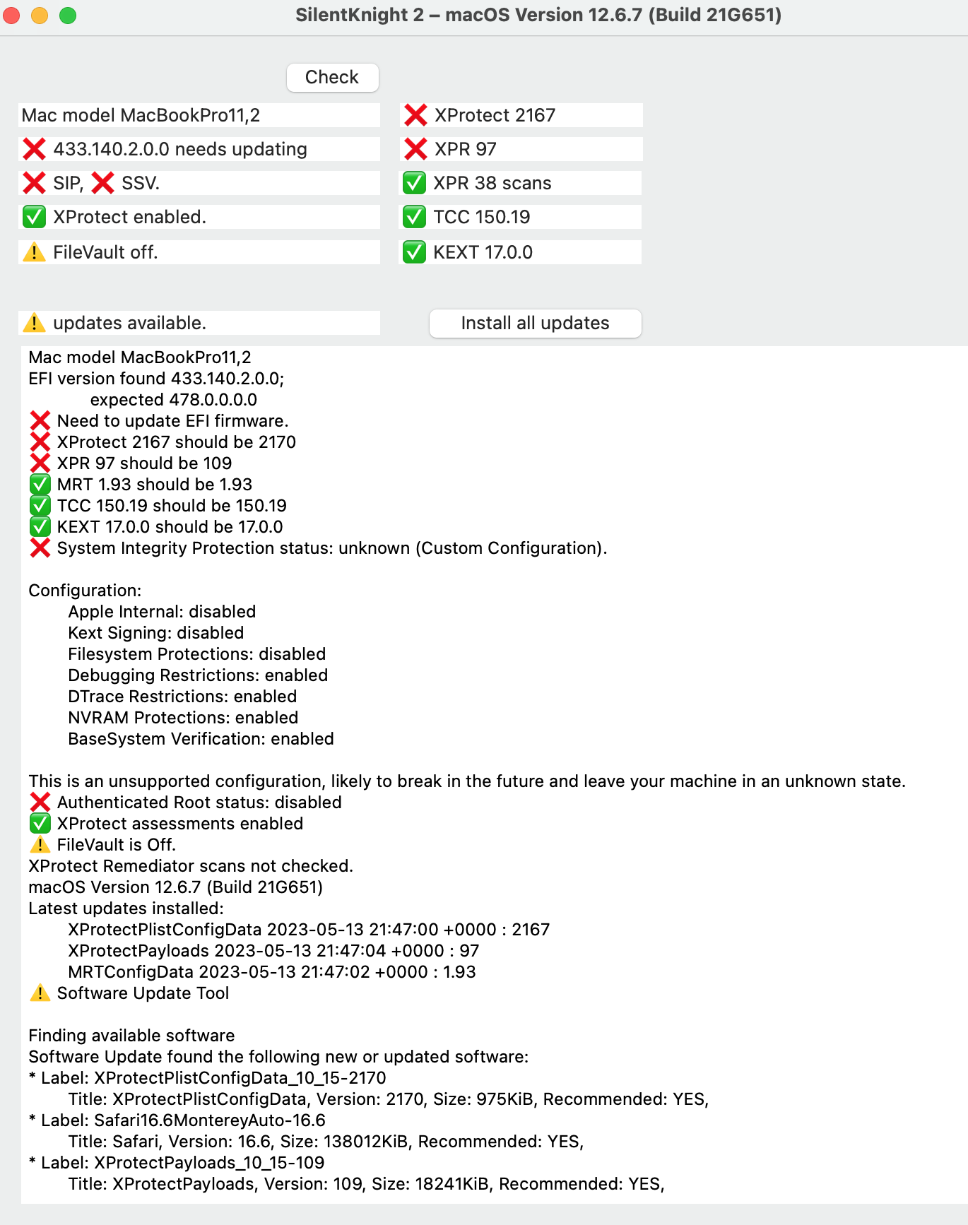

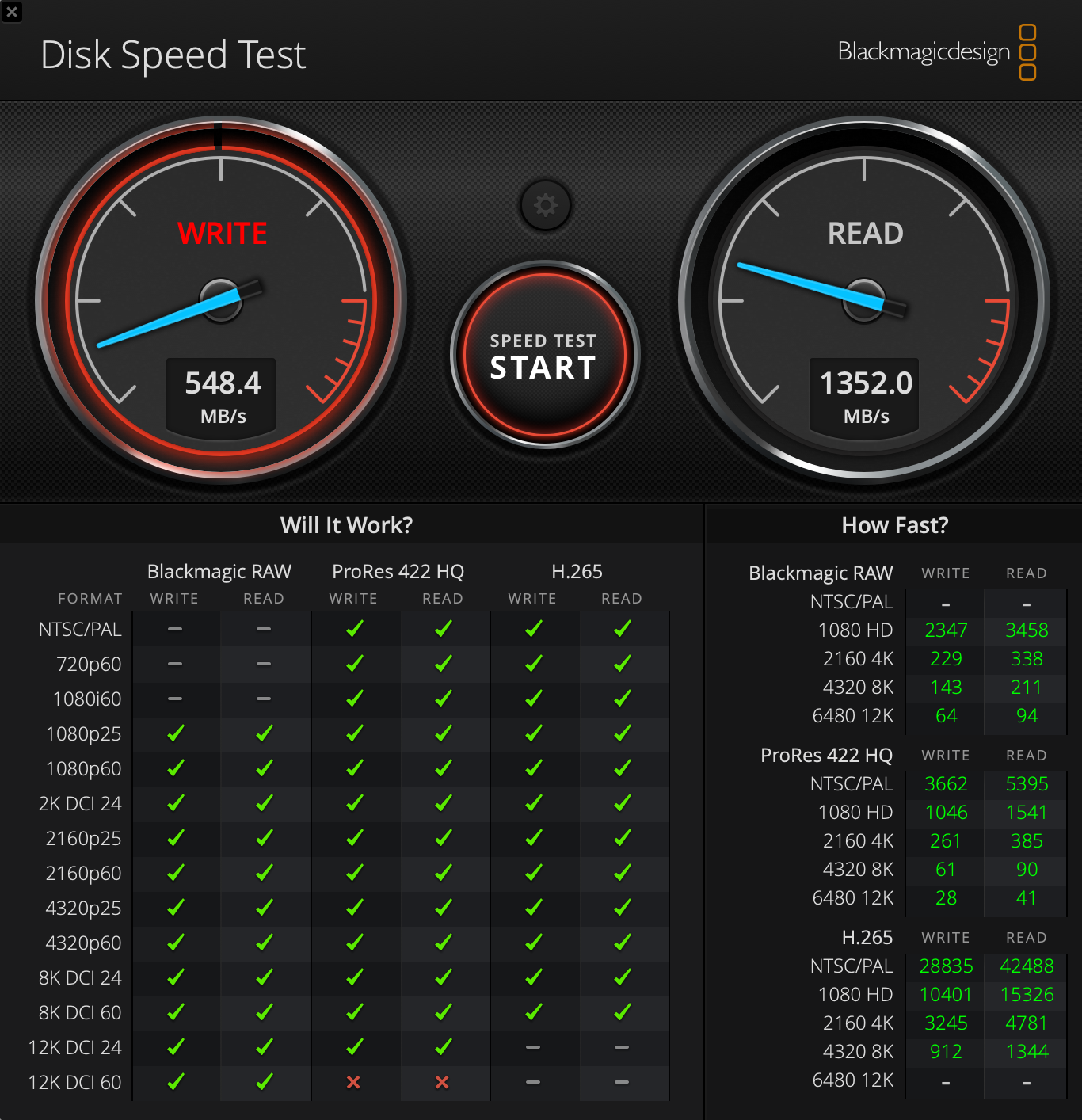

Can someone please help me troubleshoot these kernel panics? They have been happening for the past 6 months. Would be forever grateful!
MacOS version: Montery 12.6.7 (Via Open Core Legacy Patch)
Mac: MacBookPro11,2 (Retina, 15-inch, Late 2013)
Processor: Intel Core i7 2 GHz
Boot ROM Version: 433.140.2.0.0
SSD: Aura Pro X2: 500GB (firmware version: latest comes standard installed) + (no adapter needed)
link to pmset -g output on pastebin.com: https://pastebin.com/x0QuJb9a
link to .panic file(s) on pastebin.com: https://pastebin.com/8Y70zc6C
SSD speeds in BlackMagic benchmark screenshot: View attachment 2245047

Could someone please have a look at these kernel panic reports causing MacOS to freeze (and requiring a hard shut down)?
The MMIO error could be caused by a number of factors, it still seems like there is some more things you can try (before ruling out
- OS/software - did anything occur on the different macOS? (before you installed OCLP?)
- System - double check EFI version (use SilentKnight or run eficheck from the following path: /usr/libexec/firmwarecheckers/eficheck/eficheck --integrity-check. You may also need the original Apple SSD as well.)
- Health of drive - use DriveDX to check internal conditions (if the drive is going bad something should show up, I think this is probably what's going on but can't say without another unit to test...)
1 - I was on Big Sur for a few months after the new SSD went in (official MacOS). No issues. Then I went to Ventura OCLP. No issues for a few months until performing an OCLP Ventura update. Kernel panics started after that and continued with each Ventura OCLP Update. Then I went ahead and downgraded (clean install by wiping SSD) to Montery OCLP. Less kernel panics now, but still plenty.
2.1 - This is what the command line returns after entering that line into the terminal:
"ReadBinaryFromKernel: No matching services found. Either this system is not supported by eficheck, or you need to re-load the kext
IntegrityCheck: couldn't get EFI contents from kext"
2.2 - A screenshot from SilentKnight:
3 - Copied the DriveDX report to pastebin: https://pastebin.com/zRYDmF1M
Looks ok to me.
Much appreciate your help in trying to solve this! :)

Try removing opencore completely and then reinstall os
You could update the EFI firmware: replace your present SSD with the original Apple OEM SSD, and install the latest version of Big Sur on that. Latest version is currently version 11.7.10. The result should be an updated firmware, so, back to your current SSD.
I don't know if updating the firmware will result in no more kernel crashes, but it's just "fixing" something that is reported already. Maybe you will also find that the firmware update helps your other issues.

So i had a second crash where the MBA shutdown in standby please find below the error report can anyone guide on to the reason for the error
panic(cpu 0 caller 0xffffff801e2d2860): nvme: "Fatal error occurred. CSTS=0xffffffff US[1]=0x0 US[0]=0x3 VID=0xffff DID=0xffff
. FW Revision=234110WD\n"@/System/Volumes/Data/SWE/macOS/BuildRoots/5f3ad454b9/Library/Caches/com.apple.xbs/Sources/IONVMeFamily/IONVMeFamily-557.120.1/Common/IONVMeController.cpp:5499
Is your firmware up to date? (BootROM should be at least 4xx.0.0.0; builds of this index should have the sleep/hibernate crash issue that pervades your particular model).
All hardware in order? (check for fit and proper contact, if it still persists after this possibly look at adapter or drive?)
Checked SSD firmware? (using an adapter, plug drive into PC, use WD’s drive tool to check)
What happens if you disable sleep/hibernate completely? (whilst this is harder on the battery it should mitigate any problems related to deeper sleep modes)
EDIT: It looks like your EFI should be up to date (log data says you are on the latest 11.7 build),
which should rule any Mac firmware issues out..)
