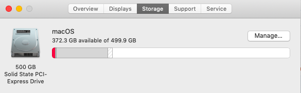

I just wanted to report in on my Mid-2014 15" rMBP and the WD SN570 2TB. It has been pretty smooth sailing for the past couple of months overall.
I rarely run on battery alone, but I wanted to test the battery drain whilst in sleep mode overnight . It was probably around a 5% drain in sleep mode with no active apps in memory, so that seems to be fine. There was a pretty long pause for the desktop to appear on wake, so I may have to adjust the PM settings further.
