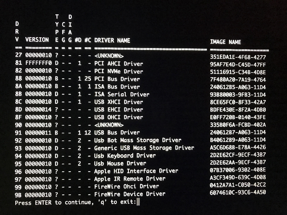

Just updated a 13-inch MacBook Pro Late 2015 from 10.13.4 to 10.13.5, using the combo update..
looks like the BootROM was updated from MBP121.0175.B00 to MBP121.0176.B00.
If someone were to tell me what to look for, I could report on whether or not the NVMe driver was patched/updated or not..

Yes, the output is the same as “bless” with the modified UEFI capsule (SCAP). EFIUPDATER (per the paper referenced above) seems to be picking the SCAP/FD files from a directory based on MacBook model and detected EFI ROM versions. Force-update in EFIUPDATER correctly picks up the modified SCAP (in my case, 0146 to Modified 0146 on a MBP11,1): I can see the SCAP file being copied to the EFI paritition and the NVRAM variables for boot changing, but it is not actually flashing the ROM upon boot - neither with the NVMe drive nor the stock SSD. There is probably some checksum/signature check that will need to be defeated, and that check is not in “bless” or “efiupdater”.
I had high hopes that 0146 on MBP11,1 introduces proper NVMe support (the DXE section did change between 0145 and 0146).
Yeah, the check is either at the EFI level itself or possibly even lower down if the spi flash is managed by some additional microcontroller. Maybe something can be set through the EFI shell to temporarily unlock the the EFI, but I kinda doubt it.
