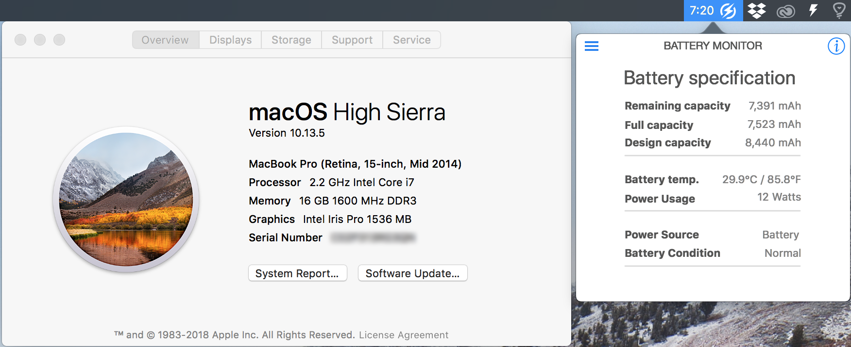

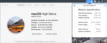

finally
upgraded my MBP mid 2014 15" to intel 760p 1tb ssd with sintech black (long) adapter
everything looks goods, no problems. Restart, shutting down works perfect. I do not have bootcamp so can't test problems with that.
Tonight I will do long sleep for Mac and in the morning will see...

How's the battery consumption?
with the naked eye it's look like it's not drain faster than original ssd in usual scenario (browsing, youtube etc...) but i will test it more accurately in next days. And in usual use scenario it's absolutely not heating

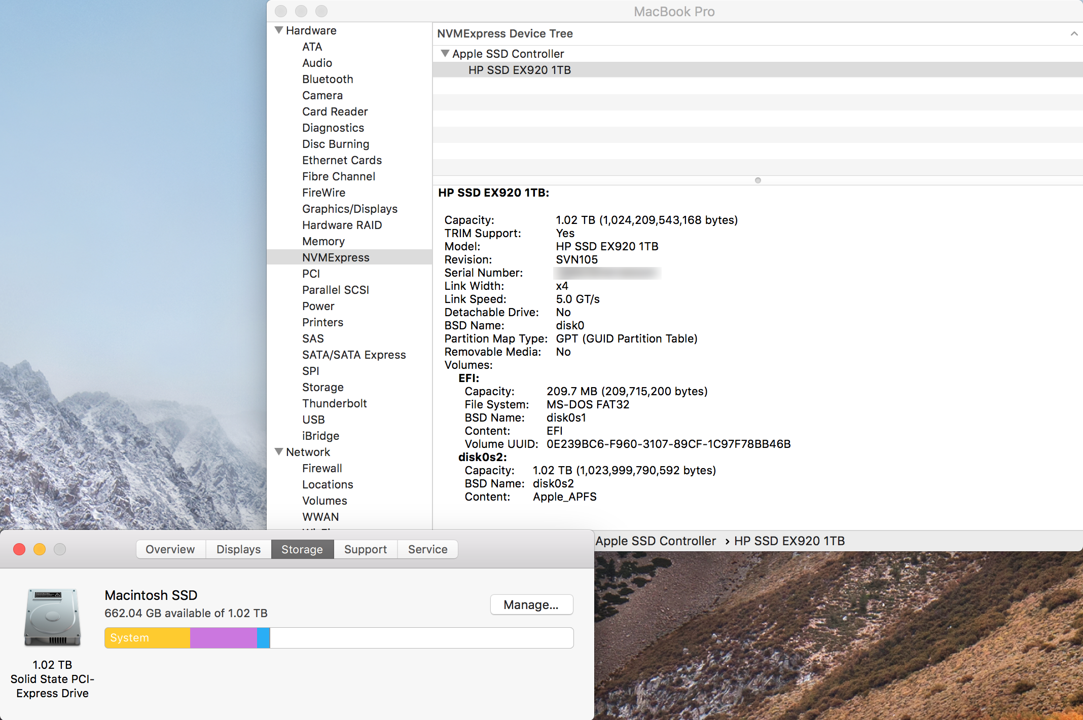

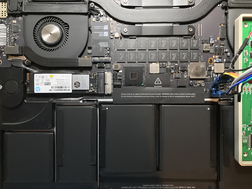

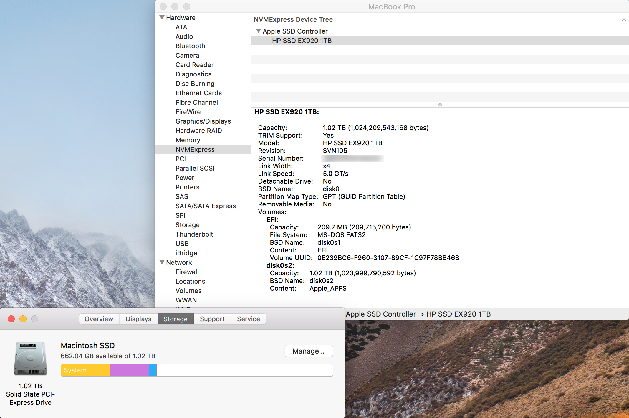

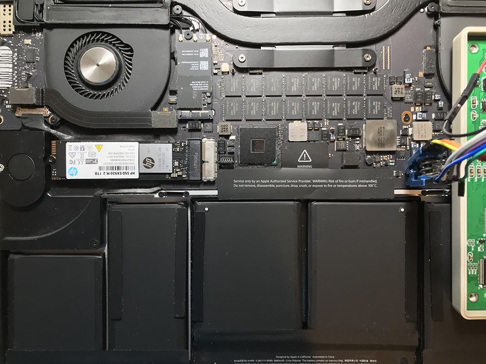

So just did this to mine. Used an HP EX920 1TB drive
Drive installed and flashed the firmware w/ the 2015 NVMe driver:
Restored my backup and everything just works. No delay when booting, detects as an internal drive, etc.

Yes he/she used a programmer - you can see it and the clip on the right hand side of the first photo. It presently is the only known way to flash the bootrom with a hacked/modified one in these machines.

Yes I have a programmer (in this case I used a GQ-4X which I had from my car hacking days, but there's a bunch that should work). I also have a rasberry pi which should work. Everything works, except in the EFI boot menu the drive icon shows as external (I wonder if there's a whitelist of drives somewhere?).

Same here on mine with the EX920. Same controller (Silicon Motion SM2262) and flash (Intel-Micron Flash Technologies) as the Intel 760p. I think the Adata XPG SX8200 also uses the same controller and flash. I do wish I took note of what the power consumption was with the stock SSD. But right now it seems like simply using Chrome is a much bigger battery sink than anything else.
