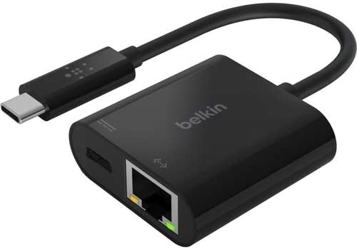

Any of you have any idea what chipset the Belkin INC001BK-BL has? It's product page lists the new silicon Macs as compatible - https://www.belkin.com/us/business/audio-video-adapters/usb-c-to-ethernet-charge-adapter/p/p-inc001/ . Obviously I'm hoping it has a native driver to offload work from the CPU. I've tried to search for the answer, but had no luck.
BanditoB
macrumors 6502
Feb 24, 2009
482
258
Chicago, IL
I couldn’t find any chipset information for the Belkin INC001BK-BL, but it is limited to 60W charging power, so if you’re going to try to pass power through it as well, it’s not suitable for the 14” and 16” M1-based MacBook Pros.
