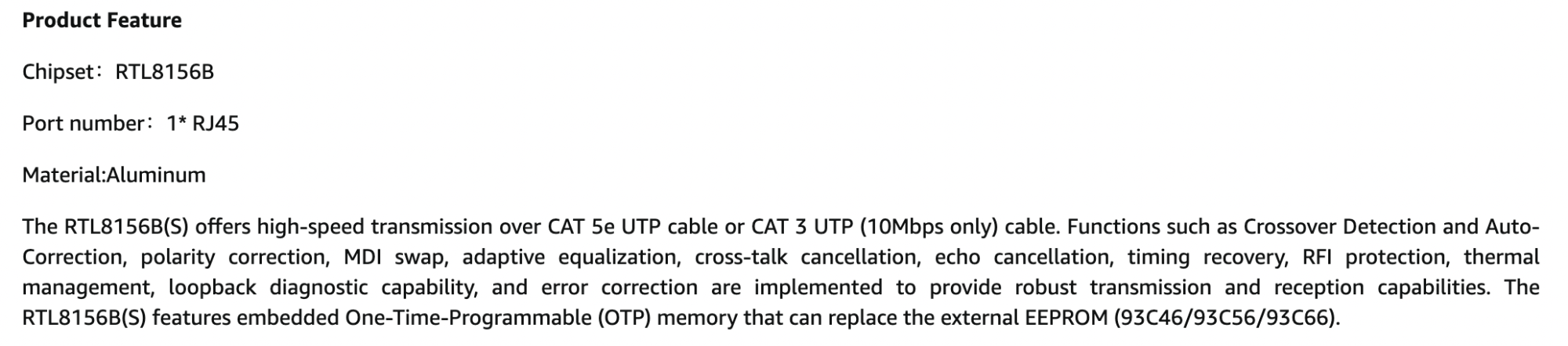

Any of you have any idea what chipset the Belkin INC001BK-BL has?
Unfortunately, this Belkin power pass-through Ethernet dongle uses the crappy RTL8153 that requires the bad built-in CDC-ECM driver.
Probably not. The RTL8156B is about two years old, and is the most common variant of that chipset. That said, the RTL8156B is fine it just tends to run hotter and it has some issues above about 1.7Gbps (which is particularly bad on Linux).
Probably not.
So the plot thickens after a better reading of the item's description - https://www.amazon.com/2-5GBase-T-RTL8156B-Ethernet-Controller-Mobilephone/dp/B0989SLQSL .
If you look at the screenshot, RTL8156B(S) without G suffix is mentioned twice in the product's description. I'm taking a chance and ordering it for $34 USD.
Reactions: NazgulRR

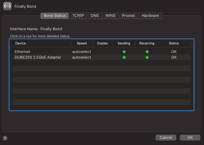

Guys I got the D-Link and did a couple restarts after setting up a new aggregate connection and it still works! So far, I am really happy with how it works. Will do some more testing in the next few days.
Reactions: CubeApril
Guys I got the D-Link and did a couple restarts after setting up a new aggregate connection and it still works! So far, I am really happy with how it works. Will do some more testing in the next few days.View attachment 2048133

So the bad news is that the $29 Plugable USBC-E2500 and the $34 ULANSeN USBC8156B both have the RTL8156B chip. This is after Plugable support told me otherwise and the description of the ULANSeN USBC8156B is a tad deceptive. I'm hoping someone finds a cheap adapter soon with the RTL8156B(S)G.
