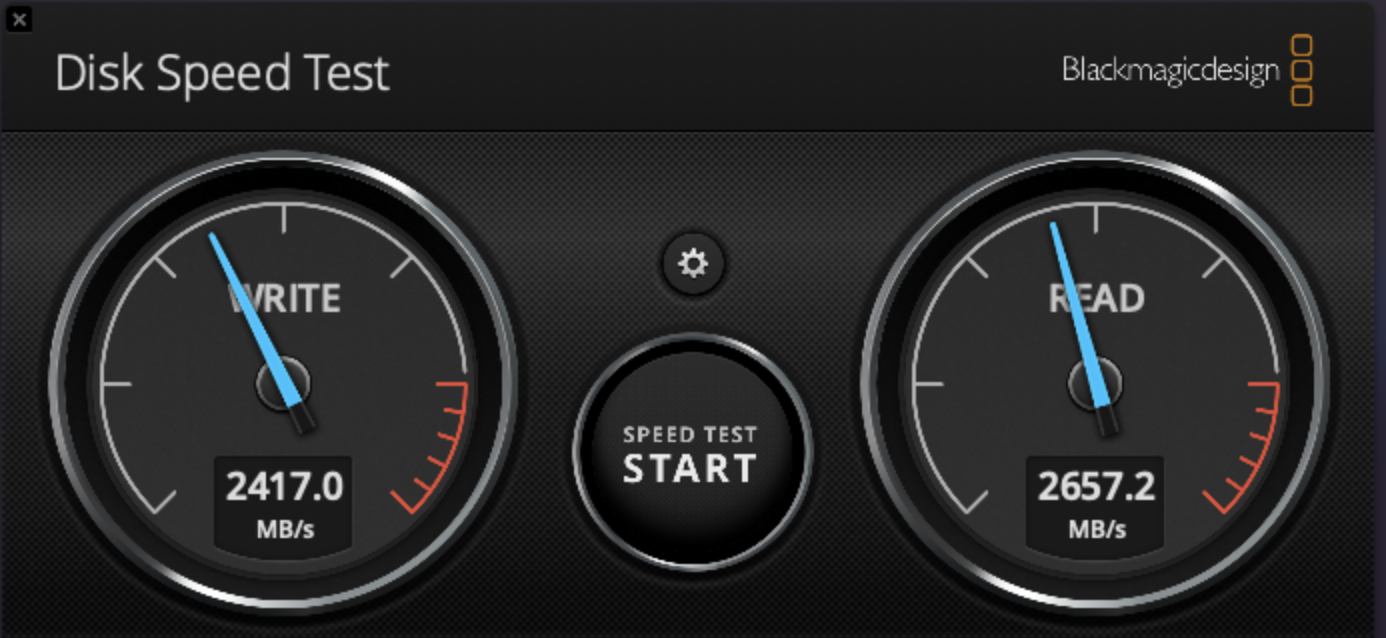

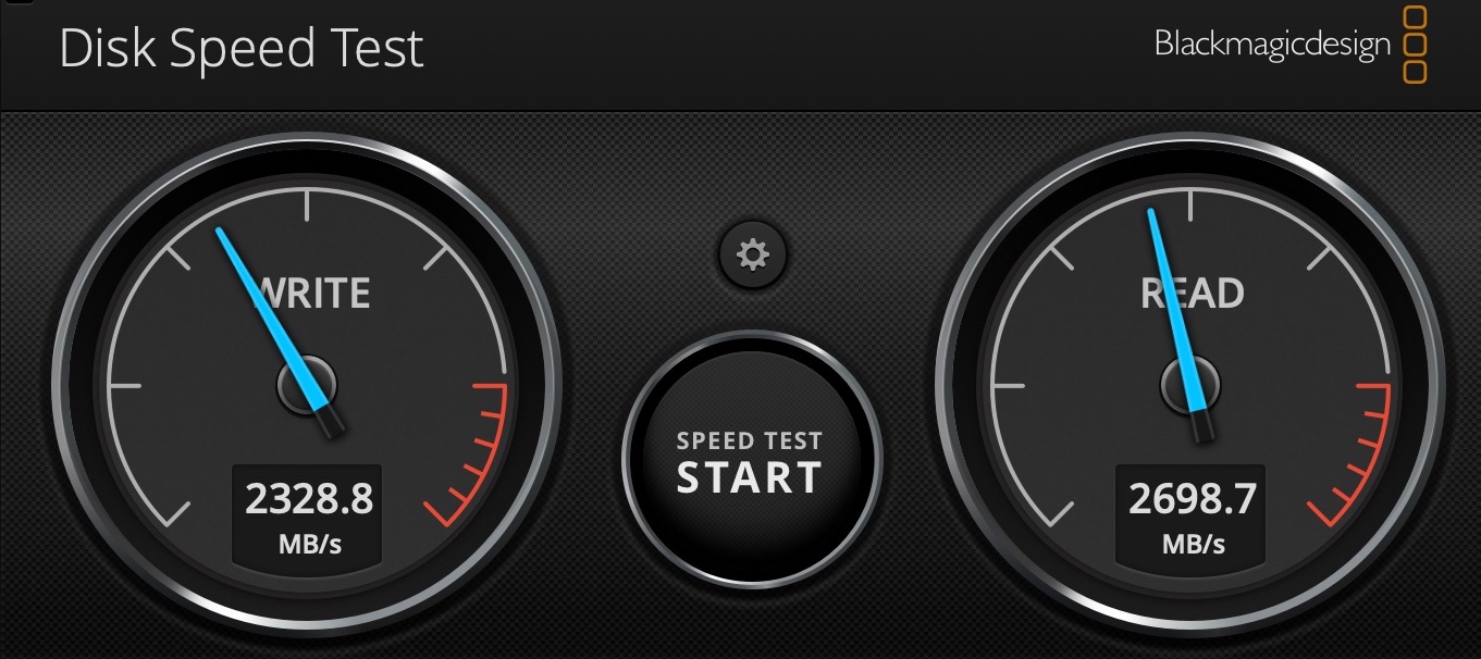

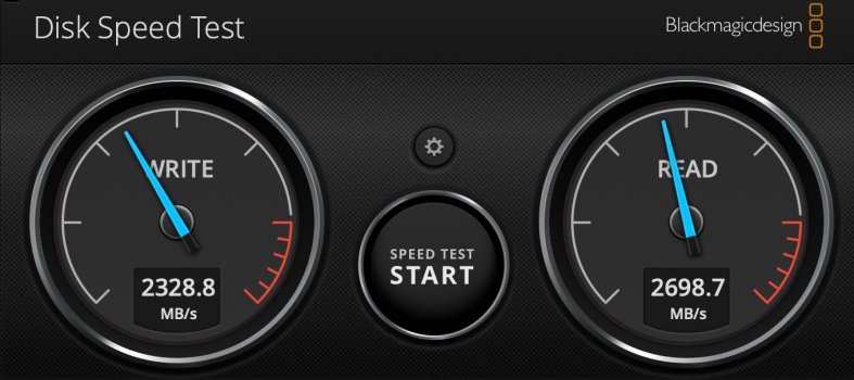

I have a similar USB4 caddy, with a 2TB Samsung 980 Pro, and it hits these speeds no problem. Not sure why others are having issues maxing out speeds with >1TB drives...

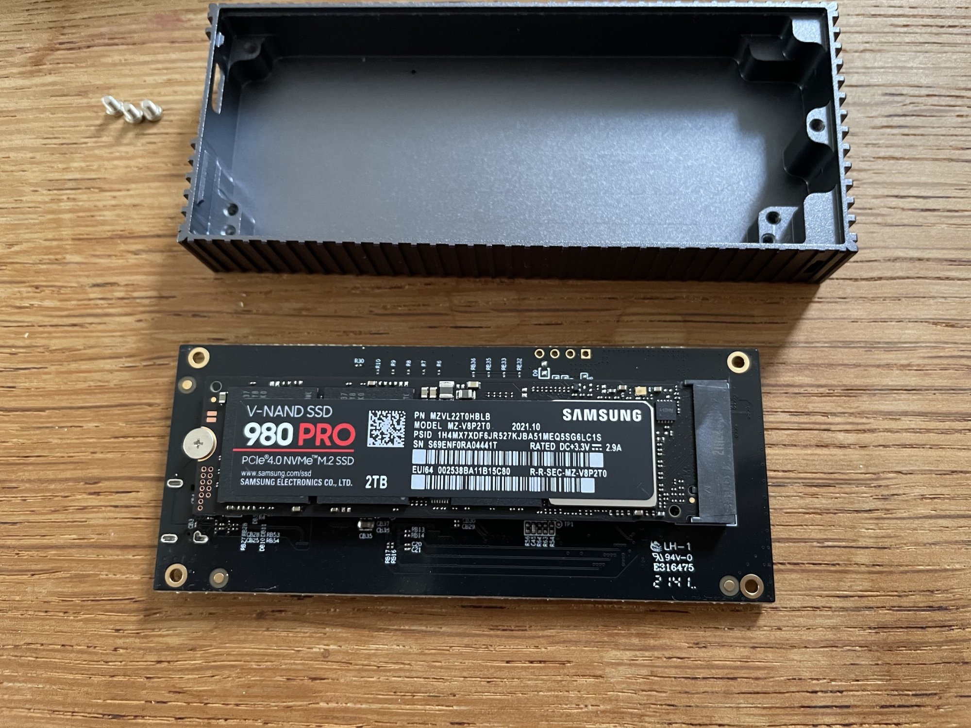

Having a "similar" enclosure doesnt mean much unless they use the same USB controller internally. Can you please take a picture of the controller chip on that board?
What is your mac model? Seems M1 pro and max chips do not have the same issues as the base M1.
It has an identical PCB to the Acasis USB4/TB4 caddy, so is the same device functionally.
They both use dual controllers, JHL7440 TB and JMS583 USB.
I’ve tried mine with my M1 Max MBP, M1 Max Mac Studio and my 2019 Intel MBP 16”. All work fine, hitting 2.7GB/s read, 2.3GB/s write with a 2TB Samsung 980 Pro.
Just to add: I’ve been using older Thunderbolt 3 -only NVME caddies based on JHL6340 TB3 controller for a long time. Never had any issues with those and 2TB drives either.
The newer TB4/USB4 dual-controller caddies are great, as I can move files between client machines which don’t always have Thunderbolt ports, at 1GB/s, with the same drive.

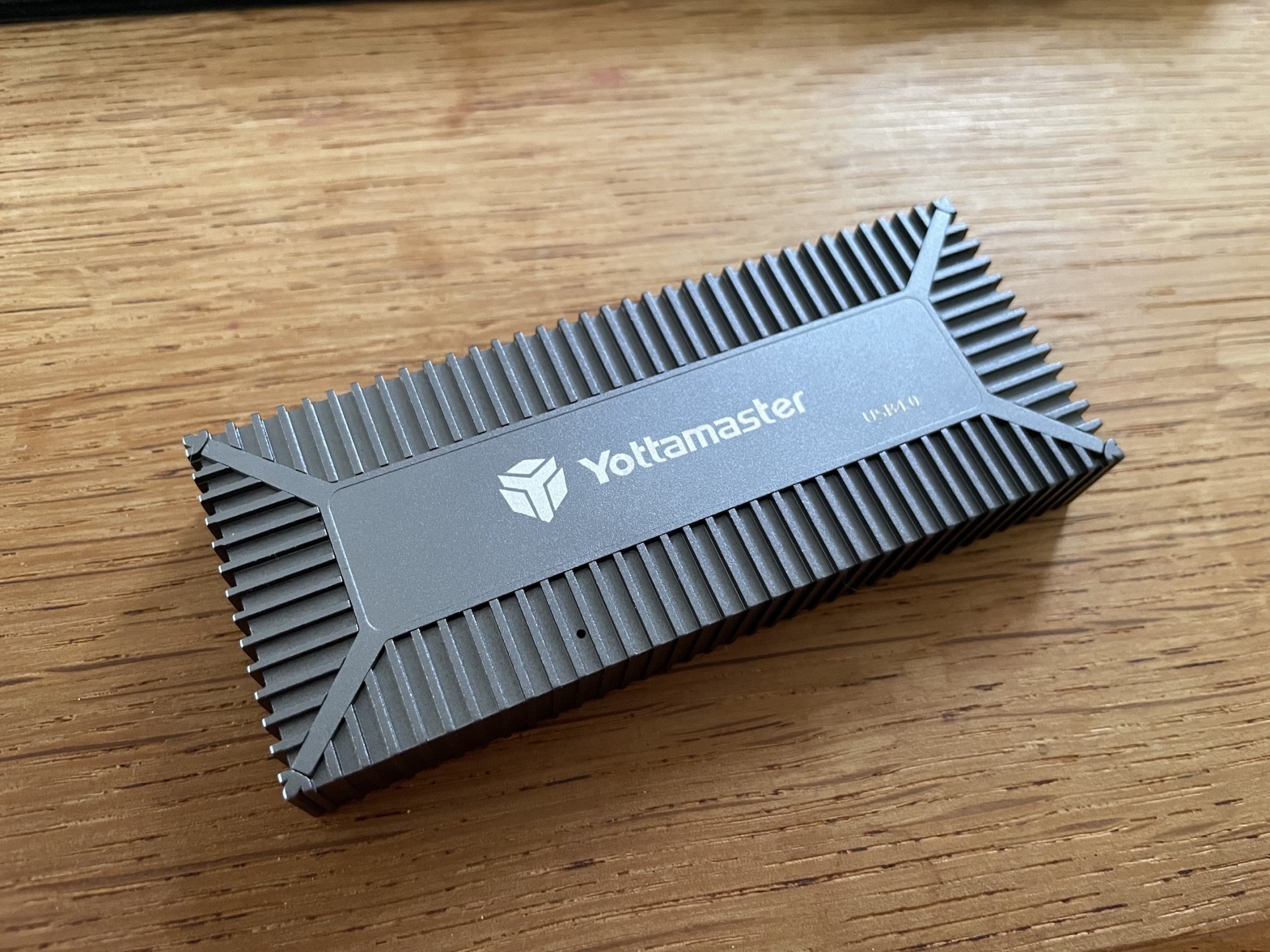

I chose the Yottamaster over the Acasis as the sculpted, finned chassis is much more effective at dissipating heat; runs ~10degC cooler with the same drive than a monoblock design. It also came with a second thermal pad for the controller chips.
