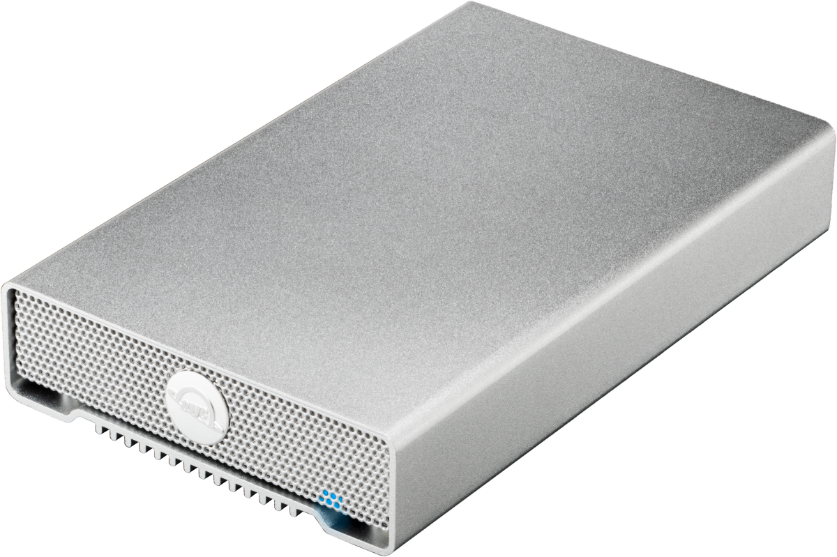

The OWC Mercury Elite Pro Mini product page says it supports USB 3.1 gen 1 which is 5 Gbps
I guess you mean the OWC Mercury Elite Pro Mini USB-C version.
SATA is 6 Gbps, but with USB 5 Gbps, you could be loosing 100 MB/s of performance. At least it's not 50% of the performance.
Yes the pro mini USB-C version. The support for 3.1 Gen 2 was the reason I spent more on this than a cheaper enclosure.

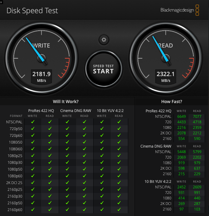

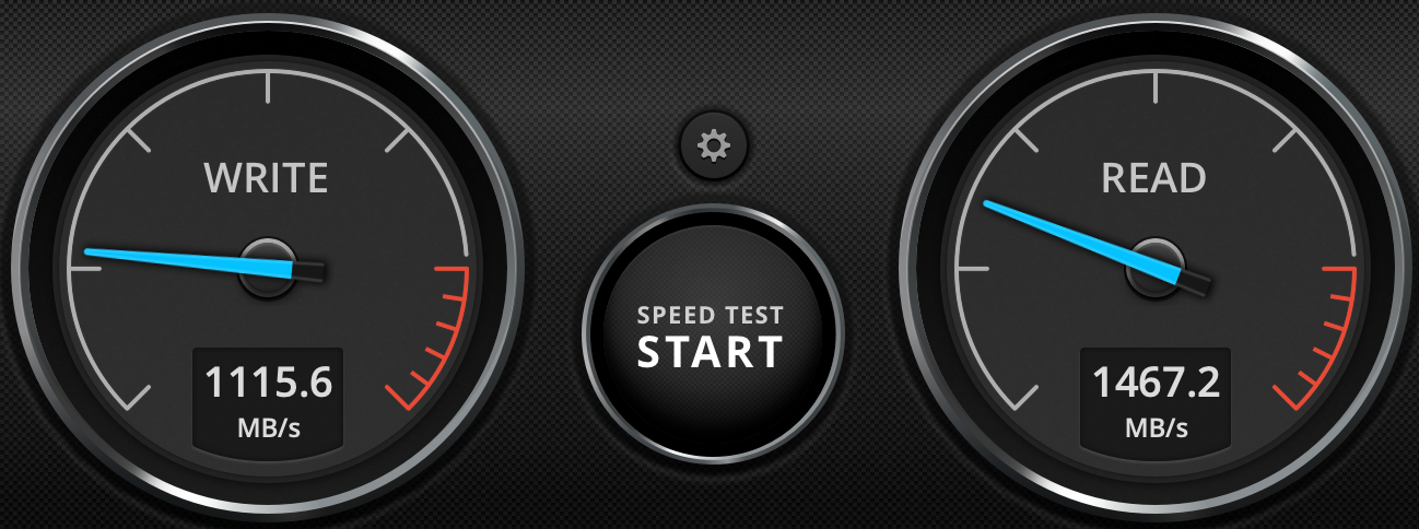

If that's hooked up to Thunderbolt, seems like it should be closer to 2,000 megs per second for both Read & Write. Below is a screenshot of what I'm getting. My computer is a 2017 iMac and the drive is a 1 terabyte VisionTek NVME drive hooked up via Thunderbolt. I consistently get 1,800 megs for Write speed and over 2,000 megs for Read speed. Owned the drive since June 2020.
This was addressed in the next posts after the one you linked at #93
- the OWC Envoy Express is limited by PCIe 3.0 x2 inside the enclosure.

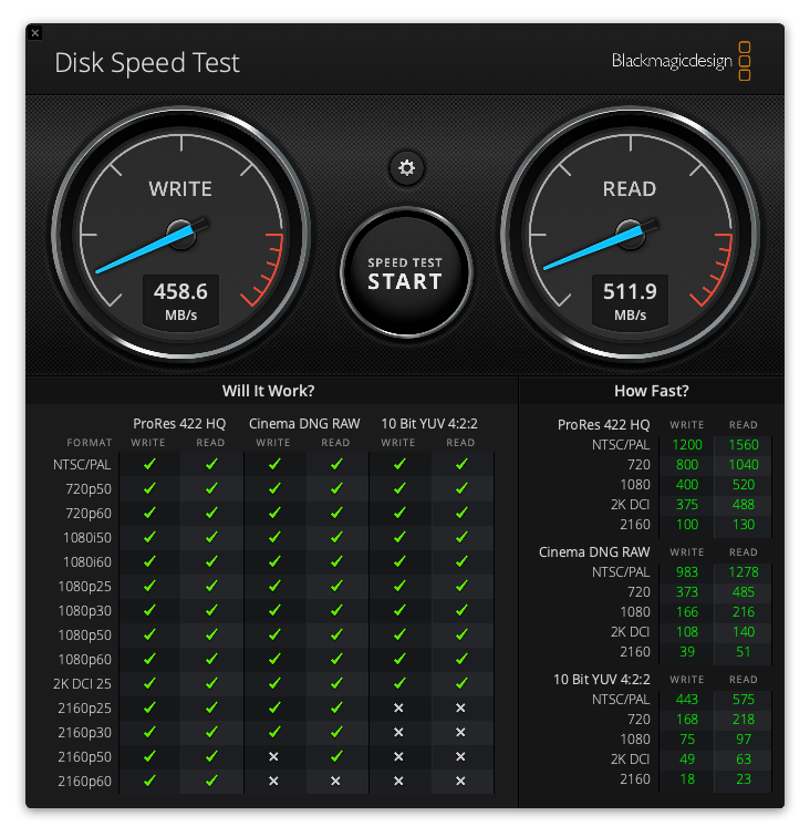

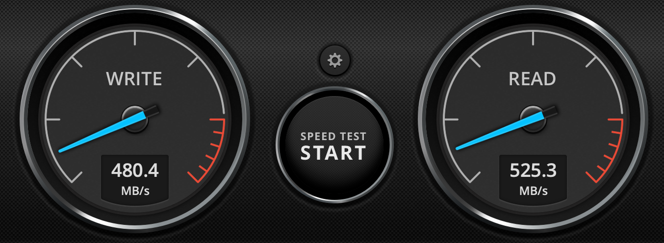

M1 MacBook Air gives me ~510 MB/s using both USB-C and TB3 cable to the same drive. Something is definitely amiss. Device shows up as initialized with 10 Gb/s in System Report USB Device Tree

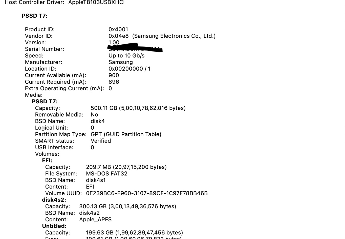

For me, a Samsung T7 is connecting at 10gbps on the USB C/ TB port of a M1 MBA (screenshot below)
What is unusual though is that the benchmark speed on a windows laptop with TB (LG Gram) for Sequential read is about 1000 MB/s (i.e. almost full saturation on the 3.2 bus) vs about 750 MB/s on the MBA m1

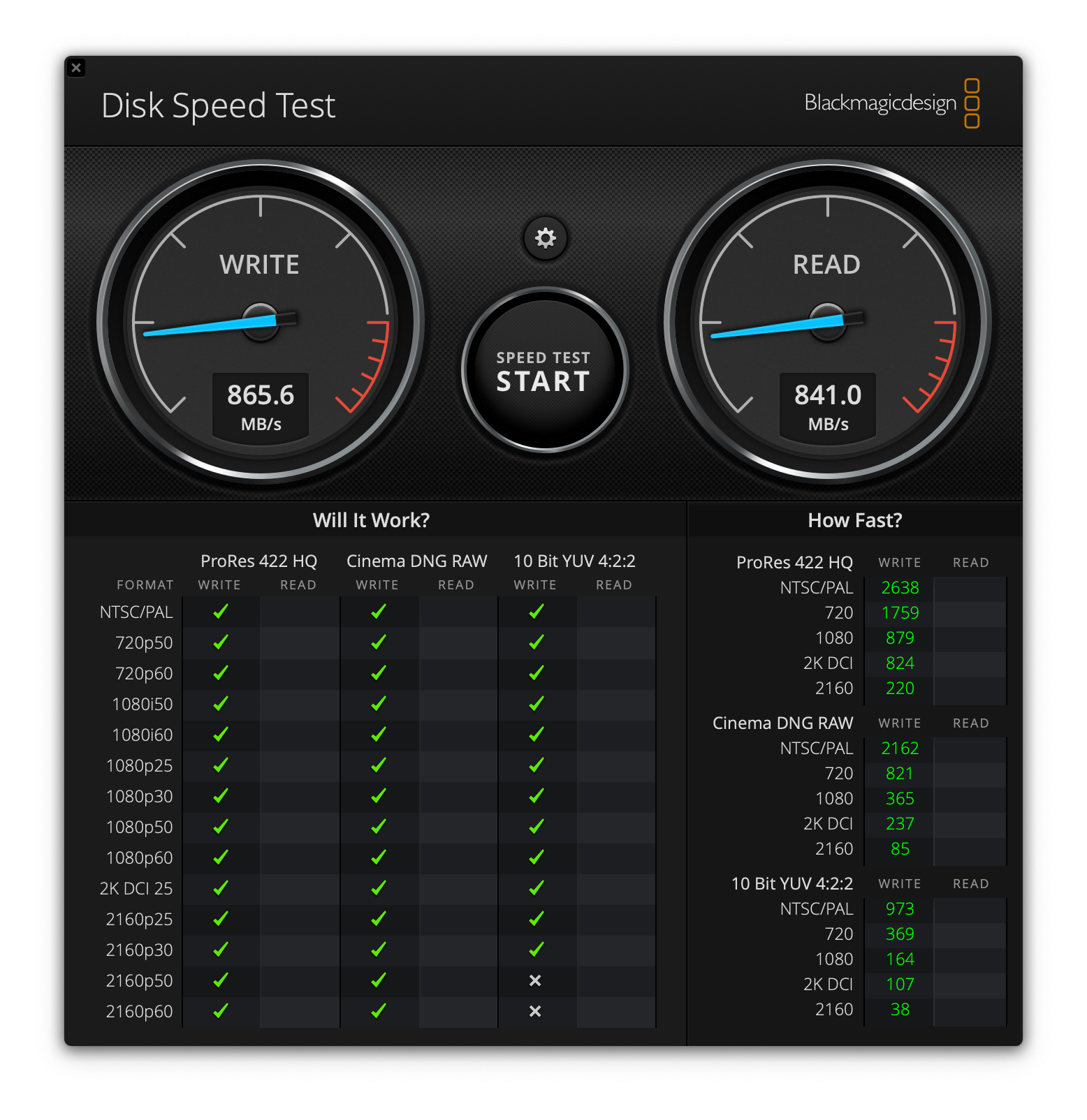

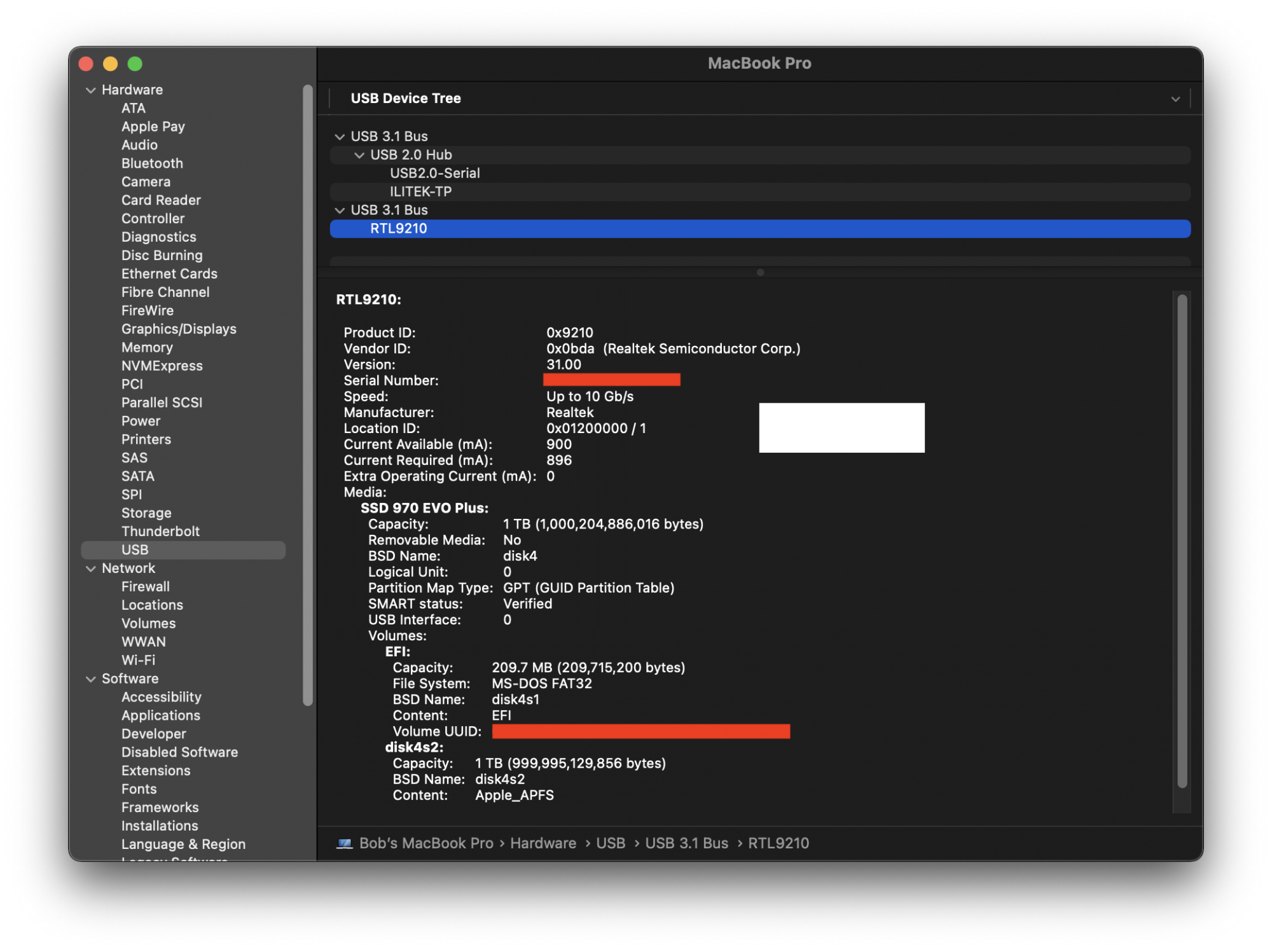

I bought this Plugable enclosure and use Samsung 970 EVO Plus 1TB in it. I can get stable write speed at 860MB/s and read at 840MB/s. The enclosure uses RTL9210. It does get very hot if I put it in extensive use.
A bit of a waste putting an EVO+ in that caddy, it should at least be in a thunderbolt 3 caddy for the full benefit.
