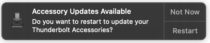

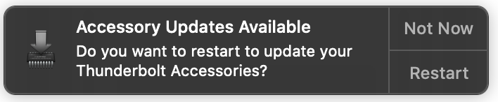

My display is on 2.2.2 and I keep getting this message since installing the W5700X after each reboot (and saying "Restart" to "update your Thunderbolt Accessories" doesn't seem to do anything special during the restart, and after boot-up the message returns until dismissed ?‍♂️ ).
Talking to myself: Reinstalling 10.15.4 via the Combo Update seems to have fixed this for me.

My display is on 2.2.2 and I keep getting this message after each reboot (and saying "Restart" to "update your Thunderbolt Accessories" doesn't seem to do anything special during the restart, and after boot-up the message returns until dismissed ?‍♂️ ).
did you fix this: I have the exact issue. I've hit restart. and Nothing at all happens.

The Thunderbolt Accessory Firmware Update is for the Thunderbolt/USB-C controllers inside the W5700X. Mine updated from 49.04 to 55.02.
You can see the status of the last firmware updater run by running /usr/libexec/FirmwareUpdateLauncher -r. (Append -v to produce more verbose output.)
It appears to set some nvram variables that run an updater EFI executable at the next boot.

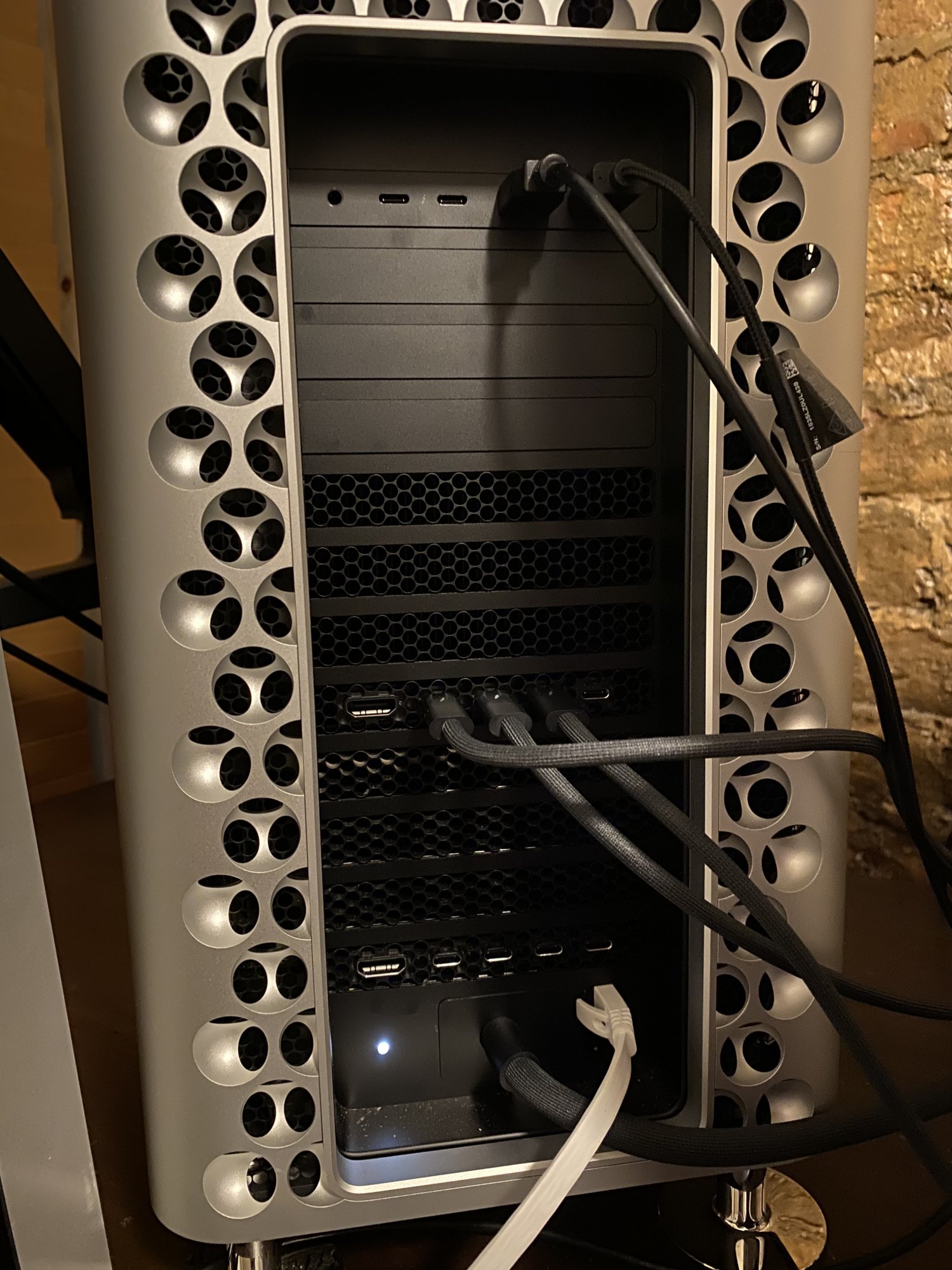

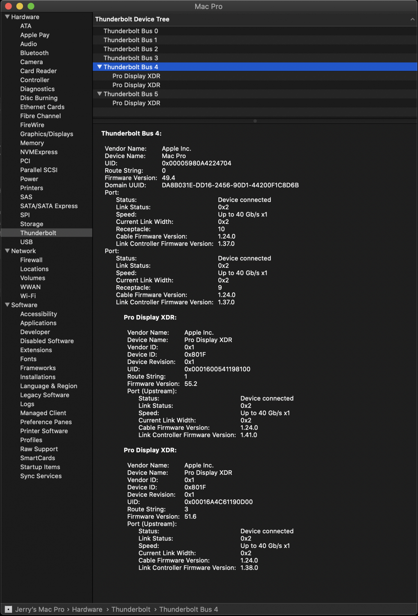

Just got my W5700X and just for kicks, tried running all three of my XDR's off the ports on the card. It works! All three are seeing 6k resolution.
*Edit*
Here is a picture of the graphics card panel in system report. It appears one of my display is on a lower firmware, not sure if that is an issue.
Are you able to connect one display to the top and one display to the I/O card and one display to the GPU? I am wondering if the DisplayPort routing is done in pairs (both to a single Thunderbolt controller) or seperately.
Physically, electrically, and RAM wise, you should be able to connect 6 XDR displays but Apple says only 3 are supported so there may be a pixel/bandwidth/DSC limit (Apple said the Vega II only support two XDRs but people have gotten 3 to work at 6K).
