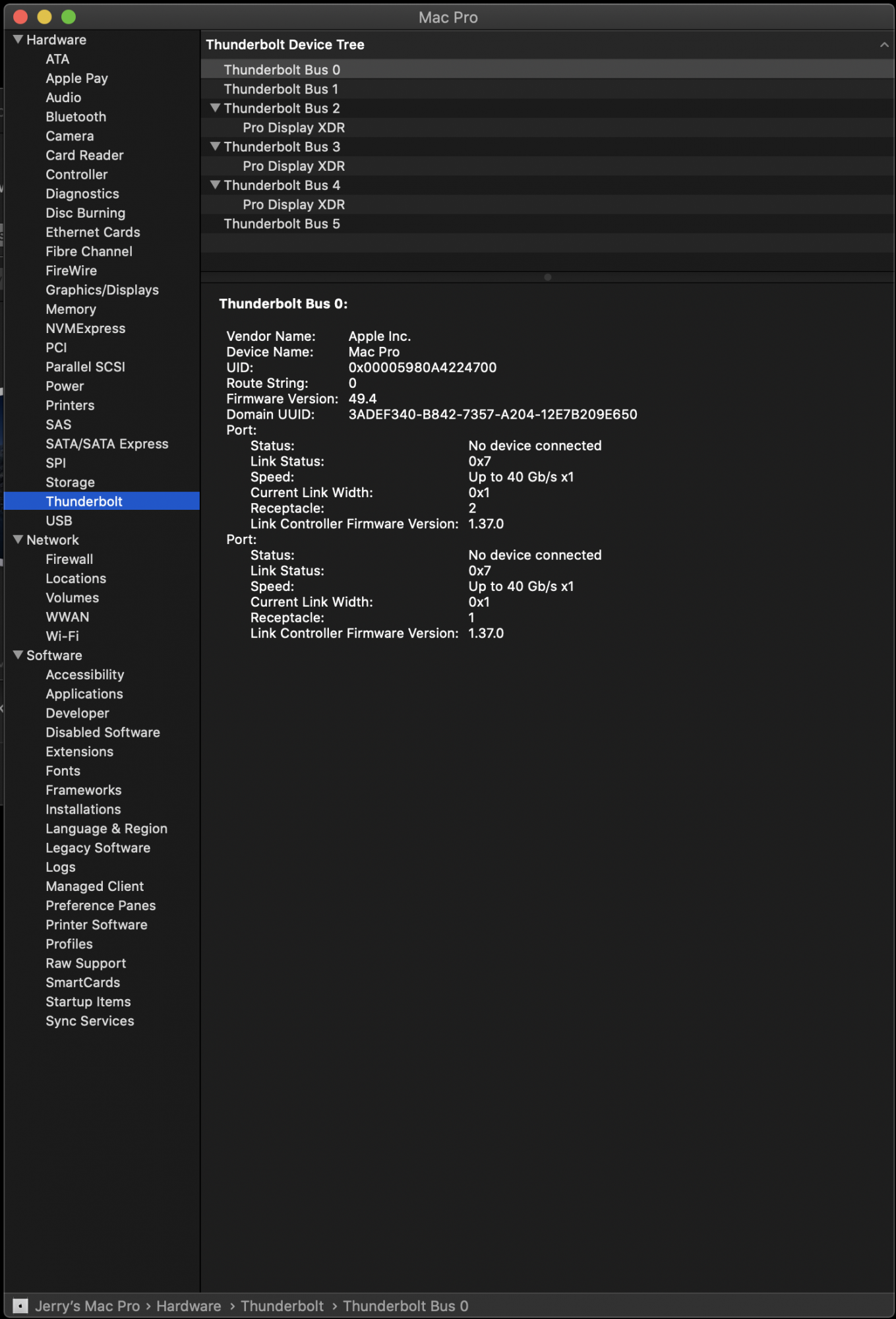

The Thunderbolt Accessory Firmware Update is for the Thunderbolt/USB-C controllers inside the W5700X. Mine updated from 49.04 to 55.02.
You can see the status of the last firmware updater run by running /usr/libexec/FirmwareUpdateLauncher -r. (Append -v to produce more verbose output.)
It appears to set some nvram variables that run an updater EFI executable at the next boot.

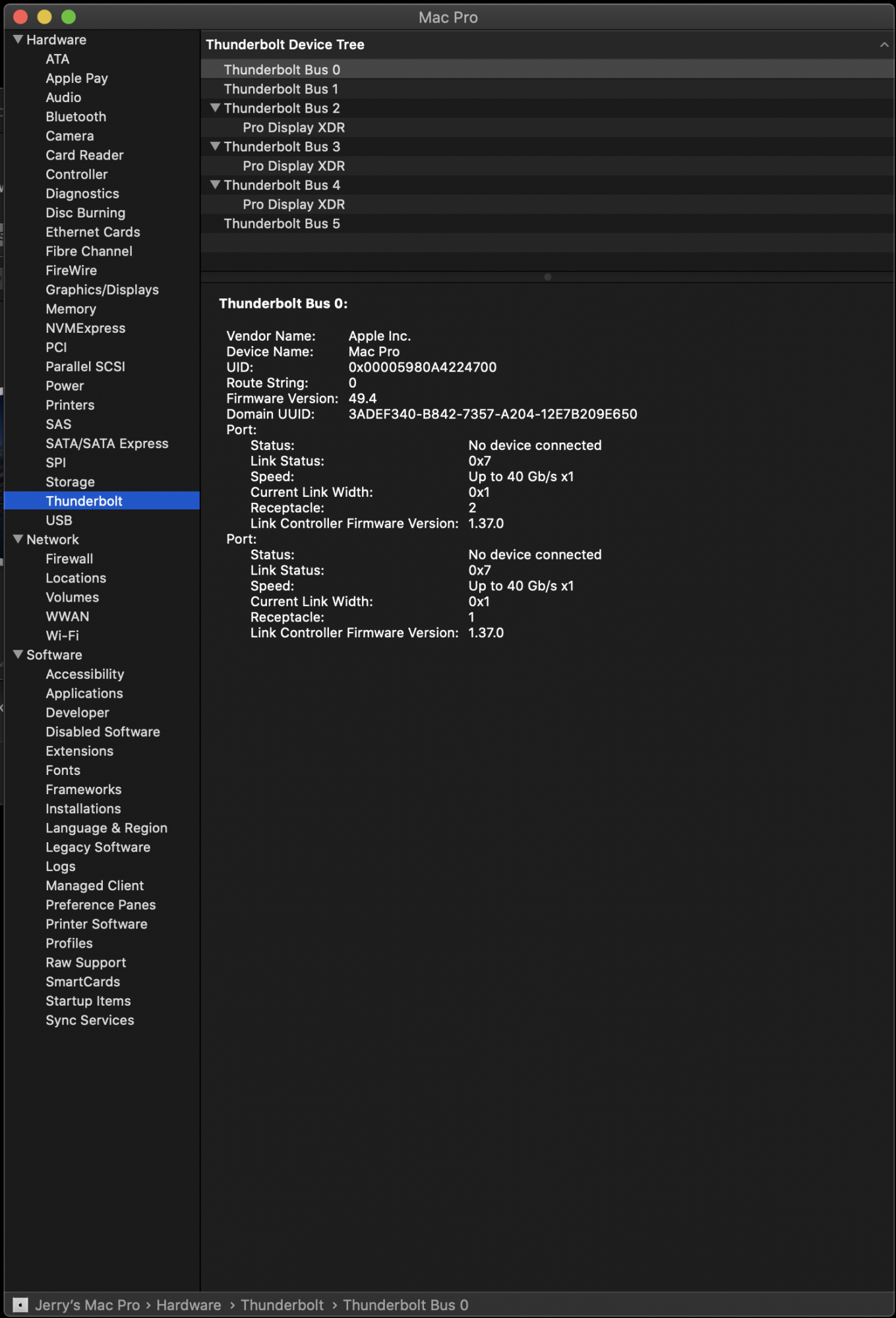

Hmmm. Seems like mine didn't update then: Thunderbolt Bus 0 and 1 have Firmware Version 55.2; whereas Bus 2 and 3 have 49.4.
The 10.15.4 Combo Update still silenced those messages though. Weird.
Bus 0/1 is the GPU. 2/3 is the I/O card and the top I/O ports.
It is interesting the firmware update is only applied to the GPU.

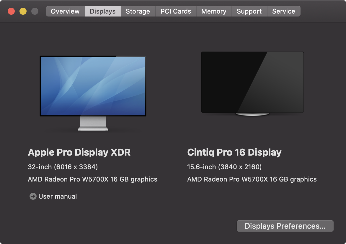

Are you able to connect one display to the top and one display to the I/O card and one display to the GPU? I am wondering if the DisplayPort routing is done in pairs (both to a single Thunderbolt controller) or separately.
Physically, electrically, and RAM wise, you should be able to connect 6 XDR displays but Apple says only 3 are supported so there may be a pixel/bandwidth/DSC limit (Apple said the Vega II only support two XDRs but people have gotten 3 to work at 6K).
Yep, works fine. I wonder if I can use 9 XDR displays with my current video card arrangement (3 on Vega II and 6 on W5700X) :p

Actually, I just tried plugging two into both the ports on top and both ports on the I/O card. In both cases, only one monitor works.
Also just tried plugging two monitors into one Thunderbolt bus on the Vega II. Only one shows up. So, it seems I can connect 8 XDR displays with this current setup: 2 directly to Vega II, 4 directly to W5700X, 1 connected to a top port, and one connected to an I/O port.
Makes me wonder if the DisplayPort routing would work correctly in that case. Is the system designed properly to let one MPX module route to the I/O card, while another routes to the top I/O?
9 could be possible - 2 to the Vega, 4 to the W5700X, 2 to the top (assuming the top is connected to the W5700X), and 1 to the I/O card (assuming it is connected to the Vega II).
That would only happen if both the top and I/O card were being connected to the Vega II. Did you check what GPU they are being connected to? What MPX slot is the Vega II in? What MPX slot is the W5700X in? Maybe they need to be swapped so that the W5700X takes priority (so that displays connected to the top or I/O card are connected to the W5700X first).
Yes, because Vega II does not have DSC so it uses two DisplayPort connections per XDR. The W5700X has DSC so only requires one DisplayPort connection per XDR.
9 should be possible - see first answer above.
The problem with this test is that you have the Vega II and the W5700X installed at the same time so we need more information.
Without the Vega II installed, repeat the test with one XDR on the top and one XDR on the I/O card - this should succeed showing that the DisplayPort outputs are not routed as a pair. We already know that two DisplayPorts to the same controller is possible because that's how a Vega II gets 6K from an XDR connected to the top or I/O card - but to be sure, you can do that test with the W5700X to show that DSC allows two XDR displays to be connected to the same controller (the top or I/O card or the two controllers of the W5700X).

It seems that way as when plugging one display into each, they both work.
What I mean is, if you're loading things down to the point where the I/O card bus' DisplayPort lines *must* be driven by one GPU, and the top I/O by the *other* GPU, does that actually work? Or maybe you have a screenshot of System Profile showing that happening already even when you aren't connecting a dozen monitors?
In practice, unless you are pushing the very limits of both cards, it would be possible to drive both internal TB3 buses on the Mac Pro with a single GPU.
The Vega II and W5700X only provide two DisplayPort outputs to the MPX slot (the 580X and Vega II duo provide 4). So each internal TB3 bus can get one DisplayPort each (test this with only the W5700X installed and connecting one XDR to the top and one XDR to the I/O card) or one of the internal TB3 busses can get two DisplayPorts (test this with only the W5700X installed and connecting two XDRs to the top and then two XDRs to the I/O card).
With two MPX modules installed, the internal TB3 busses might be giving priority to one of the MPX modules (in other words, when no displays are connected, when you connect a display to any of the four ports of the top or I/O card, it always goes to the higher priority MPX module first. This can be tested by connecting only one XDR display to each of the four ports to see which GPU it connects to. If they all connect to the same GPU, then there's a priority.

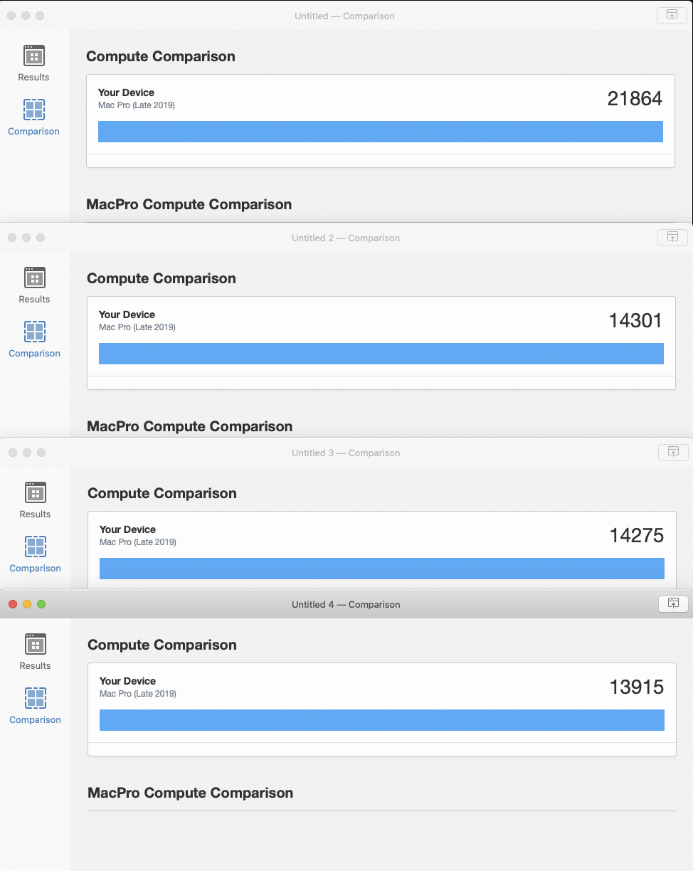

Hi,
I just got the Radeon Pro W5700X MPX for Mac pro 7.1, Catalina 10.15.4
There are big stability issues in the performance under Metal and Open CL.
At times I'm well below the performance of a Radeon 580X and generally not at the 580X level? see screenshots.
it's a disaster.
Of course, at Apple, nobody is able to give me an answer to solve this problem?
I'll have to return the card, because it's unusable for professional use...
It's a shame to sell a product for more than 1.200,00€ whose drivers are not even updated...
Apple has really fallen down...
If you've got any solutions, I'll take it...
Thank you in advance for your advice

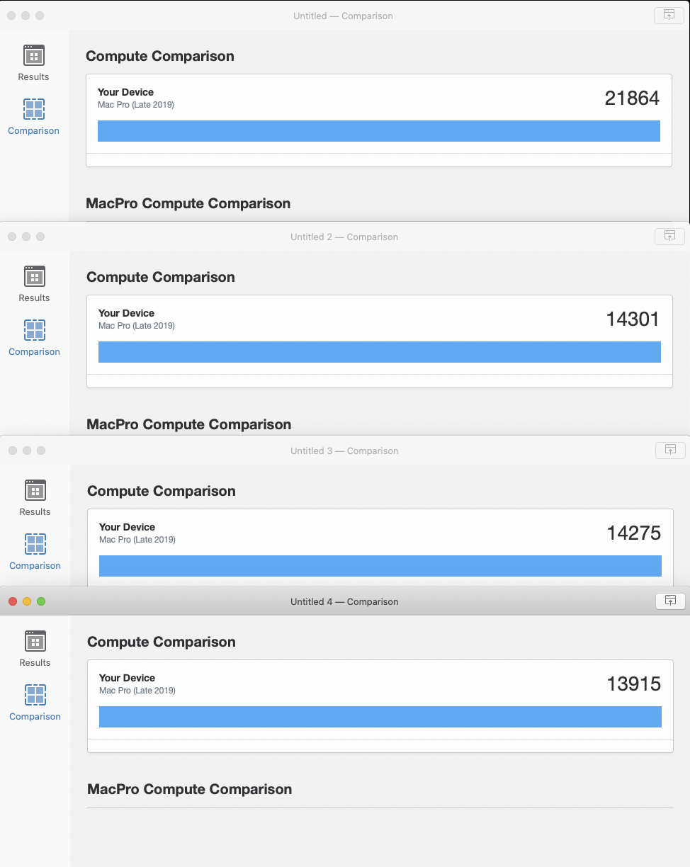

Hi,
it's a disaster.
See the notes on this page and prior.
10.15.5 beta makes the card more stable.
This.
And I’ll add that with 10.15.5 Beta 3, I still haven’t seen the issue show up again since updating. So it’s getting close to a week without issues.
