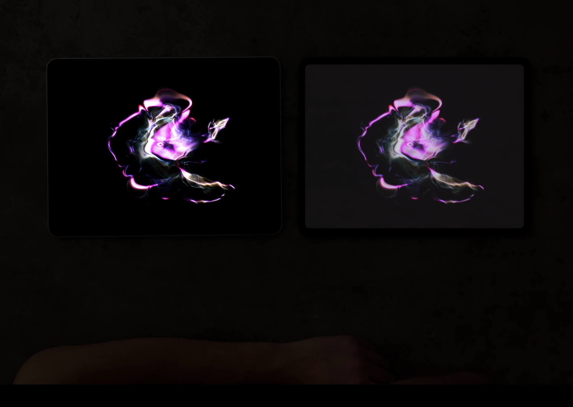

I take better blacks + some glow around objects in black background any day vs. "spotlight" bleed for example when watching 16:9 movies.
The oddest thing in that video you linked is the light pulsing of the square as it moved around on the 2021’s display, while it did not pulse on the other display. I’m guessing the pulses were caused from moving through the different dimming zones.
that's exactly what is happening. that's blooming and the LEDs not being responsive/precise enough to keep up with the video footage. as an object moves across the screen the parts of the screen where the object was will still light up unless the LEDs can respond fast enough. example:
go to 0:53 in this video if it doesn't start there:
on the left is a QLED which technically works the same as a mini led except there are fewer dimming zones/leds. on the right is an OLED. look at the blooming and how the light trails the white circle. even in the shots afterwards if you look at the sky you can see it glow up because the LEDs aren't precise enough. the OLED has way more control because it can turn off pixels instead of relying on dimming zones.

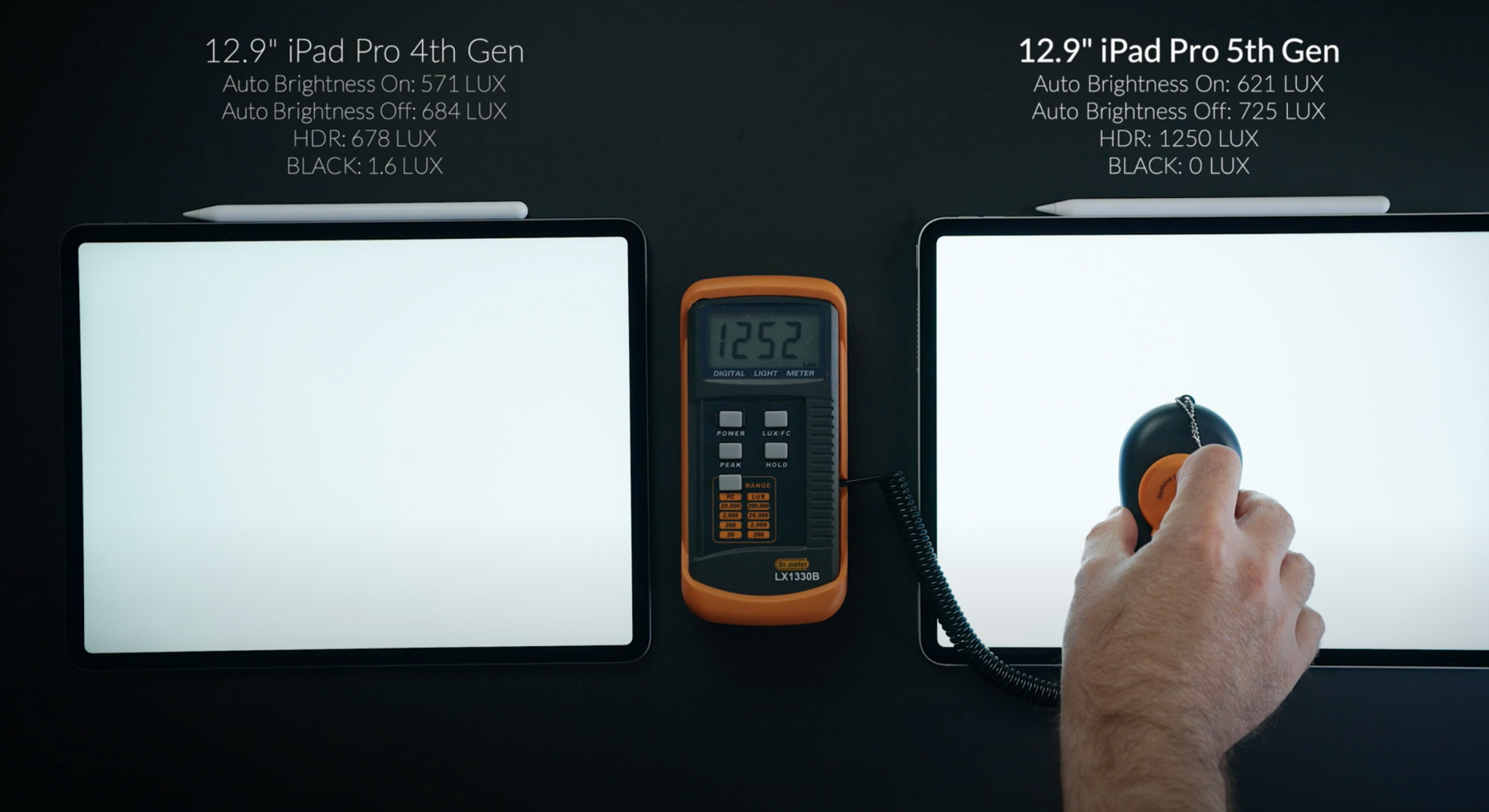

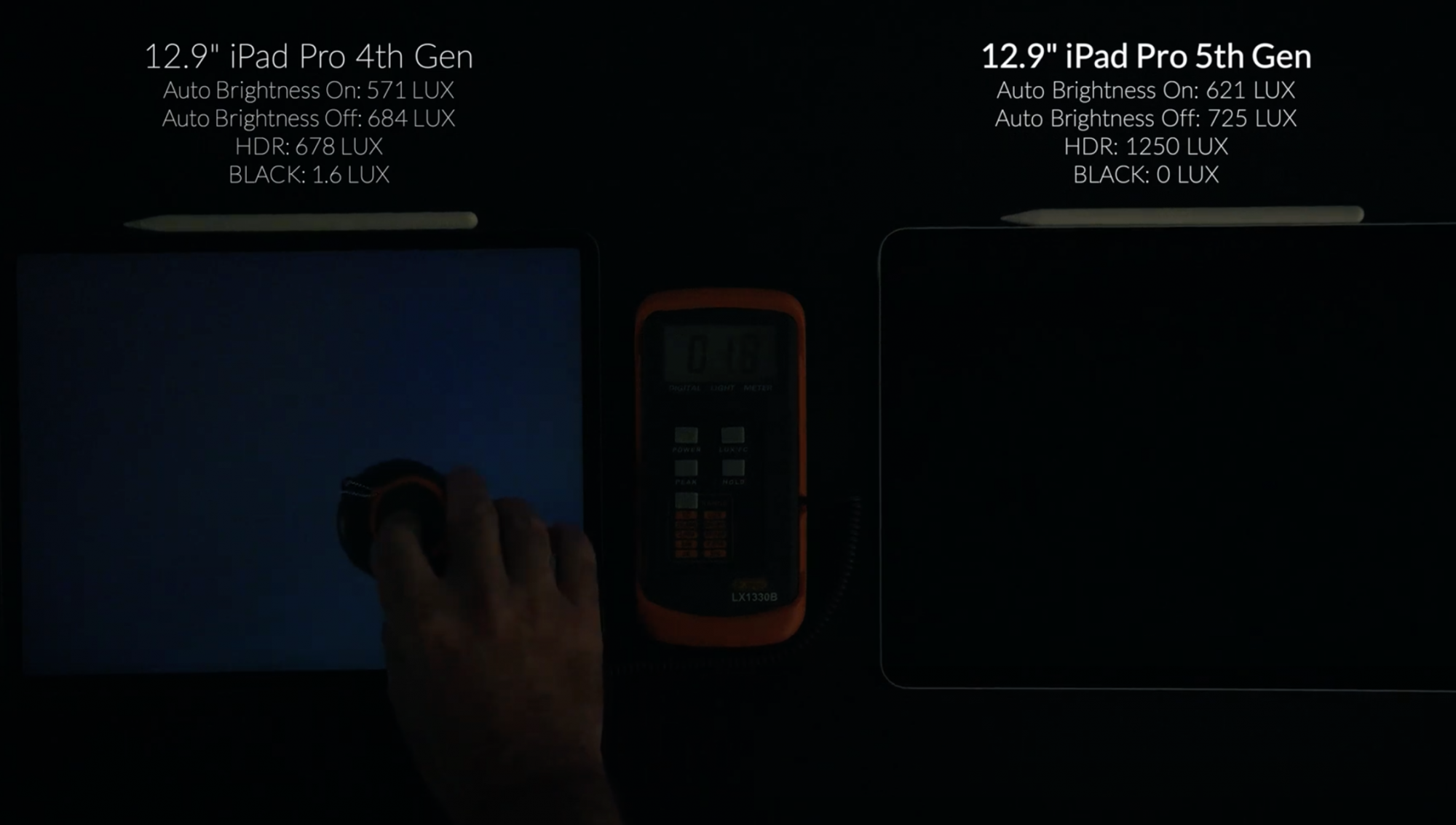

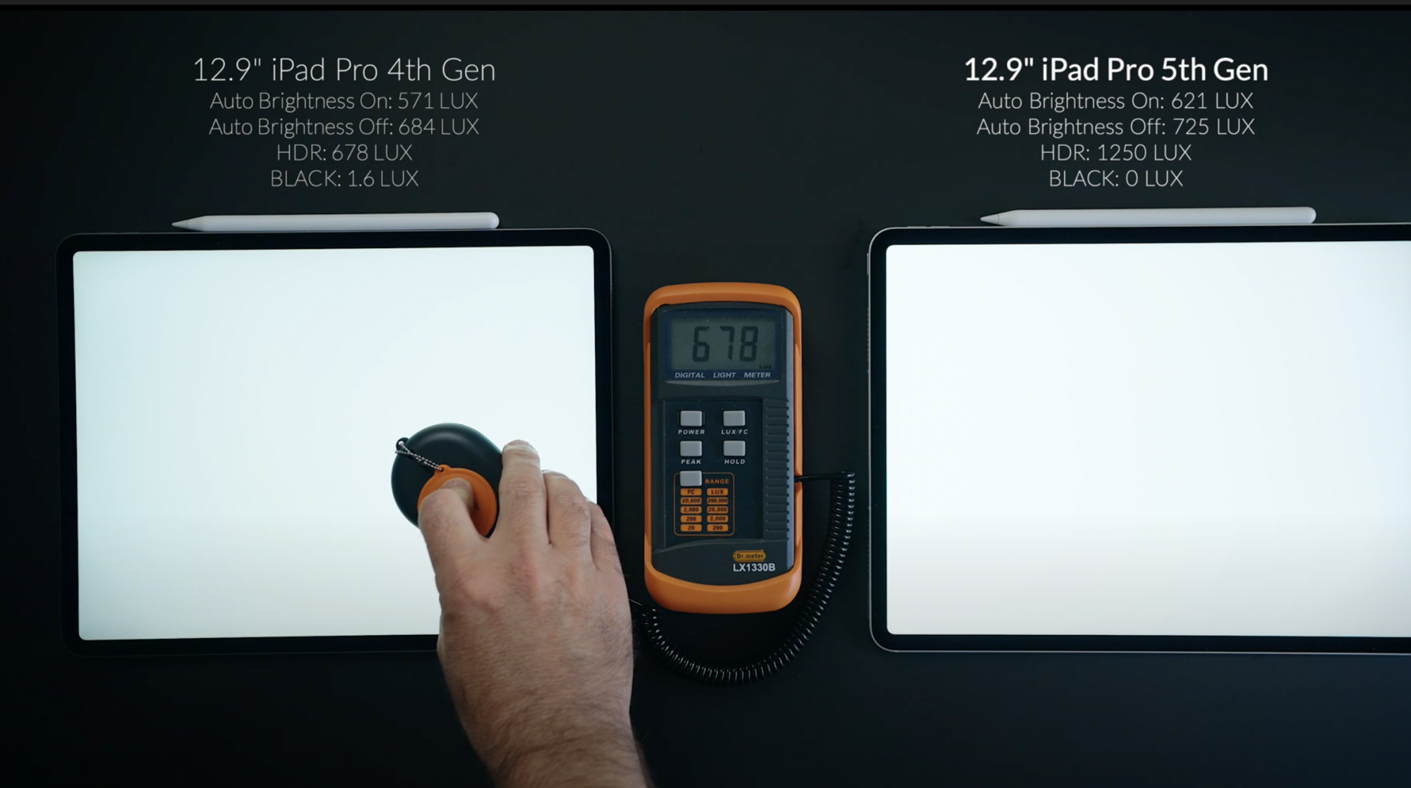

last gen ipad pro 12.9" vs new one 12.9"
with auto brightness turned on 678 LUX vs 1250 lux
Black level 1.6 LUX vs 0 LUX

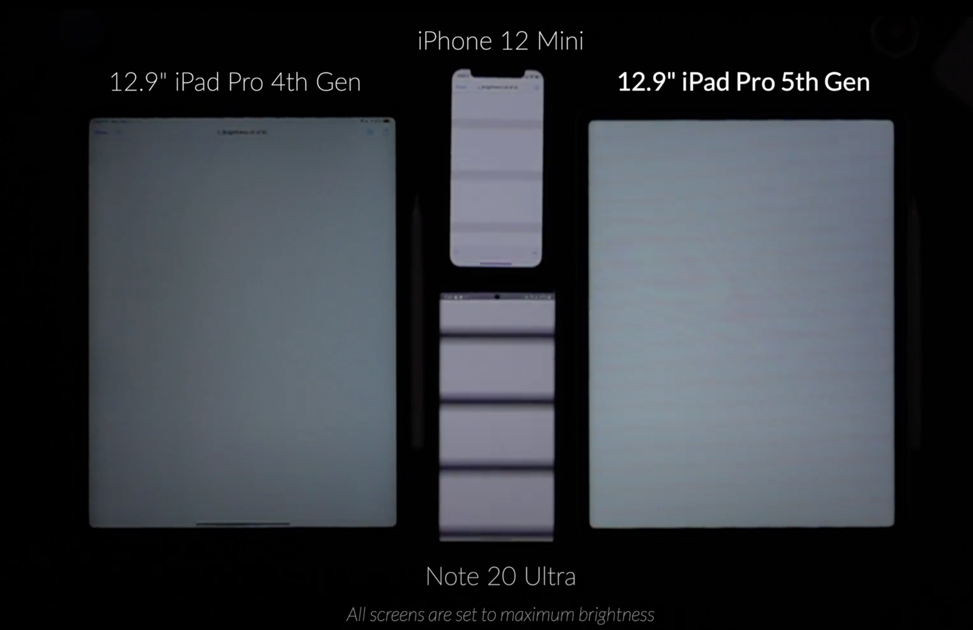

And about measurement flickering ...Note 20 ultra with amoled it is the worse and the best is the new ipad pro
