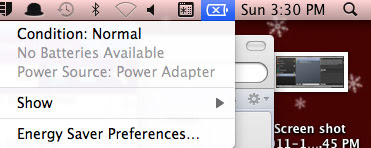

Ok, thanks. It recognizes the battery, the battery just won't charge and is basically dead.
Does the battery-icon show a black X and is loading in the other MacBook?
The battery-charging might be defective then. Ought to be a common problem in the early intel-MacBooks.
I had a black unit once showing that problem. Experience was as black as the book ...
Resold it marked as defective and I exactly described, what was wrong with that MacBook and that it could only be used as a desktop-machine, that it has to be always connected to the powerline to work. A lot of trouble with the buyer afterwards, who didn't read or believe my description ...

I'm sorry to hear about that experience. It shows up, it just says "Not Charging."

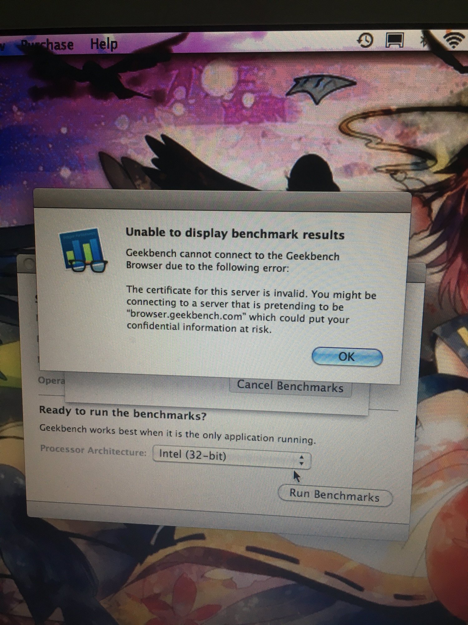

Well, I tried using GeekBench 3 and it refused to show me the results because the site wouldn't give a valid certificate.
I used Geekbench 2 just a couple of days ago and there were no issues - I was on Mojave though. It's not impossible that Snow Leopard's Safari cannot connect to the results site anymore. :(
You can try Xbench instead - run it with and without battery and compare the CPU results.

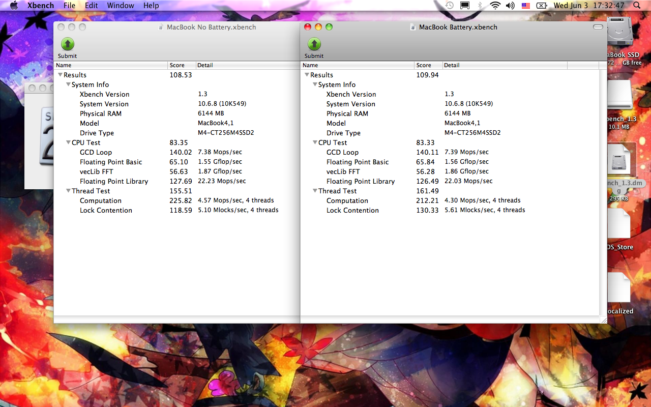

@Amethyst1 Here are the results. If you want I can also try using my 5,2's battery, which does hold a charge
