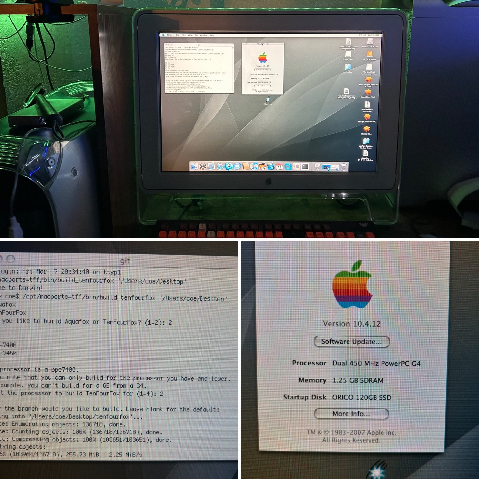

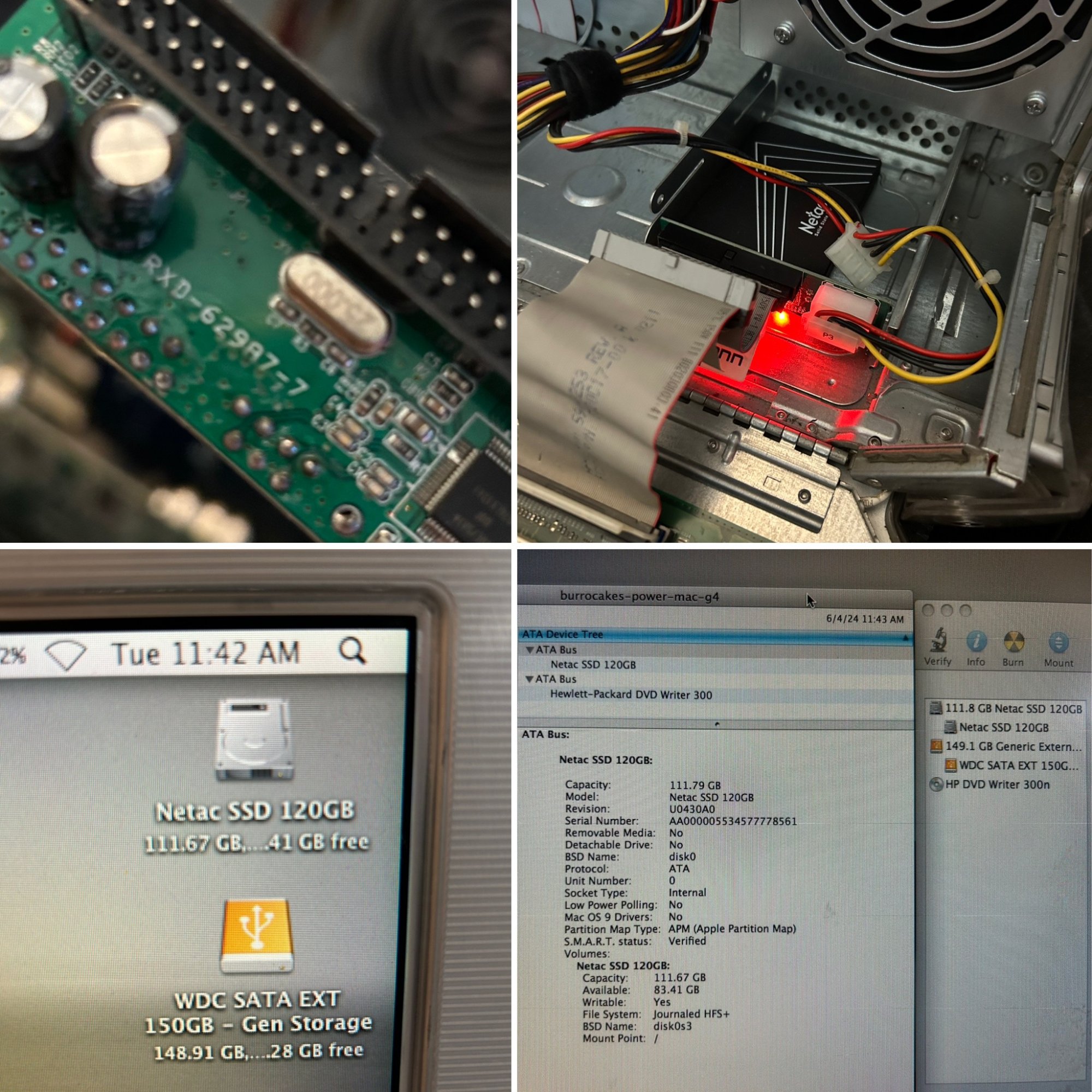

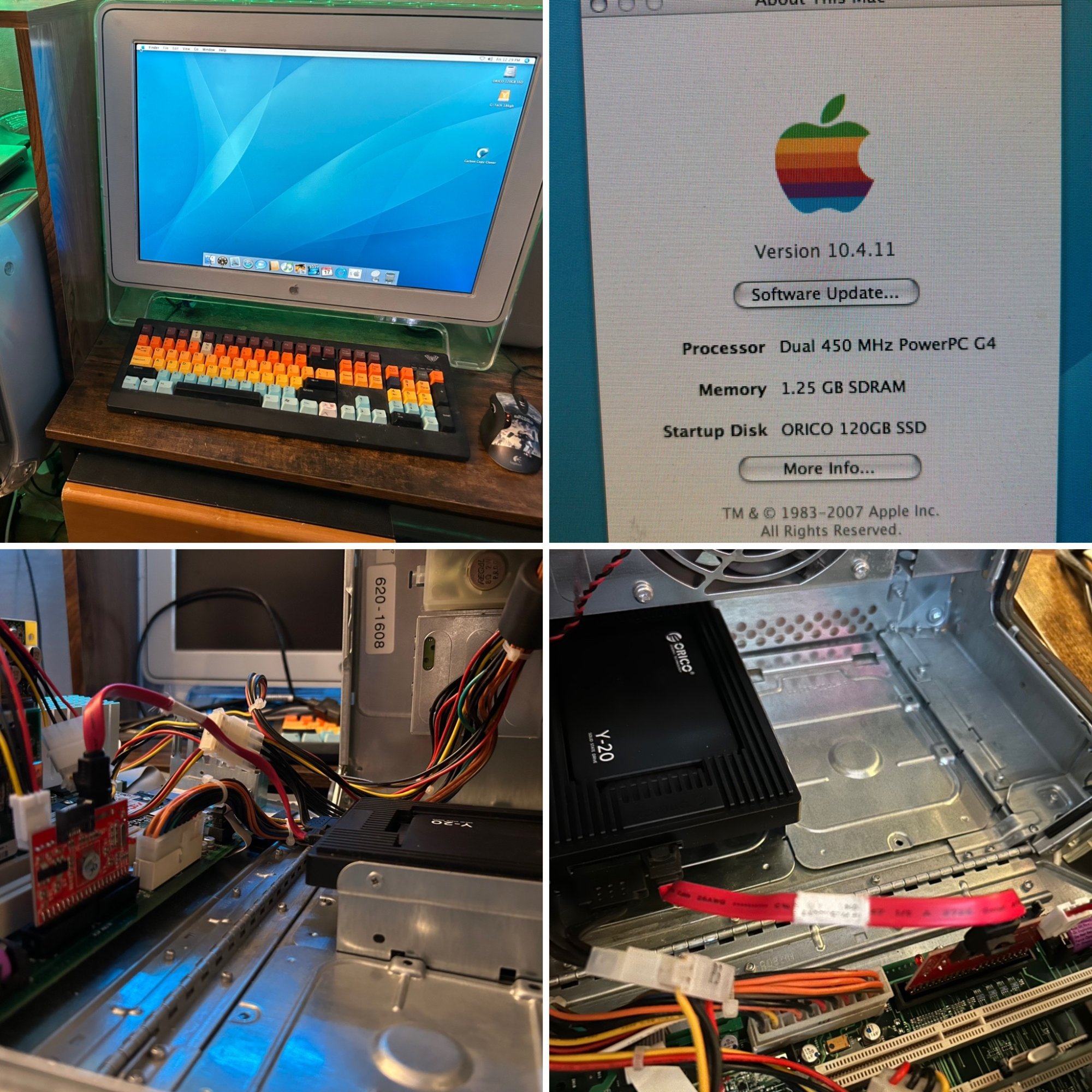

I had some adapter fun today. I picked up some cheap Orico doo-dads on eBay; a 120gb ssd and a 3.5 adapter along with one of my no-name, MIPRC, red pata/sata adapters. I realized that the way the ata66 port was oriented in my Graphite, the red adapter could live perfectly well stuck directly into the port and not destroy itself when closed up vs using an 80wire ultraATA lead. Anyways, a clone of the old maxtor spinner to the ssd and I have a nice upgrade to my Graphite Tiger box. The adapters are working perfectly together.
I think I will pick up a couple of the 2.5 to 3.5 adapter sleds so I can cleanly reinstall the current ssds into the sleds with the black rubber g5 feet things and Then into their respective tracks. Those sleds were cheap, maybe $6 bucks so why not :)
I'm planning on doing a similar upgrade to my Quicksilver, swapping out the three spinning rust drives for 1xSSD, 1x500gb sata spinning rust. Did you notice a marked speed improvement with the SSD? My friend said I should see the QS boot up significantly faster, but tbh it boots pretty darn fast already.

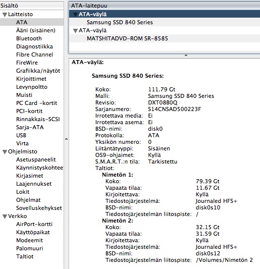

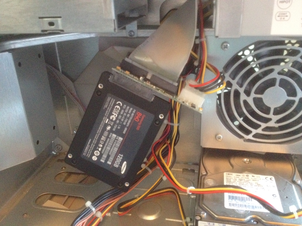

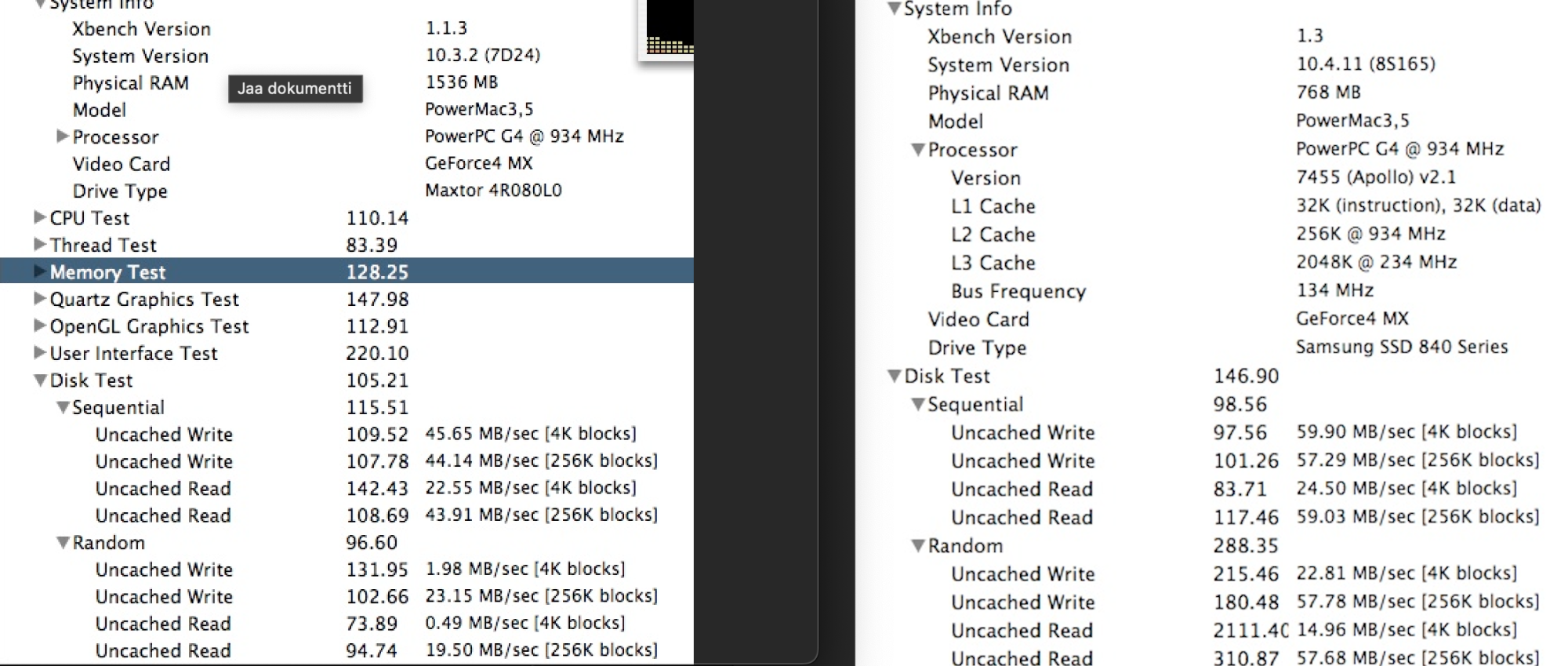

I tried, maybe 8 years ago, QS 933MHz with IDE-SATA adapter and Samsung 840, 120GB, tested it with X-bench against 300GB spinning Maxtor. I'm not sure about the scorepoints, but there are the actual speeds presented too (MB/s), and maybe, just maybe they are to be trusted, I don't know. It felt pretty fast comparing to usage under the HDD. There was a culprit though - it didn't survive sleep.
Uncached read is 28,5 times that of a Maxtor. Anything else is something like a little bit faster. Random speeds (R/W) on average 2,8x faster.
Love the benchmarks. I too have some before and after benchmarks from my QS and my G5 iirc which is interesting because the G4 does not natively support sata where as the G5 did. I’ll have to dig them out as it’s fun to see the difference. I also have spinner raid0 vs single ssd around too which was neat.

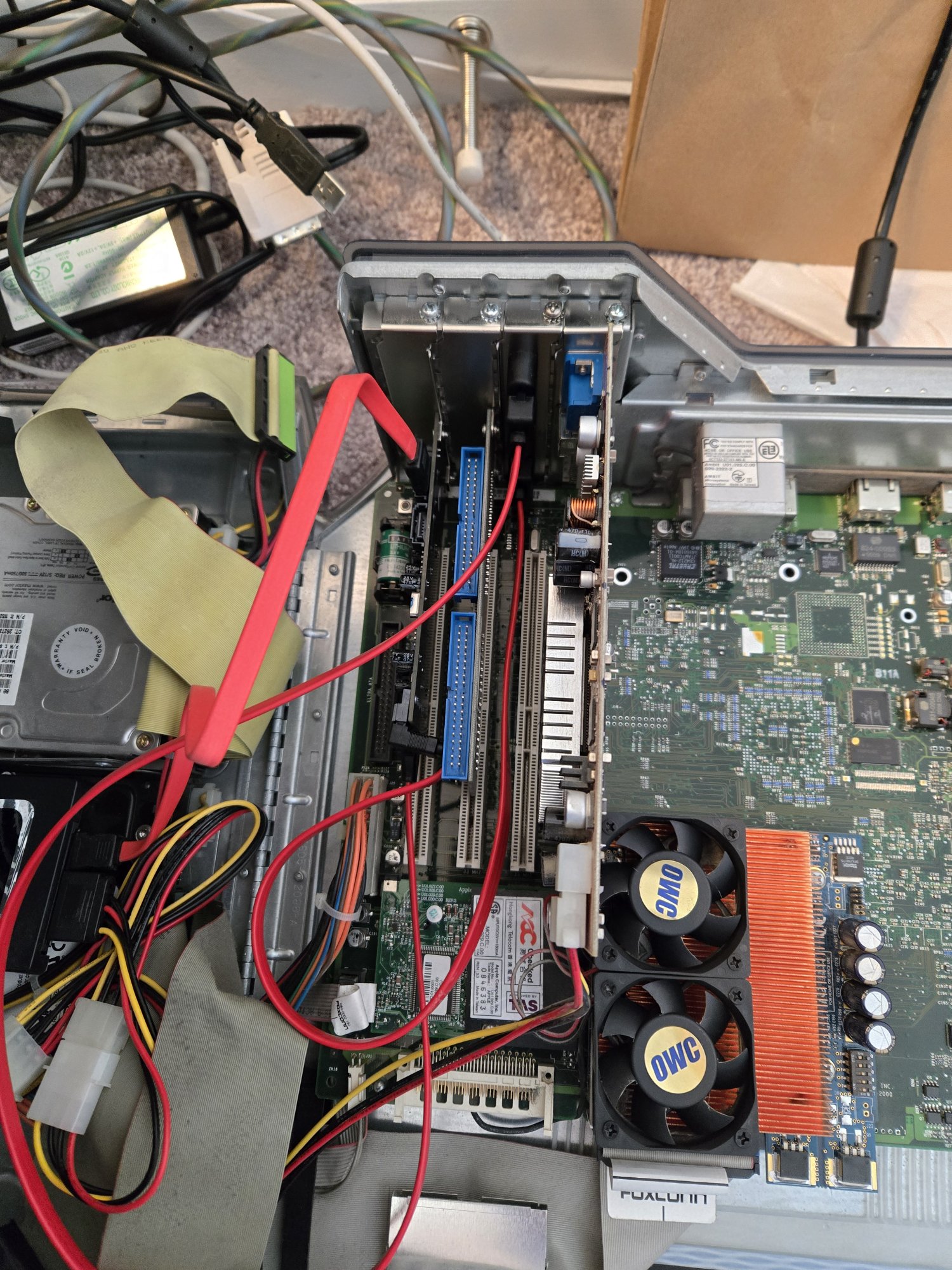

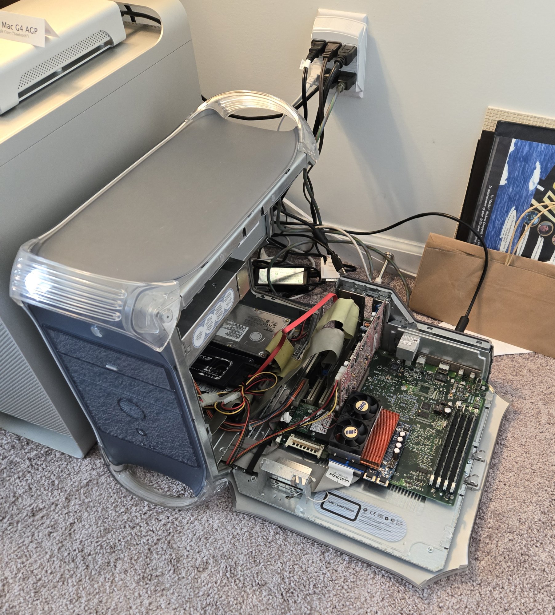

Today, I added eSATA to my Power Mac G4 Sawtooth!
I love working inside this machine - such easy access, so nicely laid out. This picture shows the machine after the SATA card is installed, but before the SATA to eSATA adapter is installed. If you look really carefully you may be able to spot at least two of the HDD spinners and possibly the third one (there are three HDDs in the machine) plus one small SSD immediately to the left of the two spinners that are readily visible, already connected via the SATA card:

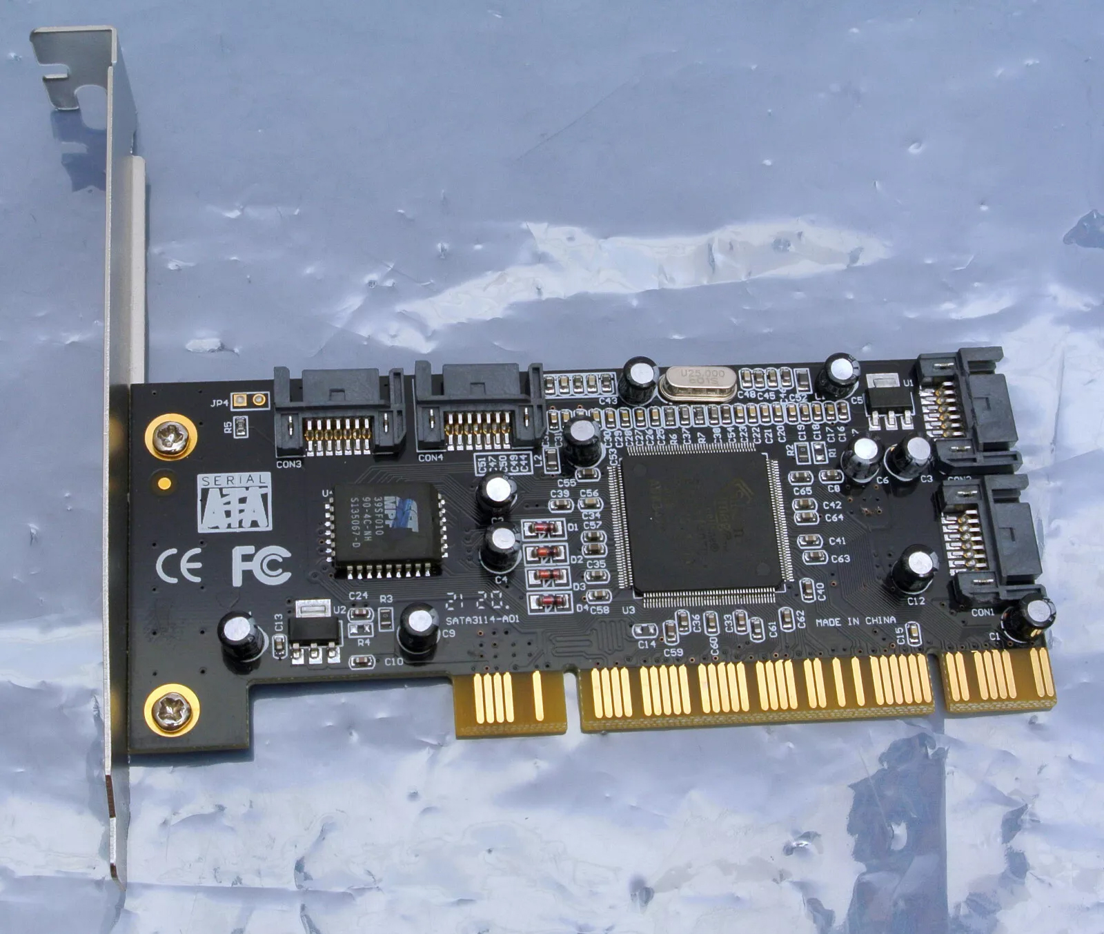

The SATA card I used is a completely generic PCI-X SATA card purchased on eBay (the eBay listing for the card explicitly stated Mac OS X 10.4, 10.5 support):

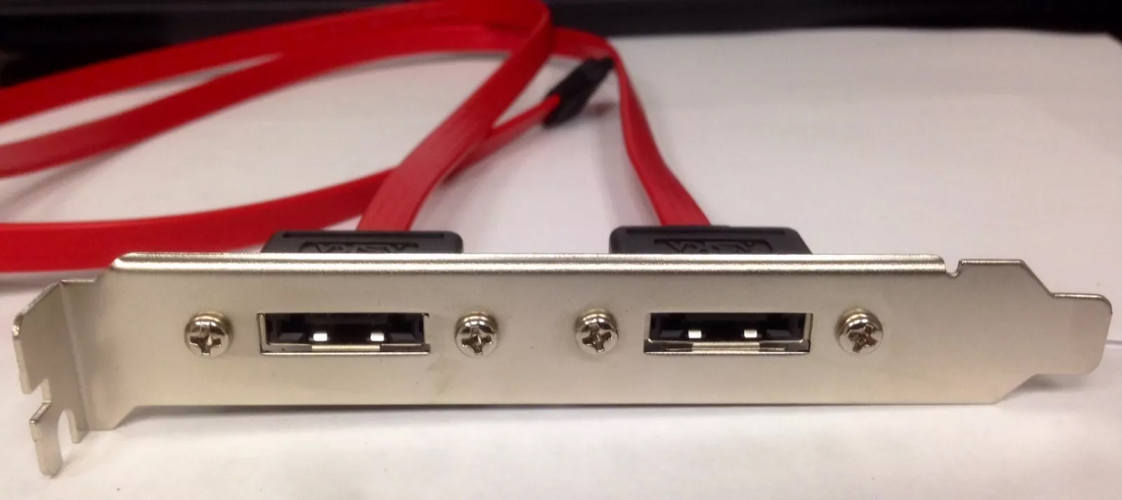

The SATA to eSATA adapter I used was equally generic and also from eBay:
and the net result, with it all installed, looks like this (disk controller cables unplugged and pushed off to the side to provide better visuals of the SATA and eSATA equipment) :
The SATA card is the leftmost one in the expansion slot area; the SATA to eSATA adapter is second from right in the same area.
The whole thing works like a champ! I am hosting an internal SSD and two external eSATA ports with this arrangement, with a 500 GB eSATA-interfaced G-Tech Q-Drive connected to one of the two eSATA ports the adapter presents.
I have benchmarked disk transfer speeds with this arrangement, and it is averaging 35 Mbps in a disk-to-disk transfer, where the source is the SSD and the destination is the external eSATA interfaced Q-Drive. I thought this seemed a tad slow (I am used to 120 Mbps transfer rates with eSATA on my G5s) but then I tested transfer speeds between two of the three spinners also in the Sawtooth and it was the same... roughly 35 Mbps. This seems to be the maximum disk transfer speed for this box.
So, mission accomplished!

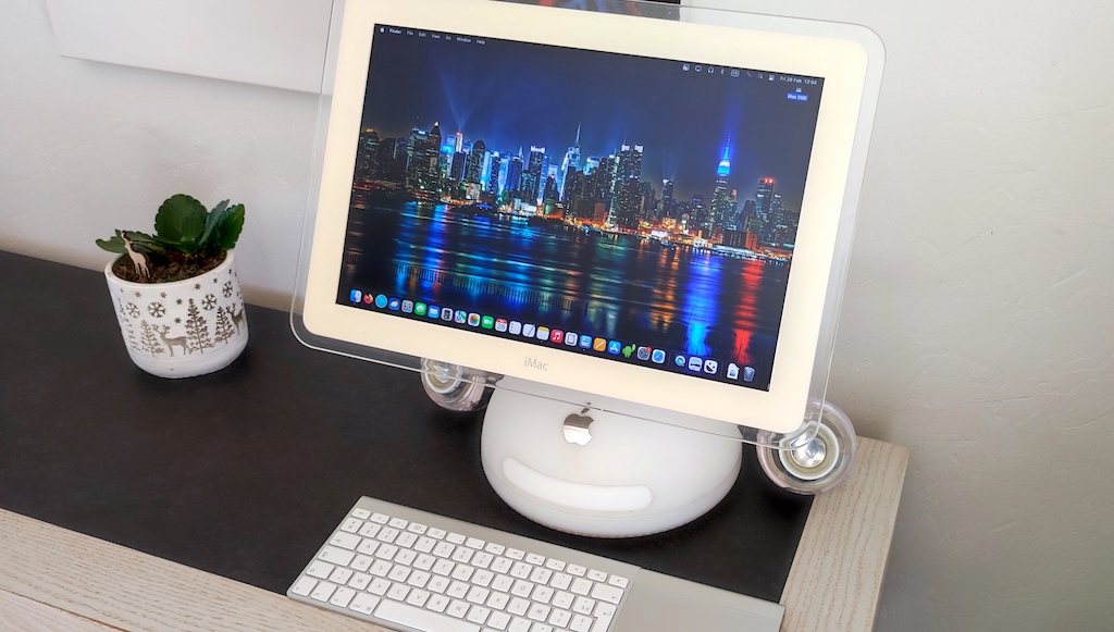

This is what I've done with a PowerPC very recently. Converted a G4 iMac into a functional external display.
Regular readers/posters here may recall my fondness for these amazing machines.
In recent years Apple appear to have lost that 'magic touch' of creating a computer to 'take one's breath away.' Not only did Jony Ive receive the Designer of the Year Award for the G4 iMac, but it’s also on permanent display in several prestigious Modern Art and Science Museums. (Ditto for the G4 Cube).
During the years that I've been collecting interesting Macs, I’ve often regretted that Apple have never launched an updated version of the G4 iMac ''Sunflower" as Steve Jobs so eloquently named it, and to which he added in 2002, "It's a technological tour de force!". No wonder it has to be my all-time favourite.
Some Apple geeks with far more knowledge than myself have shoe-horned the latest tiny Mac Mini inside the G4 Sunflower domed base. I took an easier approach and after removal of the original logic board, I installed a new Juicy Crumb Docklite Board, wonderfully designed and marketed by the Australian start-up who’s mission is to save many interesting computers from being trashed. This effectively turns the iMac’s excellent LCD flat panel screen into an external display.
In fact I found out about this project almost by accident after I'd advertised my 20" G4 iMac for sale, which I'd complertely refurbished with maxed-out RAM, an SSD and fresh install of OSX 10.5.9 Sorbet Leopard. As the 20" version has now become rare, the buyer was so keen to find one, he made a 6hr round trip for the purchase. Apparently it wasn't my upgrade which interested him, his idea was to transform it into a monitor with a new Juicy Crumb Docklite logic board and internally install the latest M4 Mac Mini.
As already mentioned, my approach was simpler. In the photos below the 17" iMac is harnessed to an out-of-sight MacMini M2Pro which can run the latest and future Apple OS's. And the performance with the original LCD flat panel screen and Harman Kardon speakers is still remarkeable!
One other 'icing on the cake' feature of this mod is that there's no 'burchery' involved with cutting or destruction of orginal components. No soldering either.
Kudos also to Dosdude1 for the Juicy Crumb software assistance, especially the facility to change the screen brightness from a menu bar icon, an addition that I find particularly useful.

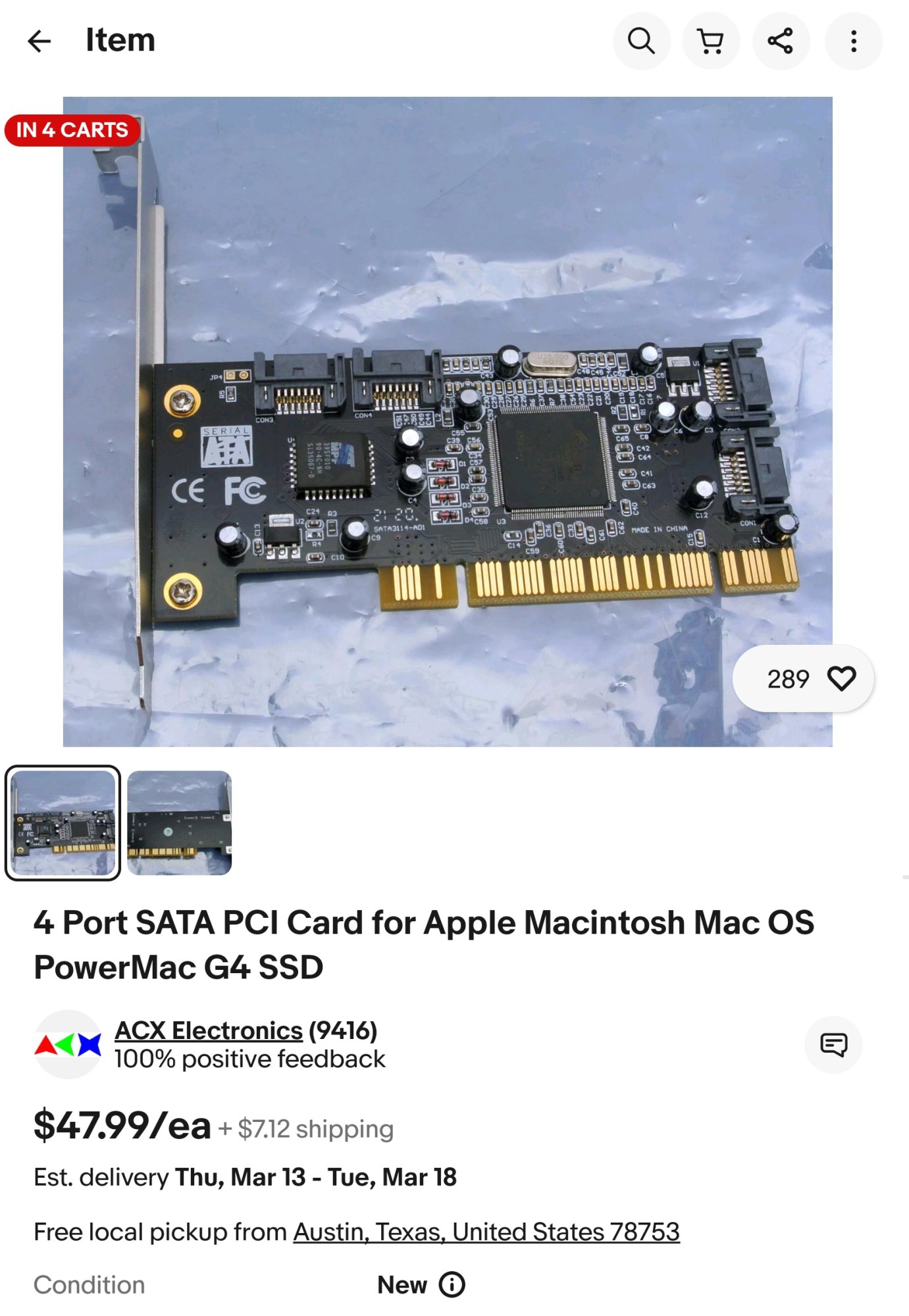

Oh neat, what is the pata pci card you have installed in your sawtooth? I have a number of them from ata 33 through 100 but none work in osx unfortunately.

I purchased the below card from eBay:

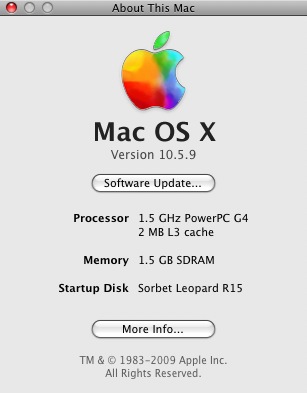

Thanks, @Certificate of Excellence, I applied the instructions in your video, which was for Tiger, to Sorbet Leopard and it worked equally well.
I used a different Apple logo than you did (thanks for including it though!), one that I snagged from a presentation Apple did years ago, where the logo used was on screen long enough to get the Apple cognoscenti quite excited about the possibility of a revised Apple logo. That never happened, but I kept the logo - I liked it - figuring I would use it one day. Today, it appears, is that day!
One reboot later and the "About This Mac" dialog, from Sorbet on my G4 Sawtooth, looks like the below (I absolutely love the addition of color to this otherwise monochromatic dialog box!):
For those of you who might want it, the original logo file, 700x700, is also attached. I used Photoshop to size reduce it to 88x88 and then overlay it onto the existing Apple logo in the Resources section of the Sorbet loginwindow.app file (Show Package Contents, Contents, Resources, MacOSX.tiff).
The card that provides those blue PATA connectors? I don't know! It was there when I received the machine (it was a donation from a fellow employee who knew of my interest in vintage Macs), and has always worked well. I have never had cause to examine it!

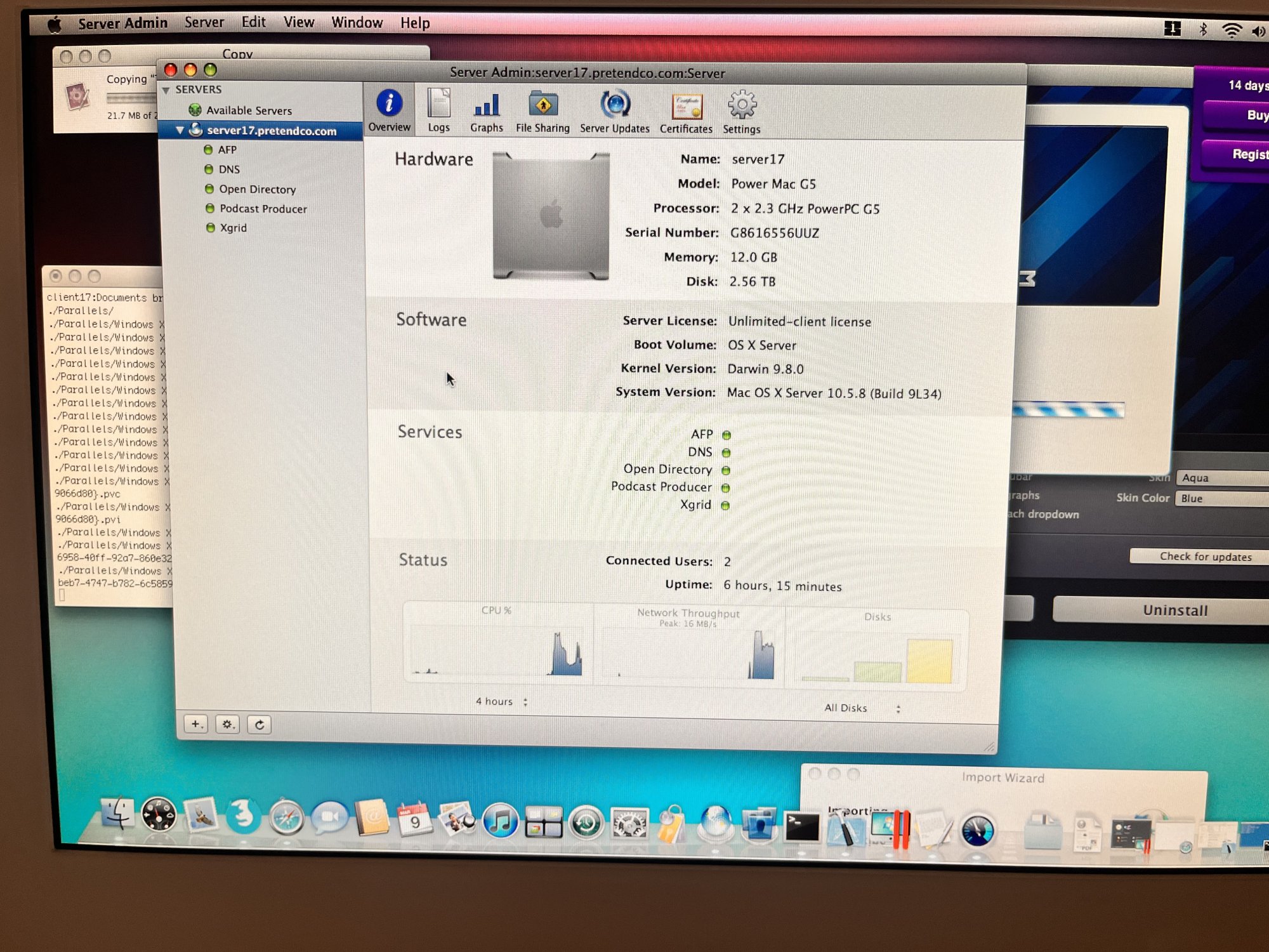

Follow up to my last post above, running OS X Server 10.5 on my late 2005 Powermac DC G5. I managed to create a network bootable disk image on my 17-inch iMac. I then used that image to simultaneously boot both my 2006 Intel iMacs as diskless network clients off of a PowerPC G5.
OS X Server is an interesting piece of software. It obviously didn't make much sense as a consumer product, but I can see the utility of being able to network boot a lab full "diskless" of iMacs or do centralized management of multiple Macs. I also got the email server running on my Apple Intranet and can send emails between network accounts. Obviously, won't be putting this online, and I'm using a wired LAN with an old Airport as the hub. My Powermac server has been up several days now without any issues. It's a reliable piece of software when used correctly.
Now I'm playing with xgrid to try running some distributed batch jobs across the network.
