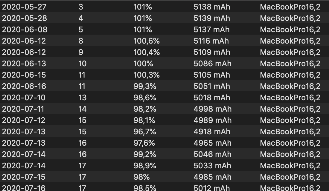

Is this a spreadsheet you created or did the computer log the information for you automatically?
Where is this information?
It's from coconut battery screen capture.

Has anyone experienced a battery health drop since using Al Dente? I was kind of worried about this issue:
Although it's a single user's recount and I could not find anyone else experiencing this.
Today though my health has dropped from 98% to 96.1% in coconut battery (at 17 cycles), while history shows today it is 98.5%. I have set Al Dente to stop charging at 55%.
It could be that it needs to be charged to 100% for correct readings, though.

Sorry, I edited the post - I am using Al Dente and limiting to 55% charge capacity. As you can see the history has never went down to 96% before so it just thought it was weird to go down 2.5% from last night to today when i woke it up. Actually, there is one spot when it was at 96.7% and it has went up after that point. I wonder how reliable is the health estimation in general.
I've only been using Al Dente for 2 days though and prior to that I have used catalina's BHM system.

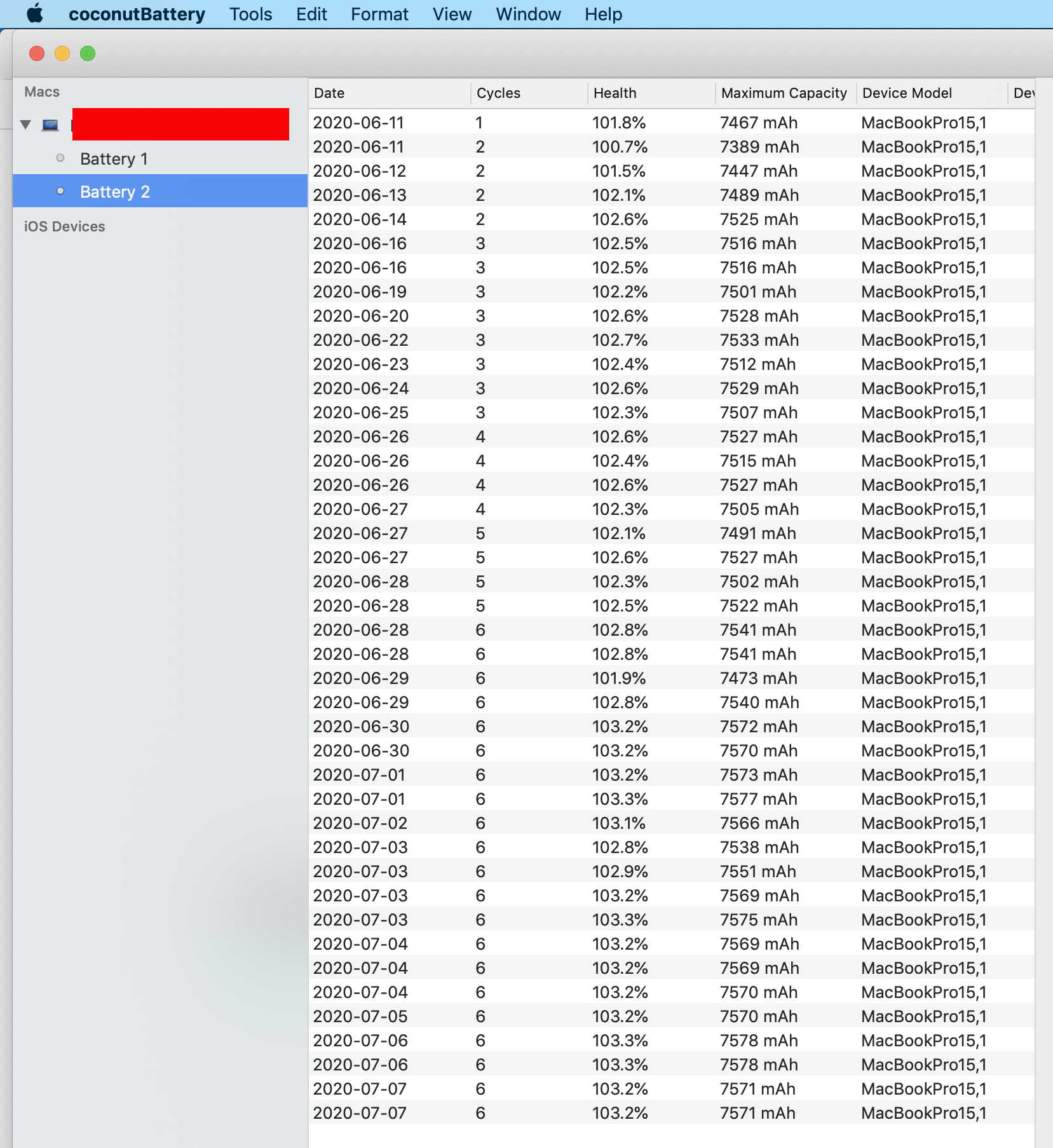

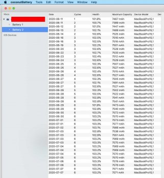

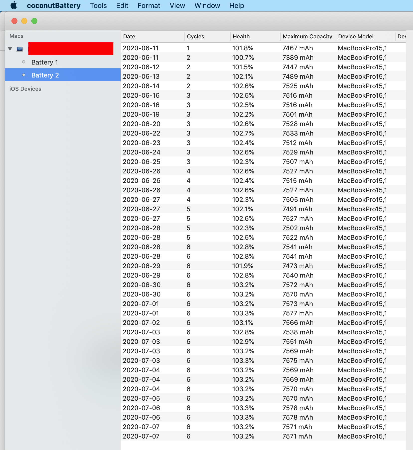

Just for your reference, here is my battery health. Since not every battery is made perfectly to be at 100%, mine has a slightly higher capacity.
As you can see, since the beginning of June (it doesn't show on the picture) when the battery was replaced under AppleCare+, I've been using Charge Limiter at 50%, some days at 55% just for kicks.
As you can see, my battery health has not changed but actually seems to have increased slightly.
You can see on the top right corner the battery is at 52% (even though I've set it at 50%) and not charging. I've noticed there seems to be very slow trickle charging even when the battery show not charging. This may be the reason why it is really bad to leave your battery plugged-in and charged at 100% all the time.
