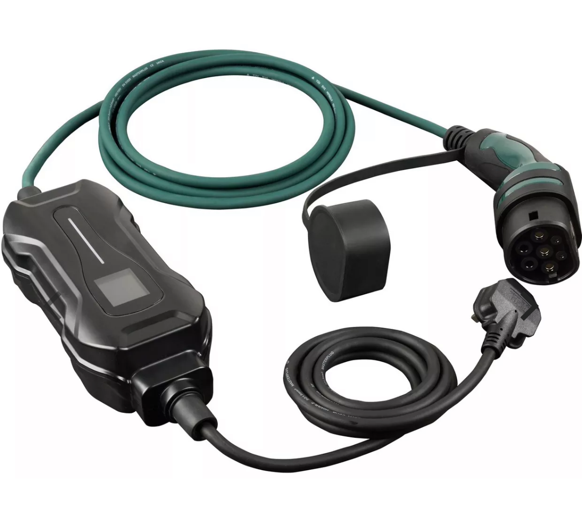

All this talk of different voltages and the like is quite confusing for those that are not in the US.
Here in the UK all our sockets are 240v.
We have slow chargers (usually called a granny charger). You plug it in to ANY socket. It just takes a long time.

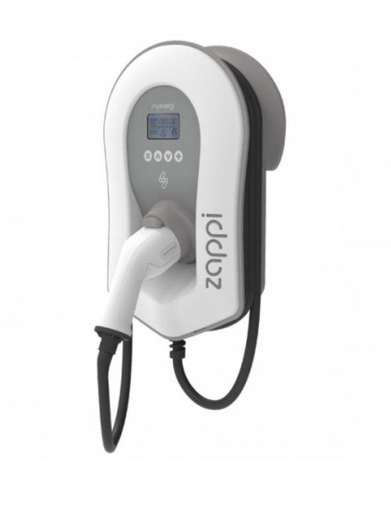

Then dedicated fast chargers. These are the chargers you get installed at home. POD point or Zappi being two examples.

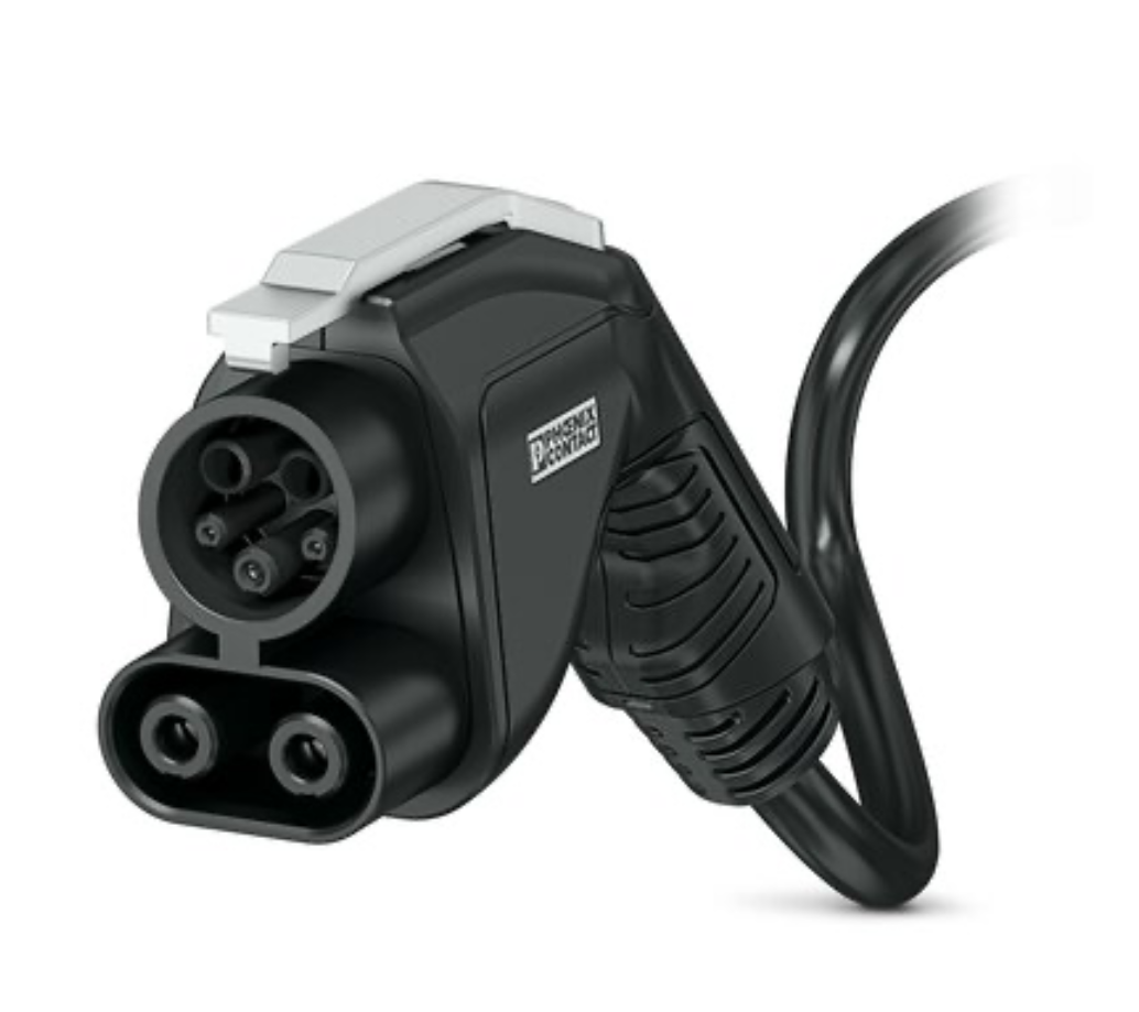

Then fast or rapid chargers are the type you use at the motorway services. They have the DC connection with the two extra pins.
