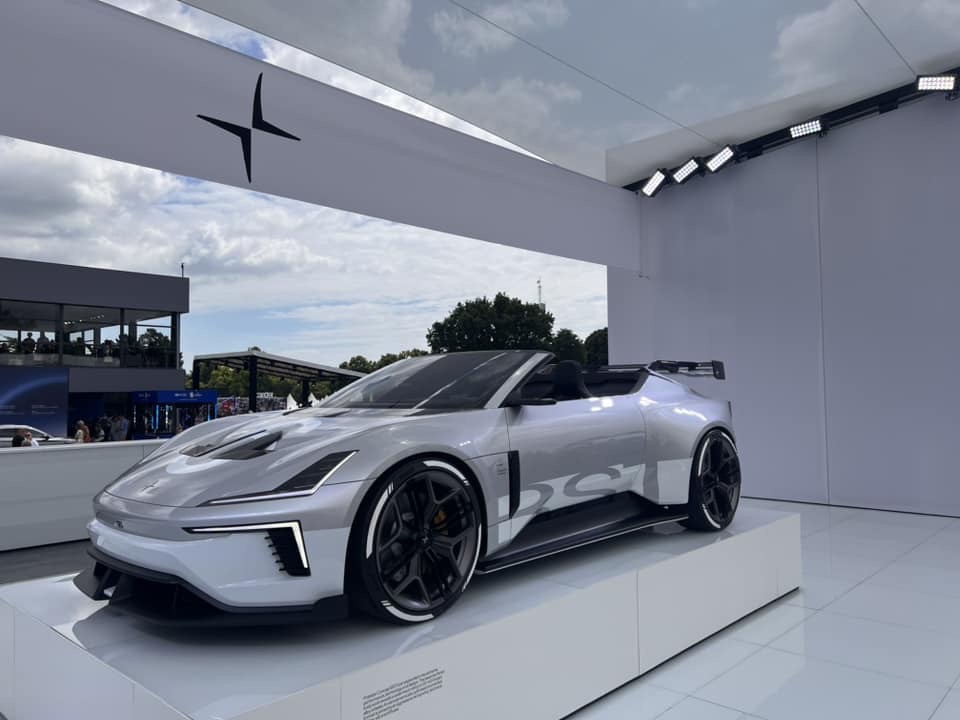

Ok, I think our (near) future household EVs will be that our Polestar 2 will be exchanged for a Polestar 3. But then if they do the BST Concept I'll have to put my name down, love the looks of this fun little thing.
At the Goodwood Festival of speed last week ;)
Together with Porsche's announcement to no longer do ICE cars, it will be the fun era for EV 2 seaters I think.
PS. My daughter would love the Renault 5 as her first car. It is very cool IMO.
