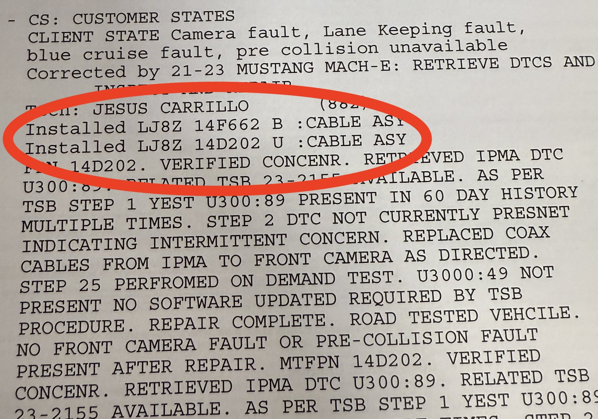

Ford BEV just came back from a warranty repair - 2 faulty coax cables causing cameras, lane keeping, automated self driving and frontal protection to fail.
If it had been non warranty, cost would have been around $4,000 USD.
Now I am spooked.
Going to trade/sell it when it reaches the 3 year /36 month warranty expiration!
Now I am spooked.
How old is the car? Cable failure seems very odd…
Reactions: 4sallypat
4sallypat
macrumors 601
Sep 16, 2016
4,035
3,785
So Calif
2023.
It's been 18 months into ownership and the issue was intermittent months prior.
But when the failure messages starting popping up 2 or 3 times a day and interfering with my safety systems, I brought it in.
Now I am starting to look for a replacement because I don't want to face huge non warranted repairs like this.
And here I thought having a 8 year / 100K HV traction battery warranty was enough = not now..

2023.

2023.
Makes me wonder if this is a common issue, but I don’t know any details about the Mach-E, just again, why would a cable fail unless it’s a mfg defect or you have rodents eating into it?
Mostly agree. But other reasons could be
Passes through bodywork without a grommet.
Salt or water erosion.
Either way they are both design floors.
Apparently, based on others who have this issue (quite common) and have fixed it themselves, the coax cables contain a fragile fiber optic cable bundle and that is what fails due to wear and bends around corners.
The DIY folks say that you have to handle the coax cabling like a virgin 😭
diamond.g
macrumors G4
Mar 20, 2007
11,459
2,690
OBX
thy use fiber and copper in the same cable? Interesting (folks tend to be more careful with fiber than copper).
yea, I was wondering whether they use fiber optic, they are delicate for sure and don't like tight "corners/bends".
Infancy problems I suppose ;(
