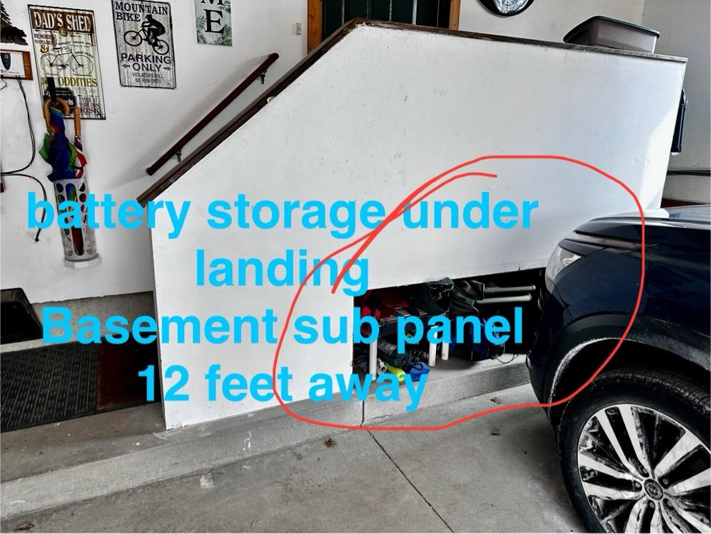

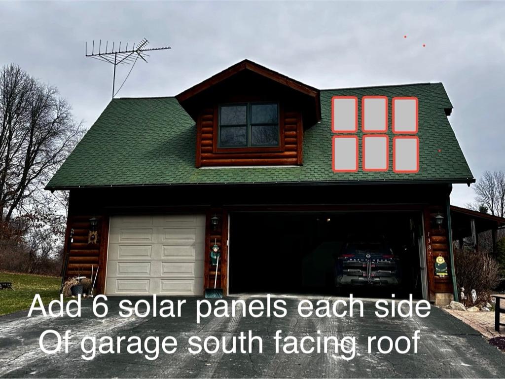

Who here has solar panels
Yes, I have 7.4kW of panels spread across three strings on a very tricky roof layout.
You should go more than 6 panels - just put as many as you can.
Assuming you were using 430w panels, 12 of them gives you 5.16kW, reasonable but could be more. Then add batteries (you can get modular systems like BYD - add more when needed) and you are done.
You can get panels that do more watts, but they are also larger size. So do your calculations and work out how many can fit safely. Depending on your roof space you could also go more strings of panels to get more power for more of the day.
You batteries shouldn't be under the landing, put them somewhere they are easily accessible and also if anything happens to them, less risk.

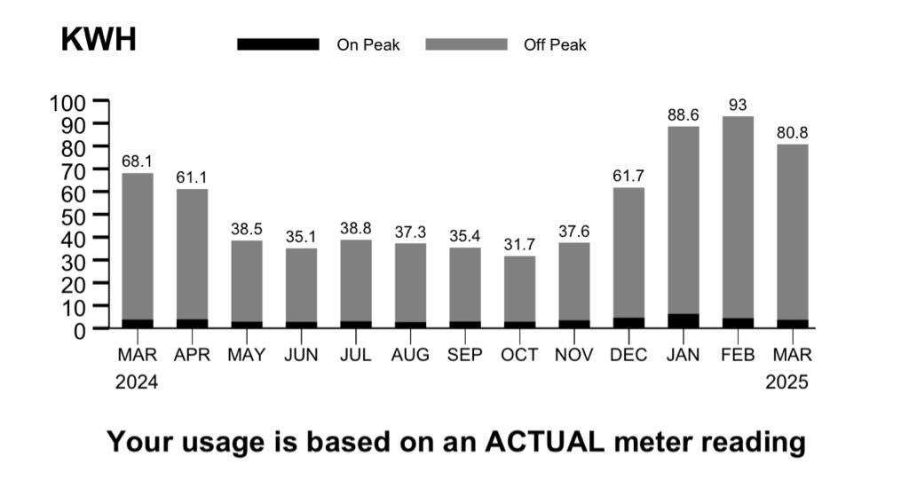

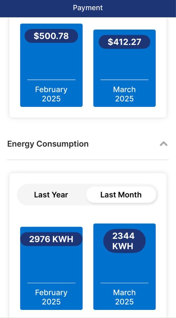

and on how Much sunlight you get. I’m in Northern California, so high electric bills and lots of sunlight makes solar an easy decision.
Our total annual electric bill is approx $3200, whole electric home, no gas.
Highs are $450-ish largest winter and lows $190-ish spring / fall. Even summer $250-ish with AC running.
