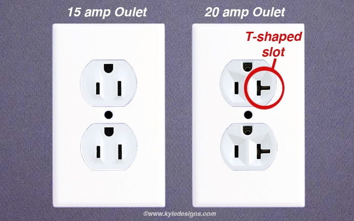

The breaker for my garage says it's 20amps but I notice the wall outlet gets pretty hot when doing 16amps so I turned it down to 15amps (5 miles/hr). We can do 60+ miles from 6:30pm - 6am from our outlet. We drive 104 miles every 2 days so should be good with outlet at home alone - not even counting free charging at university!

The breaker may be 20A, but the outlet may be designed for 15A. I would turn it down to 12A to ensure an 80% load on the outlet.
main-qimg-a1fabe975fbfc9401818b49512c96779
Ouch! Thanks for the info - will do. It's definitely a 15 amp outlet on a 20 amp circuit then. No wonder why it was getting warm with 16. (I was able to do 16amps for several hours (wow)). I ended up turning it down to 15 overnight due to the warm feeling (ran this all night long). Will only do 12 going forward! Thanks. (We didn't charge last night at home because we went to the Tesla supercharger earlier in the day (just to see what it was like)) - 100+ miles for $4.

Starting to wonder if the university outlet is only a 15amp outlet....... (It's a heavy duty metal box - for each stall).

College outlets are 20 amps.

Ouch! Thanks for the info - will do. It's definitely a 15 amp outlet then. No wonder why it was getting warm with 16. (I was able to do 16amps for several hours (wow)). I ended up turning it down to 15 overnight due to the warm feeling (ran this all night long). Will only do 12 going forward! Thanks. (We didn't charge last night at home because we went to the Tesla supercharger earlier in the day (just to see what it was like)) - 100+ miles for $4.
Yeah definitely sucky for the builders/electrician to put in an 20A breaker, but go cheap and only do an outlet only meant for 15A. Granted they probably never anticipated EV's/plug in hybrids and made the "safe" bet that if you did plug in a device wanting 18A, you wouldn't use it continuously where it could cause a fire.
Can you change the outlet to 20amp provided the breaker and the electrical connection supports the upgrade?
Got an electrician coming tomorrow to inspect the garage. Will definitely ask them that question. I'm hoping they'll be able to install an EV charger for under $1500 too.
Keep in mind that the outlets at home are connected in parallel to the 20-amp circuit breaker. So lest say that you have 4 outlets in your living room all the components connected to the four outlets typically don't draw enough power to trip the 20-amp circuit breaker. In this case it doesn't mater if you have 15-amp or 20-amp outlets in your living room, since what trips the outlets it the sum or total amperage being drawn by all the components. But components such as refrigerators, countertop ovens that "do all" (bake/toast/air-fry, etc.), microwave ovens, or just a simple toaster can trip a 20-amp outlet if all of these components are energized (turned on) at the same time. In this case it is very possible for the total amperage drawn to exceed the safety limit of the entire circuit. The refrigerator should have its own circuit breaker so it is not shared with the other components in your kitchen, and it doesn't mater if the refrigerator outlet is a 15 or 20-amp one.
The circuit breaker is a safety device that is used to "open" the circuit before the wiring and outlets get too hot, which in turn can cause a fire. Replacing a 15-amp outlet with a 20-amp one should not make a difference. If the 15-amp outlet is getting warm to the touch, it means that the outlet is defective or the wiring connected to it are also getting warm. Loose connections at the outlet could also create heat.
Look at the charger's ratings. If it requires a 20-amp circuit, you may want to have an individual 20-amp circuit, one that is not shared with other chargers or components, much like the one for the clothes washer, or the refrigerator.
A 20-amp circuit breaker would support somewhere around 2,400 watts on a single circuit. The safe (before it trips) is approximately 1,920 watts. But the circuit should never be loaded past 80% of the circuit breaker's capacity.
Look at the charger's ratings. The placard should indicate the what type of circuit it requires. Also, you have to know which chargers you can use for charging your EV's batteries, the instruction would be in the owner's manual. And I repeat, know which charger's level should be used to charge your EV.

I am not very electricity smart. I knew that the garage was on a 20 amp breaker but I figured all the stuff in the garage shared that 20 amps. We have a gas instant hot water heater, a super tiny garage door opener, and one outlet. So when the Tesla cable was only pulling a max of 12 amps, I figured, I'd spend $200 on a cable touting 16 amps thinking that'd be fine for the 20 amp breaker.
What I didn't understand at the time (till a helpful person posted above) is that the outlet itself was only designed for 15 amps. So when I was drawing 16 amps, it got warm (not hot) so I lowered it to 15 and left it charging overnight. Now, I see why Tesla's cable limits to 12.
The university's outlets are 20 amp outlets (the -| | design), so I feel much better about using the 16 amp cable (6 mi/hr) with that (vs Tesla's included cable that only does 12 amps (5 mi/hr)) - was just hoping it would be more like 7-8mi/hr. lol.
Yes, all the outlets in the garage are shared (all depend on the 20-amp circuit breaker). However, drawing a continuous 16 amps, you are already near the tripping point of the circuit breaker. If the charger is drawing 12 amps, it is ok :)

Yes, all the outlets in the garage are shared (all depend on the 20-amp circuit breaker). However, drawing a continuous 16 amps, you are already near the tripping point of the circuit breaker. You can have the electrical leads checked by an electrician.
Agreed - after doing some reading and receiving very helpful advice here - after that initial night, I've limited it to 12amps at home (charging at 12amps now).
