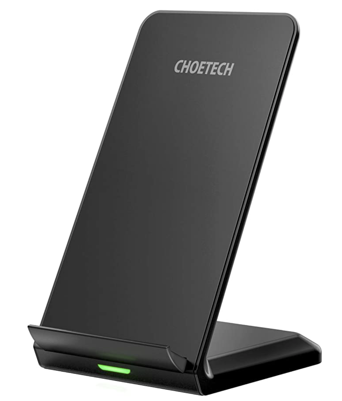

Right I've got my experience here. iPhone 12 Pro max does NOT work with Choetech wireless charging stand.
It works only without the case ... don't understand how come the genuine silicone case shields it!!!

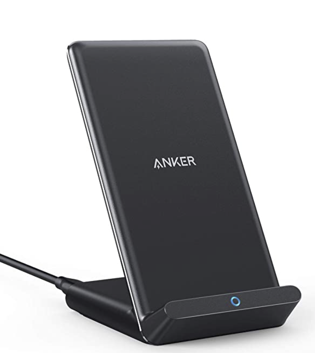

I need a wireless charging STAND and it seems the Anker below works. Any real life experience with iPhone 21 pro max and silicone case?

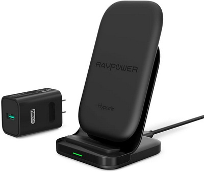

I have Anker PowerWave 7.5 w/ Internal Cooling Fan and RavPower. Neither work with my 12 Pro Max. On the Anker the blue light flashes and doesn't charge. On the RavPower it charges for about 5 seconds then charging stops and the light blinks red.

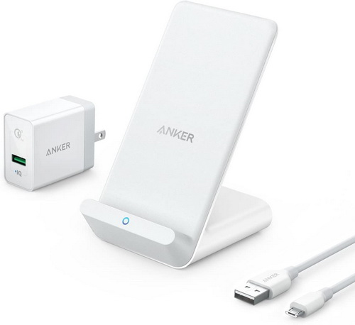

Auch!! Don't know why I thought I read somewhere the Anker worked well! Probably it was the Anker Powerwave Upgraded (which looks identical to the other one).

Also, it's extremely strange as the Choetech stand I've got works with the 12 Pro Max without the silicone case!
It does not make any sense!!!

Yeah, I've been wondering what the difference is between the Anker PowerWave that I have and the Anker PowerWave Upgraded and if the "Upgraded" version works with 12 Pro Max.

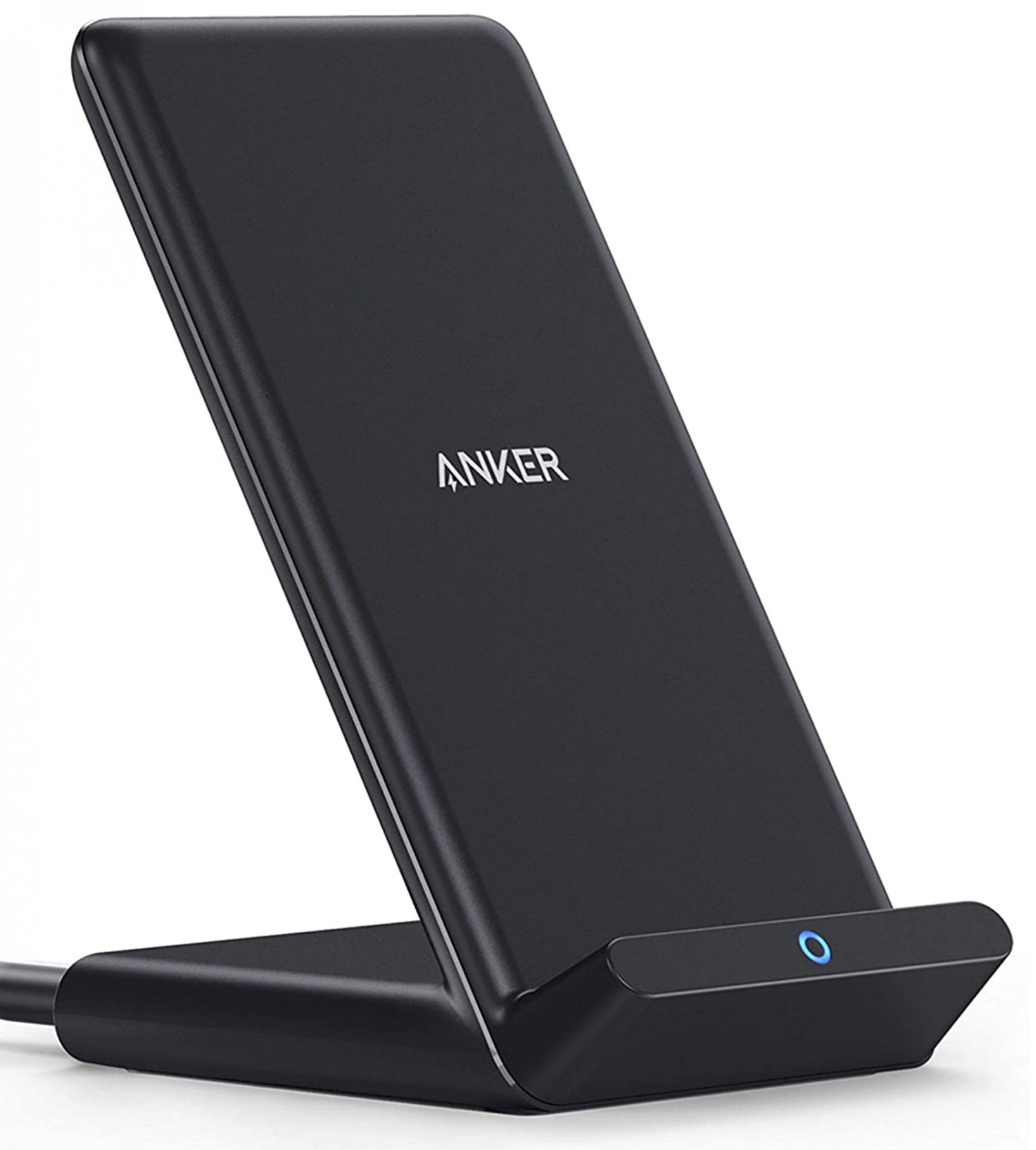

I’m not sure why several of you are having problems with the Anker Power Wave. I have a 12 Pro Max with an ESR clear case and it works with my Anker Power Wave version 7.5 I bought from Amazon in February of this year.

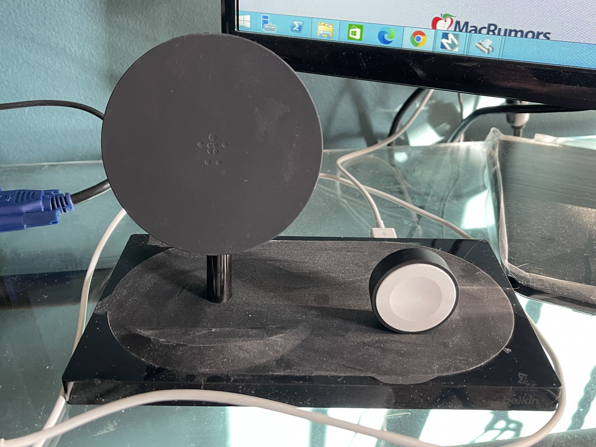

I have one of the phone/watch Belkin chargers and my 12 Pro Max won’t charge on it. If I hold it sideways it will, but has to be placed just right.
Ugh. Frustrating.
Edit - I put the phone upside-down and it's charging....so I guess the magnets or whatever are higher on the top of the phone, so however it's positioned upside down it works.

I can report that the Anker PowerWave 7.5 I bought in 2018 (part number A2522) does not work with my iPhone 12 Pro.
Hmmm... that’s interesting as that’s the same model number as mine yet mine works fine.
