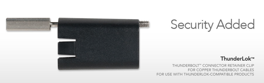

Sonnet even has a Thunderbolt screw adapter, but of course it only works on custom ports with the threaded hole:

As for the wiggle thing... Use a better connector. I never once disconnected a wire by moving my laptop or pc... But then again I'm prudent when handling $$$ electronics.
