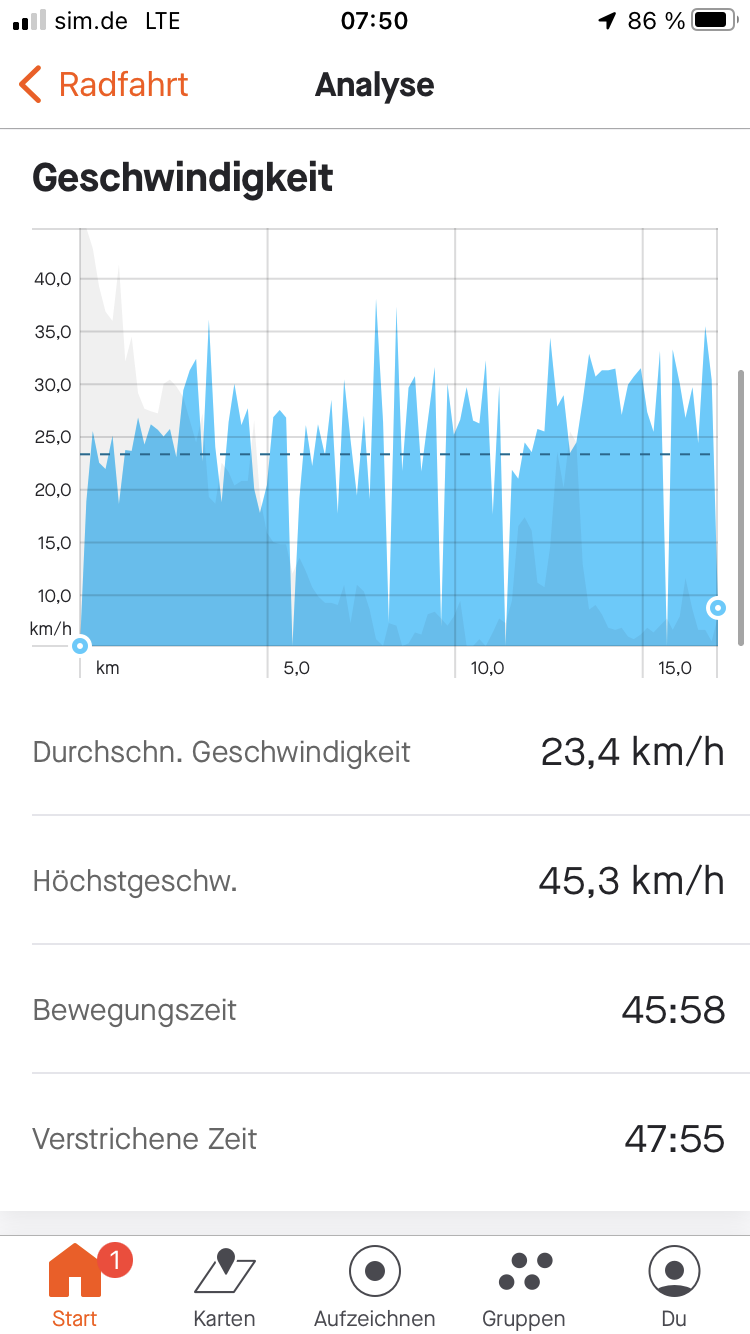

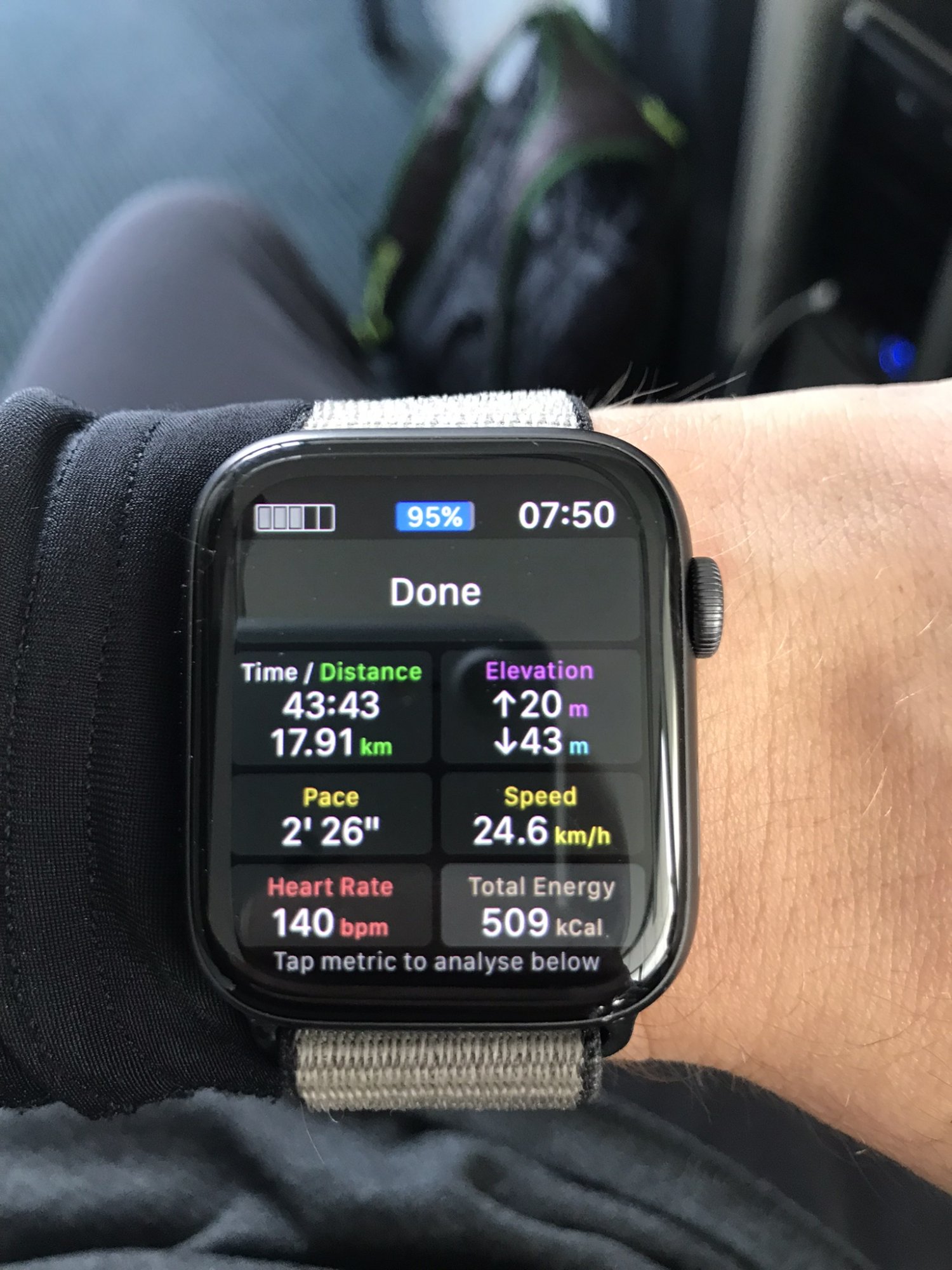

Good morning all,
Im using workoutdoors almost every day on my apple watch with the automatic sync option to strava. But the data are not consitent (time, speed).. How can that be? The pictures are showing the same trip. Is there anything I could change?
Thank you! Workoutoors is uploading a TCX file to strava. I changed that now to GPX and will see if it is better or not. Otherwise there is not very much I could do.

There are many reasons why the data in Strava may differ because they tend to recalculate everything from the GPS positions. Please send the wkt file to info@workoutdoors.net and I will take a look. To do this tap the Export button 3 times quickly.
The next version of the app offers FIT export and this will be the default for uploading to Strava because they seem to respect the data in it more often.
