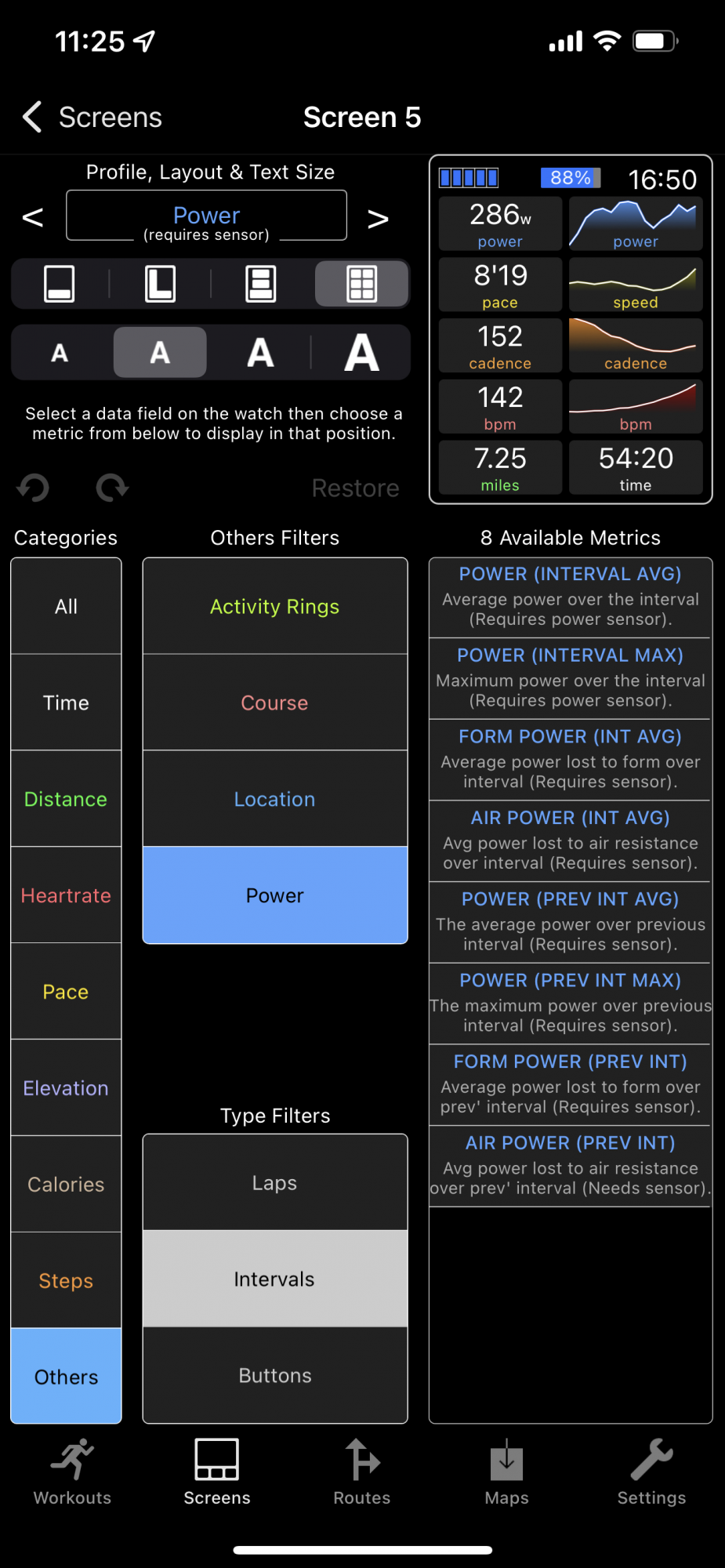

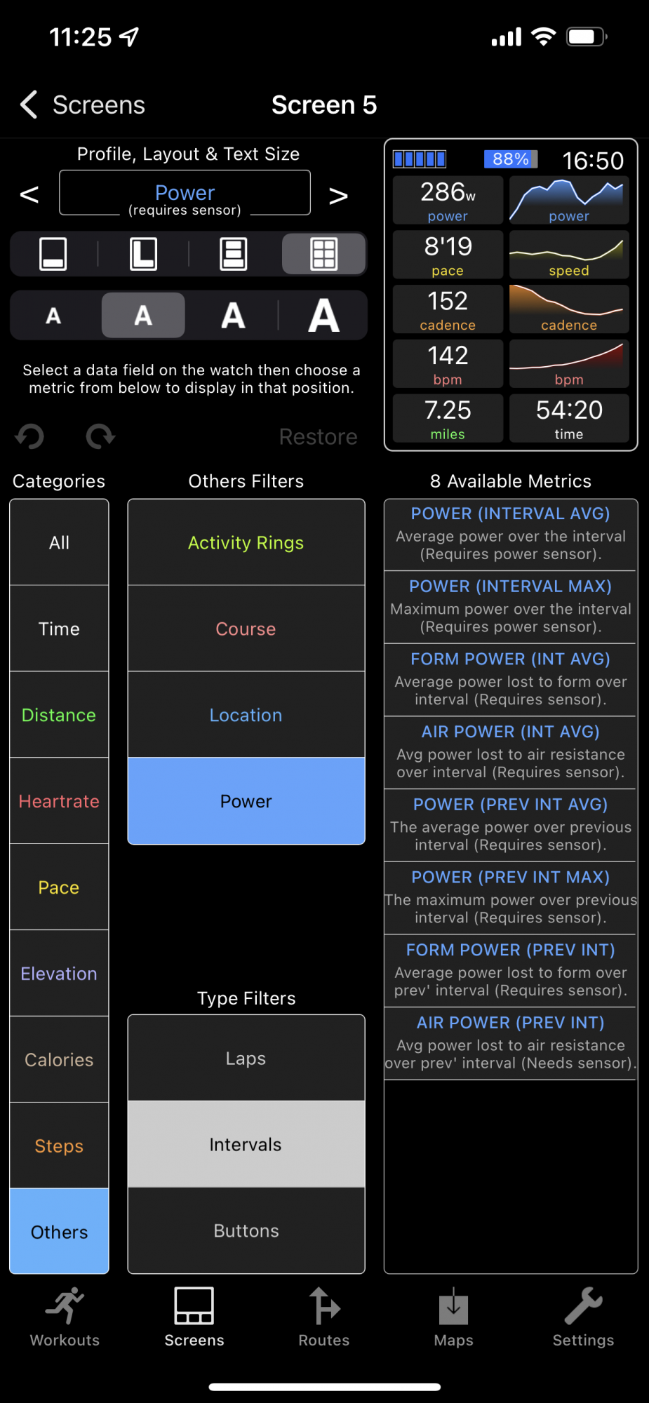

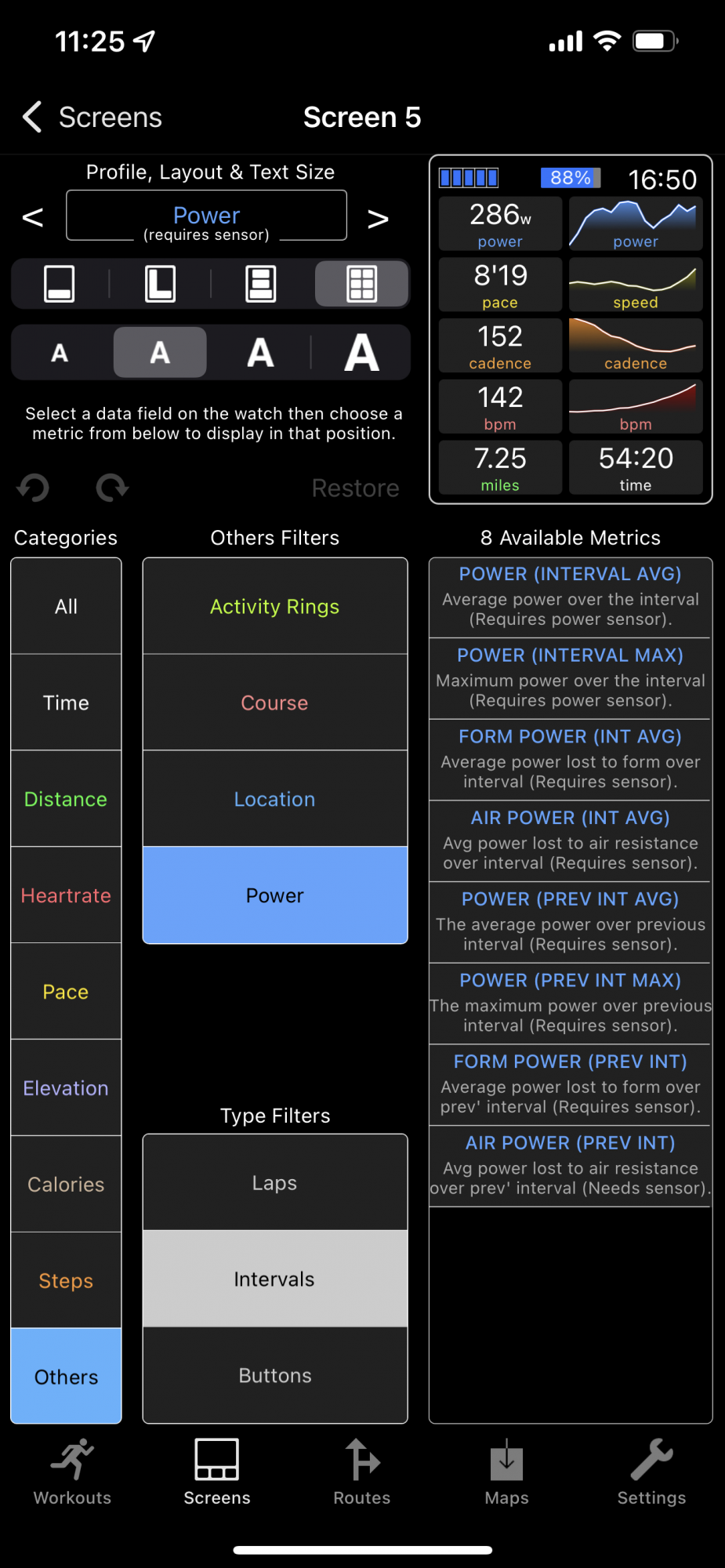

Tested out a run with Stryd this morning. Worked really well! One thing my Garmin does that I really like is show the lower/upper bounds of the target zone. Is this possible at all? Like Low-Current-High: 200-214-225, for example, where the lower/upper bounds could be shown in small text and the current power could be emphasized.

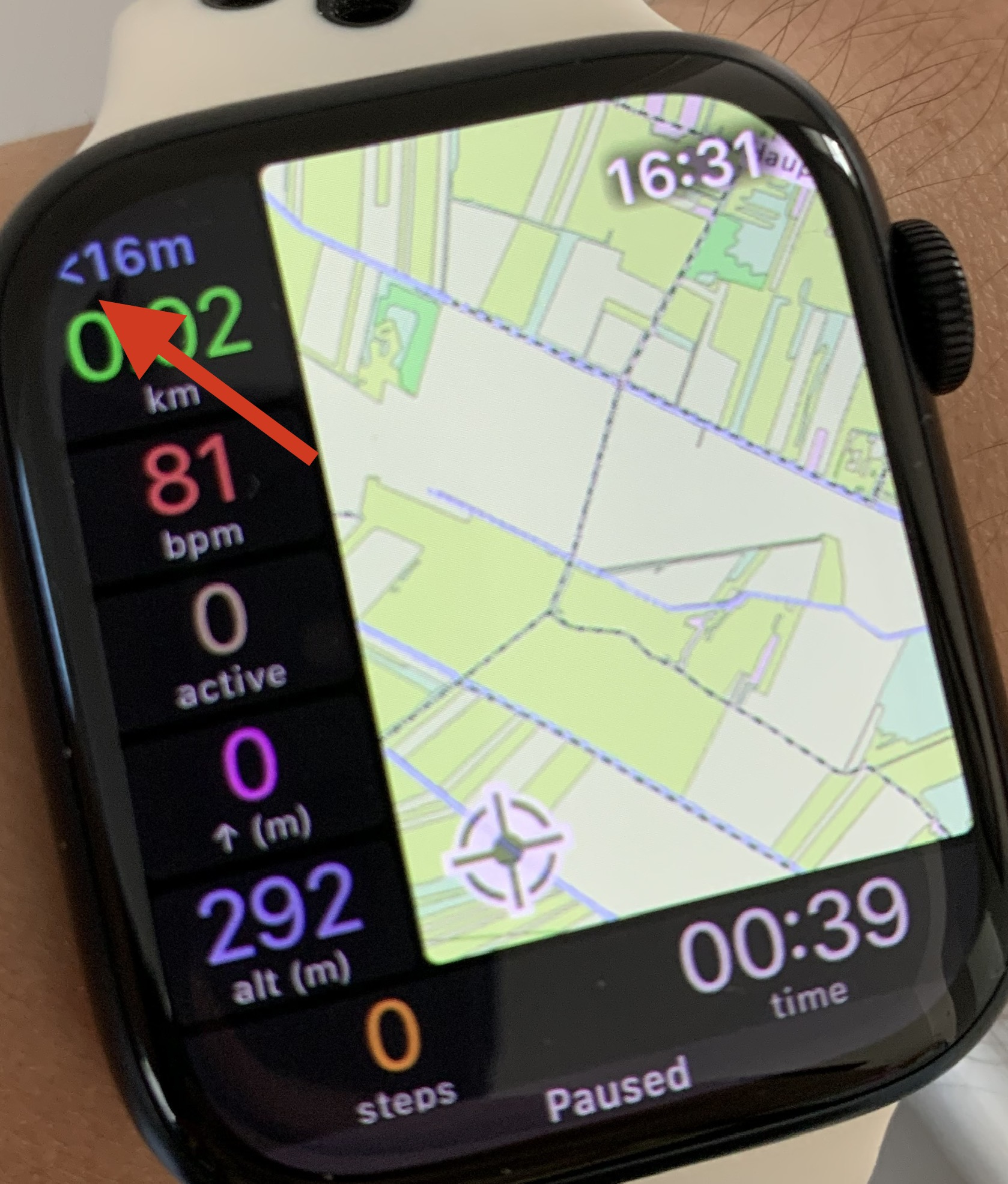

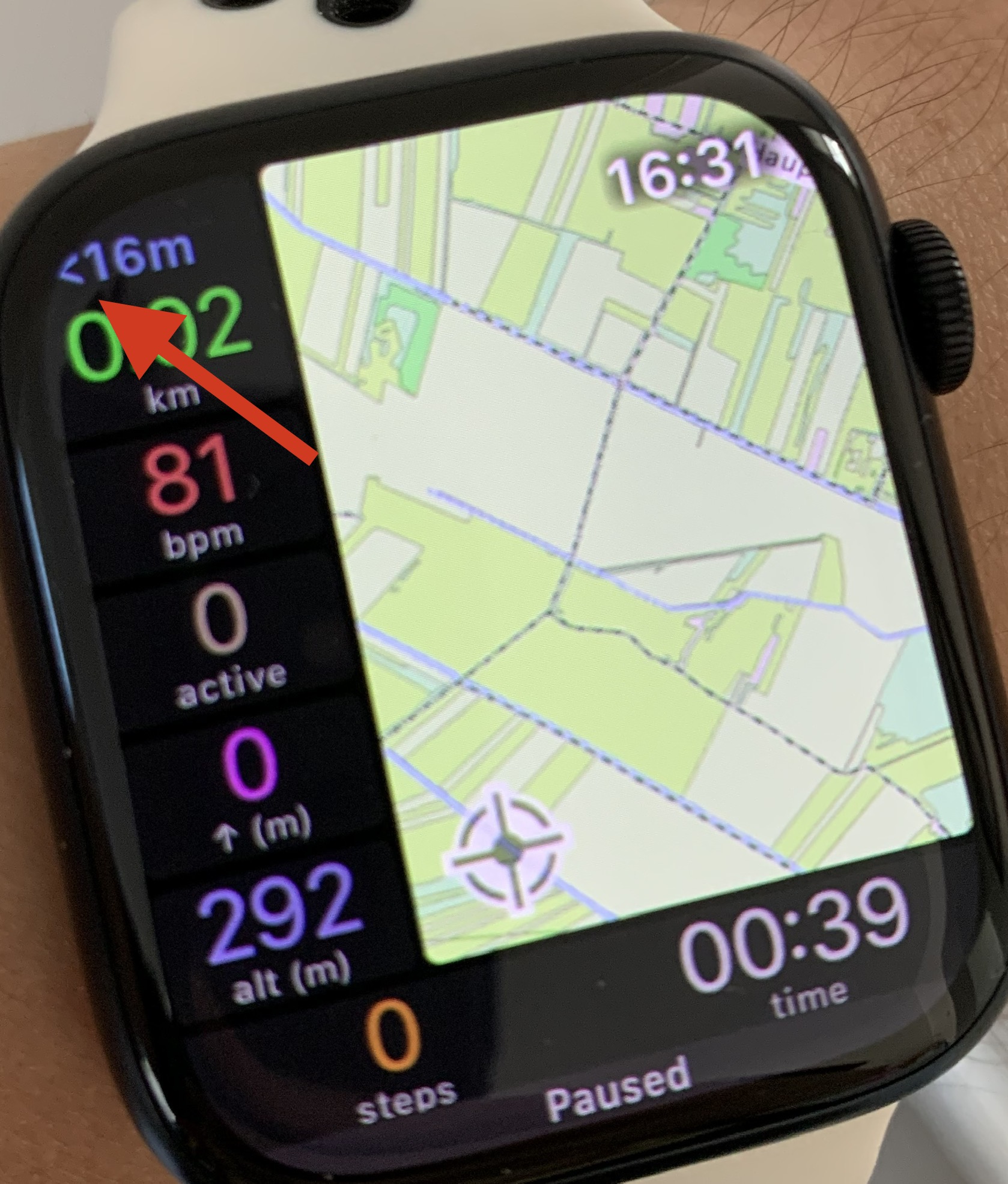

Thanks for the latest update with AW7 support! Perhaps just a little cosmetic change could be made regarding the GPS strength in numbers… 🙂 See attached photo.

Glad the run with Stryd went well. You can show the target low and high in their own separate metrics but there isn't a metric with 3 values. I may allow more complex metrics such as this in the future, but only for full width fields.

You can change that in the Map settings. By default it is a 5 bar meter, so you probably changed it to use numbers in the past.

Well, actually I've been using the numerical display instead of bars because I prefer to see the actual accuracy by meter rather than bars. What is the bar to numbers scale, by the way? 5 bar ... <5m? 4 bar ...<10m?
5 bars: <= 8m.
4 bars: <= 16m
3 bars: <= 34m
2 bars: <= 150m
1 bar: <= 500m
0 bars: > 500m
It's a bit arbitrary based on fine tuning over the years, so may change in the future.
Really? I couldn't find it as an option. Screens > Power profile > Categories > Power with Intervals filter.
Tap on Power to deselect it and you should see Interval Target High and Interval Target Low.
It is not a power-specific field because the target can be a heart rate range, a pace/speed range, or a cadence range, rather than a power range.
