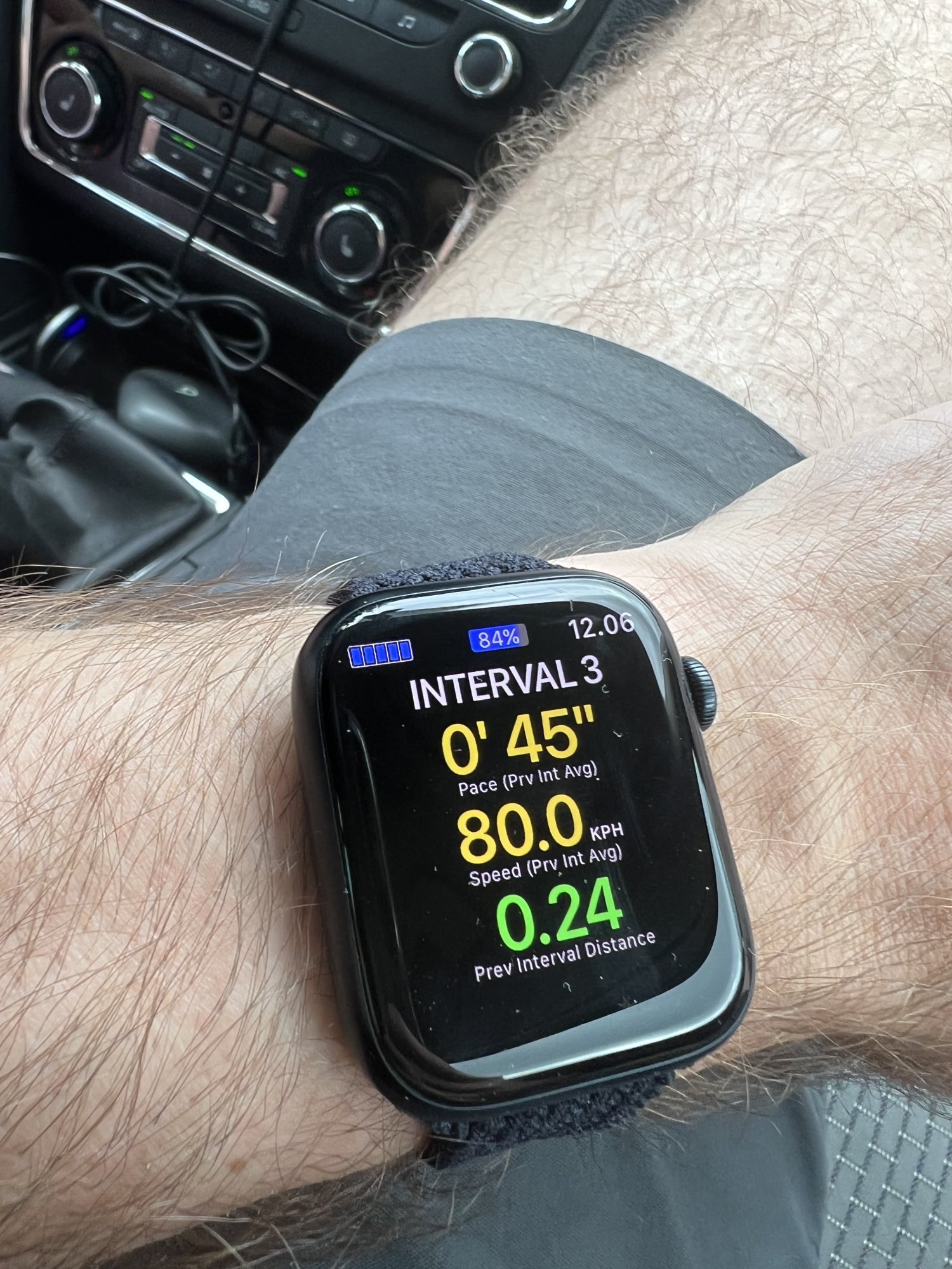

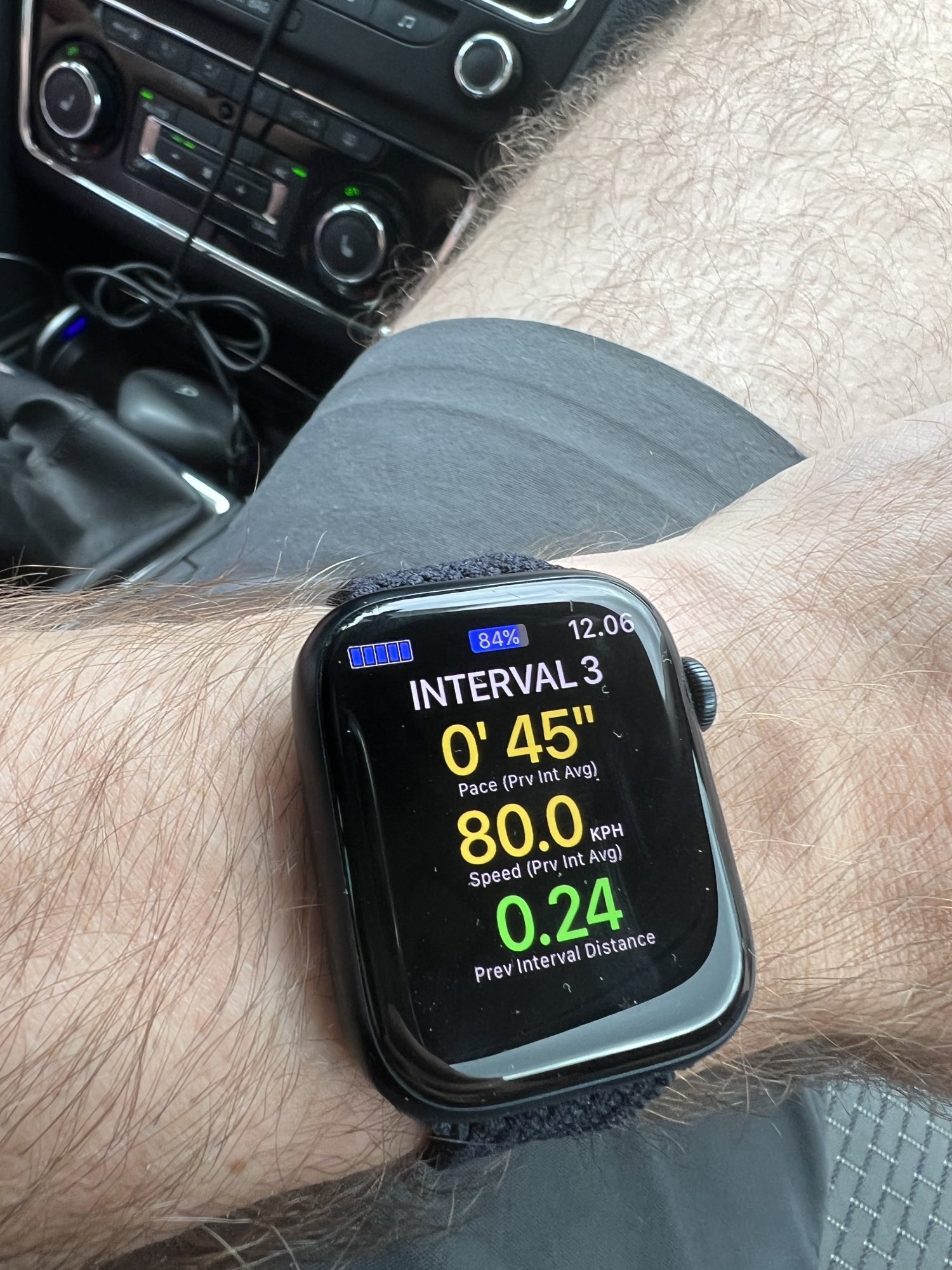

The one that appears if I make a manual lap or split.
Yes, you can configure the metrics that are displayed on that screen. Go to the Alerts settings and choose the activity (e.g. Running). Then tap "New Manual Interval". You can then configure the 3 metrics that will be displayed when you start a new interval.
This is great! Would it be possible to fit more than three metrics and maybe ad an configuration option that the metrics are displayed until dismissed?
No-one has asked for that before but I will bear it in mind the next time I am looking at that area.
Note that you can make the messages appear on the screen for longer in the Other Settings screen. Only up to a maximum of 5 seconds though.

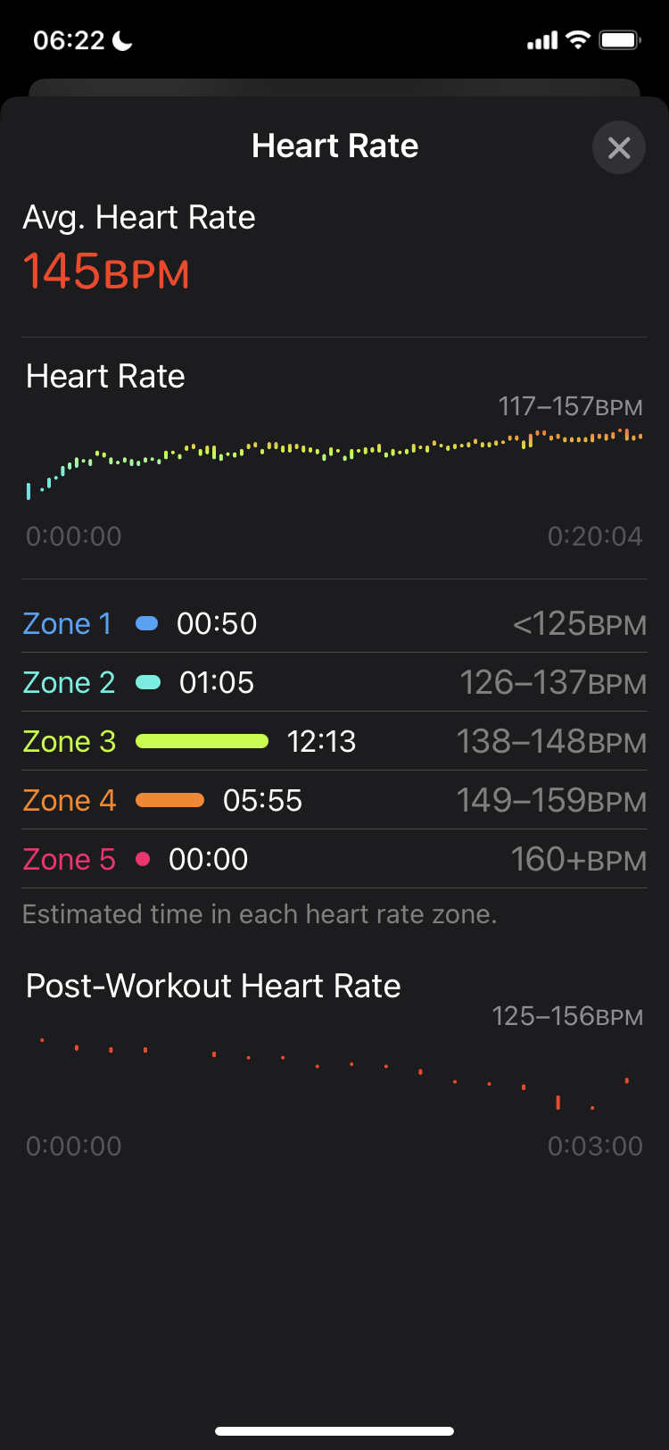

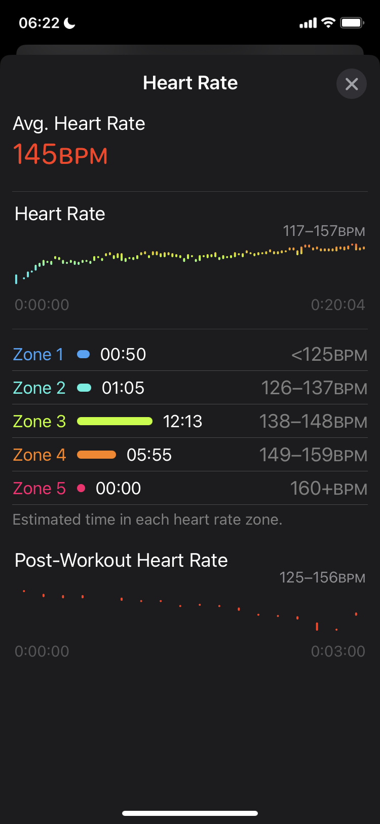

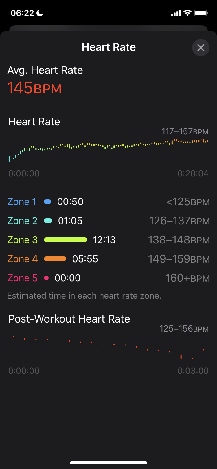

Great app! Please pass Heartrate Zones data to Fitness.
Below was captured on iOS 16 beta, WatchOS 9 beta, on a run I did in the Apple Workout app.
Shows up in iOS under Fitness > Outdoor Run > Heart Rate > Show More.
Showing the zones and elapsed time is really useful.
Thank you.
Edit: Ah - I can see the data under Workoutdoors > Workouts > Heart > Zones! Stupid me - such a thorough app must have that data somewhere ^^. Make this feature request a "nice to have" then. TY.

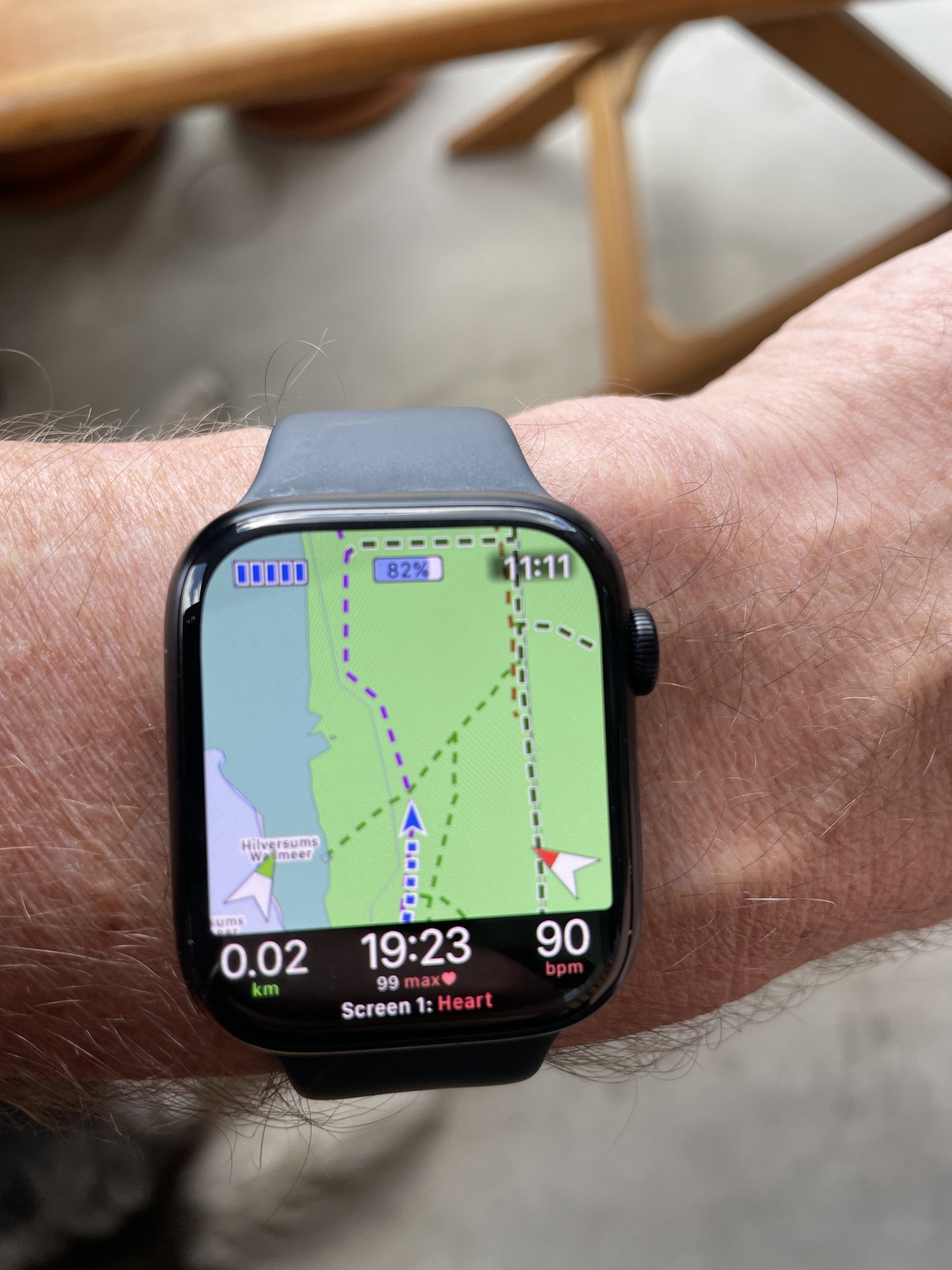

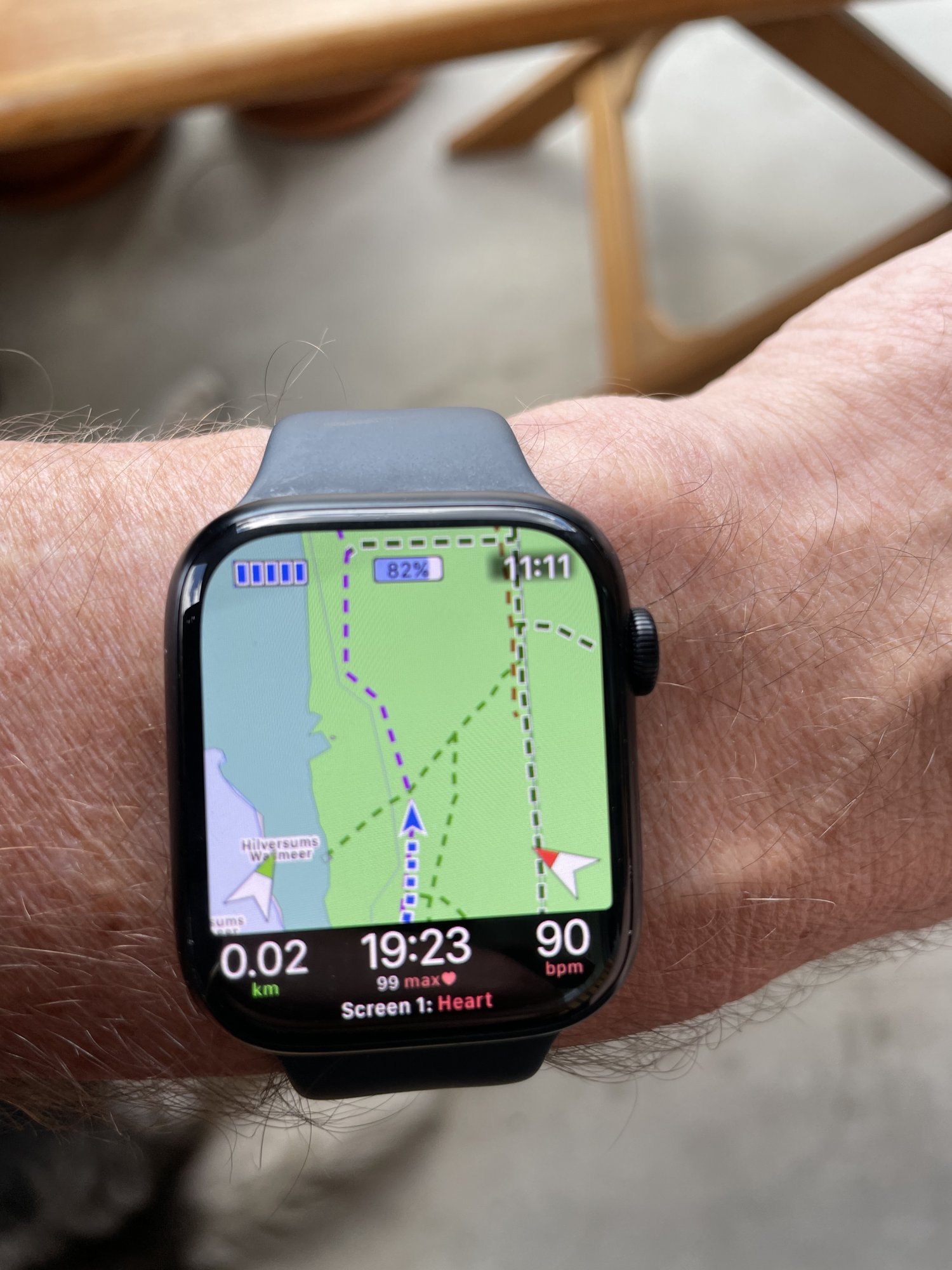

My WorkOutDoors app on my AW7 froze when running today - the map failed to move although it seemed to continue recording the run. Turning the crown had no effect (no zoom). I could not find any way to recenter on where i was etc. It remained frozen at one location. I had to stop the app and restart on iwatch. Is this a known bug or am I doing something wrong?
Alex
Happened to me a few times before. Seems like a problem with the new Thunderforest maps (assuming you use those?), but I don’t know for sure. Force quitting the app and reopening it seems to help; no need to restart the watch… but no idea how to reproduce the bug.
Alex
A couple of people have mentioned this with the Thunderforest maps but I am unable to reproduce it. Sorry about that. Please could you send me the wkt file for that workout. Hopefully the more examples I have the more likely I can spot a pattern. To do this tap the Export button 3 times quickly and send it to info@workoutdoors.net. And maybe use the default Mapbox maps until I can fix it.
